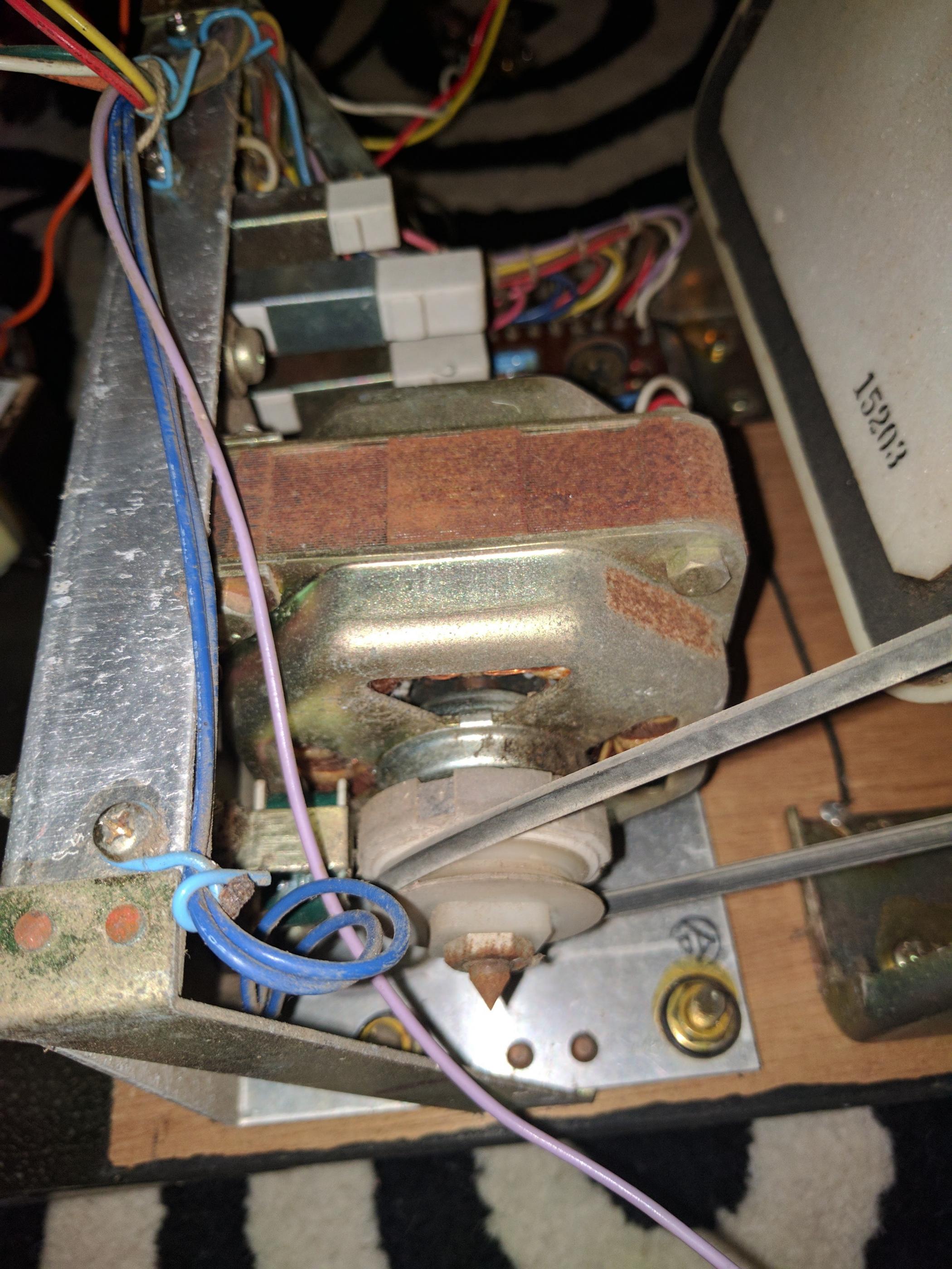

Hi everybody!
Digging up a very old thread I know, but I've been using the information here to get working my own yamaha rotating speaker that I pulled from a Yamaha B-5br organ, the speaker is working, and the owner of the organ said he saw it spinning while it was still in there, but I can't get it to rotate. Following what I've gathered from here and the youtube video linked in the OP, I'm powering it with a 6 VAC transformer attached to the green - and orange + and connecting the red and yellow, and red and white wires together for the different speeds but not getting any action. Does anyone here have any additional info that might help? Thanks
So do you have a schematic for the B-5br? My service support site does not include organs.
How did you determine it wants 6vAC to run the motor?
The only Yamaha spinner I have is the RA100 schematic. That motor is a JC00008, any chance yours is too? THAT motor has a run cap and three wires, plus a couple more wires for its speed sensor. It expects mains voltage.
Thanks for the info Enzo! Unfortunately I haven't been able to find any schematics for the B-5, so I got the voltage from the schematic posted by komigenie. I suspected that maybe it needed mains power from the comments on the youtube clip, but I'm in Australia, and didn't want to jump to that conclusion and hit it with 240v! The unit may be expecting that kind of voltage though. The motor has no markings but I've taken a couple of pics just now, in case you recognise it

I hooked it up to the mains voltage (240v) and it works no problem, thanks Enzo. If anyone out there comes across a Yamaha organ with a rotary speaker don't hesitate to whip it out of there, great sounds, really easy to work independently of the organ. Here's what I've found:
Wires
Orange: Mains +
Green: Mains -
Red: Rotary speed common
White: Rotary speed slow
Yellow: Rotary speed fast
Purple: ground
White: Speaker +
Black: Speaker -
Put the red and white together for slow, red and yellow together for fast, I've wired them to a footswitch. The speaker is 8ohm so I'm running it out the extension output of my fender hotrod deluxe, sounds great!
