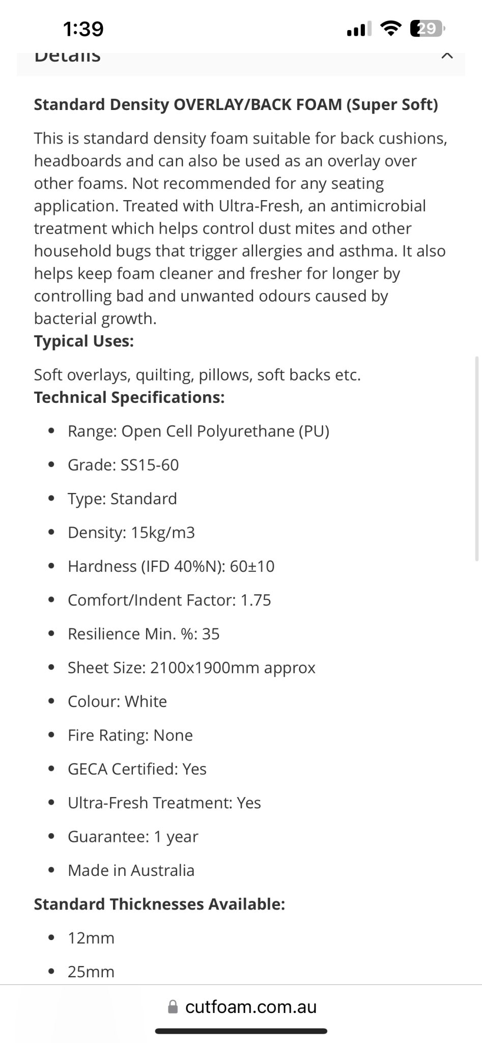

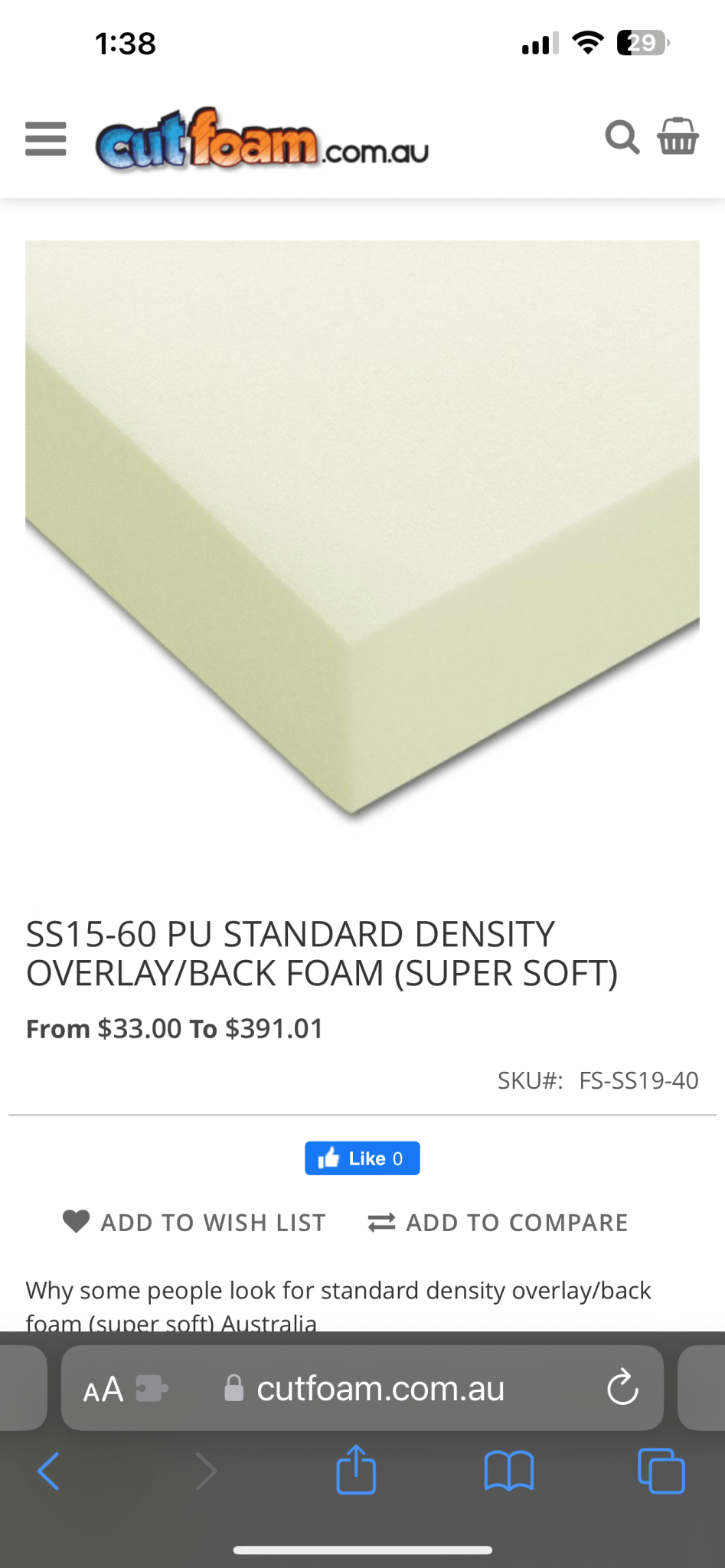

There are different strengths soft med and hard is this the damping material to get and how thick of a material should I get https://www.thefoamcompany.com.au/collections/flexible-polyurethane-foams-open-cell
Is this the right material cheers Rick
No, foam is not what you need. You need an open damping material, fibers like Rockwool of polyester pillow filling.
You need to prevent the damping material from touching the cone from the back and /or small fibers or dust entering the voice coil.

@Turbowatch2 @Rick2023 The proper type of foam for enclosure dampening is low to medium density open cell urethane foam. Only open cell foam will work. Closed cell foam acts like a solid in a speaker enclosure, raising Fb due to reduced volume. Some slightly better, wider band absorption mediums are sheeps wool, rockwool, fiberglass wool and melamine foam.

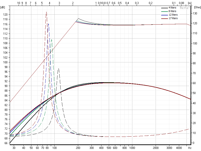

This is the Rosso in different enclosure sizes (TSPs from SB audience, 0,5 Ohms series resistance from xover, 20% stufffing):
You see, the behaviour >500Hz is neary not affected by the volume. Also, once above 8 liters the behaviour < 500Hz is varying not much when the volume is increased. So for midrange application, the enclosure volume is rather uncritical, you have a wide range to choose from. Personally, I would give it >= 10 liters to have enough stuffed volume to absorb the rear sound of the mid poperly, but I would let me also drive by a meanigful construction design of the cabinet.
Are you using Vituix cad for this graph

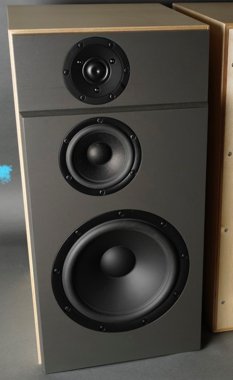

@profiguy what kind of spacing do you think I should do for the drivers on the baffle I’ll show a photo on how I want to place the drivers but idk about spacing.

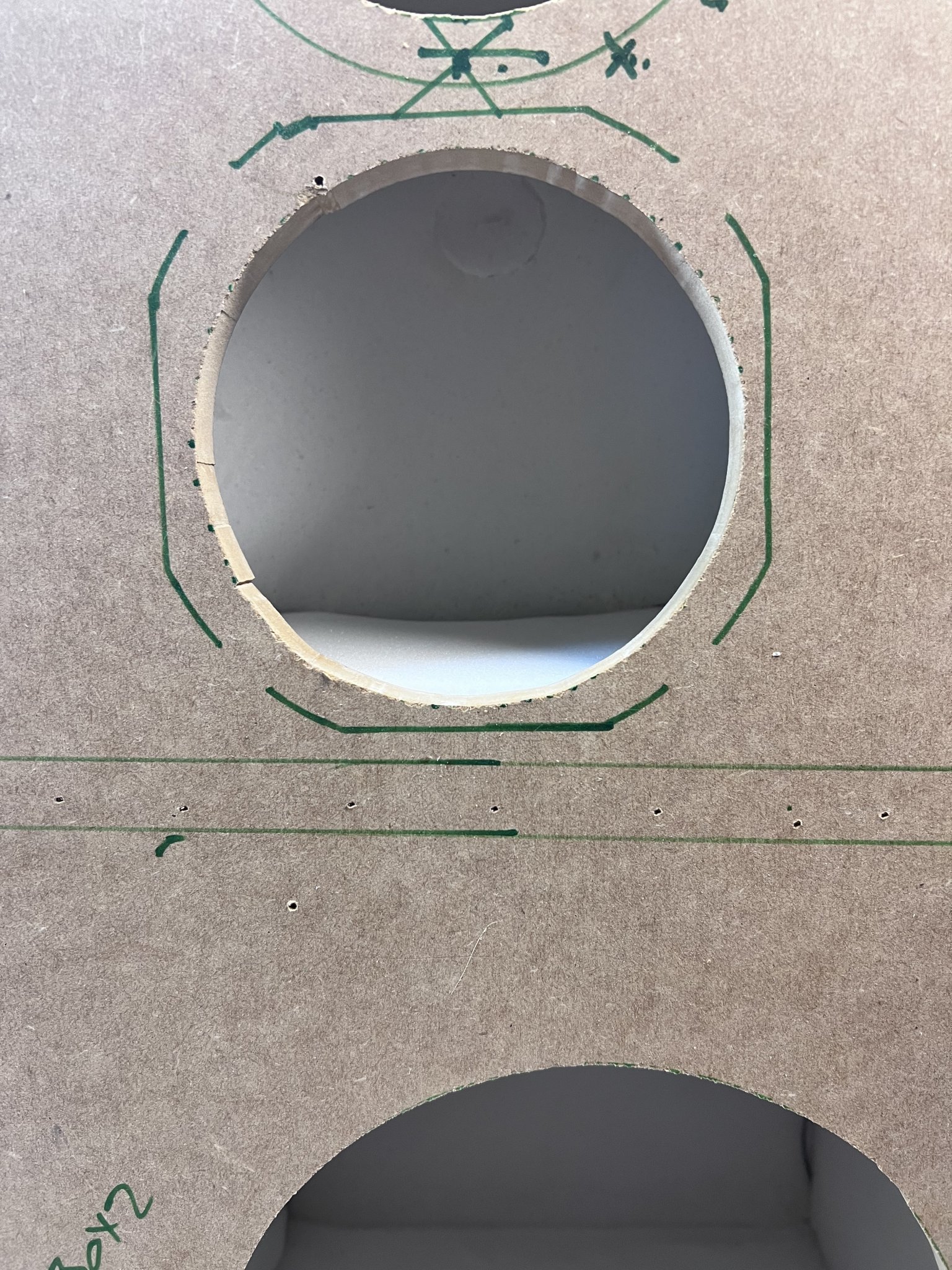

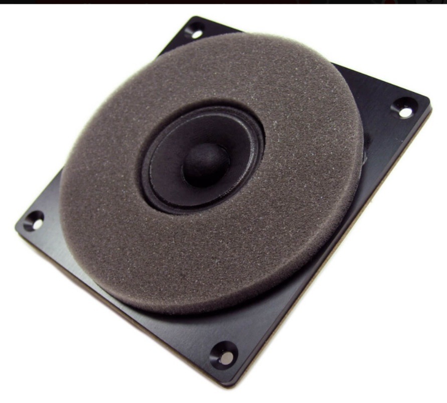

@profiguy I think I messed up bad on driver location on the baffle the midrange driver is so close to the foam and the cut out is about 15mm away from mdf / the bottom of the sealed enclosure I wanted to place all the drivers as close as possible but idk if I’m going to run in to any issues of the midrange sound idk what do you think do you think it will be ok.
btw that 3M spray adhesive is good stuff I and should of used gloves lol
I think you'll be ok with the tweeter being that close, but make sure you countersink the mid flush with the baffle. If you're concerned about tweeter diffraction from the surround, you can use some thin, medium density wool felt or open cell foam in the height of rhe surround, placed around the tweeter dome perimeter to "soak up" some of the higher frequency radiated energy and create an acoustically flat surface. The idea is to soak up some of the HF energy so it doesn't reach and diffract at the mid surround. JBL did this with their LE26 cone tweeter.

I won’t be able to flush mount the midrange do you think foam on the waveguide would be ok the middle hole is for the midrange the top hole is for tweet and the bottom hole is for the 10” woofer I was worried about the midrange being so close to the bottom of the sealed enclosure from the bottom of the cut out the foam is almost flush with the midrange cutout so 25mm of foam then the wood is there I wasn’t sure if I would have any problems cheers Rick

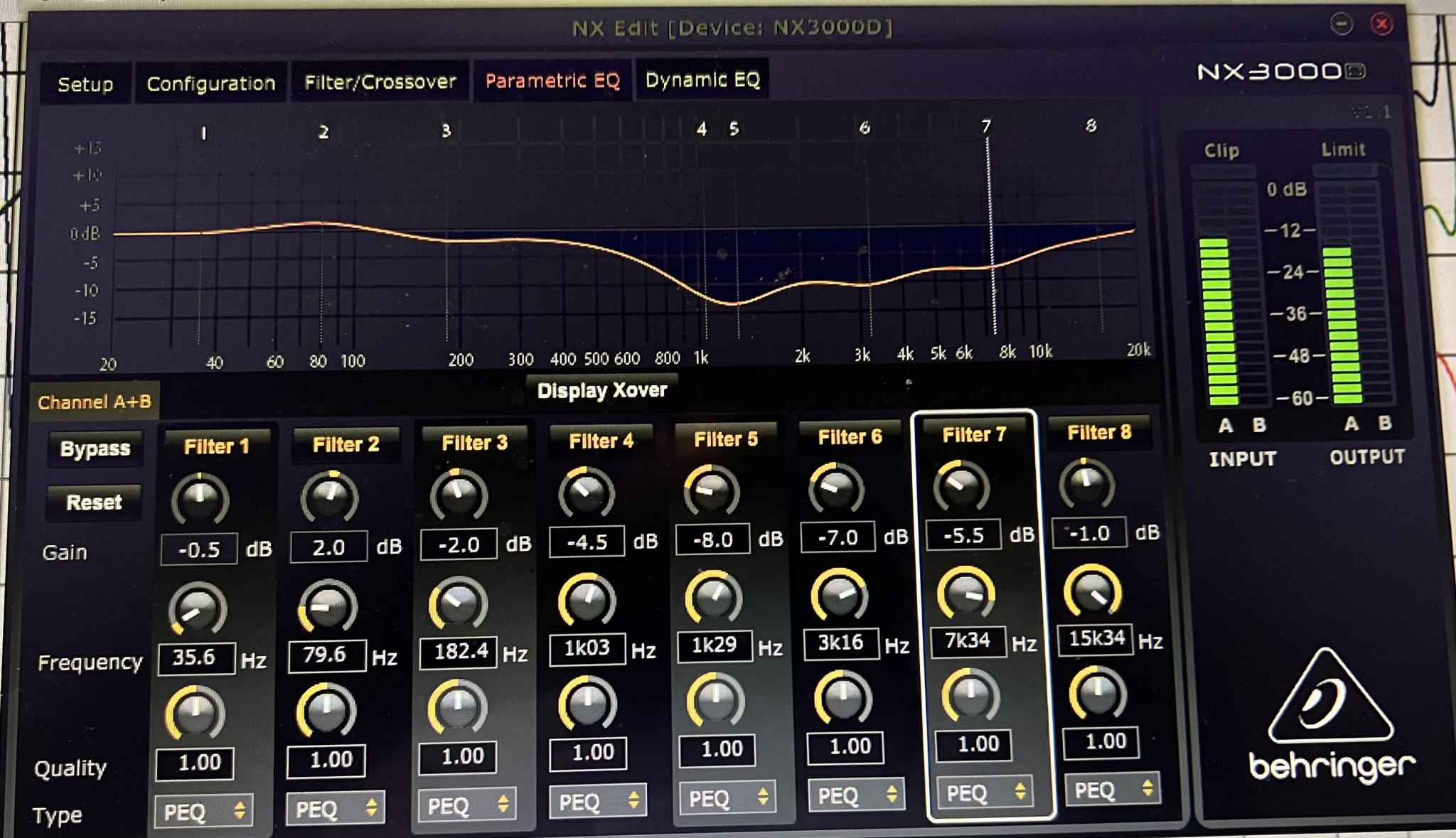

@profiguy I wired up the speakers and had a listen to one of them since I’m still making the other one it sound ok I noticed there’s a lot of midrange I could say it’s harsh I had to dip out the midrange a bit but still finding that it’s still abit much even if I spin the enclosure around 180 facing towards the wall @about 3-4ft away it’s better but I think it’s midrange here’s a photo of the eq do you think it would be a crossover issue or just a driver issue or eq
Cheers Rick
Without measuring and just looking at your EQ curve, it appears you need a good amount of BSC and dampening of the rising FR which is normal. It would help slot to take some basic measurements on and off axis. That mid is capable of smooth response, especially on a larger baffle. Also, not knowing exactly where the acoustic center is in relation to the horn driver makes things much more convoluted in terms of achieving good phase alignment and smooth FR on / off axis.
Reactions: 1 user
BSC = Baffle Step Compensation. Its counteracting the baffle's influence on FR based on its width, causing a gradual rise in driver outout as the frequency increases. Most drivers are measured using a very large IEC spec baffle to minimize its influence on the driver's anechoic FR. This is why you need to consider the baffle size (specifically width) to predict driver FR when mounted in an enclosure. Both the baffle width and enclosure volume have significant effect on final driver FR.
I'd purchase a DATS V3 system if you want an easy to use, basic measurement system. The alternative is your choice in calibrated measurement mic used with a decent 2 ch USB interface with a program called REW. This option allows for relative phase measurements, which DATS V3 can't do. You need a mic with a known CAL file to get accurate results.
