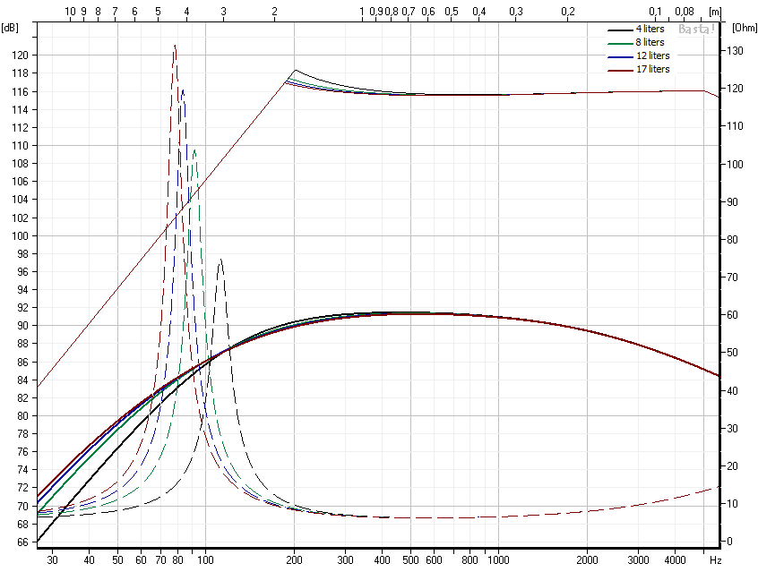

This is the Rosso in different enclosure sizes (TSPs from SB audience, 0,5 Ohms series resistance from xover, 20% stufffing):
You see, the behaviour >500Hz is neary not affected by the volume. Also, once above 8 liters the behaviour < 500Hz is varying not much when the volume is increased. So for midrange application, the enclosure volume is rather uncritical, you have a wide range to choose from. Personally, I would give it >= 10 liters to have enough stuffed volume to absorb the rear sound of the mid poperly, but I would let me also drive by a meanigful construction design of the cabinet.
