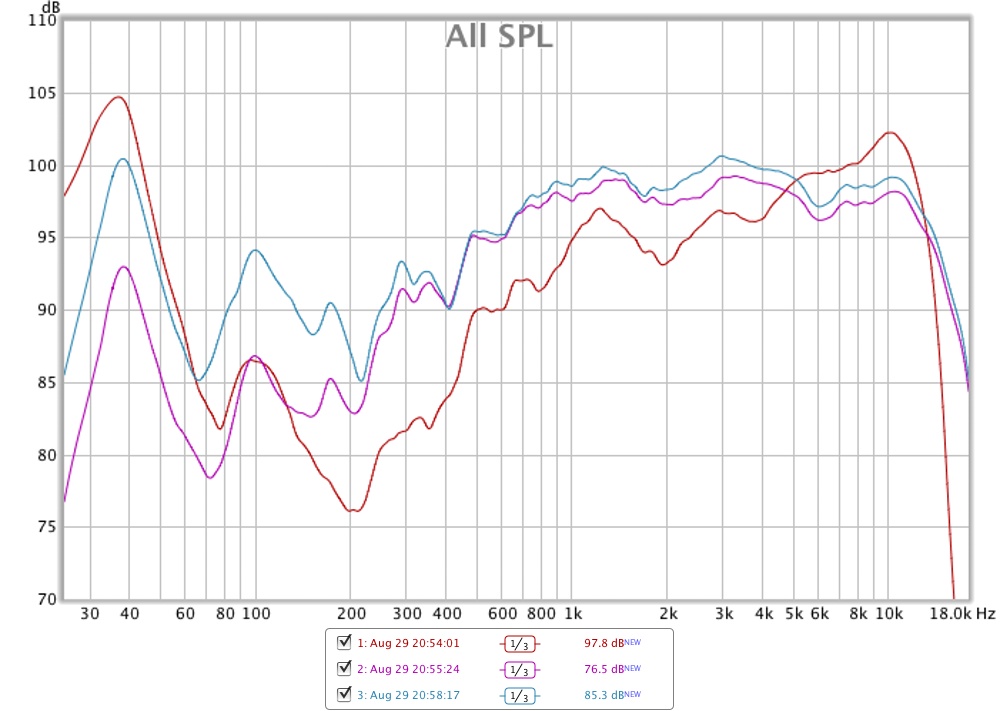

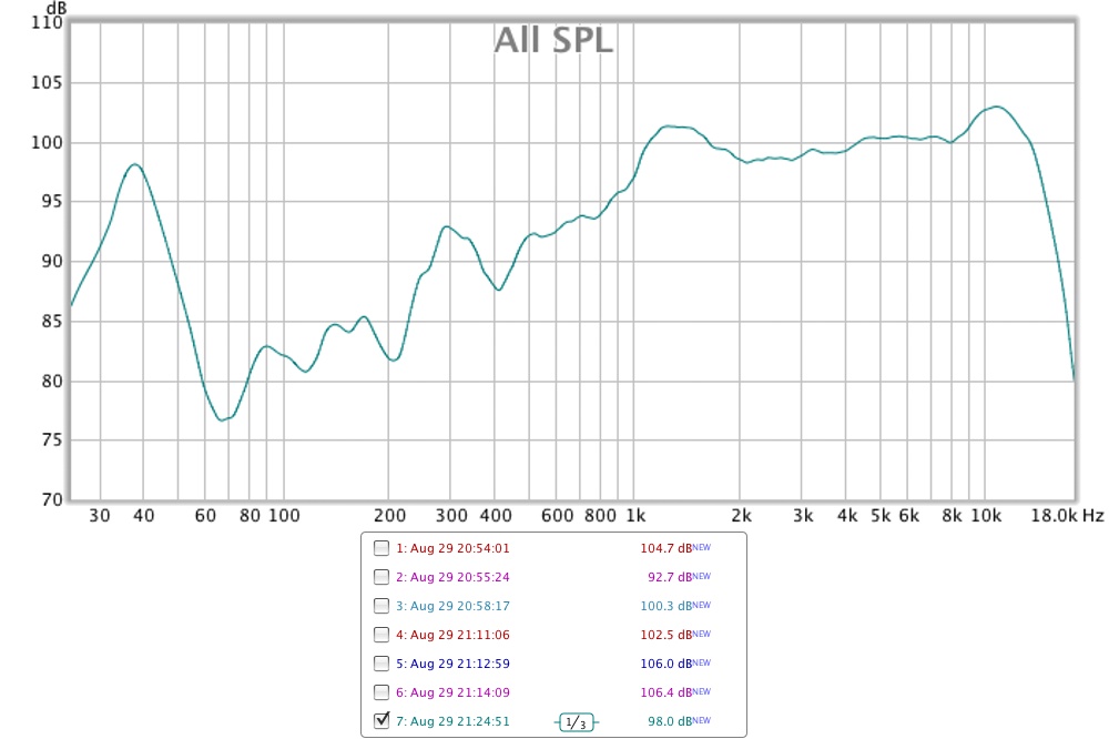

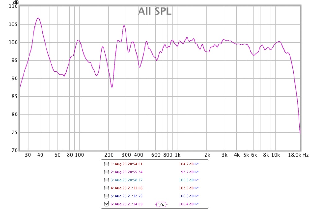

Image 1:
First sweep is for the B&W DM604S2´s (Baffle 65cm out from wall)
Second is Line Array´s non-EQ´d (Baffle 45cm out from wall)
Third is Line Array´s EQ´d (same)
Two major dips at approx 66hz and 220hz while the LF peak is at 37hz.

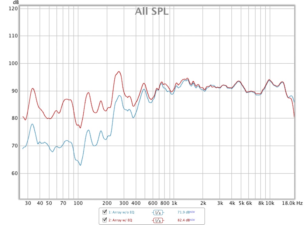

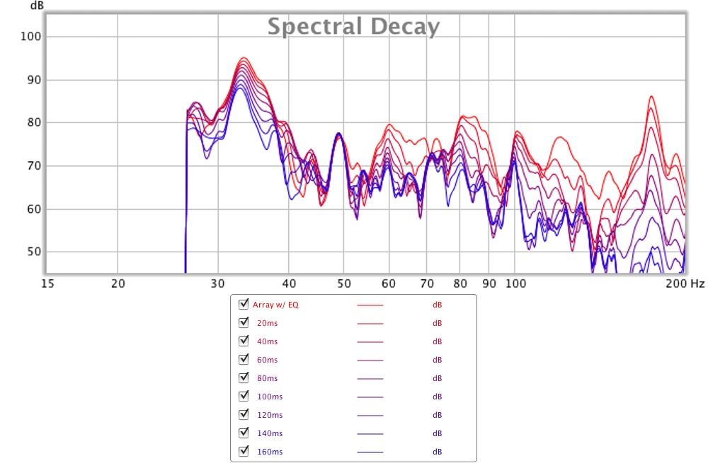

Image 2:
Single measurement of arrays with freq. evened out by EQ. This resultet in unsatifactory listening experience. Image 4 show a sweep where SQ is percieved as much improved.

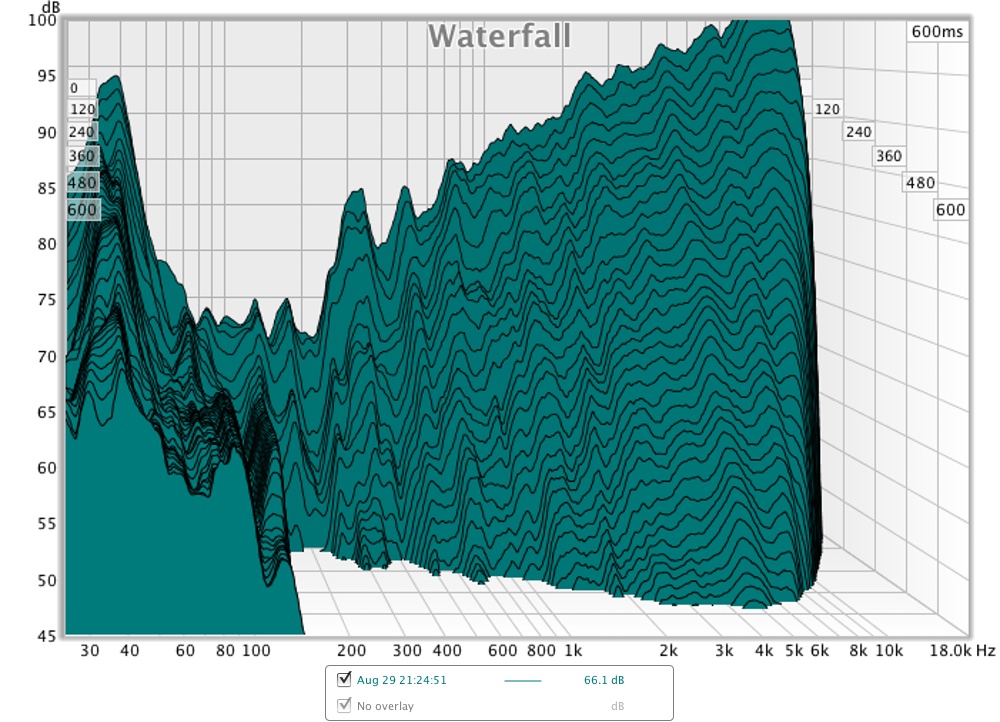

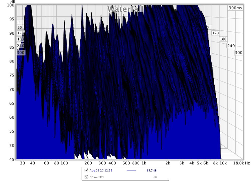

Image 3:
Waterfall
I'm just guessing here but there must be something going wrong with the measurements?
The last picture (4) shows a remarkable resemblance to the first picture of the B&W.
If that is what sounds good (60Hz to 250 Hz is down by -20 dB compared to 1-10 kHz) something must be wrong. At least, that's what I make of it... Can't imagine a speaker with that kind of output sounds good.

I think what we are seeing is that Halair's listening room must be a cavernous box with hard walls. The fact that the response from the B&W and the line array both have dips at 70Hz and 200Hz indicates these are room effects. And the line array does a good job of reducing the room effects which also include floor bounce cancellation as the dips with the array are not as deep and narrower. I would do an additional very near field (30cm) measurement in front of the B&W and the middle driver of the line array. That will have very little room effect. The HF's shown by the line array are excellent and at 4m away I don't expect any comb effects to be significant. If the mic is calibrated and your ADC (sound card) is calibrated, the measurement should be good within 2dB. That is one reason I use USB mic's - the ADC is always calibrated with mic because hey are the same unit. If you get a chance do a measurement with 1 speaker on only at 30cm, 1m, 2m, 3m. That will shed some light on those big dips because they should move around with distance. If it it intrinsic in the speaker they won't move so much. Hope that helps.

The 60Hz and the 160Hz dip are definitely room resonances, the 220 Hz one may be interference between the direct signal diaphragm to microphone when mixed from first reflection from floor in between, the 400Hz one might be cabinet edge diffraction/interference.
That said, your results are no bad at all, but realistic, it´s what your speakers sound like in that room, that position.
To compare, remeasure with the microphone very close, a few inches from the diaphragm, most of the problems you see will disappear.
Of course, you will not use your speakers as "Texan Headphones" , inches away from your ears 🙂

Just looked at your data files from REW and you'll notice an upwards slope in both the line arrays and the B&W data files. It seems to me about a 3 dB/octave rise across the range from ~ 40 Hz to 10 kHz. It looks like the difference between white noise compared to pink noise.
Did you use noise or a sweep? Seems to me very close to what I'd expect for a measurement made with white noise. That would also account for the lack off drop of seen in the high frequencies.

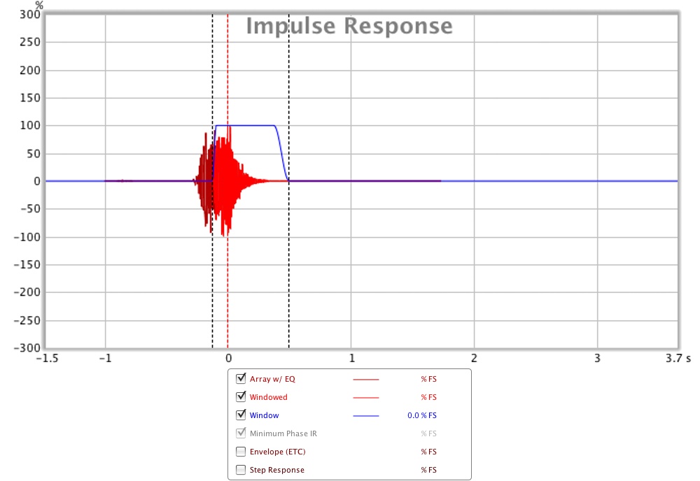

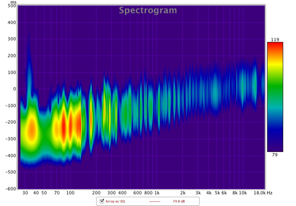

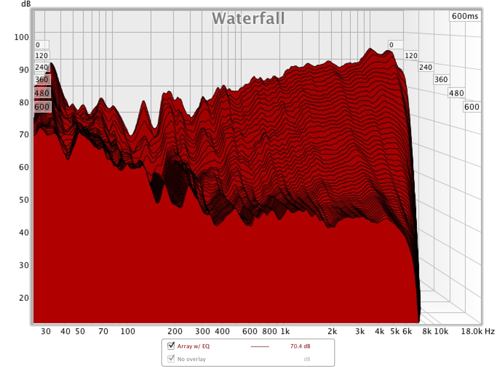

Images with graphs shown below. Are these still dubious?
I went through the REW setup process once more but during calibration I get a message that the difference is say 70dB between 20-20000hz and this might not give me a good calibration. There is also a clicking noise during sweep/measuring. I googled that and tried the suggested fixes to no avail.
