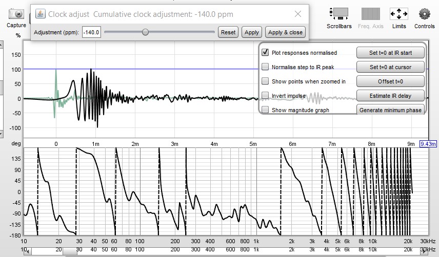

Here's my first test IR using REW and timing references.
The test is done with my nearfield desktop Adam A5X rpi4+iFi DAC as client.
I doesn't seem to look messed up like the IRs I've seen with the drift not being taken care of.
Does it make sense? What is this graph telling me? ( A huge reflection of the table surface!?!?)
Thx.
The first millisecond is the speaker settling or extremely close surfaces interacting, the first obvious reflection is at 2.3ms which is still very early. The view is highly zoomed in. Also have a look at the step response as that will give you a better indication of the time performance of your speaker. The IR is dominated by high frequencies and it obscures a lot.
Another thing to check is to apply a 15 cycle FDW through the IR windows tab. Then go into impulse and press the clock adjust (don't adjust it) and have a look at the phase graph. If the phase trends back down to zero near the nyquist frequency then that is a good indication things are OK. If the phase is still messy then use a lower cycle count.
