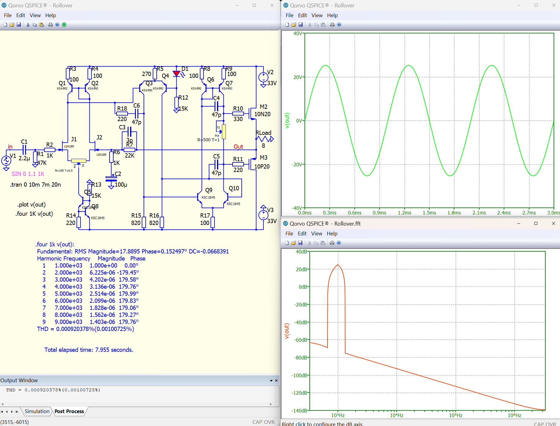

A more accurate calculation. I started the calculation after 90 ms. That is, when the process was steady, when the capacitors were charged.
