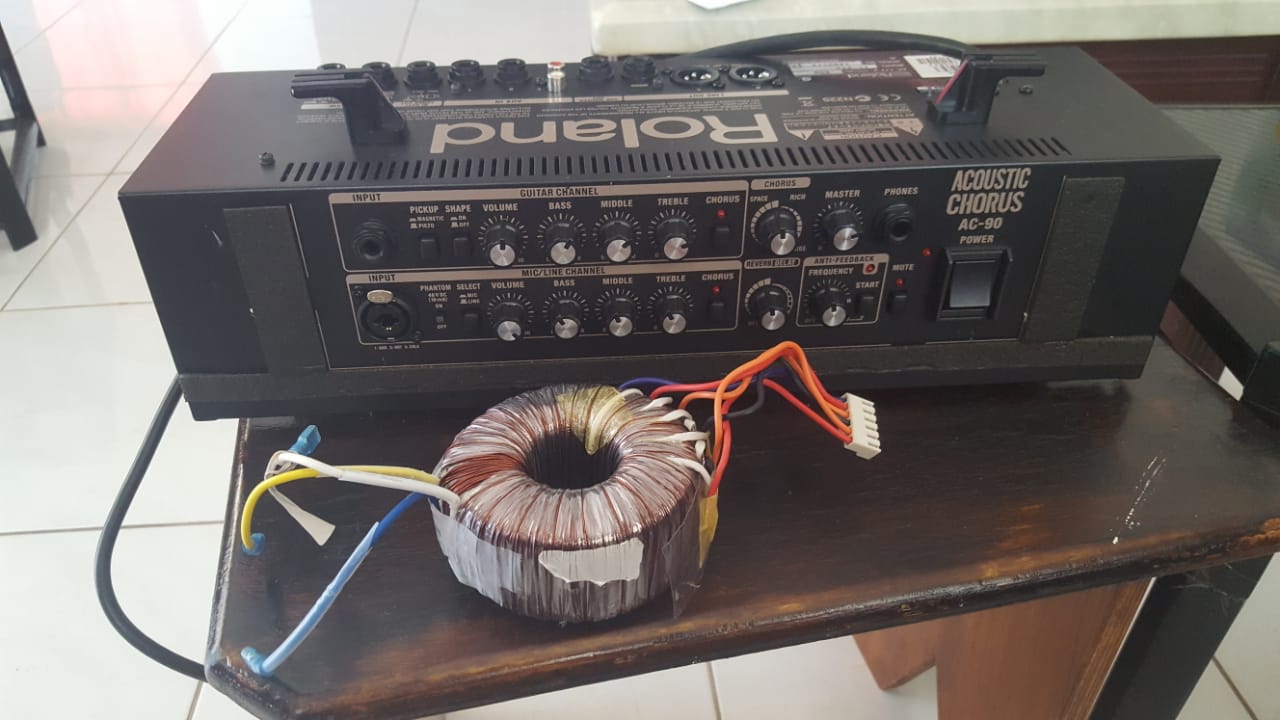

Hello, have you sorted out the issue with the transformer? I have a friend with the same issue. He also has a Roland AC-90 with what seems like a dead transformer. Attached you will find a picture of the actual amplifier with its defect transformer.
If you have found a solution, we'll really appreciate your information.

Hello, a friend of mine is also having an issue with it's Roland AC-90. It seems that they were able to narrow the issue down to the Transformer as well. Attached you will find an actual picture of the amplifier with the presumed defect transformer.
If you were able to find a solution, we really appreciate the information.
