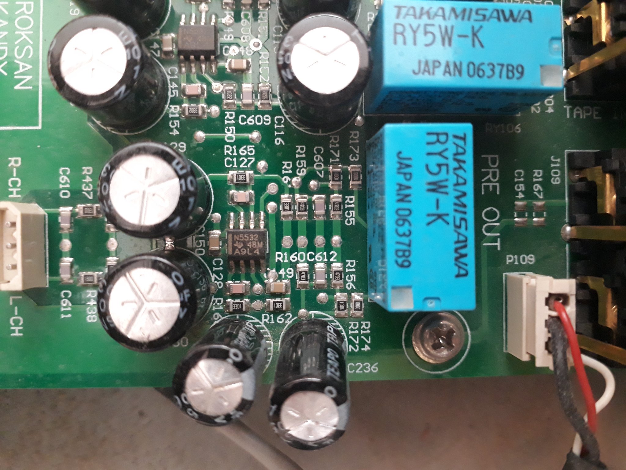

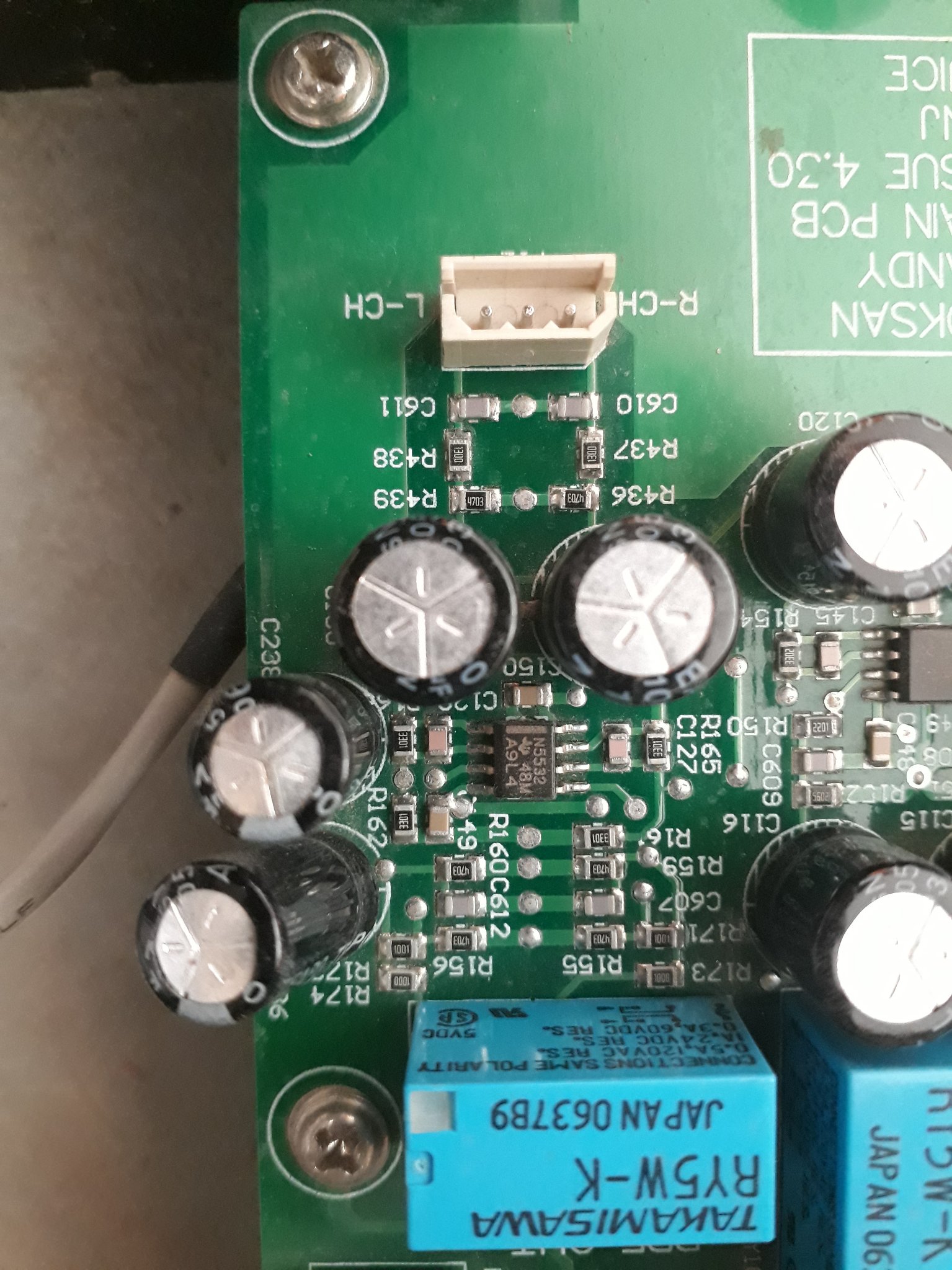

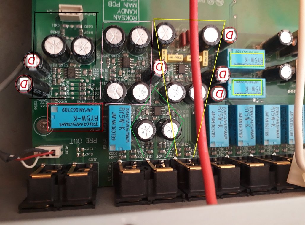

My MSpaint skills are not going well, but here as a couple of the board from below. For completeness.

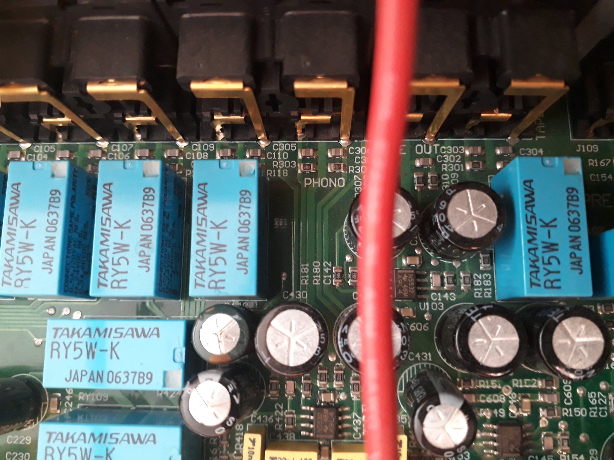

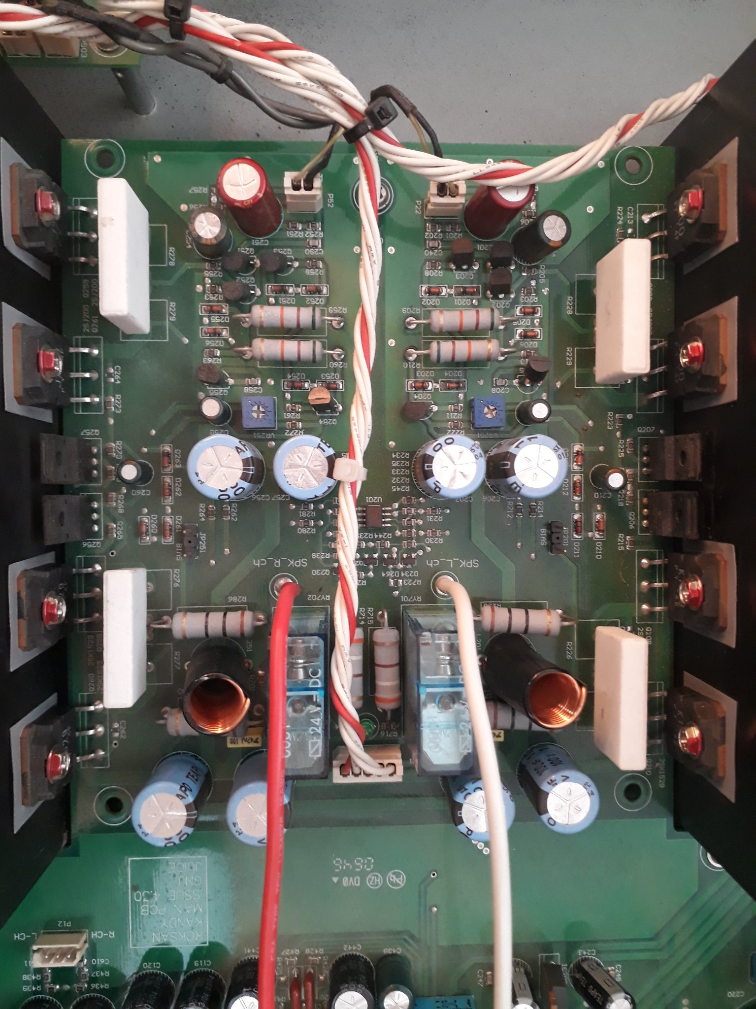

I notice all these caps are rocking about. Non are particularly snug, and no efforts been made to support any. I guess they shouldn't be moving, but this isn't the hifi ethos I expected. I reckon my glue gun could help in places, or maybe the wobble is suspension in action 🙂

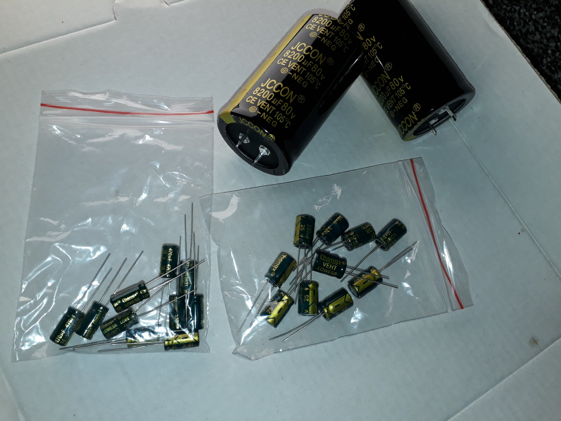

I might buy the smaller and obviously broken caps again, as good one's are only 50p each. I have seen some chonkx on youtube. blowing just for fun. At a rate that might not even survive first power on. The 8200uf I'm stuck with, as I can always replace them later, but right now the saving is quite real. Reviews are fair, and its better than blown one's. One channel actually sounds fine, so I'm not far off. Being just one that's 'bad' is why I'm looking at the audio path, but I reckon I'm going to leave that side alone, until the scope arrives, and I can pretend I know what I'm doing

If the capacitor lead spacing is correct, the capacitor body should be sitting flat on the PCB. If not, the leads should be formed properly and the capacitor sits perpendicular to the PCB surface. No attempt should be made to make it a solid mount. Capacitors are glued only if their mass is large enough to stress the leads/traces/solder joints. Also for wave soldering so they don't move during that process. Those parts are often mounted on their side and glued.

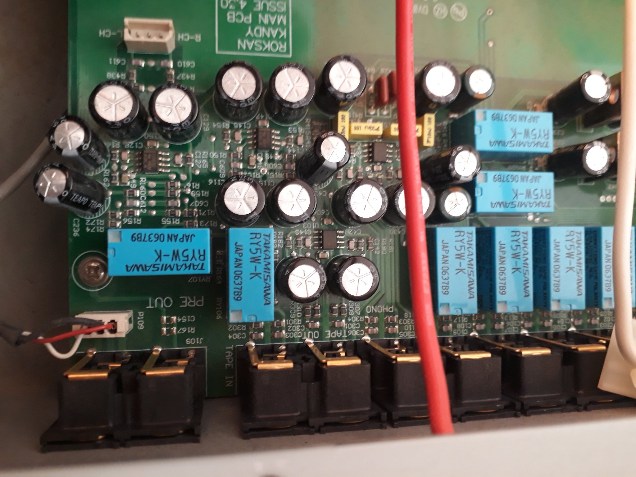

I don't think a single one of these sits flat. I have been looking under them for venting. They all seem contained.

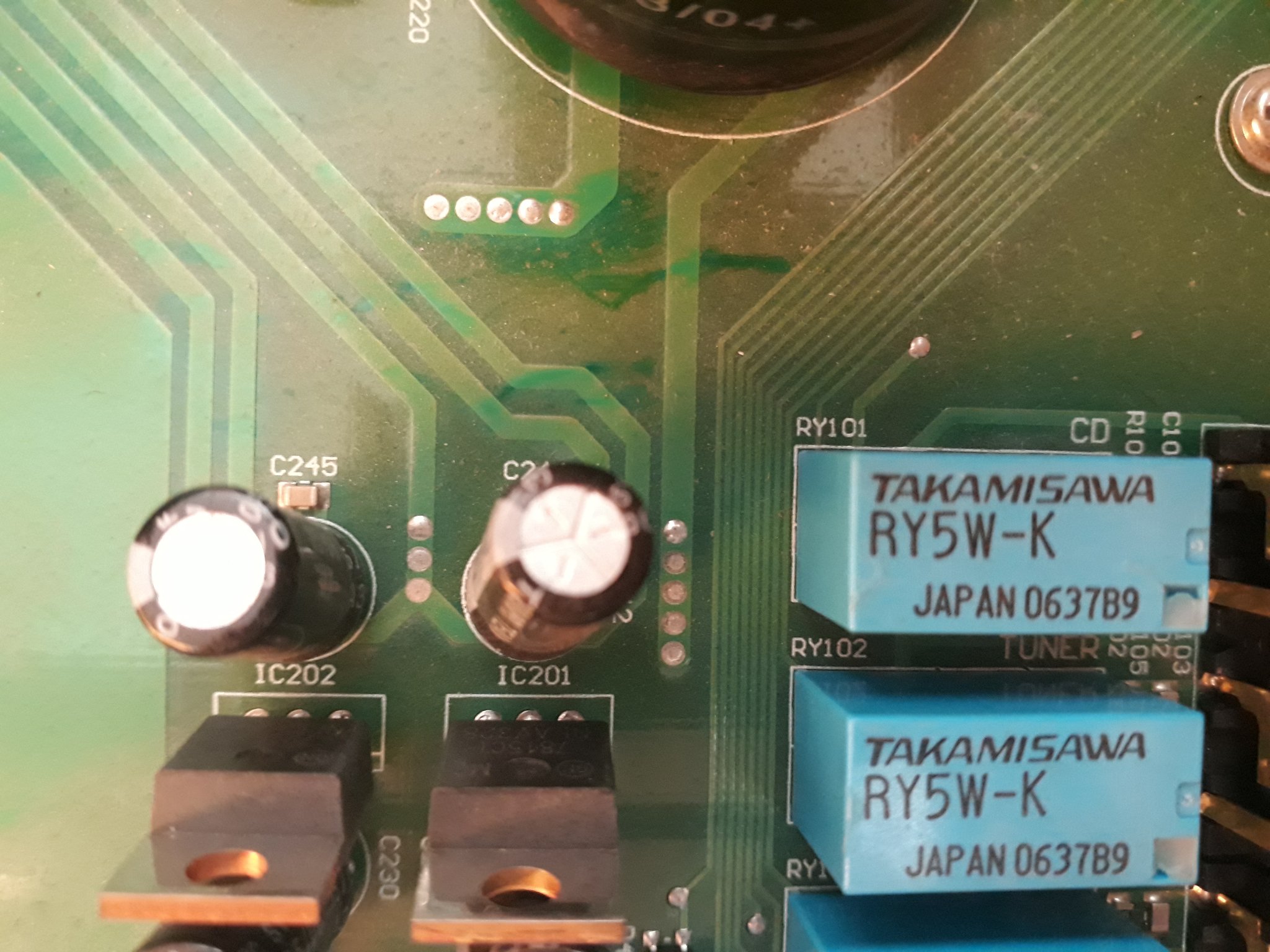

Most of the time I see dry joints, it's heavy components. Maybe small themselves, but with heatsinks being favourate. I'm going to help out the main caps, as vibration with half a K is going to be physical, so I think shifting up the resonant frequency is worth the small effort. It's a blob of sealant or hot glue, so not a big deal. Either will be just a blob at the edge of a 105c cap, where it is just the base of the can. I won't be cooking anything.
I can't say I'm a big believer in microphonics either. Not without a very susceptible part, and a high gain. There are no iron core pots in here 🙂 Perhaps relay coils and armatures, but they are on a separate 5v regulated supply anyway. The fact that cap has blown, is one of my head scratching points. Not that I'm having crazy ideas it's microphonics injecting extra noise as some could try and sell us. I'm just thinking it's without clear reason. Everything popped is in the same area though. Picture if you will, a closed rack of kit, making perhaps 250w of heat. Then pushed up against a radiator of the household heating system. It's happened somehow. I can see the symptoms, but not the cause. Yet.

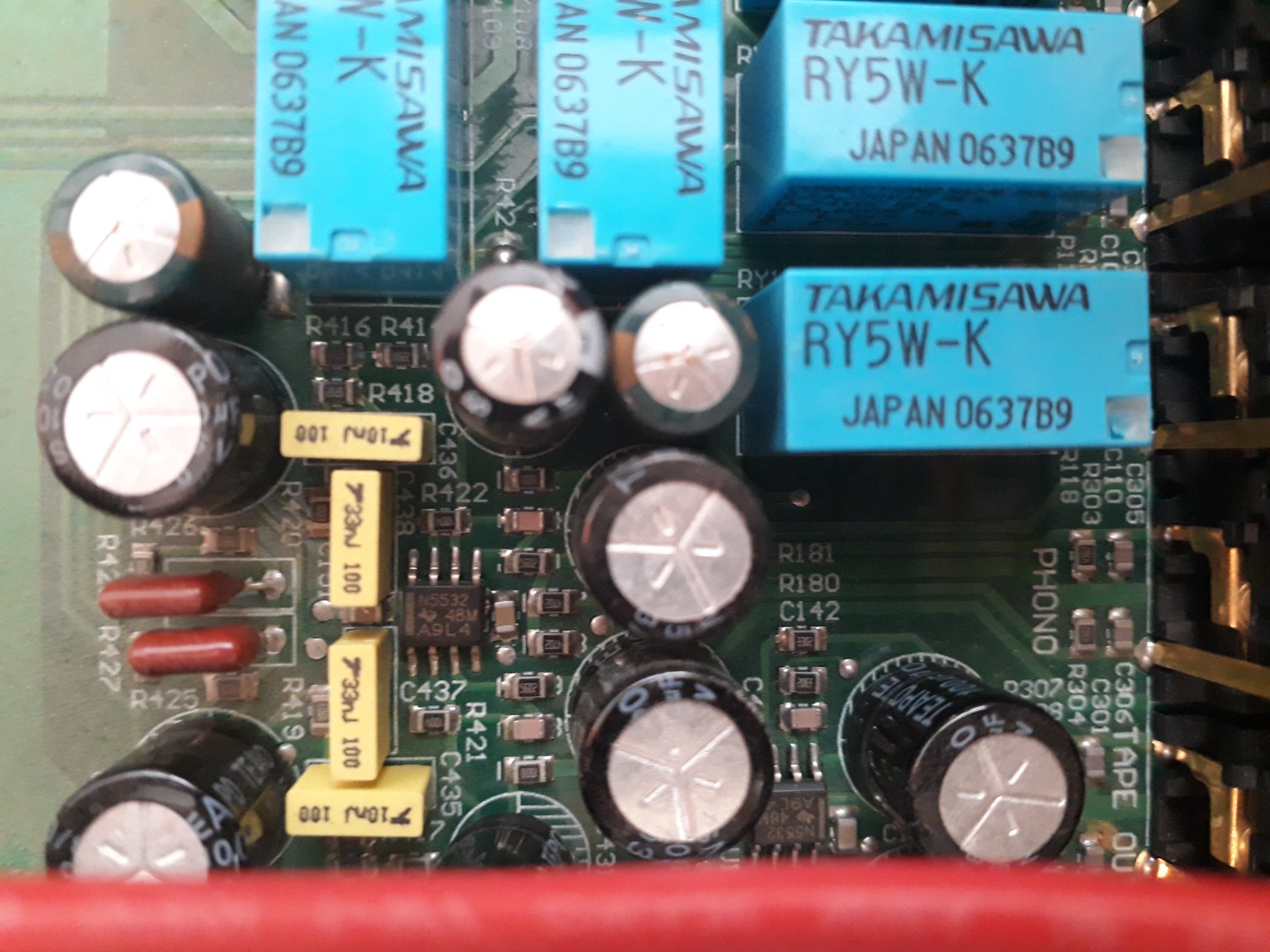

Try new capacitors with lead spacing that aligns with the holes. They will be better capacitors (a touch more expensive) if they have wider lead spacing. 105 °C caps are not always better, high temps are destructive so solve the root cause if you can. A touch of silicone adhesive is best. Bad connections begin in the wave soldering machine. Hand soldering solves this issue. The larger components do not heat up enough due to thermal mass, so the solder never properly whetted. Also sometimes the larger parts move during the process. Smaller capacitor do not require mechanical restraint in any way. You just make a mess. Avoid using hot glue.
You probably have excessive internal case temperatures, plus high ripple current in the caps affected. Higher internal resistance coupled with high current can add to the ambient to overtemp the part. Cheap capacitors can be the cause coupled with run temperature. If you have limited ventilation, either fix that or install fans. Watch the thermal in the transformer may go next since the lack of ventilation wasn't solved.

I do hope the new caps fit better than what comes out. I won't silicone the small ones, as they vent at the bottom, and have no real weight. They were 105c to begin with, so I will stick with that. I can only do so much reforming the legs, as they shouldn't be bent using the body as a former. Some height gain is inevitable, and I don't fancy drilling the board lots. I might be forced to do as they did, but recognise it's probably not best practice.
