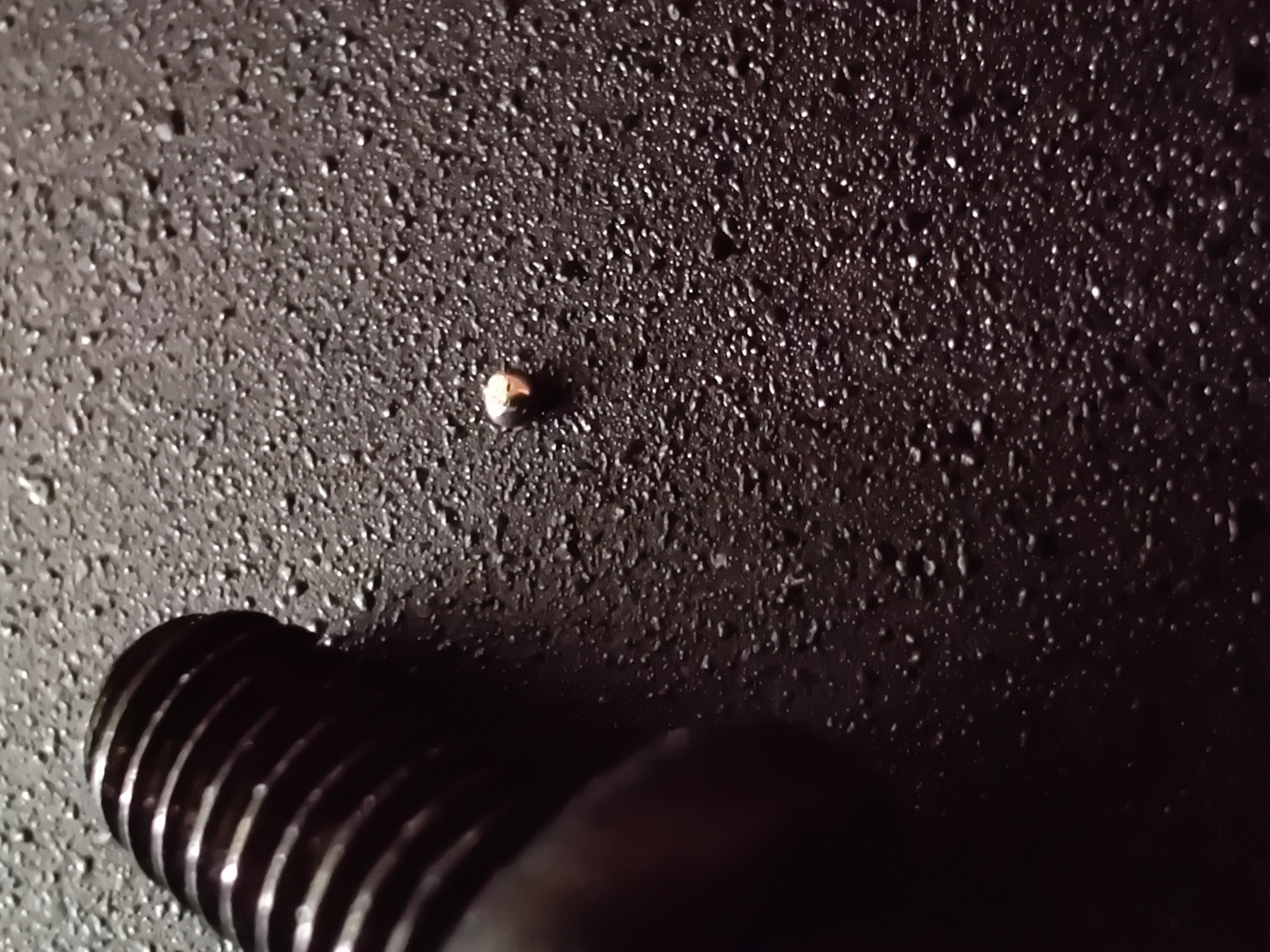

Now my second more pressing question is - Once I looked back into the case after removing the mechanism there was, what appears to be, a tiny ball bearing sat in the bottom of the case. I've taken the best picture I could with a case screw for size reference but cant upload for some reason (ill add them later), with a vernier it measures 0.54mm. Does anyone have any idea where this could be from and could this be the reason for the occasional jump whilst playing?

No idea on the ball bearing without knowing the mech used. Philips swing arm types had them... can't just recall any other common ones.

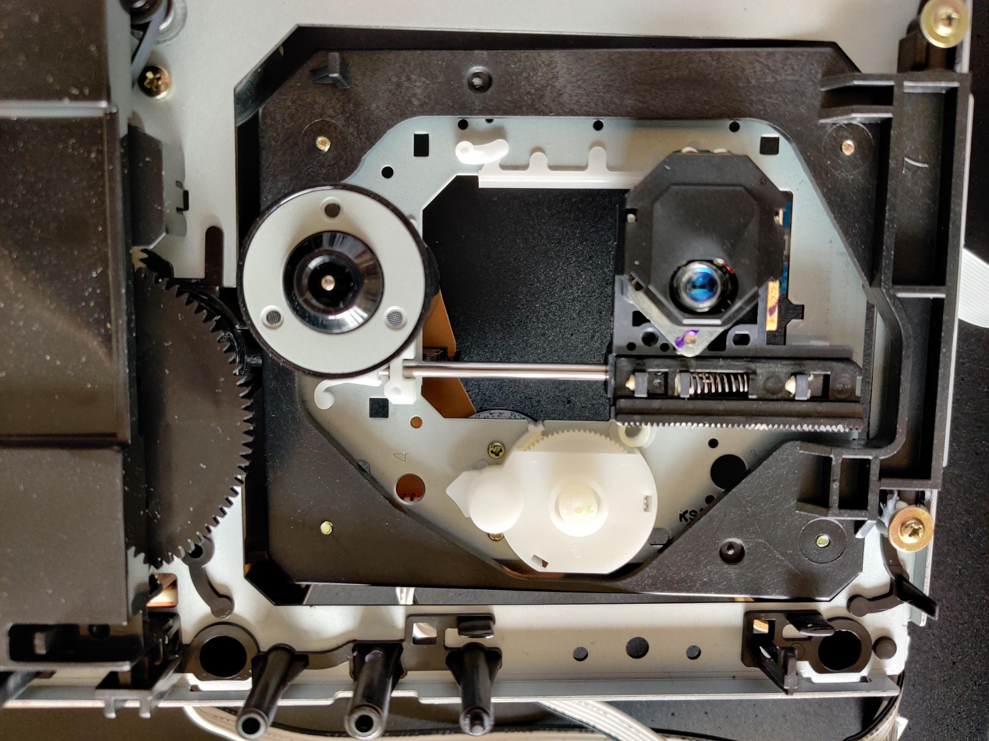

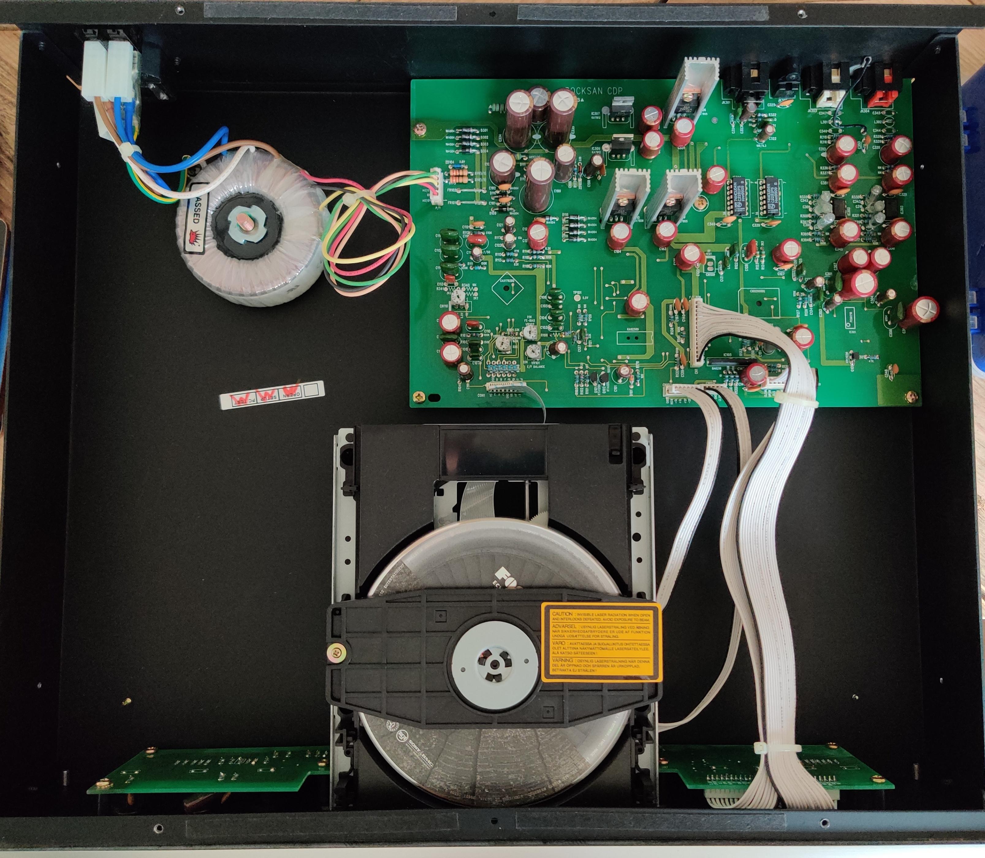

I have attached a pic with the cover off before I realised I left the CD in :boggled: , and one of the mechanism.
So update - I think that ball bearing may actually have been a tiny ball of solder, its not magnetic and in some photos looks to have a tiny flat spot! is this a common thing? Seems odd but it looks like such a small bearing and I cant see anywhere it would have come from.
Anyway i've cleaned and re-greased the gears in the mechanism and its all back together and moves freely. Its playing at the moment and fingers crossed it's not jumped yet! Ill update again if it does!!

Bits of solder are not unknown so if that is what it is then its nothing to worry over.

Judging from those photos, that is one of the cheaper-style CD mechanisms.
Those white plastic gears are a dead giveaway.
In the shop, we used to call them " recycled milk-bottle plastic", and they are found in lots of things, VCR's included.
I suspect that the motor shaft gear may be split, which seperates the teeth at that point, and when meshing with the larger gear, hangs up due to binding.
I've seen this plenty of times, and the only solution is to replace the motor gear.
Remove the shroud over those gears, and with a magnifier, inspect the motor gear carefully.

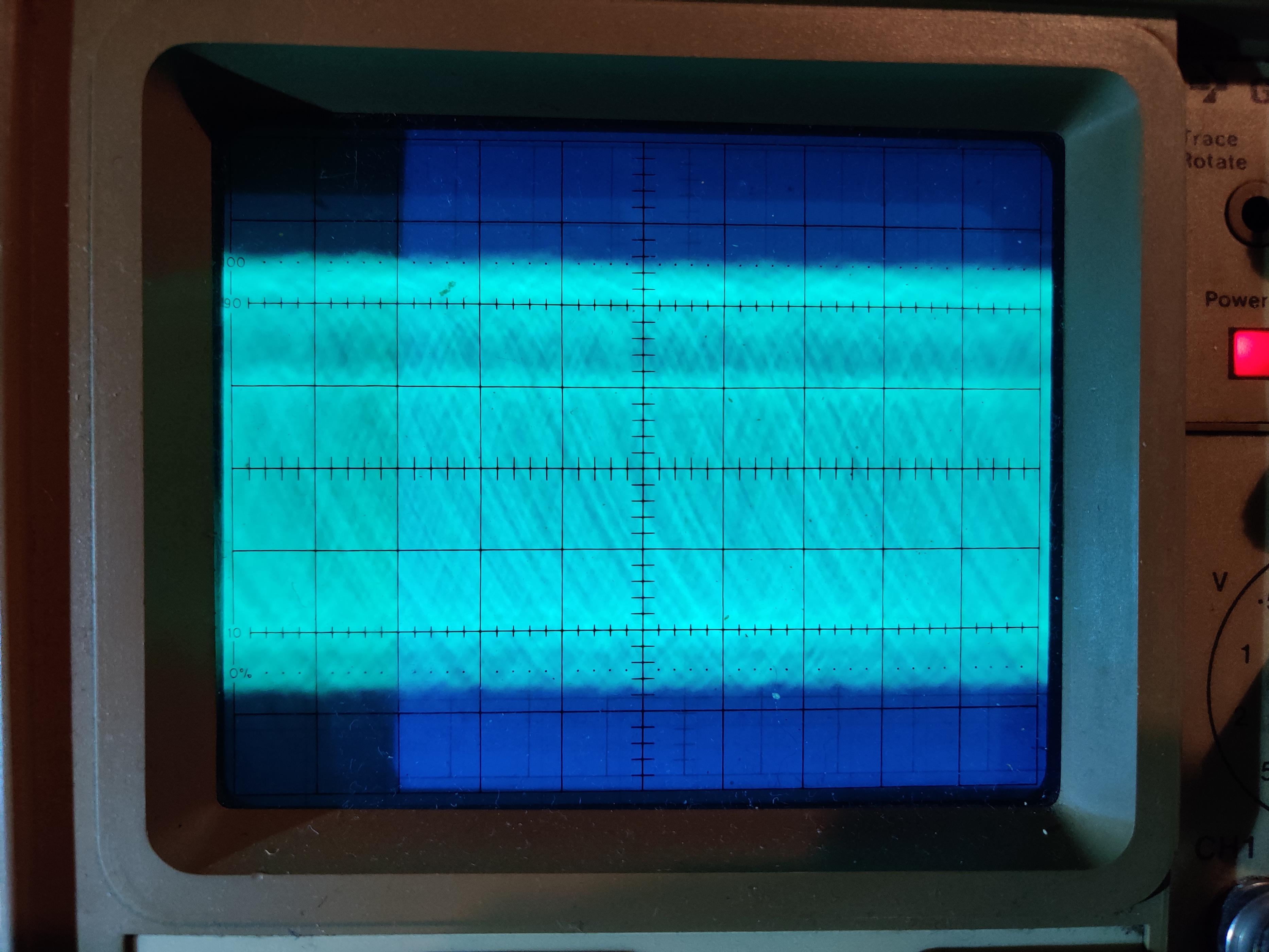

It's been a while since the last post but I finally got around to getting the scope attached to check what's going on.
I've attached the 'eye pattern' but this is as clear as I could get it . I've not seen one myself before only images of others online and this one looks pretty messy in comparison?

Look at the images I posted in the link in post #6. The eye pattern in those shots is a good example and shows a clear and steady pattern with no horizontal or vertical jitter. It should look just like those on a scope like yours.
Is your scope triggered correctly? AC coupling and no HF reject selected.

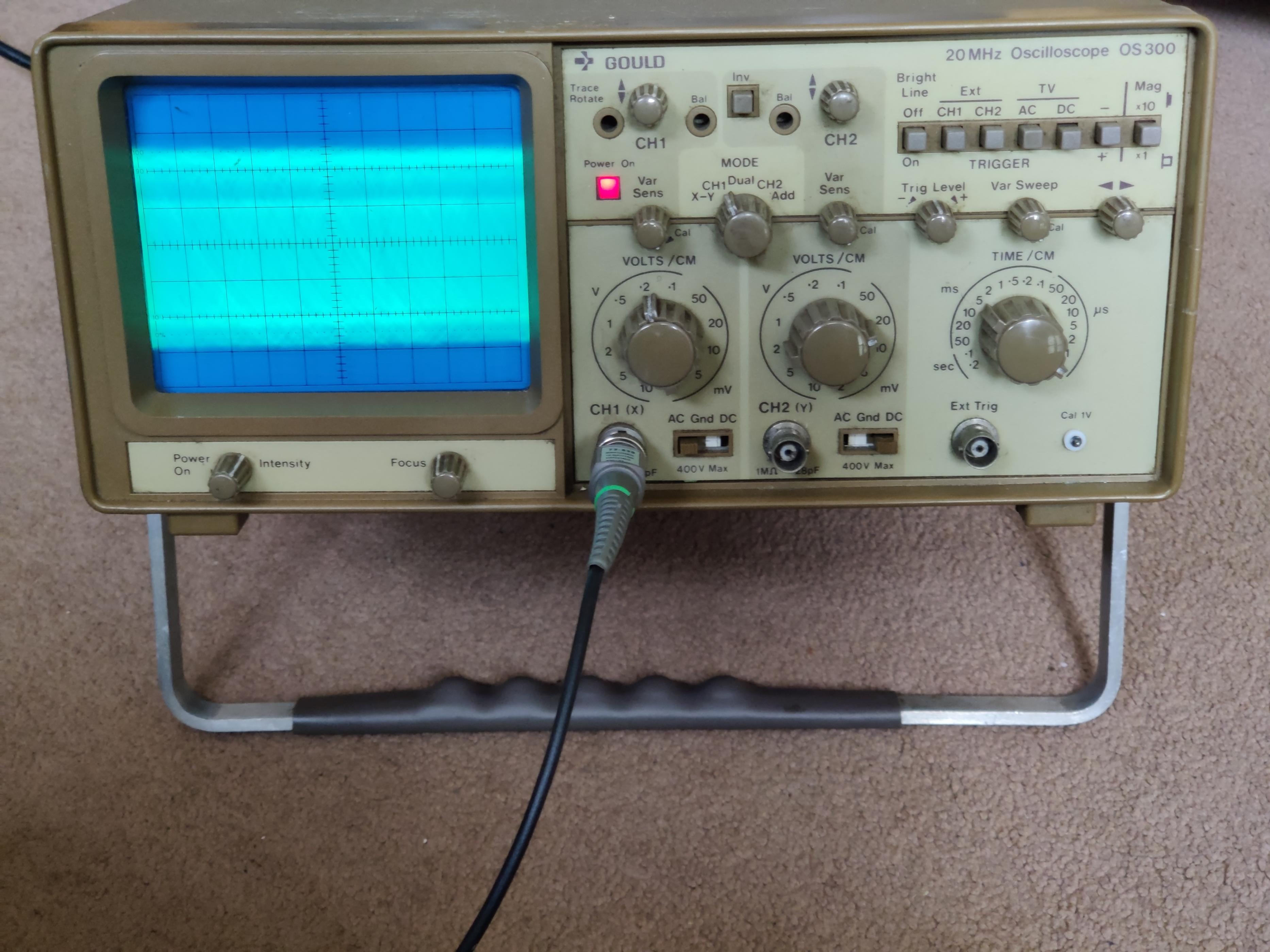

@Mooly - I should have taken a better picture with the scope dials showing! - It's an old Gould OS300 for reference - I'll set it up and take another photo.

The joys of working from home at the moment... Just hooked it back up to the scope. There is no HT reject that I can see, but set to 0.5 microseconds and 0.2V on AC.

The timebase speed is correct (0.5uS/div)... it should look way better than that.
The trigger switches don't have HF reject but have a 'TV' mode which was for old fashioned analogue TV and its frame and line sync pulses. So you want those switches NOT selected and also select just Channel #1 as the trigger channel.
If both CH1 and CH2 are pushed in then it selects external trigger which you don't want.
With the switches correct see if very carefu adjustment of the scopes trigger control will lock the waveform. If it won't then you can also adjust the 'Var Sweep' knob a little to see if that will get it to lock.
Hi Mooly - All switches as you suggest but still no luck clearing it up.
the 'var sweep' does make a difference to the scope but for the worse not better - it feels as if the scope needs another step beyond 0.5us to get a lock?
Trigger control Makes no difference to the waveform at all regardless of which trigger Chanel is selected 🙁 ..
Do you think I've perhaps gone and got myself a faulty scope?
