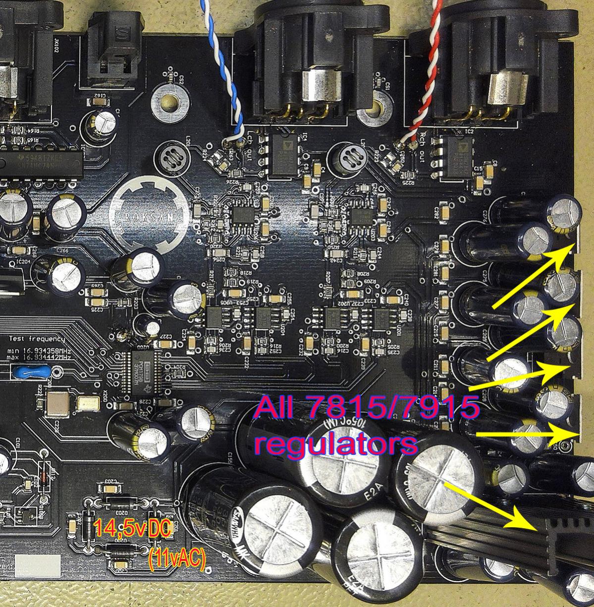

The post DAC circuits on Black CD player it are designed and build to be powered by standard (LM7815/7915) fixed regulators. The I/V stage it should be powered by +/- 15v regulators, as the buffer opamps as well. I appreciate this design as a good one, being able to ensure a high quality output signal. Well, maybe not just the best choice for these fixed regulator devices, but anyway, good enough.
The problem here is that all these regulators mounted on board (see picture), it get on their inputs 14,5v. On the output pin of these regulators I measured +12v and -13v... This is very wrong! All these regulator devices it not regulate anything!

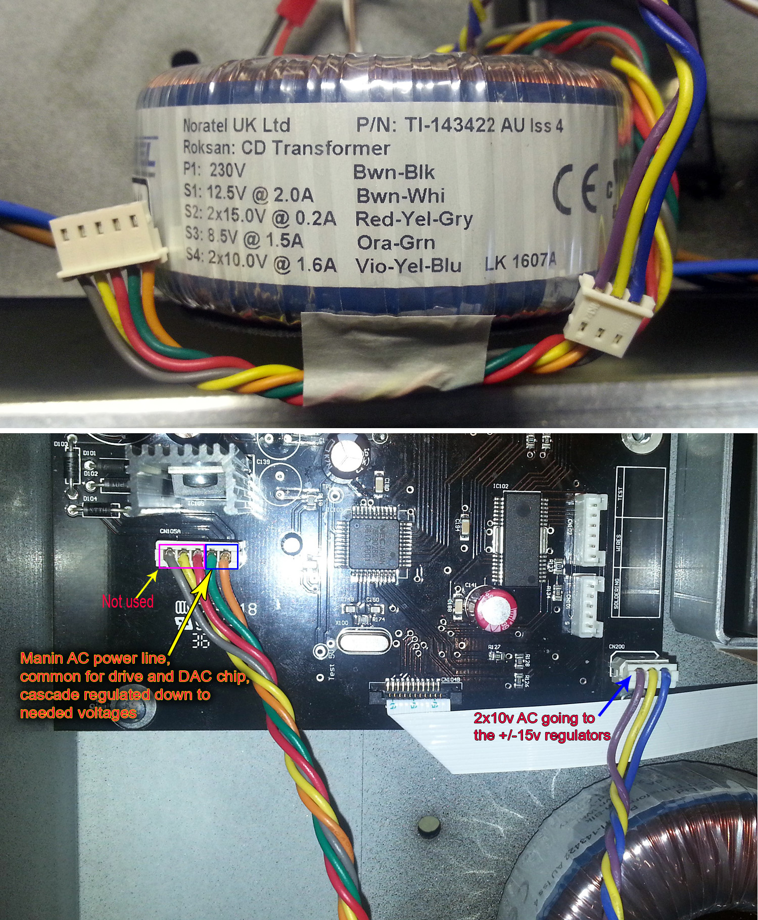

The toroidal transformer used to power these devices it is not properly made to deliver the right voltage or power so that the 15v regulators get a higher voltage on their inputs (at least +/-17v unregulated DC), so to be able to do their regulating function. The consequence of this fault is the all post DAC opamps it are powered by fully unregulated DC.
Here is not about a possible power fault on board, which it may cause an over current, lowering so the voltage delivered by the transformer. The toroidal transformer it is just not made/designed to deliver more voltage on this winding output. Why Roksan have used a such faulty transformer? How it happened that nobody have measured the voltages in this area on the production lines (voltage test points are provided on board)? For sure this fault is not singular, being specific to a singel product. This is a production line or product design fault! I just wonder myself how Roksan it can sell out such devices...

I am very sure. Input voltage is in this case, 230v. The device is well functional all point of views. The only issue, which it seems to me, not being specific to only this device, is that the original power toroid transformer it output (on load) 2x11vAC, which it result (on load too) +/-14,5vDC on the inputs of the 7815/7915 regulators (analogue section - post DAC). Please note that the currents needed by the circuits loading these lines, are quite low (into few teens mA). All other power lines voltages of the toroid, it are as it should (the same for the rest of power DC lines).
In this reported case it is either the toroid transformer wrong for this winding, and this it should be cached by the production line testing procedures. Or there is a faulty population of the PCB, with wrong voltage regulators, which also this it should be cached by the device testing procedures...
The fact is that the +/- 15v power lines of the analogue circuitry (post DAC), in Roksan Balck CD player, are first not 15v at all (measured +12v and -13v), and second, these lines it are not regulated, but only filtered by the planted capacitors... All the regulators mounted on board for this section it no do their function, because it are wrong powered.
It could be interesting if another owners of this device may open the box, then doing a simple measurement on the specified test points.

Some more details...
Please note that the S1 marked winding on toroid, it is going to the front panel power system.
Question: it is right having a main common power line for both noisy drive motors and its controllers, optical servos, and the DAC chip both digital and analogue sections (all together)?

Some words about Roksan design of the post DAC analogue section.
The differential outputs of the DAC chip (PCM1798) it goes into differential I/V circuits (NE5534). Then the differential audio signals are converted to unbalanced for RCA outputs (OPA134). Then the unbalanced audio signals goes into an unbalanced to balanced converter, to be outputted to XLR (SSM2142).
Each analogue processing section it have its own 15v regulator (+/-). The +/-15v regulators are powered (input) with 14,5vDC... Measured on TP+/-15v on PCB: +12v, -13v... Filtering caps on input/output of the regulators - 330µF.

Hi, difficult to judge but can it be that S2 and S4 are (partly) interchanged or that a thinking error was made in that section?
You can solve this clear design error by adding a 2 x 15V toroid or even better an R-core transformer (if there is space). Or, as you already remarked, by replacing all 7815/7915 for 7810/7910 but make sure you order those from Onsemi (lower noise). There is way more than enough headroom with +/- 10V. I don't think Roksan will respond as this is embarrassing but not dangerous.

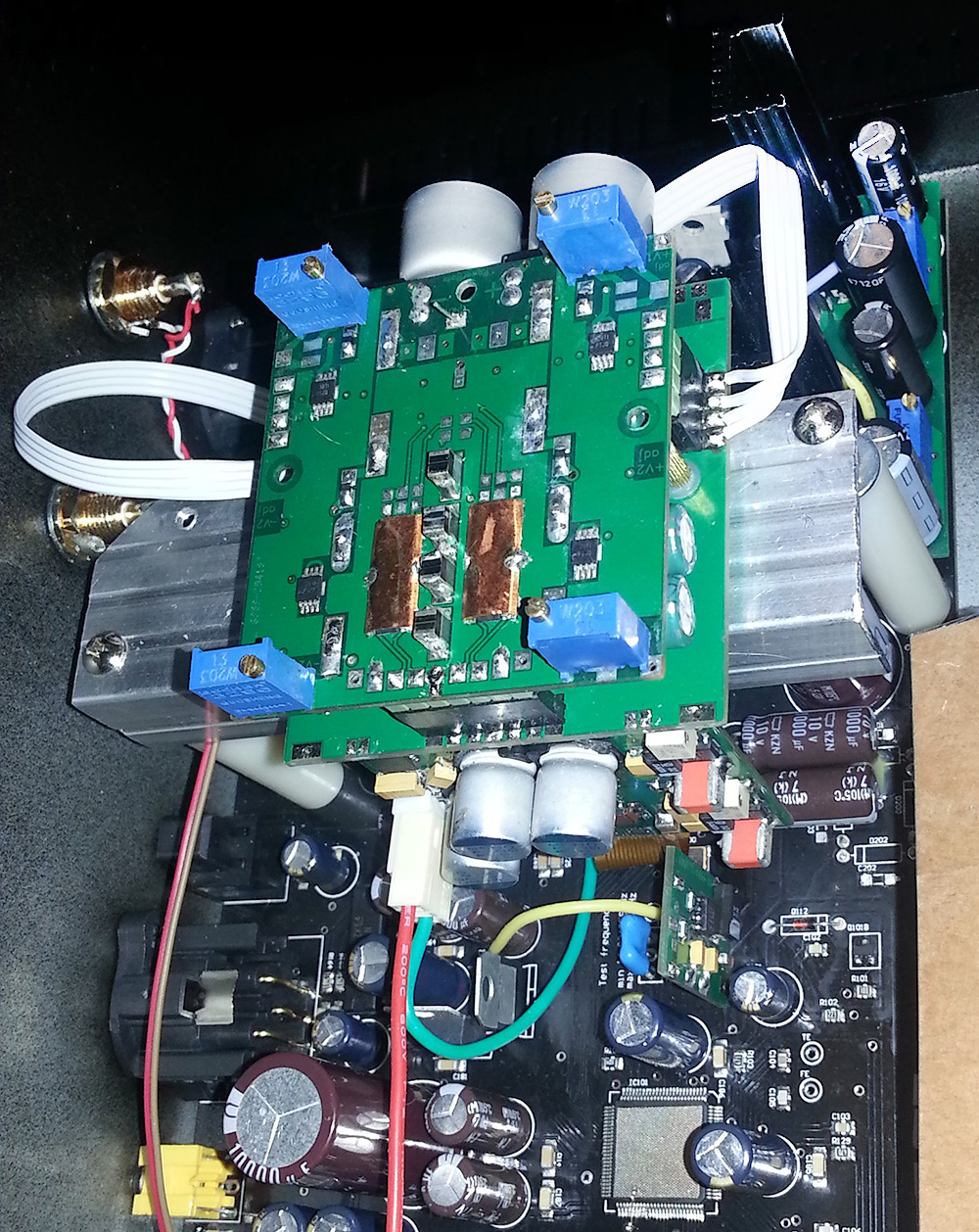

The main improvement approach for this device it was adding an complete chain DAC and post DAC circuits, and dedicate it to the XLR outputs. The original DAC/post DAC design it remain functional only for RCA out (with corrected +/- power rails issue as well).
The modified device it have now two DACs working in parallell, sharing the same digital interface (one for RCA and another for XLR output). Well, some more other improvements are done as well.
In my opinion, the power system for this DC player model is designed quite unprofessional.
I can only say that the improvement for the outputted audio signals for this upgraded device, is just dramatic.
