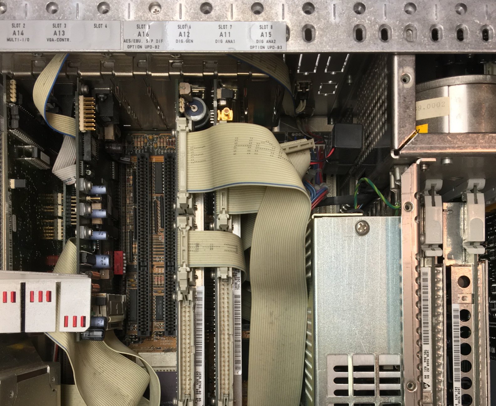

So here are some of this pics, and I've got more questions.
Does everything need to be removed to replace the mother board
capacitors that fail?

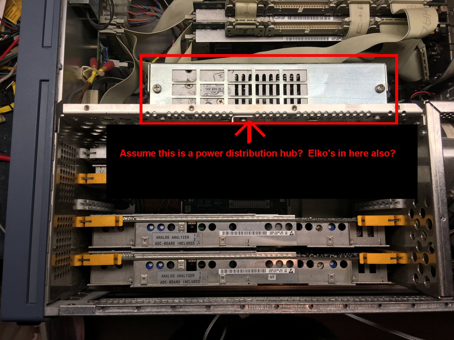

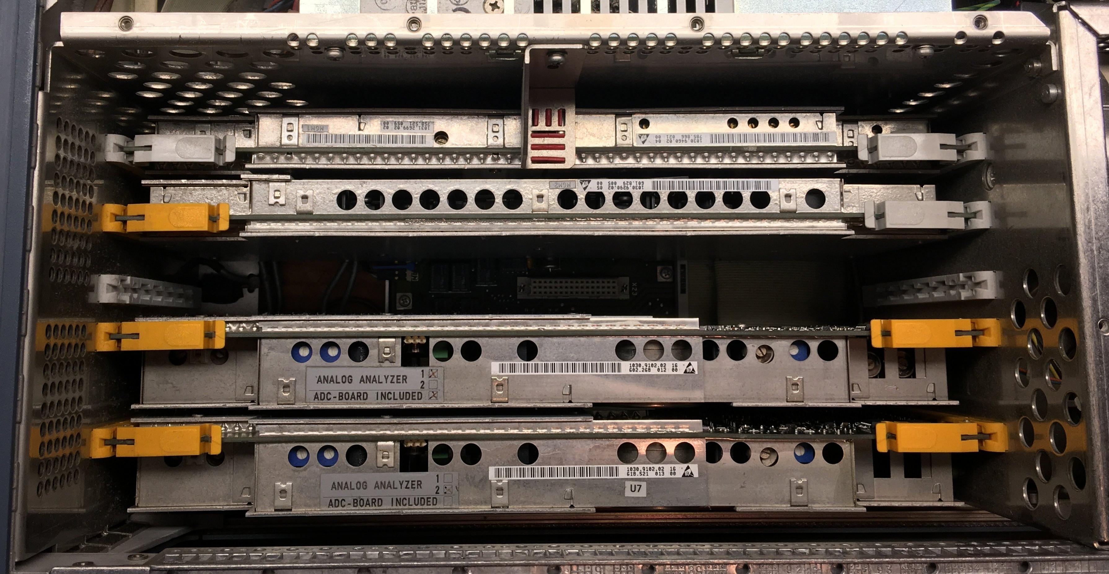

And, while I'm in here, should I pull out the Analog analyzers and
look for caps in there also? Are ELKOs in there too?
I'll post a a better motherboard pic so the plugin boards
align up properly.

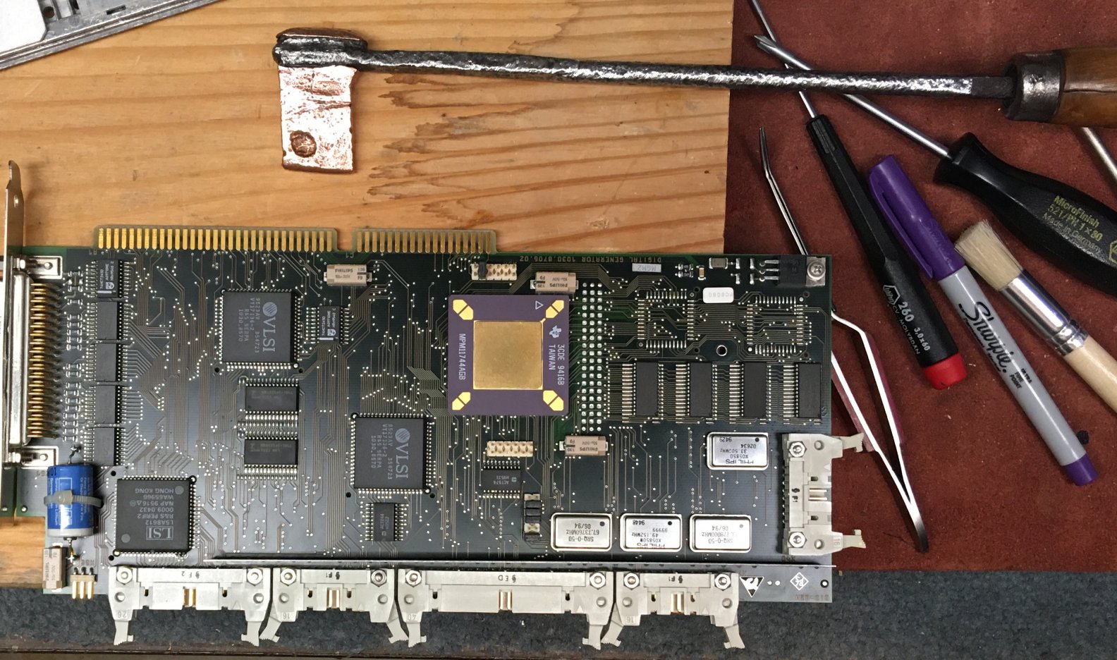

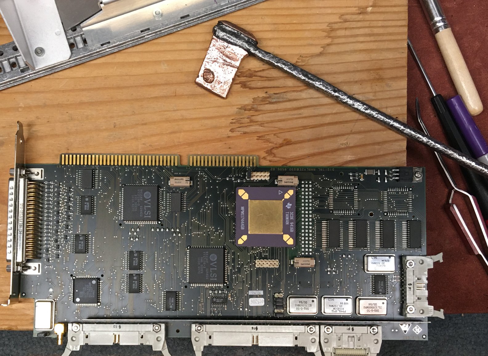

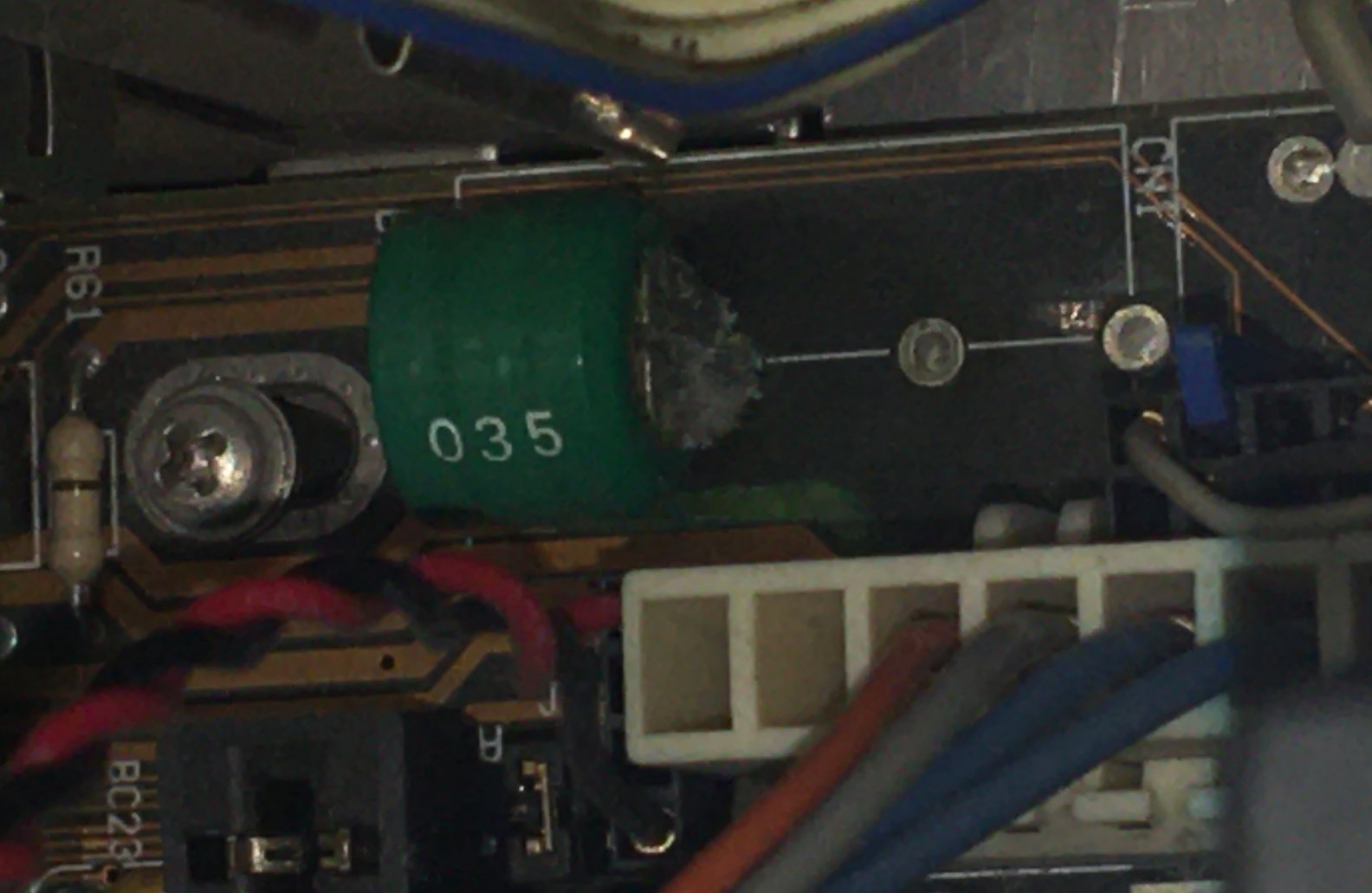

Update with the following:
Leaky Green Battery, Bat 1 = 1.124v. It says 035 on it.
Looks to be 3 stacked batteries. Any one know type?

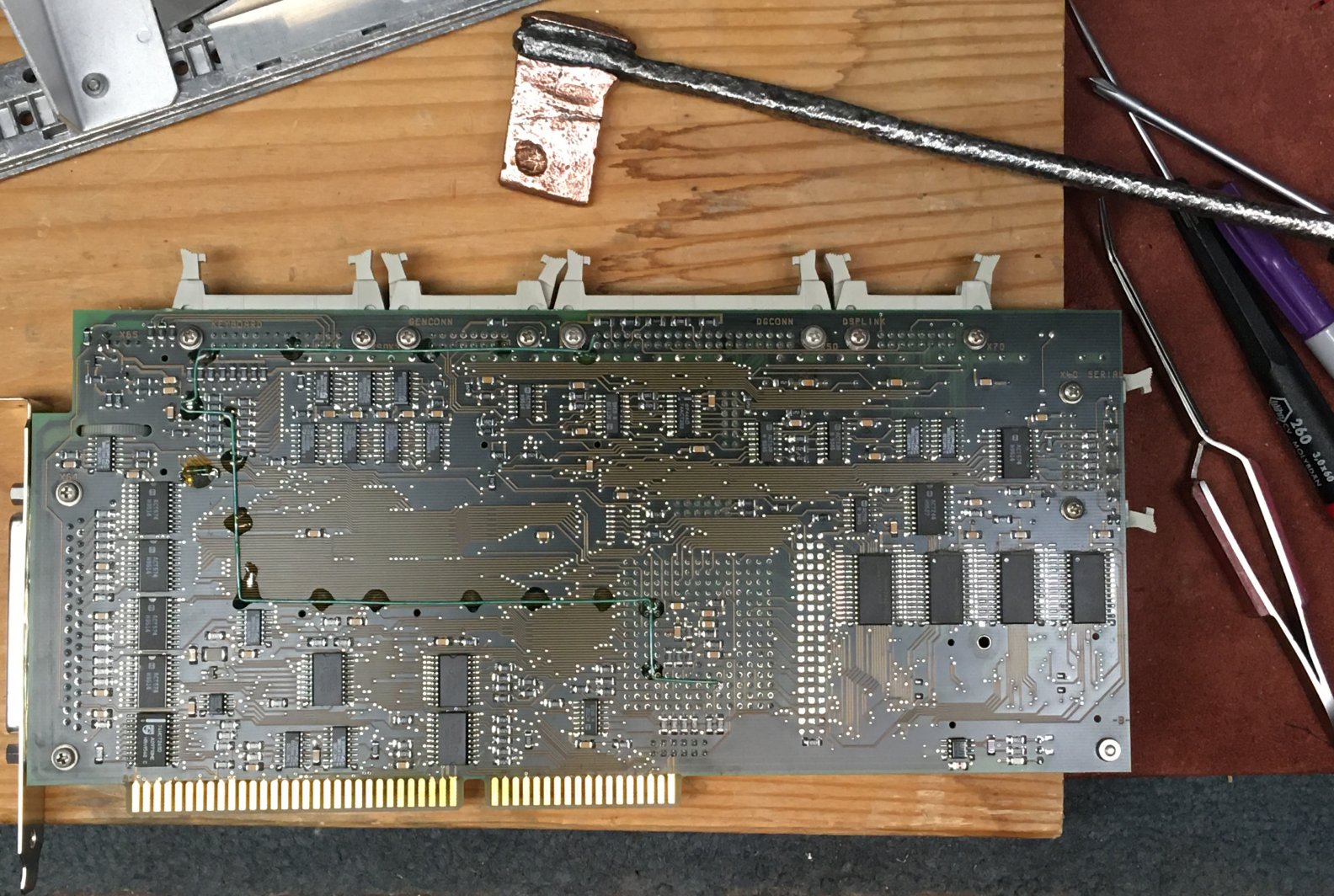

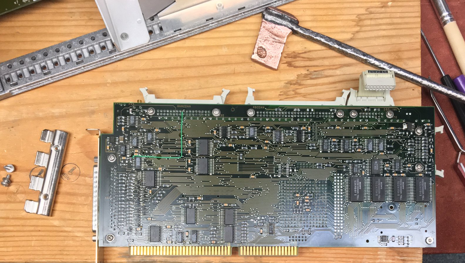

Big blue battery on Digital Generator board (V12) dated 10/95 = 3.702V.
Then some pics of both digital boards front and back so everyone
has a reference as to what they look like.
V12 is the Digital Generator board.
V11 is the Digital Analyzer board.
Note: They both have fixes on the rear of the boards
that didn't make it into the final board design.

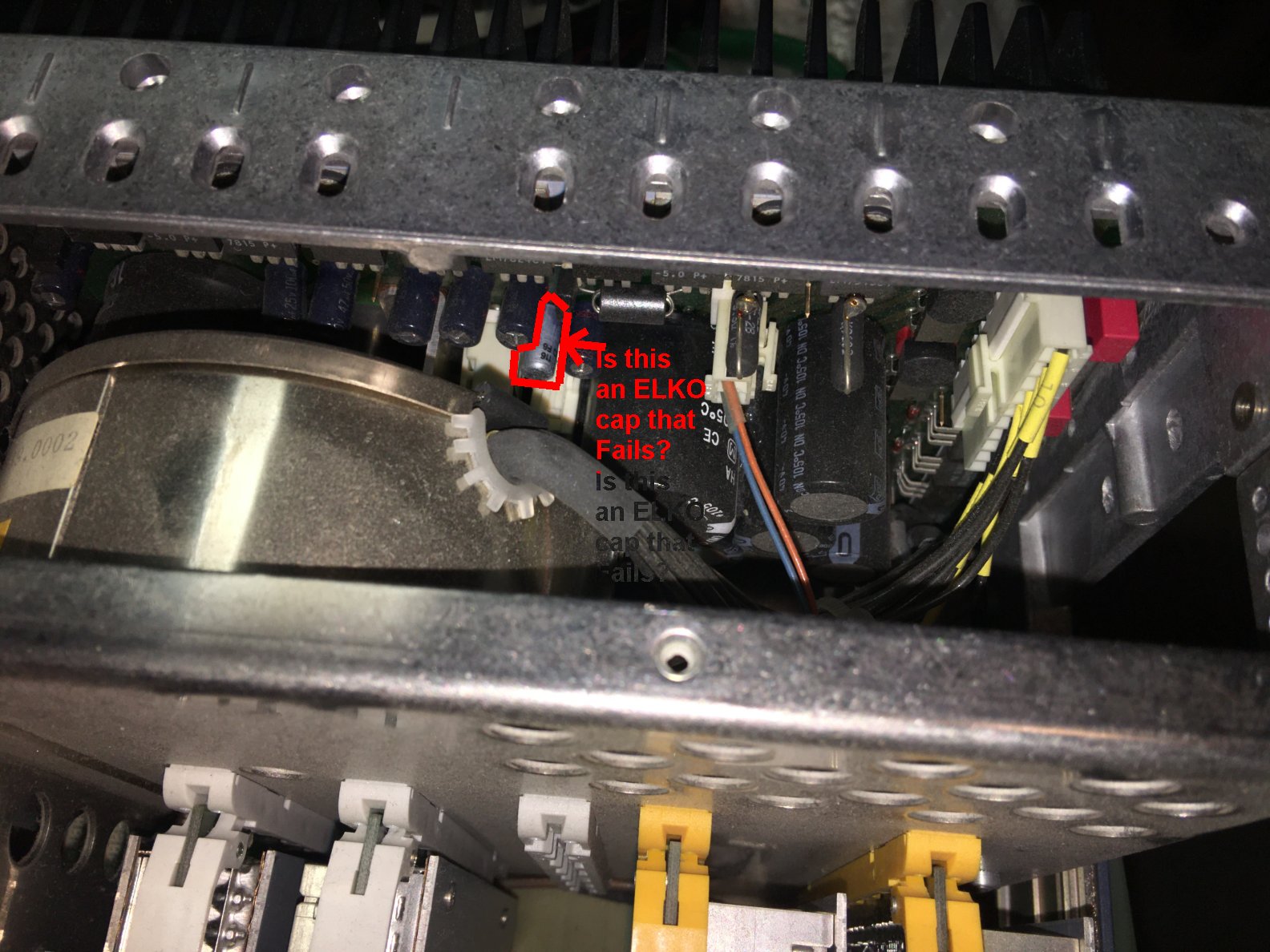

On the mother board I only see one electrolytic cap.
Is that they only one?
Is that also an issue?

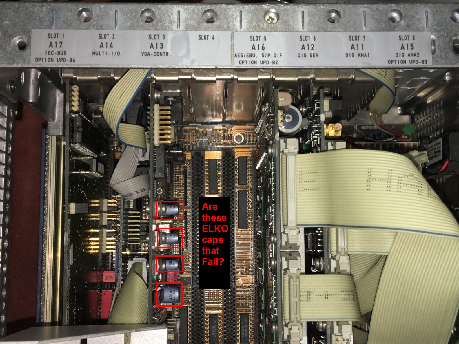

SyncTronX,
Your motherboard must be the same one as mine.
The board is fixed by cards on ISA bus and a retainer on the edge of the board of the CPU side. I forgot the screw is fastened from which side but removing the screw and slide it, you can pull the motherboard from the left side of the instrument, opening of the chassis. I could not just pull the board upside why there is a PSU module for the motherboard (which you wrote power distribution hub).
Then, the leaked battery. This is a typical symptom on vintage computers those days. You must remove it and clean the alkaline around it. I just used water and alcohol, but some vintage computer fans use a kind of vinegar.
The electrolyte corrodes copper traces and some of them were lost. I soldered jumper wires to repair. Yours also looks like have darkish corroded traces. One of the traces will be the supply to the ISA bus, so it may be the cause of the malfunction.
Next, the battery replacement. Actually, you don't need to replace the green one. UPD has another battery, half AA size non-rechargeable Li-battery, mounted on chassis and electrically connected through wires. Mine has been low voltage so I replaced it by AA size Li-battery (because I could get it cheap) but a typical coin cell may be OK.
Thanks Sinja,
I'll remove the mother board which I think has one screw in the center
removed from inside the UPD. I'll do that later on
then removed that 035 battery from the board and clean it up.

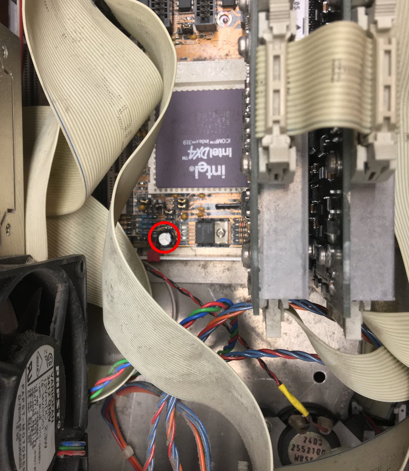

On post #94, pic 3, on the left edge of the board is Big Blue = 3.702V.
I'm guessing that keeps the Digital Analizer memory or something.
Where is the other battery you mentioned in the chassis?
I've looked but have not found it, yet, the one that's velcro attached?
So, are those the ELKOs that go bad in these units that I've highlighted?
Or were ELKOs brown blob cylinders and not the light blue caps?

I've removed the two large boards I'll have to look in the corner where
it looks like two additional boards are. Checked post #93, pic 1.
Three boards are there:
Slot 1 A17, IEC-BUS Option B4
Slot 2 A14, MULTI - I/O
Slot 3 A13, VGA-CONTR

I found a mess on SLOT 3. I think R&S taped up two large pads on the reverse that
weren't being used, along with a pair of diodes. The sticky stuff ran down the
board into the slot. It also migrated to SLOT 2 board and infected it,
the red 4 pin switch and some other stuff.
I can't get it off my hands at the moment. Will try various solvents later on.
Film at 11.
Post Script -- QUESTION it occured to me that the "ELKO" isn't a brand name,
rather it is jargon for "electrolytic capacitor"? Holy smokes folks, it would be nice
if we'd include the definition before or after first use in a thread.
Electrolytic Capacitor ([ELKO, common use in the EU], [Lytic,use by some
in the Americas]). There is a lot of these Lytics populating the various board,
and The analog power supply board along with the SMPS in the center.

I found the chassis battery, on vertical mount, and it feed the mutha board, right
where the SMPS connections are also.
I assume it's alright to removed the connections as the important stuff should be
on the hard drive. Maybe the batterys only save the current configuration of the
boards.
Film at 11.

- Design & Build
