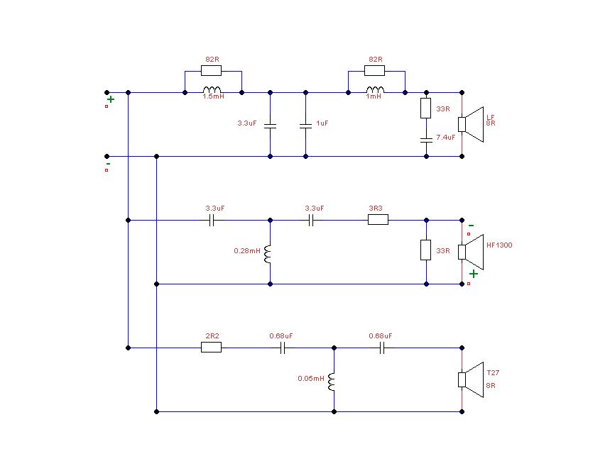

Hey guys I've been searching for these Roger's studio 1 for a while and I'm pretty close..I have the original cabinets and speakers but no crossovers.
I have emailed Winslow and falcon with no avail.
Can anyone please that has these speakers write up the schematics.
Or do you guys recommend a crossover?

The Rogers Studio 1 has a heavily populated circuit board.
030.JPG - Google Drive
I haven't had any success in locating a schematic though.
If you wish to consider taking the minimalist approach, you could base your crossover on Russ Andrew's 'upgrade' to the Spendor BC1.if I cant get a schematic for the Roger's I will go the spendors xover

I dont have a crossover at all..I would need to make a new one ..and I thought copying the spendor bc1 would be my only option
You could invest maybe $200 in buying some test gear, make your own measurements, then design your own crossovers.

I had a pair a while ago. At one point I wanted to change the caps so I examined the crossover and drew this schematic. I must say some of the resistors didn't seem original so I can't tell if this is 100% accurate. There were probably some revisions down the line, although these speakers had a nice and pleasant sound.
Have fun!

Wow great thanks..I'm going to start with this
@ jozhaa - looks like you've filled a hole in the market there - I can't find a schematic anywhere else!
@ venaka - Before making jozhaa's crossover you might like to test your speakers using the simpler crossover I mentioned earlier.
Wire the midbass direct to the speaker terminals, put a 2uF capacitor in series with the HF1300 and put a 0.47uF capacitor in series with the T27.
This could reveal any driver problems before you commit to building the full crossover - just a suggestion!
