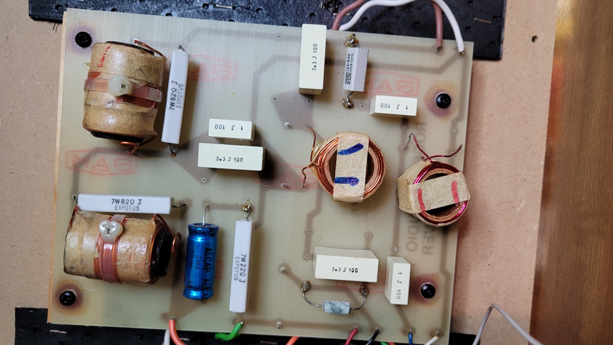

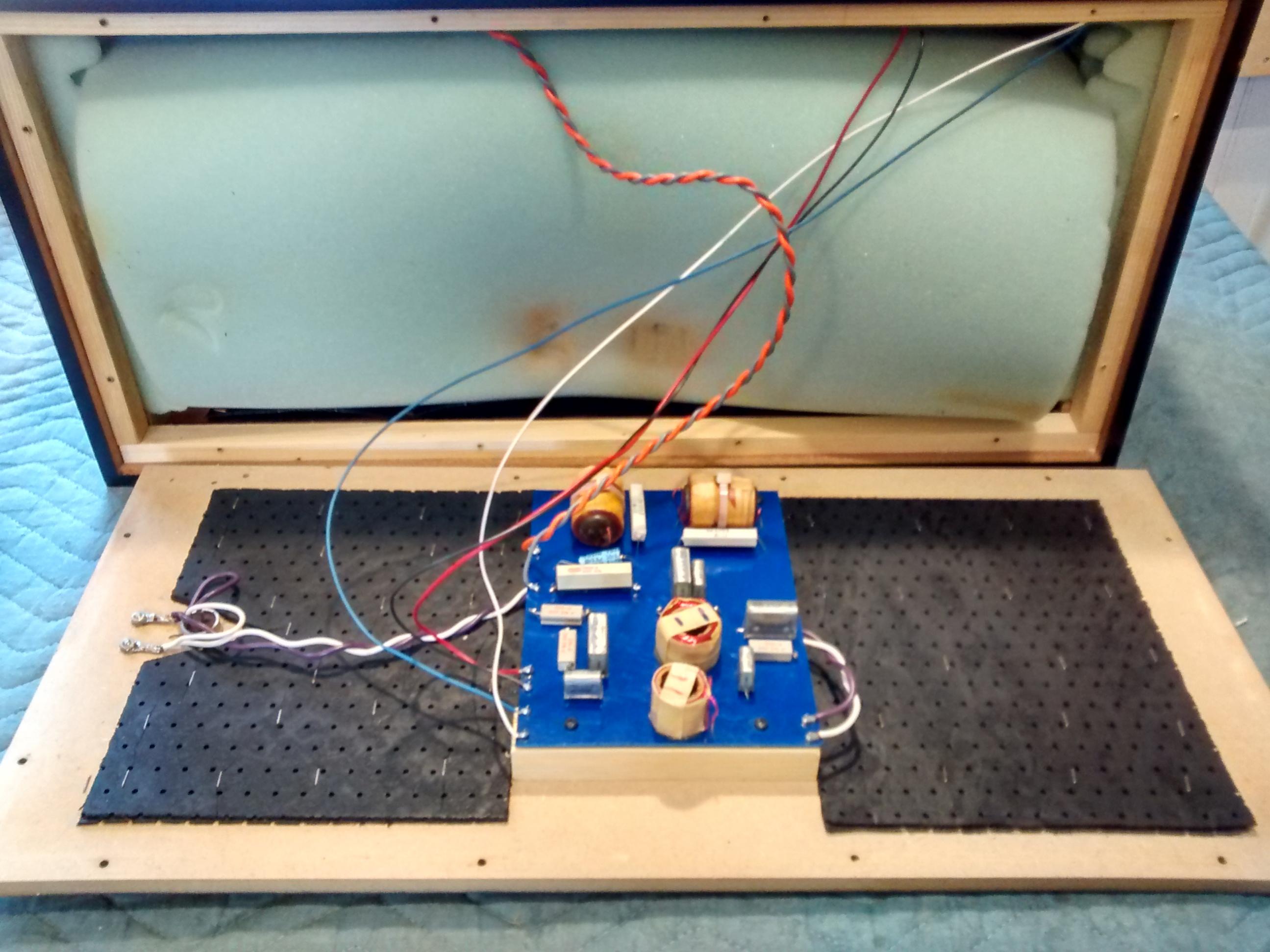

Brought a pair of Rogers Studio 1 they were in fantastic shape cosmetically everything on the outside looked good as new...
When removed the backers to have a look inside found that one of the cross-over boards had been played with some of the resistors were missing and or bypassed. [One owner but he had passed away so no asking him]
They sounded Ok the one with the missing resistors sounded better to me...
The other had been played with but the parts were all there just not original.
So decided to replace the boards so both were the same as intended from the designer.
Sourced parts from Germany and Canada.
Audyn MKT radial / SCR audio capacitors and Mills and Kiwame resistors.
Some of the caps were different ratings board to board.
One had two caps at .68uf on one the other 1uf in the same place so changed them all to the same value of .68uf.
Things seem good the speakers both sound clean and clear so really happy with the way work.

Studied different images of cross-over boards that others had posted online from the Rogers Studio 1 series
Over the years there were different board configurations with different components and layouts. Mine shown from 1980
The one thing that kept constantly showing up and somewhat confusing was the use of different capacitors or resistors being used varied in rating from board to board taken from a matching set of speakers.
Either tolerances of the components were/are so big that small changes in capacitors rating doesn't make a difference least to the human ear.
So the manufacture buying capacitors in a box of a thousands decides that since its a non issue uses them up as stock allows.
The devil is in the details as they say...
