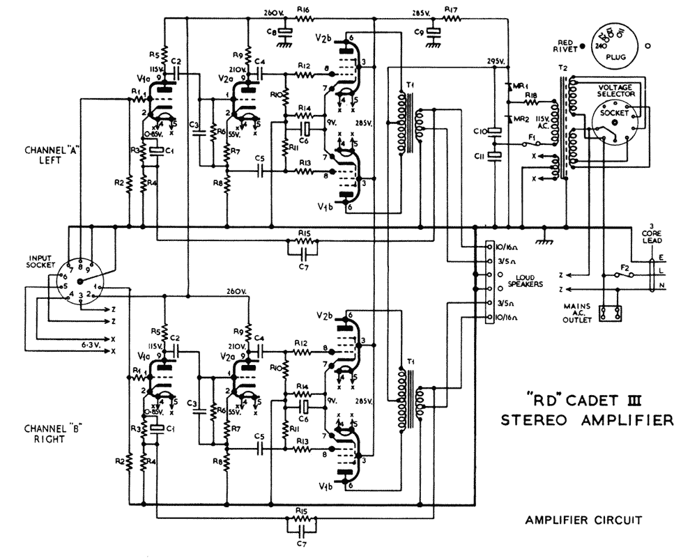

First off, thanks for the replies - was about to accept defeat and take it to the shop, but I'll have another few goes with it - it's half the fun after all.
To answer a few of the questions:
1. Have cleaned the valve sockets with pure alcohol and contact cleaner and the pins seem tight.
2. I have localised the problem to be in the final stage of the amp, following the "debugging" approach Gary (rotaspec) suggested. Only one channel is problematic.
3. Banging or tapping the amp clearly affects the scratches and pops
4. I have replaced nearly all capacitors in the amp (a couple of polysterine ones I could not find a good match for were left in, but these are nowhere near the final output stage)
5. Have not replaced any of the resistors, as they all measured to spec - I guess this is the next step?
6. Grounding is indeed though multiple chassis-fixed rivets - what do you mean by "cleaned up"? Just take all the old solder out and re-solder what is connected to the point?
7. With regards to the potential for cold solder (not to be disregarded as my soldering skills are far from great), how do I really diagnose this, other than de-soldering and re-soldering parts and trying again?

I know it's a sacrilege & you probably don't want to hear this but I had a Rogers Cadet III working fine & I modded it to a Baby Huey design (Gingertube) without too much modification needed - what a difference it made! Original Baby Huey used ECL86 tubes just like the CadetIII
BH mod is something I may do in the future. First I want to have some time listening to the stock Rogers without the clicks and pops though, so that I have a good reference point. Do you have the schematic for the ECL86 version of the Baby Huey btw?
I found the original thread http://www.diyaudio.com/forums/tubes-valves/49395-partial-feedback-amplifiers-5.html#post552739
If indeed the scratches and pops are coming from the final stage, start replacing the resistors there. You can replace resistors one stage at a time, and as kevinkr noted, wait for the next one to fail, or do them all. I like to know what caused the problem, but a shotgun approach will fix it quicker.
In terms of solders, I have a 60W iron I use for stuff like this (more is even OK). Go to each solder joint in that stage and melt the solder until it reflows around both parts of the connection. It takes practice, but in this case it takes heat too, especially with chassis connections. Use lead solder for goodness sake, it is far less likely to create cold or intermittent solders.
If you're on a roll, replace all the anode resistors. Carbon comps add "extra noise" on top of thermal noise when they are passing DC like in a tube anode, and to some extent cathodes (esp. cathode follower etc.). The sound will be much more accurate, and the noise floor lower. This is of great benefit at inputs especially. Grid resistors are actually better as carbon comps unless you suspect them.
Tap directly on each coupling cap and bypass cap with a "chopstick" or insulated screwdriver. Sometimes caps develop intermittent shorts.

Once again, thanks for the feedback. I'm waiting for a delivery from RS today with all the resistors I will need to replace everything in the power amp - this is my project for this weekend.
One question if I may: In the schematic attached I could not find the right value for R14 (meant to be 130 Ohm). Can I use 150 Ohm instead?

After a long Saturday replacing most resistors in the amp section and cleaning up the majority of solder joints, I fixed it the cracks, pops and static! Once again, thanks everyone for the advice! The amp now sounds amazing with my lowthers (DX4s in early Acousta cabinets)!
Hum is still there to an extent, but this may well be something I have to live with, given the Rogers is at least 45 years old and was not meant to be the ultimate amp to start with.
Still have the R14 resistors I mentioned above to replace. Would appreciate advice on whether I can up the value to 150 ohm and what, if any, effect this could have.

Glad to hear you had success! No, unfortunately you cannot replace the original R14 with 150 ohm resistors as this will significantly shift the operating point of the output stage. I made this mistake many years ago in an amp I was repairing (after the initial successful repair) and was stunned at the deterioration in sound quality.. So if wirewounds are used you can probably leave them alone, and if not I would look for the exact value used. Some vendors do make 130 ohm power resistors, and you might also find them on eBay..
Two 270 ohm in parallel gives 135 ohms, which is very close to the 130 you need, certainly within the 5-10% tolerance range of resistors that would have been used originally.
