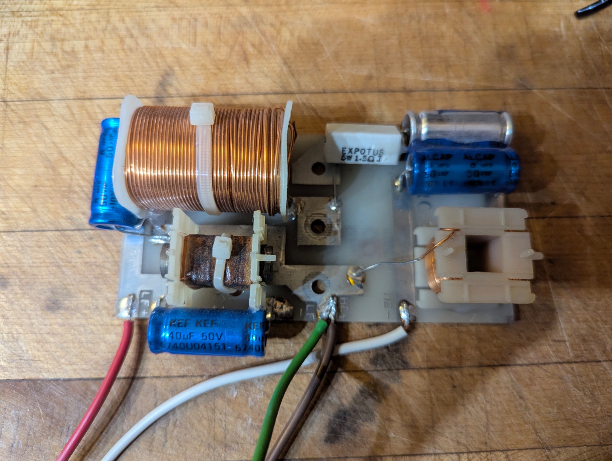

I removed the crossovers and purchased an inexpensive LCR meter (not for accuracy necessarily, but for comparative purposes) to test the caps. The woofer circuit consists of a 40 uF cap and an 8 uF cap. I isolated the caps and the 40's measured 41.2 and 41.3 respectively and the 8's measured 8.3 and 8.4. Acceptable values I believe.
The tweeter circuit is where the situation gets a bit difficult. To make matters more challenging, the cellophane wrapping on one of the caps disintegrated on both boards.
On the working circuit, the caps both measured 8.3 uF. One definitely is 8 uF and I believe that the other cap is also because what was left of the wrapper has a number code that matches the other. On the non-working circuit I do not get a reading for the 8 so that cap is definitely a problem. For the unknown cap, I get a reading of 4.3.

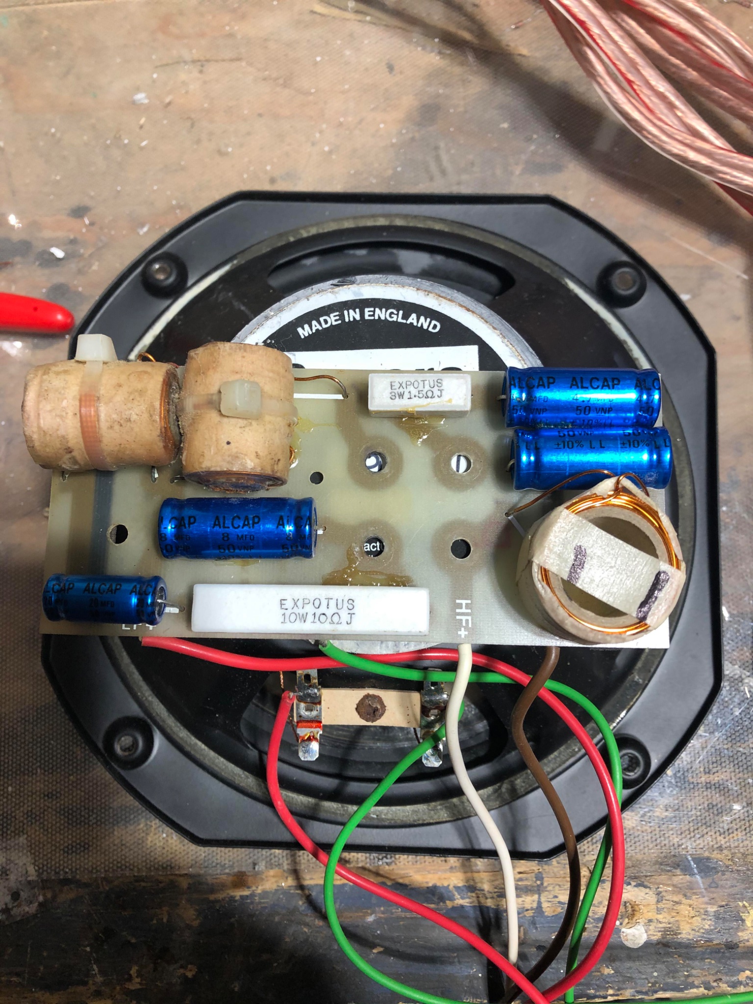

In my research prior to this post, in a very limited sample, I see that Rogers did have a tweeter crossover configuration for the LS4a's that was a 4.7 uF cap along with an 8. It is actually difficult to locate identical crossovers for this speaker - supposedly they had several different configurations. I am pretty confident that the working circuit consists of two 8's. Is it possible that the non-working one is a 4.7 and an 8? Or is it most likely that the 4.3 reading is an 8 uF cap that has failed.
Could a pair of matched speakers actually have different crossover configurations? In a repair video posted on YouTube, the pair being worked on had the same caps but one had an added resistor on the notch filter.
As far as the actual repair is concerned, my goal is to eventually re-cap the entire board. But to begin with, my plan is to recap the bad tweeter circuit and test it with the working speaker I have. I will then repeat the process on the working board so that the two circuits are identical. I saw Solen polypropylene type caps were now the recommended replacement with maybe slightly increasing the resistor. Does this seem accurate? If not, the original AlCap ones seem readily available -- if I can figure out the correct specs.
I am attaching two photos - the first is of my board and the second is of a LS4a crossover I found on the web.

It's unlikely they were different out of the factory, but these speakers may have an untold repair or modification history. It's sensible to try to return them to standard unless you have much bigger plans for them. Given the troubles and the age, I'd replace both sides evenly if possible.
In addition it may help to have the tweeter circuit to refer to. Have you considered drawing it before you begin...
Reactions: witwald
Looking at your Xover it is for a non biwire version, the web based find is for a bi wireable version.
Possibly it has a slightly different Xover due to a production or drive unit change.
Also worth noting that your inductors are air cored as far as I can see, whilst the others are ferrite cored or some such. Which may mean they have differing DCR resistance values. To measure what you have with your LCR means you probably have to lift one of the component legs to remove the rest of the circuits influence and then measure it. It would be nice to draw out the circuit diagram or find it on the web to use as a reference.

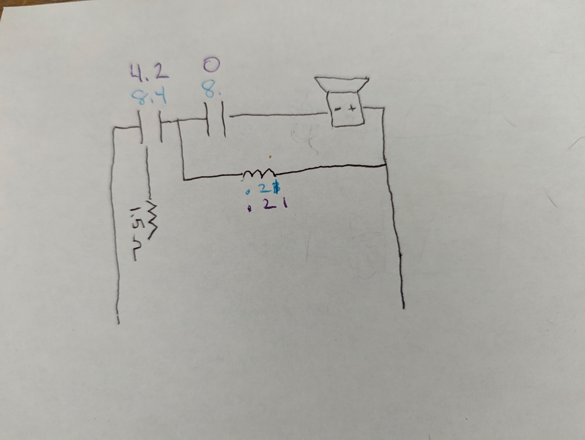

I attached a very primitive drawing of the tweeter circuit along with the recorded values. Go easy - as I mentioned this is my first attempt at anything speaker related. I have no idea where the 1.5 Ohm resistor belongs. It seems to jump between the tweeter and woofer circuit.
The inductors on both crossovers measure .21 mH.

So it is logical that both crossovers would have been spec'd the same from the factory? The 4.2 reading that I am getting on the one cap is probably degradation?

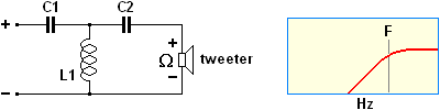

The two capacitors and single inductor would indicate a 3rd order high pass filter as shown attached.
I would think that both crossovers would contain identical components
It may be that the 1.5 ohm is a tweeter attenuating resistor. If so, it would be in series with the left hand capacitor (C1 in my attachment).
Have another look at the circuit to see if this is, in fact, the case. EDIT: It appears so to me.
It would appear from the evidence presented that C1 is 4.0 uF and C2 is 8.0 uF.
So 4.2 uF is a correct reading for C1.
EDIT: I've just checked on a 3rd order HP crossover calculator and C1 = 4 uF, C2 = 8 uF and L1 = 0.21 mH would be consistent with the requirements of the LS4a's HP filter.

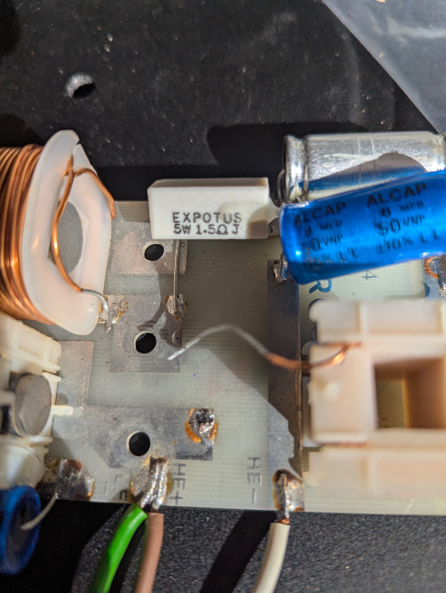

The 1.5 ohm is in series with the left hand capacitor as you describe. I am just confused by the second solder point connecting it to the woofer inductor (attached).
Is it likely that something caused a catastrophic failure of the capacitors and sound coil at the same time?

There's some confusion. The first photo is of my crossover, the non-biamping one. The second photo, as I mentioned, is one that I found on the web. I was curious as to why the same speaker model had several different crossover configurations. It was explained above that there was also was a model LS4a/2 that was the biamp version.
My working speaker has two 8 uF caps on the tweeter circuit. The non-working one's measure 4.2 uF and 0. That seems unlikely to be a factory configuration. I assume that they were once both 8's and either degraded or were damaged. As discussed above, it is possible that the C1 is a cap in the 4 uF range, but the C2 still has its wrapper intact and that is definitely an 8.
In a video on YouTube, the crossovers were also different -- one having an added resistor. The guy doing the repair mentioned that Rogers was known to tweak their speakers to match before leaving the factory.
