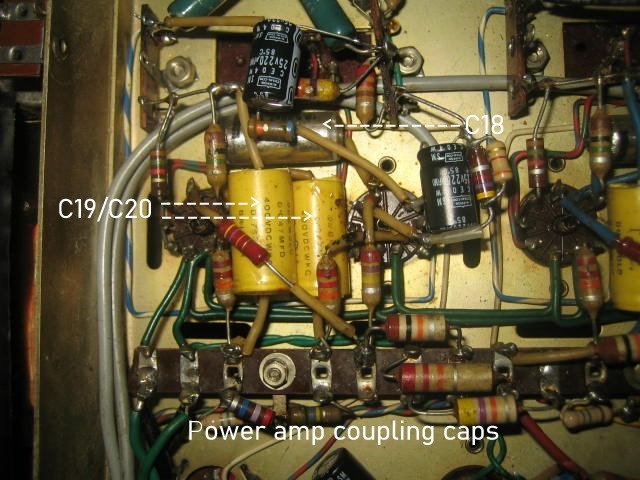

Hi DanyF from the UK.
Can I just tell you that over here the Black 'Hunts' Mould seal caps (in your pre amp section) have a ''Change on sight'' warning. They become electrically leaky and are better resistors than caps.
Likewise the yellow TCC coupling caps in the power amp section are not much better. I would replace all of them... but C18, C19 and C20 to preserve the ECL82s.
At least make sure they are not putting positive volts on the pin 3 grids of the ECL82s. They will have a short life if they have.

Hi Alan
To coret you - I'm not in the UK. I'm actualy located in Toronto Canada!
Now, the low voltage Lytics were @ fault - I canged them all w/ higher uF values per Geoff's advice. The Hi volt Lytics weren't shorting, just dried out of their inside chemicals = a common cause. That's why I connected new ones(w/ a bit higher uFs) accross them = no more hum = common practice, again.
The Grid caps in the ECC63 - I installed new onse w/ 5,000 pF instead of the 1,000 - again w/ the rcomandation of Geoff. In the process I also replaced the coupling capsfor the ECL82's w/ same capacitance - made w/ 2 in series in order to achive a higher voltage rating(I think 2 w/ 160v = 320v.

Hi DanyF,
Thanks, I fully understood you are in Canada, the greeting was from the UK, where I am based.
We have a lot of experience, here in the UK, with the Hunts 'Black' caps and the TCC 'yellow' caps. They are notoriously unreliable and I was just pointing you in a direction to at least check them.
And I'm confused, you say the ECL82 coupling caps (C18/C19/C20) have been replaced? But your completed pictures still shows the originals?
Best, Alan

Hi Alan
I'm sorry about being late answering you, but both of us = I & my wife have been busy planting veggies in the garden & in big & huge pots located on our huge(42') veranda in the back of the house. Even earlier today I've been planting - forced to stop due to the rain. Previously, I'd to till the soil in the garden. still have to plant & place seeds in the garden. &, lots of different cherry(black & red, yellow, orange, red) tomatoes plants have finally bore tiny plants. Also other big ones. I'm currently waiting to seedlings of extremely hot peppers.
Now, about C 18/19/20. I never said I'd replaced them - I think you're referring to the yellow caps. These don't leak & the appropriate voltages attest to that. However, I did replace the o/p caps of the ECC83 - just as much as the i/p ones = blue. Again, all the voltages match very closely for the 2 channels.
Regards, Dany & Judith
