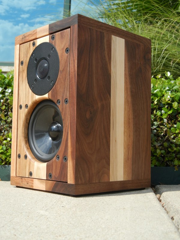

The continuum is pretty as cheap as possible. Jeff bagby have went thue 3 design using different driver before being satisfied with the continuum. It won the midwest 2012 event and pretty much anyone who heard them, or mostly any jeff bagby design, have all seem to be extremely satisfied (you can count me in as well).
Its hard to not be satisfied with the continuum, they really are high end. Besides the bass capabilities, I prefer the continuum to my three way system for sure. They are a pure fun speaker, musical, defined with a lot of details!

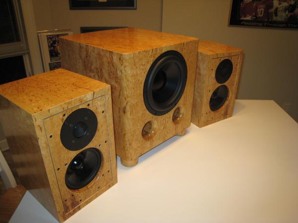

Clear and defined bass...ahh sealed speakers 😀
There is a DIY sub kit as you probably know, built around the original. But that was a long time ago, I believe it was ported. A sealed (or 2) might integrate a lot better with them.
I must say along with the high regards they receive I find there looks a smash, and the fact that they offer such sound and are so small adds to there novelty and charm.
They can be made to look quite high end and so good looking as in these other examples. If the builders ever get to read this I compliment you greatly on the craftsmanship there beautiful
