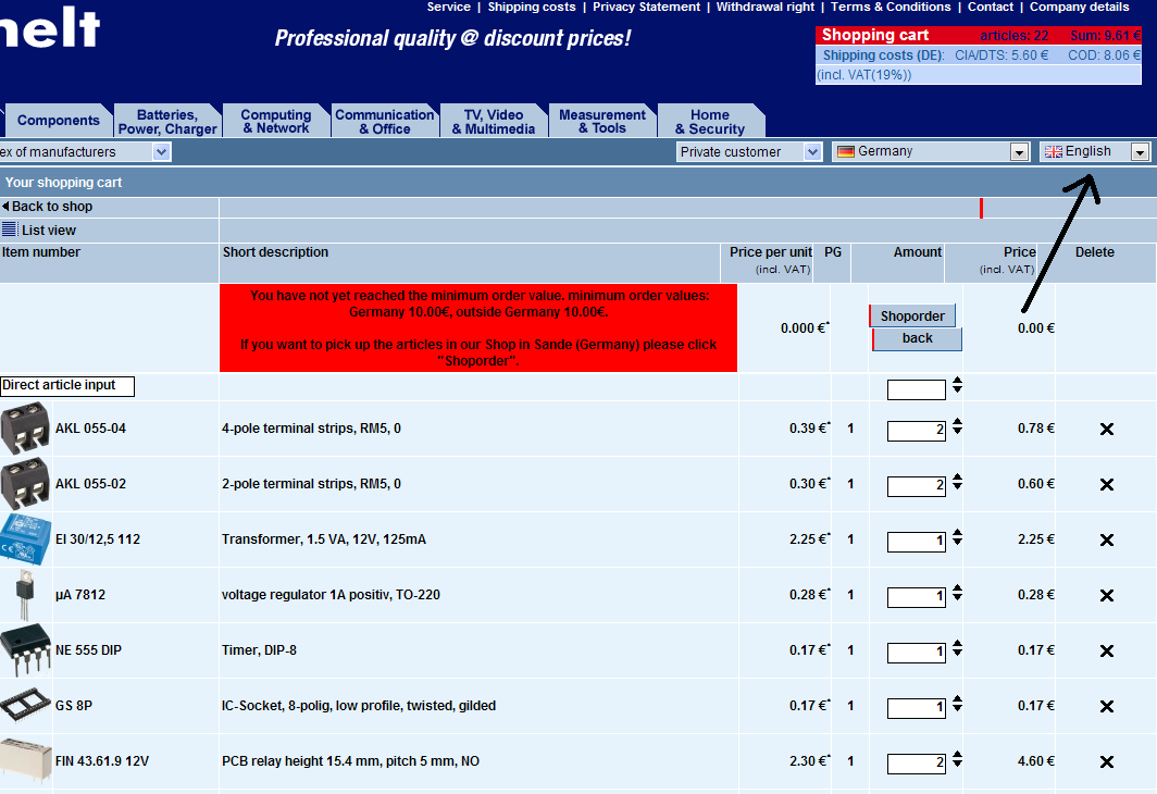

Gentlemen,
I have just finished the BoMs of the PCBs of my FC-100 group-buy offer.
Have a look at post #84 where I have shown a typical configuration of the FC-100 amplifier.
I have included the BoMs of the different PCBs in form of URLs.
When you open an URL, please change the language to "English" (as shown on the attached image).
This is the BoM of the FC-100 amplifier-PCB:
https://secure.reichelt.de/index.html?;ACTION=20;AWKID=565875;PROVID=2084
The BoM does not include the emitter-resistors, the MKP1839 / 1µF capacitor and the NJL transistors.
This is the BoM of the integrated PSU:
https://secure.reichelt.de/index.html?;ACTION=20;AWKID=565881;PROVID=2084
The two 10.000µF capacitors per rail are set up in a C-R-C configuration.
The resistor (0R1/5W) is not included in the BoM.
You can use a C-L-C configuration (using a 1mH choke) as well or a combination of both: C-L/R-C.
This is the BoM of the shunt regulator:
https://secure.reichelt.de/index.html?;ACTION=20;AWKID=563980;PROVID=2084
I included 2.200µF capacitors / 50V, but take care, if you use 34VAC or 35VAC transformers.
You will be on the safe side using 2.200µF/63V capacitors.

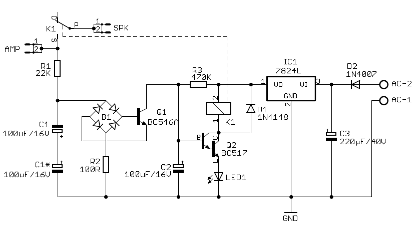

This is the BoM of the Speaker Protection PCB:
https://secure.reichelt.de/index.html?;ACTION=20;AWKID=564957;PROVID=2084
Take care that you will use a relay with the required grid.

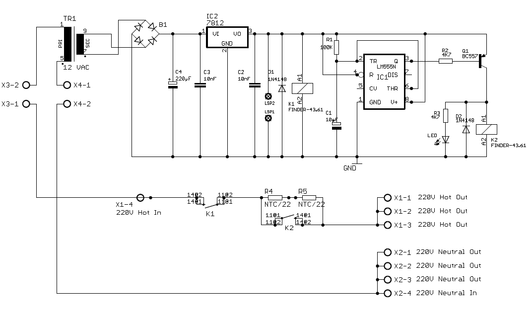

This is the BoM of the Soft-Power-On PCB:
https://secure.reichelt.de/index.html?;ACTION=20;AWKID=565919;PROVID=2084
The BoM does not include the NTCs (I used 2 x 22R / @25 degree NTCs).
You can also use 1 (or 2) big power resistors and mount them vertically.
Regarding the used transformers:
You need 1 (or 2) 2 x 25 VAC transformers for the Backend-PSU with high wattage and 1 (or 2 ) 32 - 35VAC transformers
for the frontend (shunt regulator) with very small wattage (30W).
I will course include the BoMs in my "FC-100 Builder's Manual" which I plan to complete by the end of this week.
Best regards - Rudi_Ratlos
