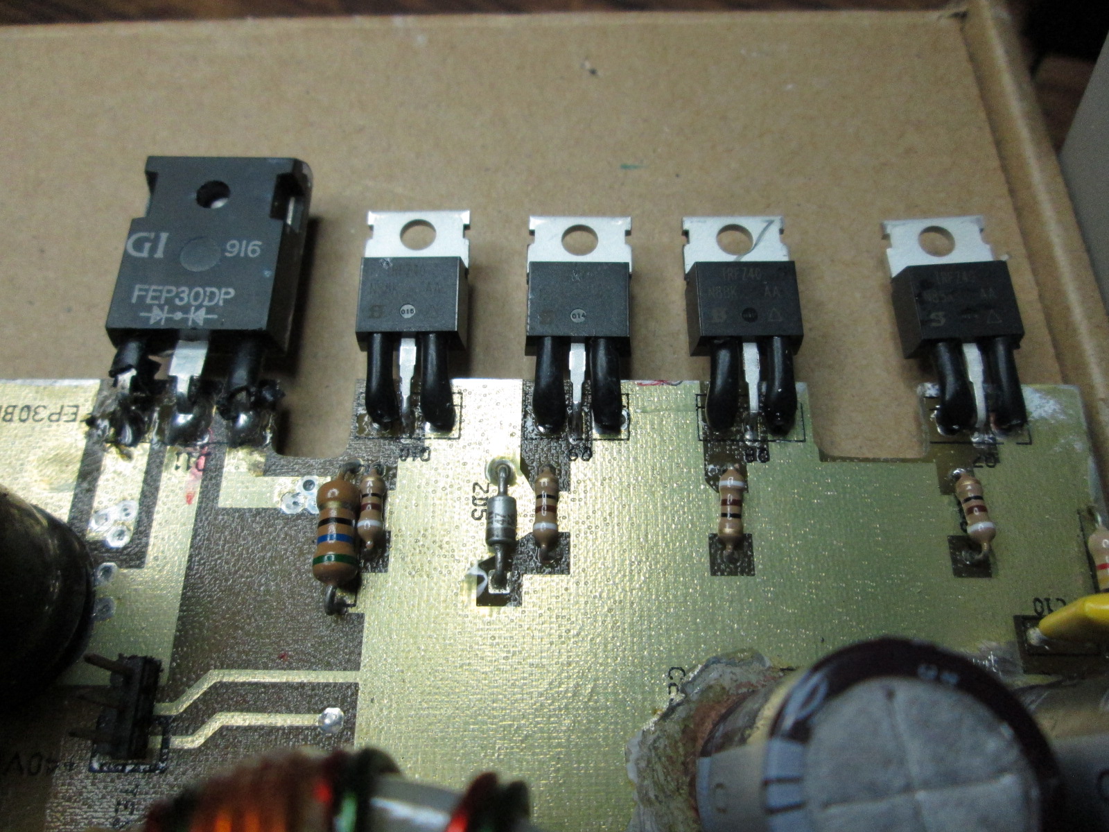

I see the power mosfets run up to 175C so I'm just paranoid I think.

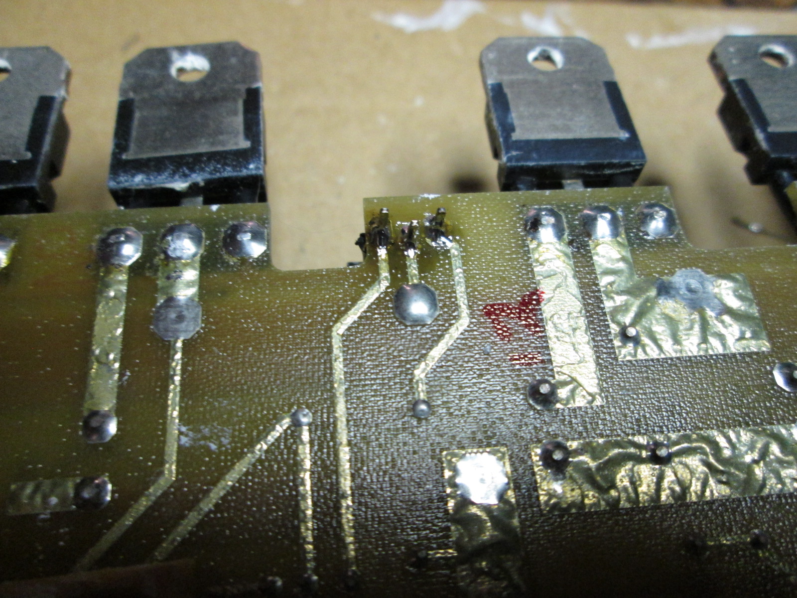

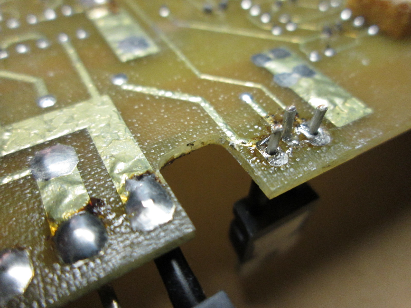

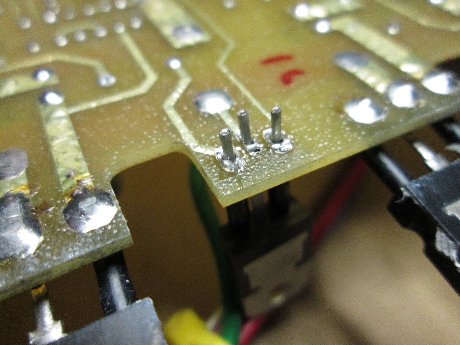

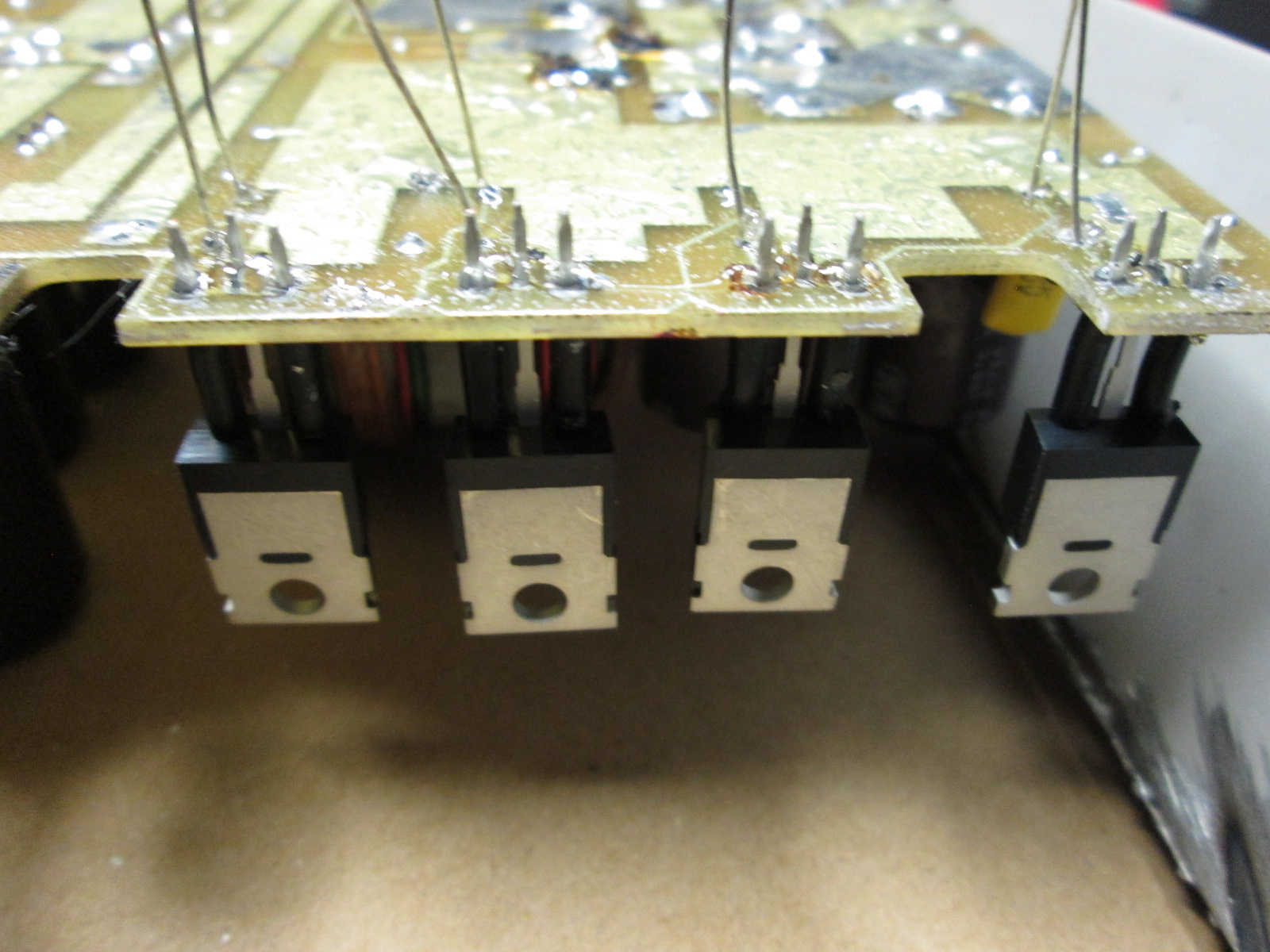

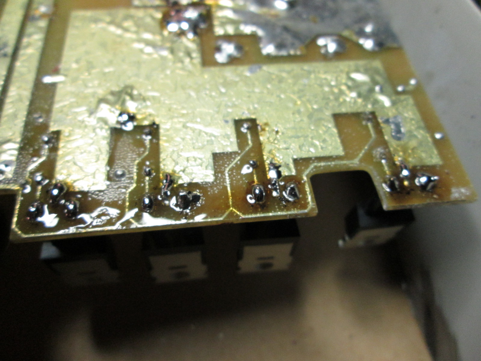

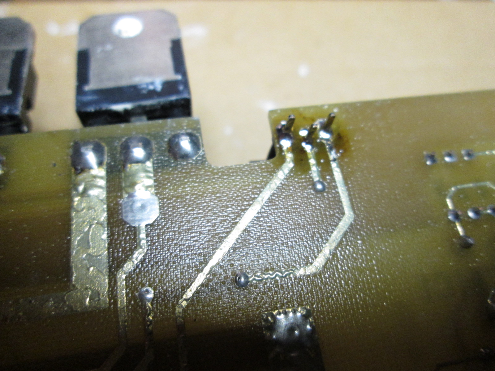

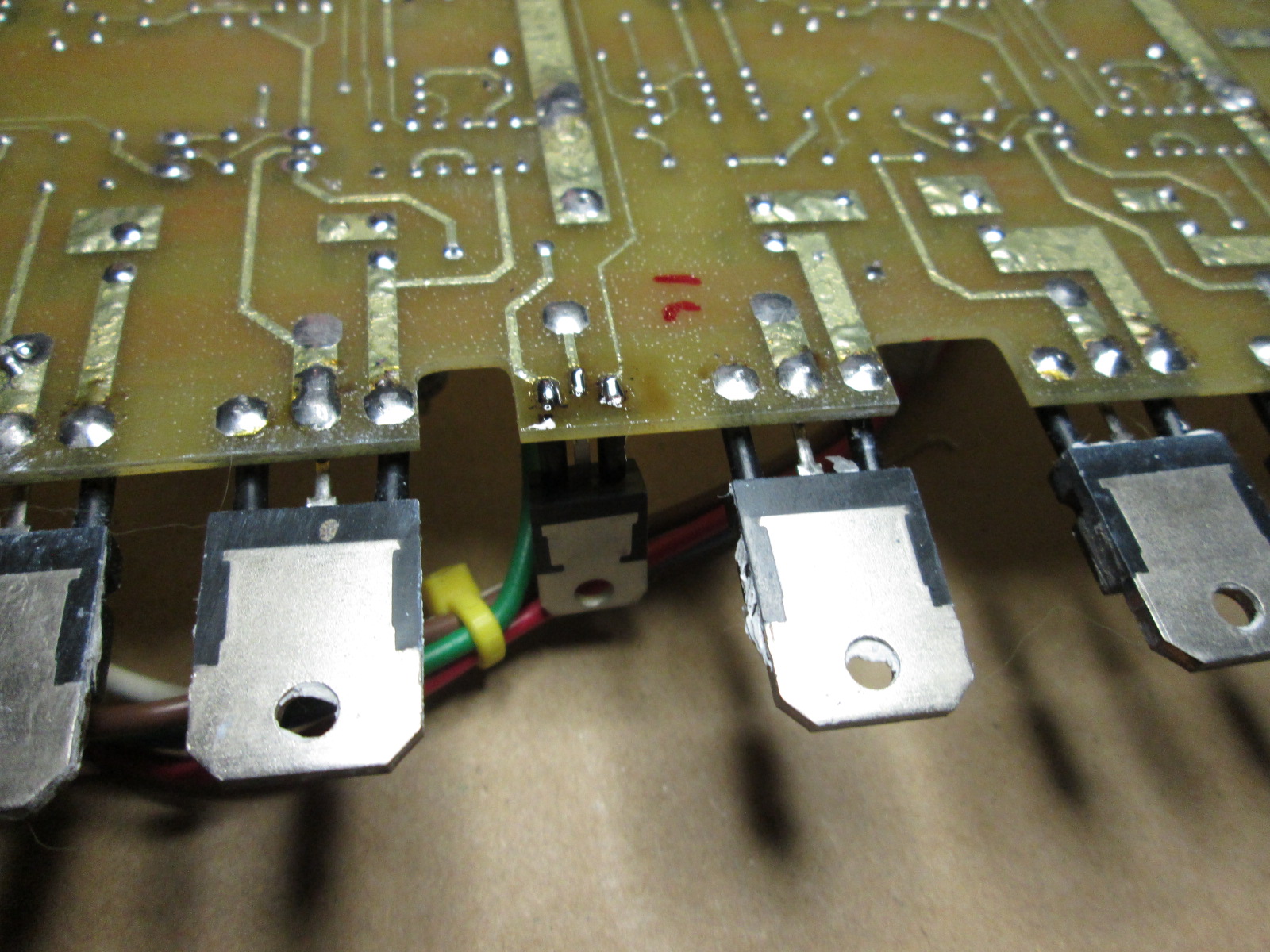

I'm a bit worried about my solder bridges I made where the trace popped on the drain legs. I think I should have used a small wire also maybe.
Also I may have been a tad bit too crazy on the torque of the hold-down nuts. Spec says 10 inch pounds and I probably did 15 ft⋅lb on those nuts..🙁
Zed mentioned IRF3205's. I never heard of a hexfet.

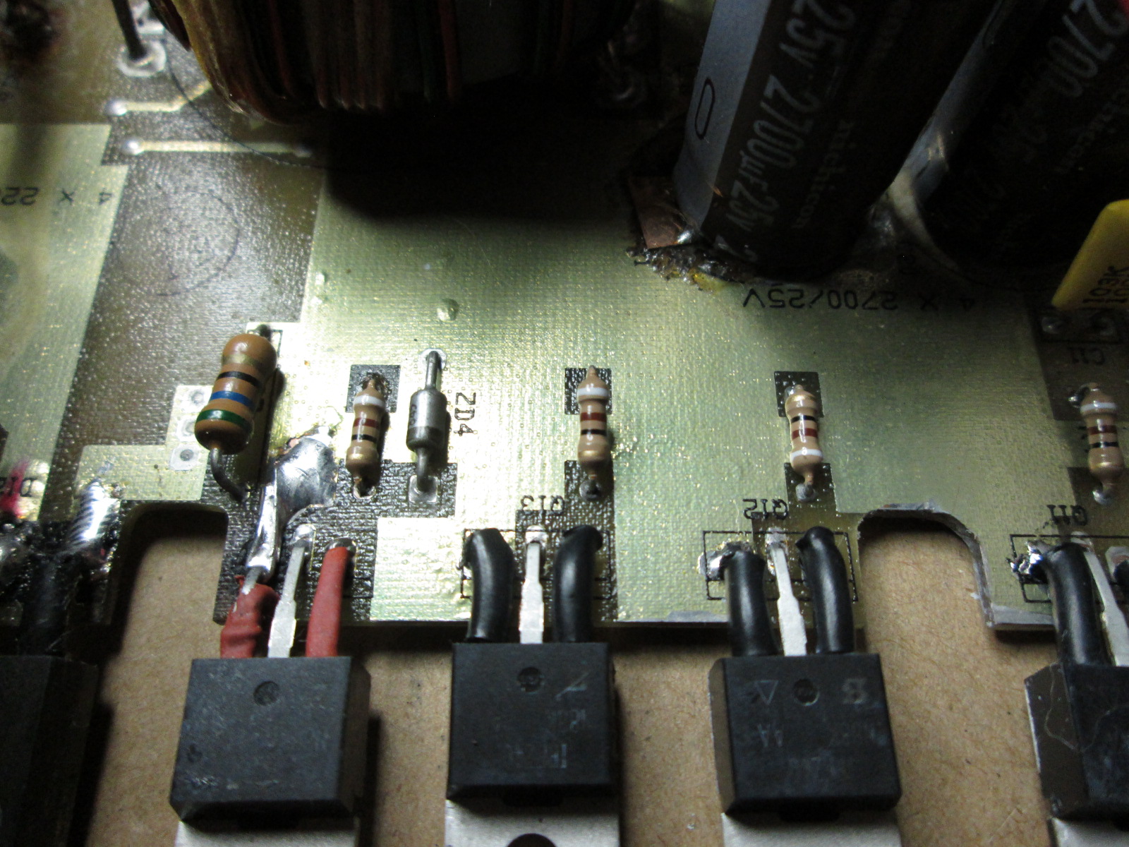

Did the PS FETs or the outputs get that hot?
You never use solder alone to bridge a broken trace. The attached image shows one way of using wire to jump the gap.
I wouldn't say hot, just that end of the heatsink got warmer than the output side, about 45-50C.

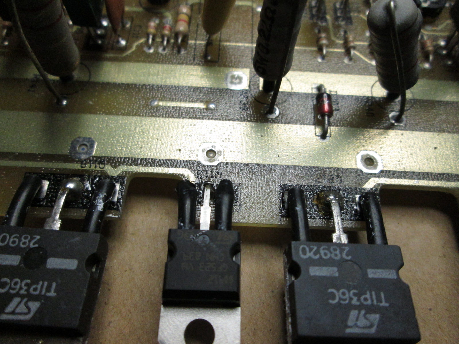

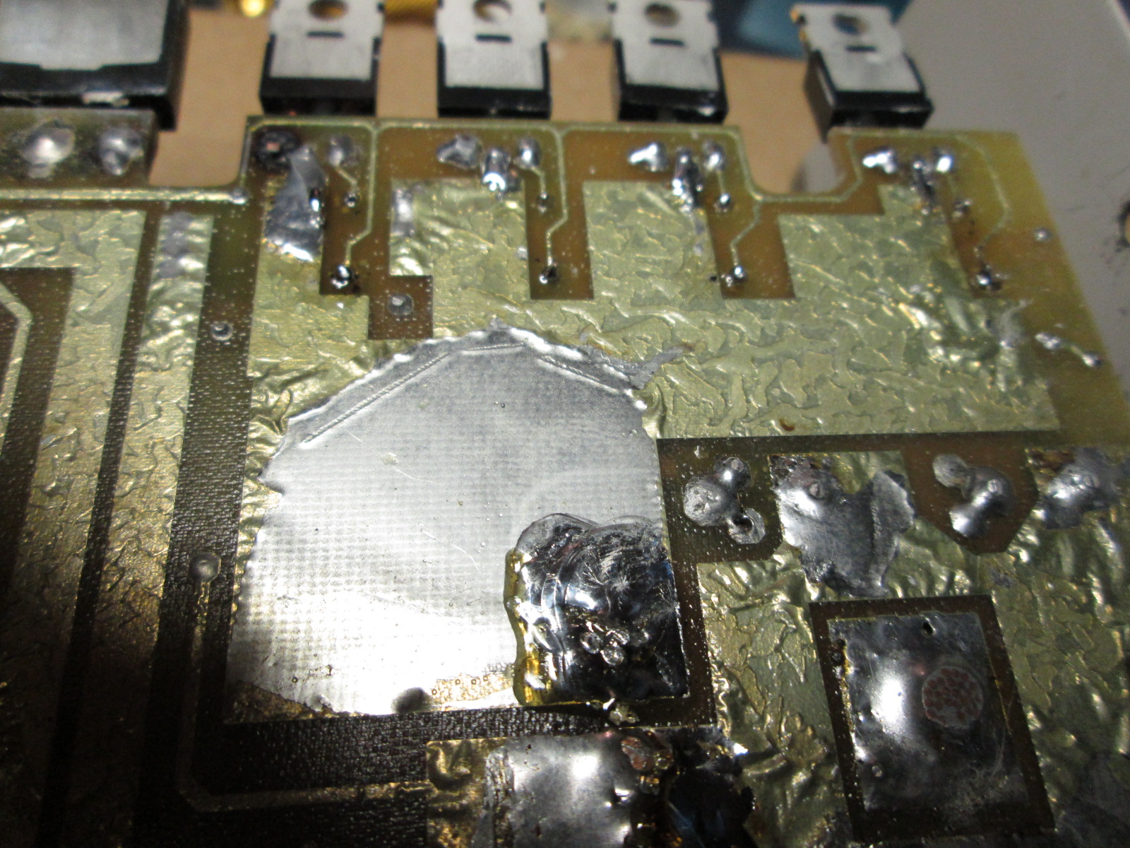

These images show where the Drain traces cleanly "zapped" almost by design instead of burning up the whole board.
The one leg on the topside was the hottie that charred the board in the grey circle, the Source.
I'm just being paranoid and over protective I think but it will be a good idea to fix the traces better.

The audio end of the amp generally gets hot much quicker than the power supply end. If the power supply got hotter than the audio end, there may be a problem.

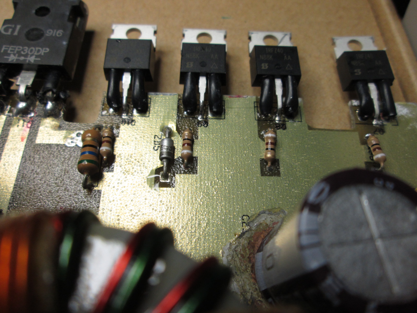

OK I got the rodek out to fix the traces.

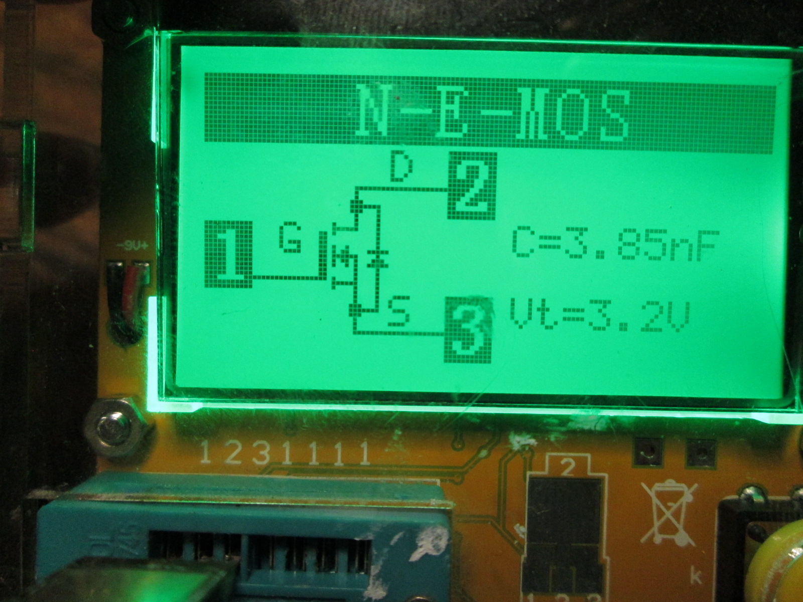

Are the gate resistors supposed to be matched?
I've got 92.5-88.9 ohms
The traces should be ok now I hope.
I'd love to find this kapton MT.
Not sure what Rodek used MT100 or thicker?

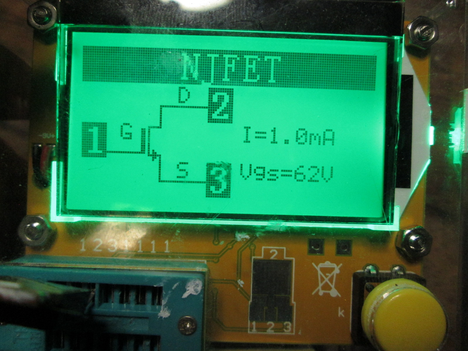

I'm worried about the original IRFZ40's.
The mold isn't flush on the back, theres a step there. Not sure if it got too hot and melted or what.

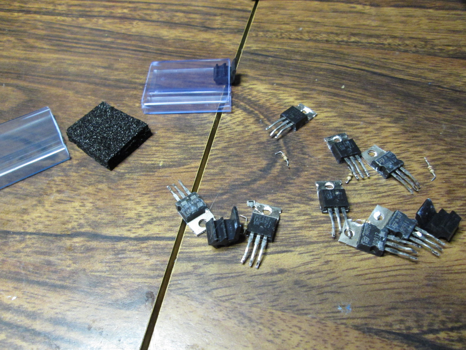

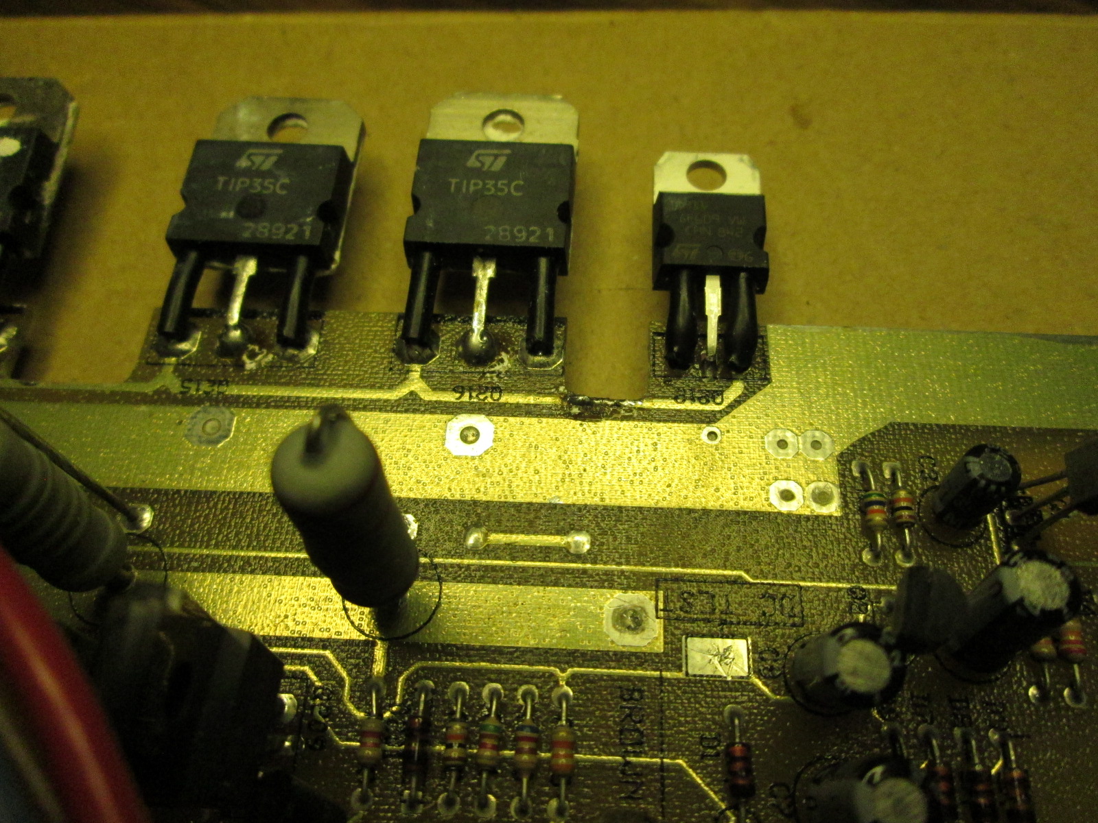

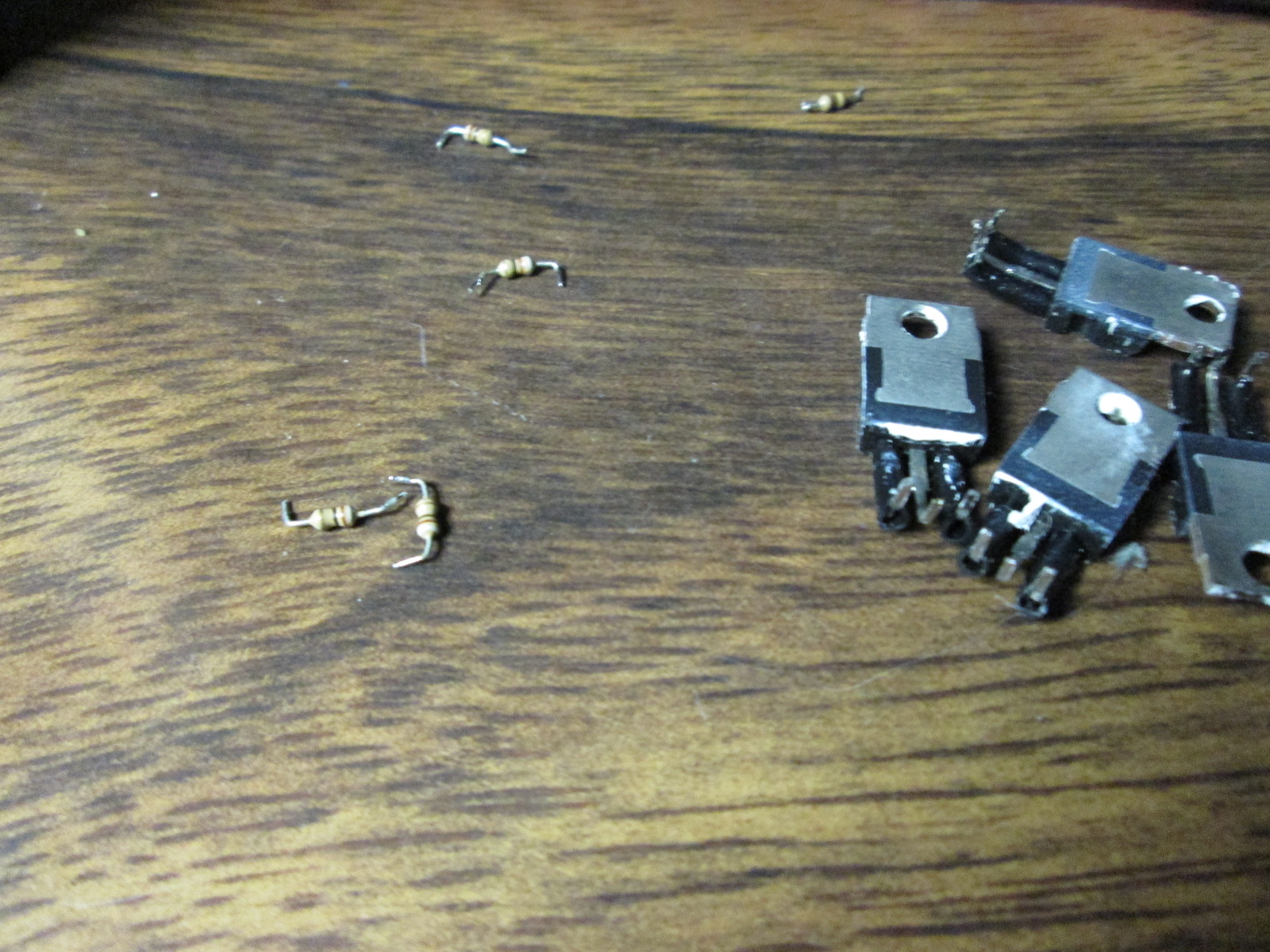

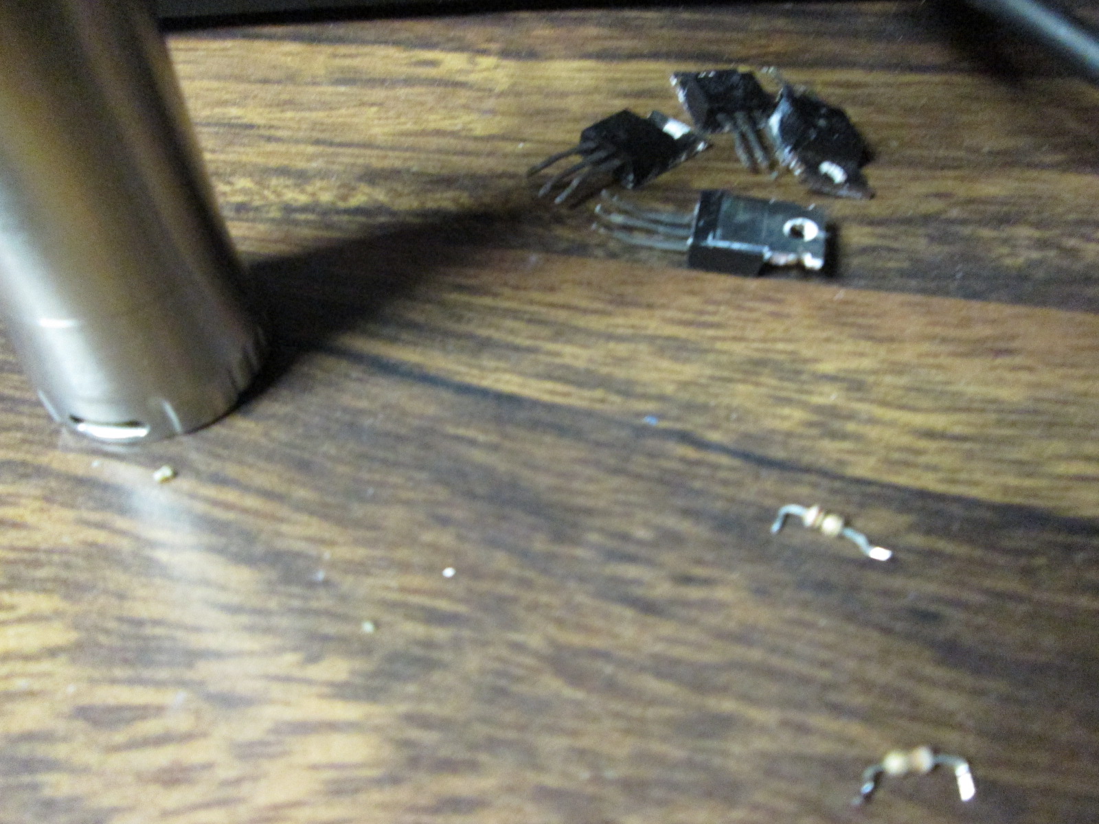

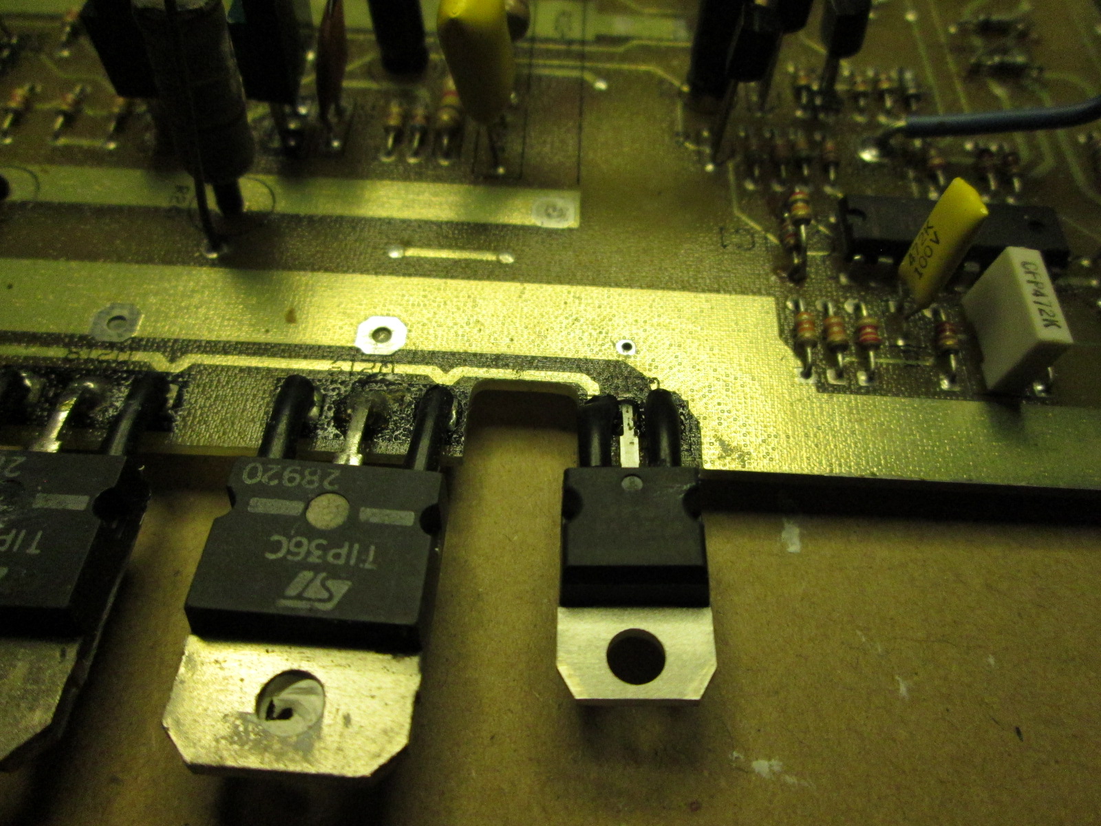

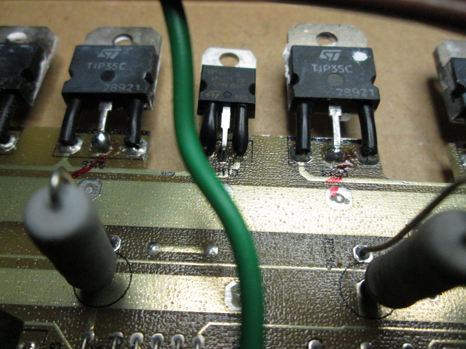

OK well I got some more parts today.
I replaced the other 4 IRF40Z's, 8 gate resistors and 2 BSD911's, BD912's.
Just waiting for the silicone strips so I can put it back together and check the bias again.
