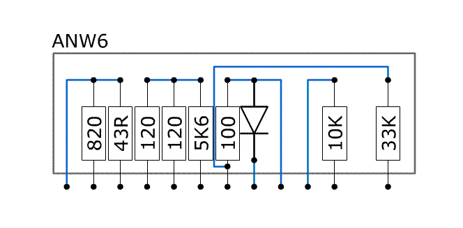

I pulled NW201 (ANW6) and measured alright around the 33k resistor; not leaking from anything around it not connected. Everything is measuring OK except however the two 120ohm resistors. They are measuring 78 ohms instead of what I thought should have been 240 ohms across them. This in an ANW6 9402. I dont find anything else wrong with this module.

The NW101 (ANW6) NW101 from the second channel is measuring exactly the same as the NW201; including the 78 ohm section.
Is this portion equally bad on both or is this OK? The 33K/diode/100 section does not appear to have any leakage to any other pins.
Check the diode to confirm that there is no reverse leakage.

The information I have was faxed in January of 93. There may have been revisions or there may simply may have been an errors in the values on the document.
Got it. The diodes on the modules are checking out fine. No leakage at all.
I clippe half the pin of the 33k resistor so that when putting it back into the board it does not touch the PCB. If I need to re-connect it I'll just use a thin piece of wire lead with a little extra solder. Both modules are now soldered back in the PCB with the 33k pin detached.
