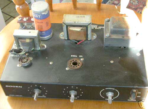

Pictures of a CHB-10 on eBay

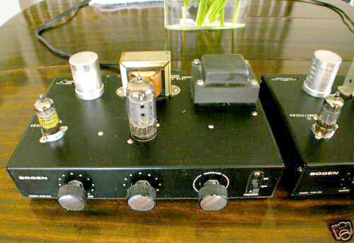

PRR - that ebay link you put up kinda confuses be because that doesn't look anything like the ones I bought. I hope it's not a PA amp, but when I bought them I had just started looking into tubes and it seemed like a decent price compared to a lot of others. The guy selling them said he'd been using them to amp his home speakers, of course, being ebay, he could very well have been lying. 🙁
Here's the link to the ones I bought:
http://cgi.ebay.com/ws/eBayISAPI.dll?ViewItem&item=5763053970&rd=1&sspagename=STRK:MEWN:IT&rd=1
One of my friends here who knows a little advised me they'd make good stereo amps and they did look like nice little (little being the key word) amplifiers. If they are indeed a PA amp... is it even worth trying to amp a set of speakers with them or is it a better idea to just resell them and find something else?

BTW If you look closely at the hot rod link given, they are the same only missing their outer (ugly) cabinets, good riddance!
Those do look in very good condition and were a good buy.

Looks like yours have just been stripped of their outer enclosure -- someone looks to have done some work towards converting them from PA to home-hifi (ie isn't that a choke on the left-hand side (something i've not seen on any of the Bogens thru here).
They can probably be made a decent little amp
Were those mostly push-pull?
I think on SE of that vintage and power, you "have" to have a choke. Yes, 1 Watt radios lost their chokes, but at that scale you put a little more money in the filter-caps and it is good-enough. (Actually, many-many radios leaked some ripple through the output transformer backward for semi-cancellation.) On my 1940 10W PA amp, the choke is as big as the (pretty big) output iron (the choke has more load: it fed the speaker field coil too!). Past 1970, the price ratio between iron and electrolytics reached a point that a C-R-C filter could work OK (especially with overall feedback), but nobody noticed (the 10W amp field was all sand-state by 1970). But look at Fender Champ guitar amp: C-L-C filter to the end of original life, and on nearly all modern clones. You either need much-more than 16uFd, more than 40uFd, to keep the buzz down; or you stick a choke in.
The "choke" in the attached picture from the auction, doesn't seem to also be in the pics with tubes... be interesting to see the underside.
