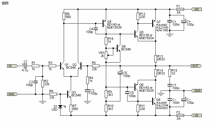

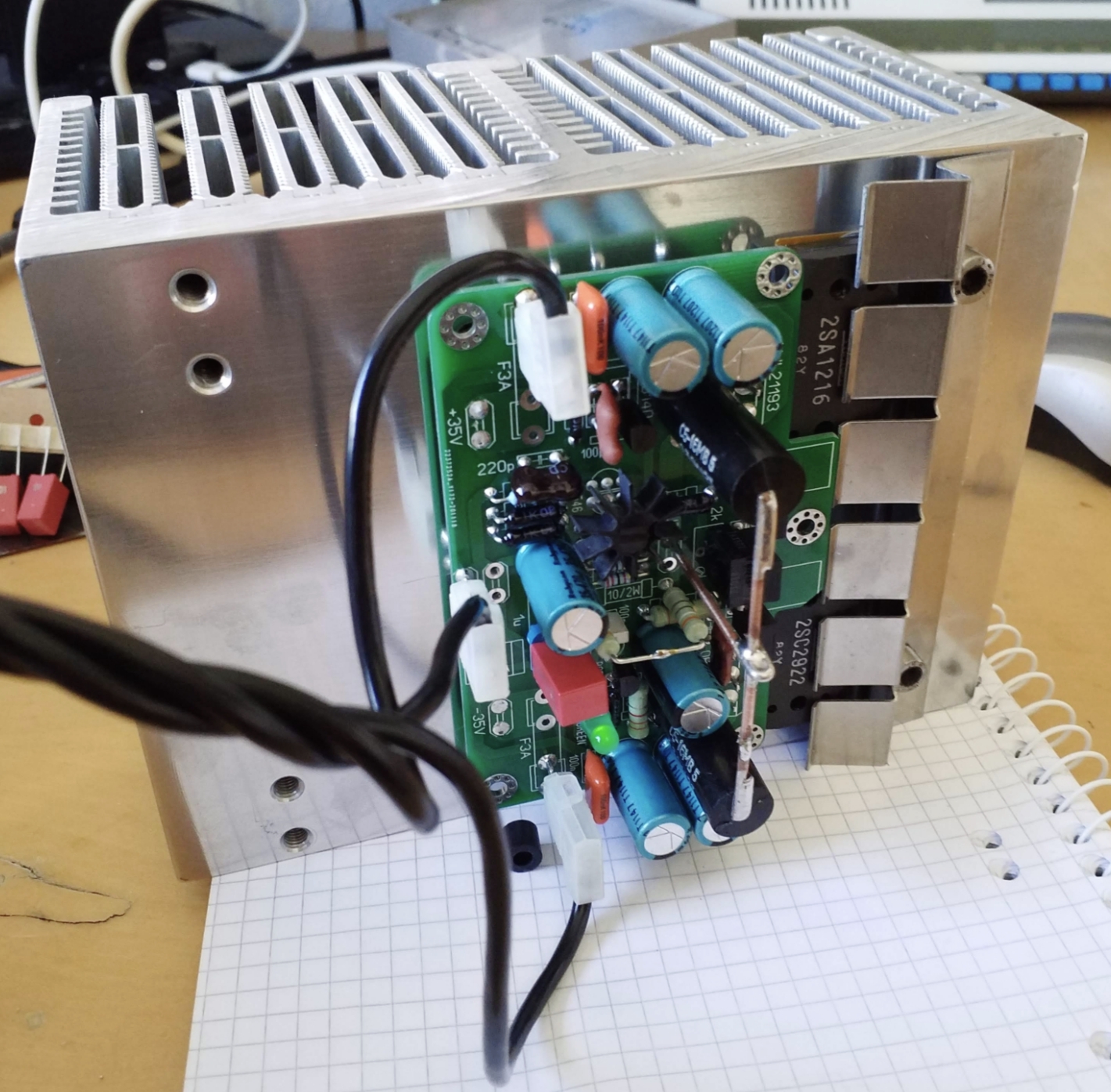

I have built the P3A several years ago, but for my taste, the sound is too clinical. I understand it is built for precision, and it does that very well, but it lacks the "warmth" that usually comes tweaked for branded amps. This warmth, as far as I understand, comes from an emphasis on bass and highs, with a decreased representation of the mid end, making it sound less-harsh and less-tiresome. ( like a V shaped equalization pattern ). So, I was thinking of making some adjustments, and with the help of Chat GPT, I identified some possible mods that I can make, but I would love it if anyone here had the time to validate if these can cause other issues with the amp and if these will actually affect the sound signature towards "warmth" :
low end :
- increase C1 from 4.7 to 10 or even 22
- increase C2 from 100 to 220pf or even 470pf
- increase C3 from 100 to 220 or even 470
- increase C5 from 100 to 220 or even 470
- reduce R6 from 560 to 470 ( will this affect the recommended bias value ? )
- C+, C- increased from 100 to 470 or even 1000
high end :
- increase C4 from 100 to 150pf or even 220pf
- reduce R11 and R12 from 220 to 180 ( same question, will this affect recommended bias ? )
- add 2.2nF capacitor in parallel with R5
It was also suggested to increase R13 and R14 to 0.47 or even 0.56 to tone down the vocals
Another thing suggested is to use a combination of ceramic and metal film resistors, rather than full metal film, even though it will slightly affect precision it will also slightly introduce a tiny bit of pleasant distorsion. Also to use electrolytics instead of Polyprop for the same reason.
What of these advices do you think are feasible ?
Thanks in advance !

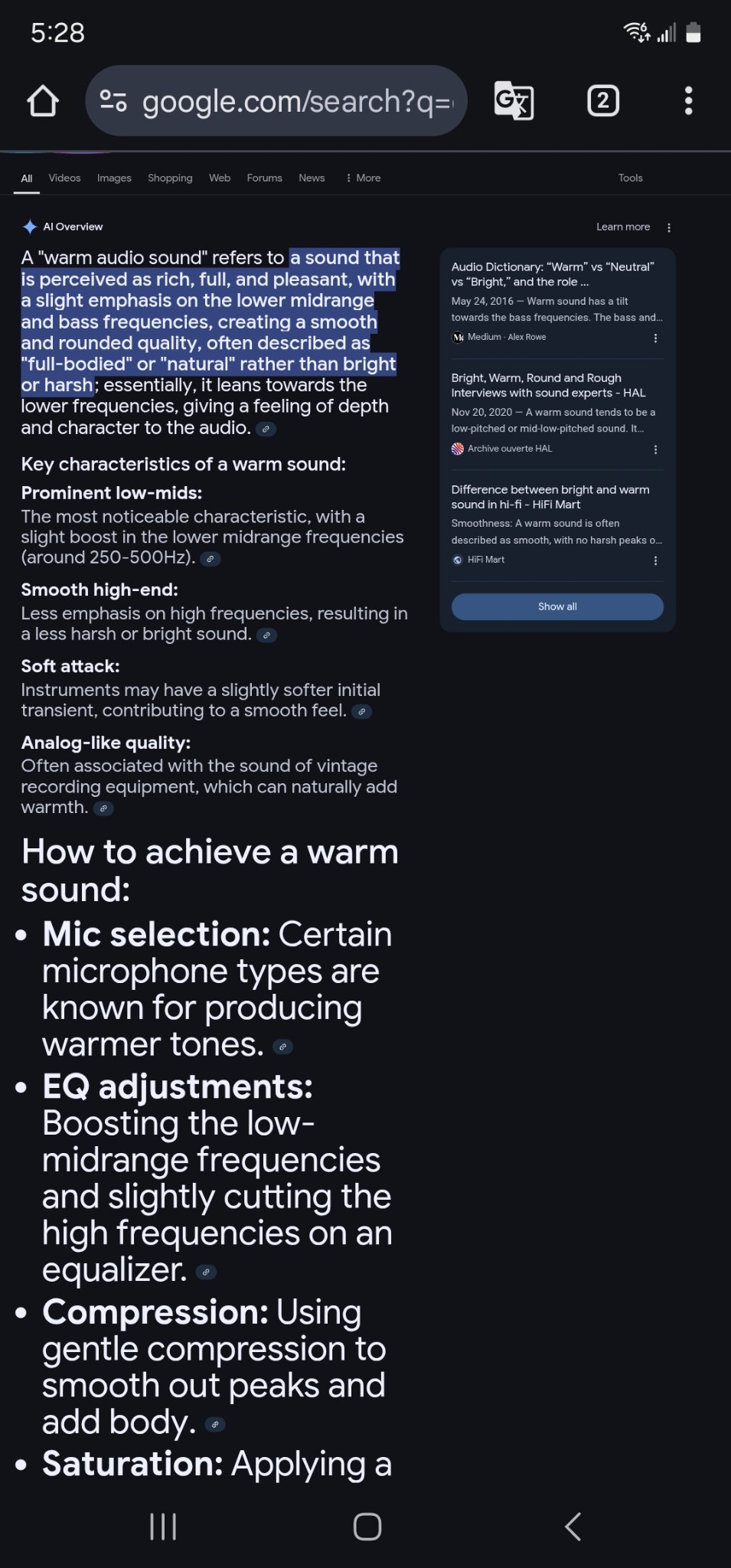

We are quite good in finding solutions for non existing problems here but what about connecting old “warm” loudspeakers with woven tweeters to that P3A? If ChatGPT agrees with that of course, we don’t want trouble with the authorities.

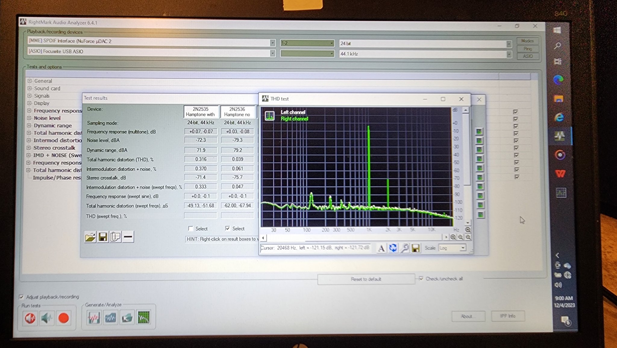

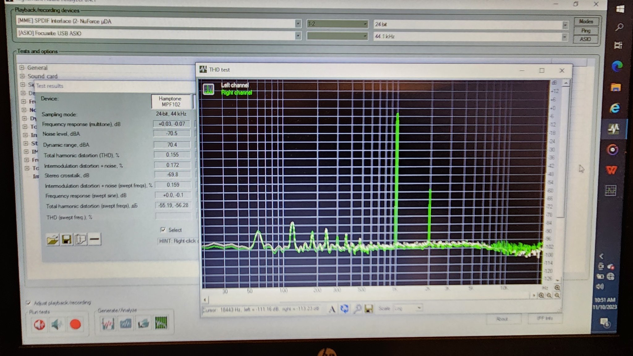

This is simple jfet pre hamptone. Well known for sweet sound. Pure second harmonic.
Please post fft spectra of 1kHz test tone before and after your dsp.Sharp and harsh. Like I added an octave above the original sound. 😀
Otherwise adding octave above is enriching, hardly noticable at low level. Never sharp and harsh.

The DSP in that test rig has been repurposed for another experiment, so it will take me a while to get it up and running again. I'll see if I have screenshots somewhere. If my memory serves me right, it wasn't noticeable at first, but when it was, it wasn't pleasant. At least not to my ears.Please post fft spectra of 1kHz test tone before and after your dsp.
