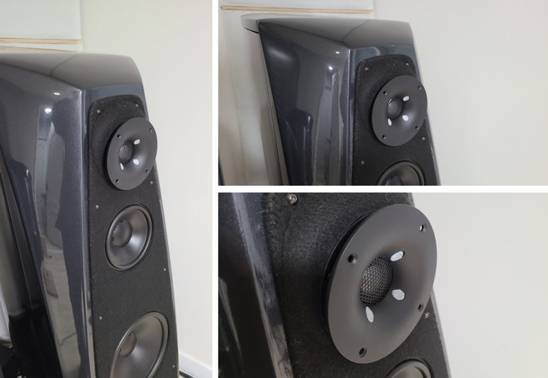

Gorgeous looking enclosures, that is one of the nicer DIY enclosures posted on here that i have seen.
But that 6 inch baffle with no recess for the drivers, will and does give unwanted resonances.
There is a few in your impedance curves.

@Arez
Thanks for pointing that out.
I didn't take a picture, but the chamfering is already applied.
However, the baffles are very thick, so they are shaped like the 'D' type on the Troels website you linked to, and the airflow behind the driver is good.
This is also the same shape on the Avior 2 from Rockport that I modeled.

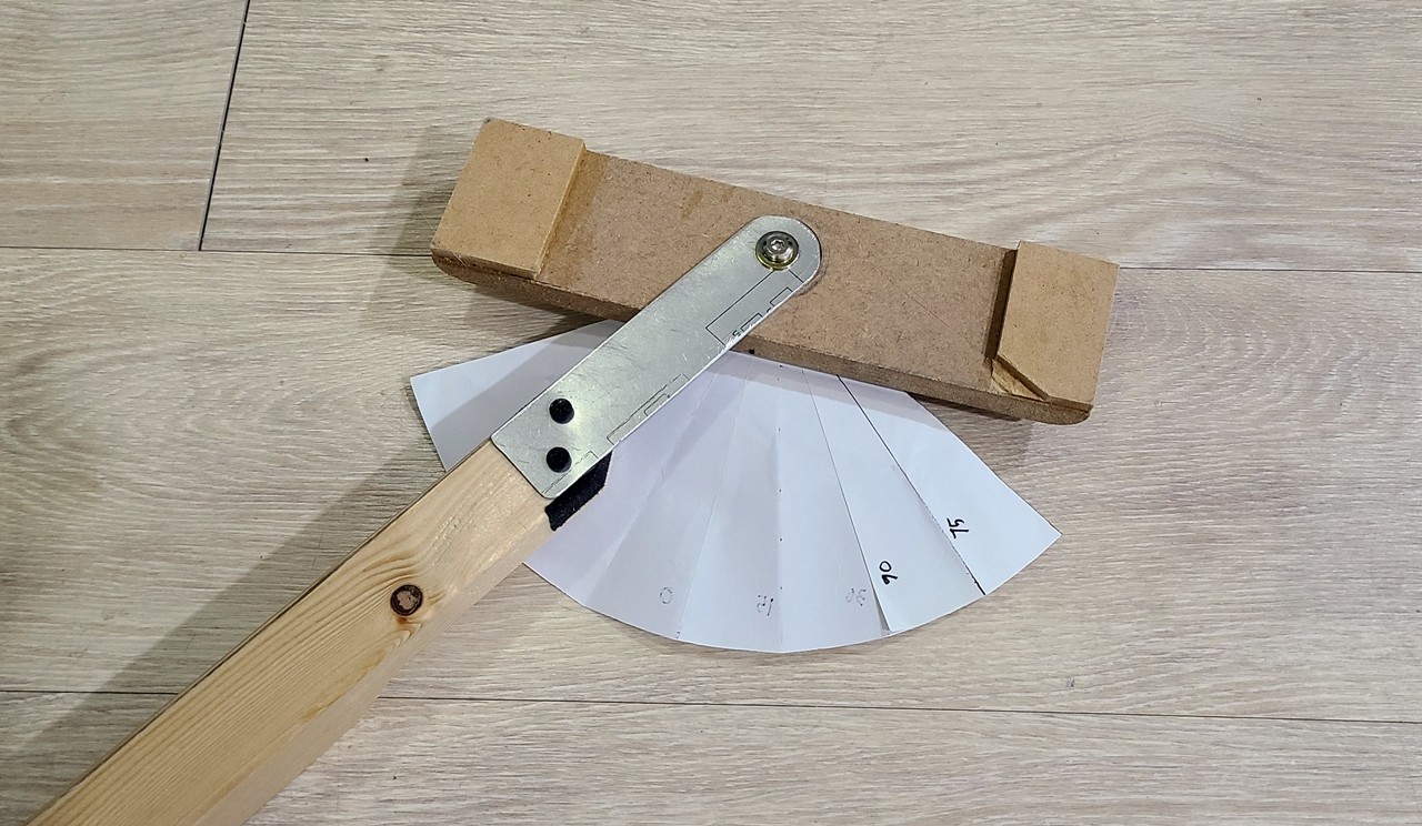

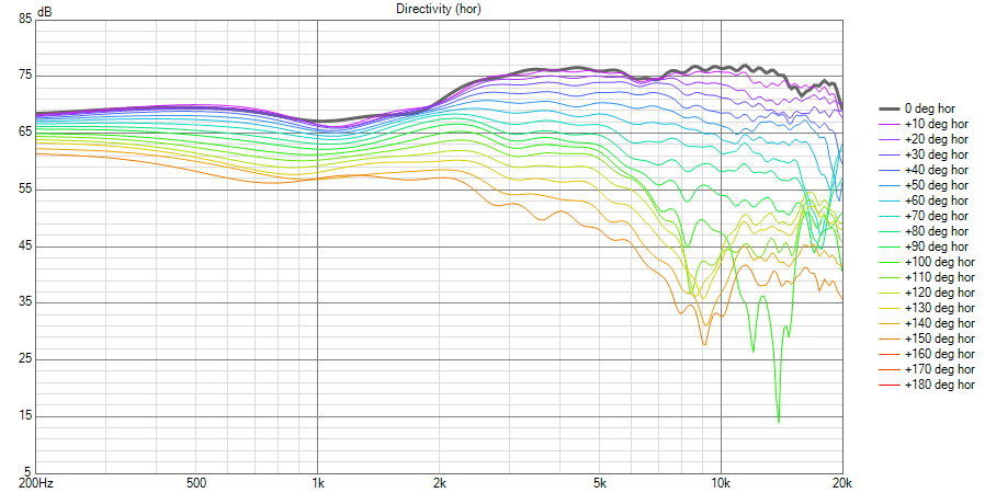

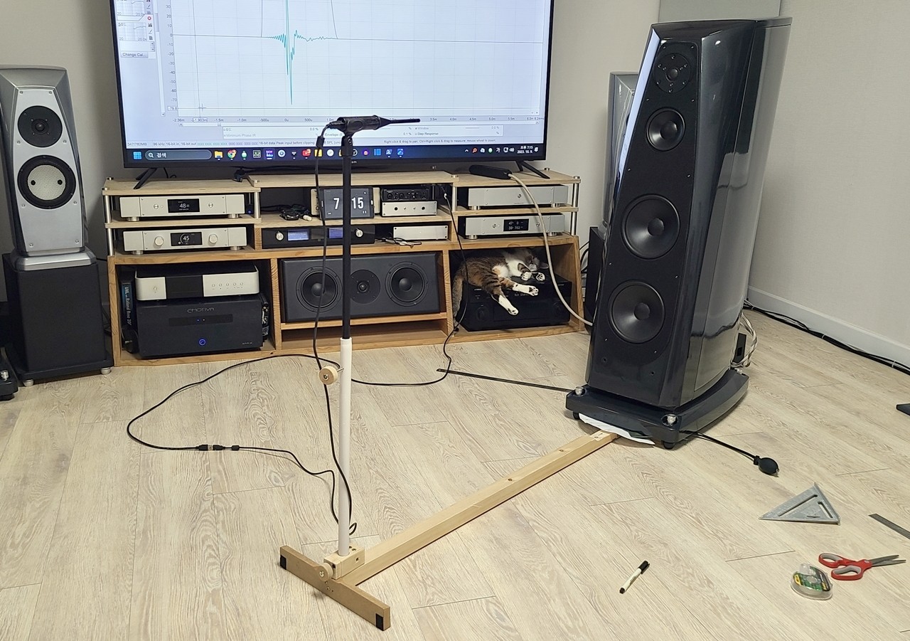

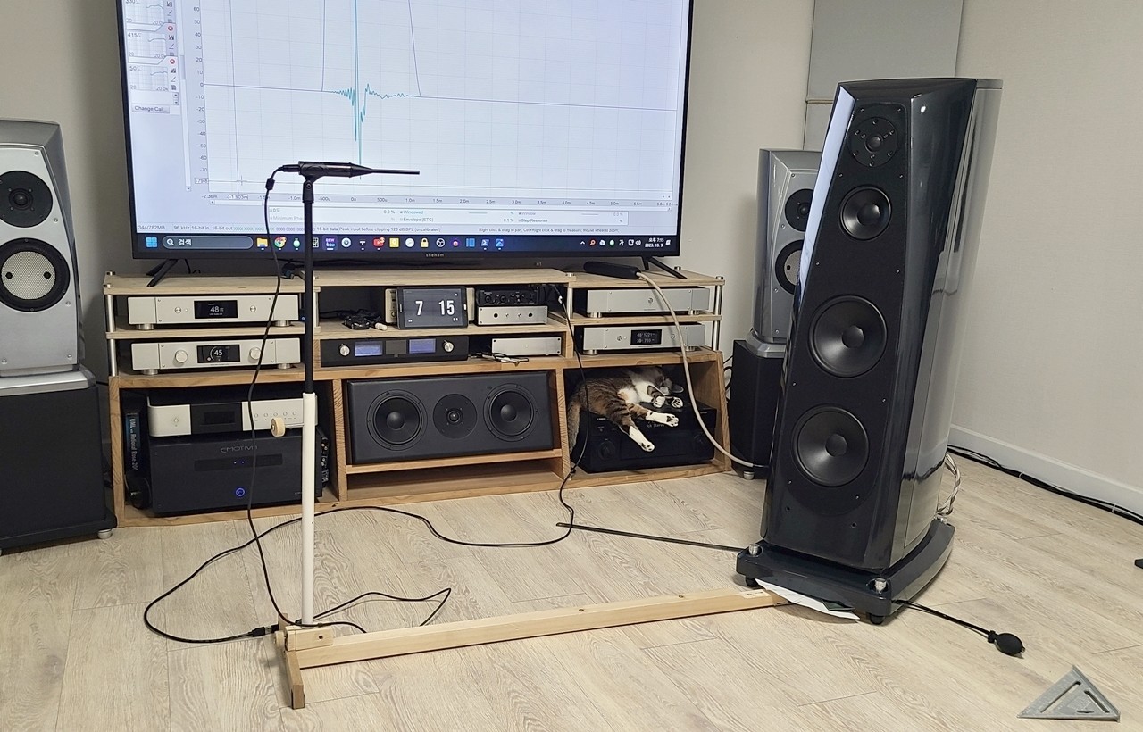

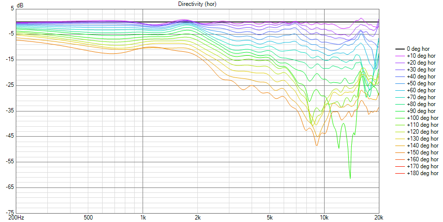

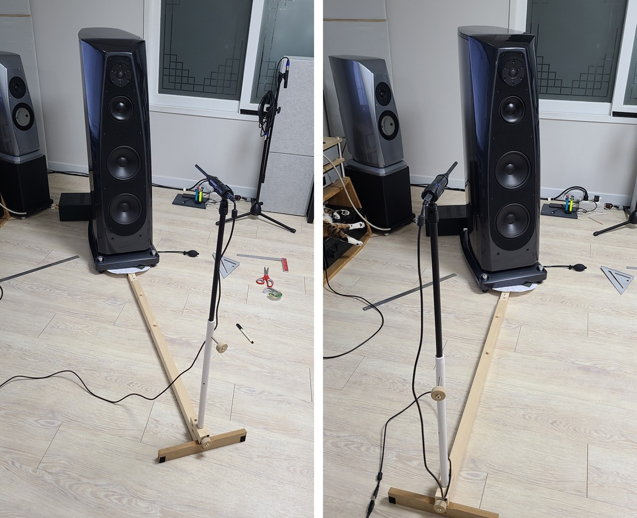

I measured the off-axis frequency response of the speaker. The speaker was too heavy to use a rotating disk, so I made a tool to easily move the microphone.
Below is a graph depicting off-axis response measurements, with reflections eliminated through gating (1.2ms).
I have only displayed frequency bands above 1k, primarily to assess the variation in directivity between the tweeter and midrange. Starting from the highest point, these angles are 0, 15, 30, 45, and 60 degrees, respectively.
The characterization remains consistent up to 7K, after which it becomes somewhat inconsistent between 7K and 9K. The minor dip observed at 0 and 15 degrees could potentially be substantially improved with the use of waveguides, although I have not conducted tests on this yet. Beyond 10k, the off-axis response generally performs well. While it may not exhibit the ideal shape, it remains acceptable considering factors such as room conditions, measurement errors, and so forth.
(Psychoacoustic smoothing, 1m distance, tweeter to midrange height, 50 dB/decade aspect ratio)

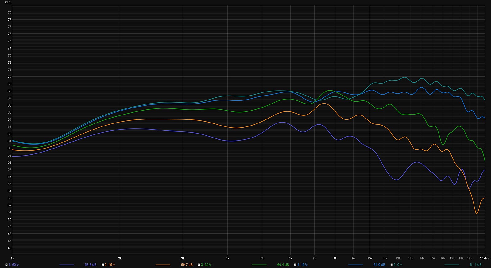

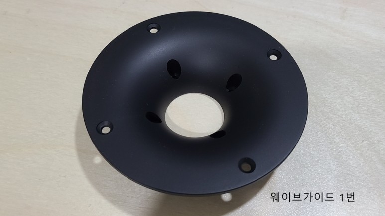

I recently purchased a waveguide from Aliexpress, attached it temporarily, and measured its directivity.
I measured from 0 to 150 degrees, and the graph below is the response without normalization.
Here is the graph with normalization applied.
Here is
Above 8 kHz and beyond 120 degrees, you can see some unevenness in the directional characteristics, but that's pretty good.

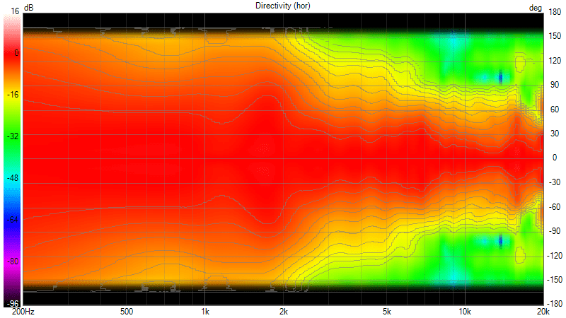

The following is a polar map.
I gated the time window to 5ms, so below 500Hz is not significant. The tweeter/mid COP of this speaker is around 2.8 kHz, and the mismatch in directivity at that point is not significant due to the waveguide and offset baffle geometry.
