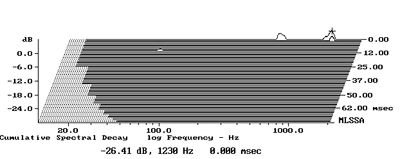

Frequency response as follows. Crossover design is not finished yet.

Try to pad down the 2K to 4K hz area...
