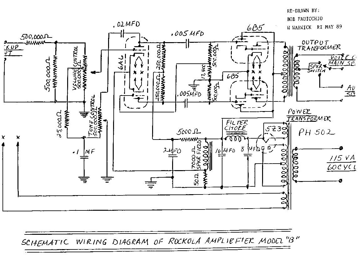

A friend recently asked us to take a look at his Rockola Jukbox sufferings from distortion. It’s been restored in the past the fault was found just to be dirty pre amp valve base. I used a my bluetooth receiver into the amp and the sound was was very good. But switching inputs has been a problem. I tried audio relays and using a 4066 audio chip but the sound quality wasn’t great so not sure if it’s possible. Also the amplification from the bluetooth device has reduced yet it’s ok from the phono input any advice would be appreciated

The 4066 needs that inputs and outputs float over VDD/2 for proper biasing. Did you do such a job?
