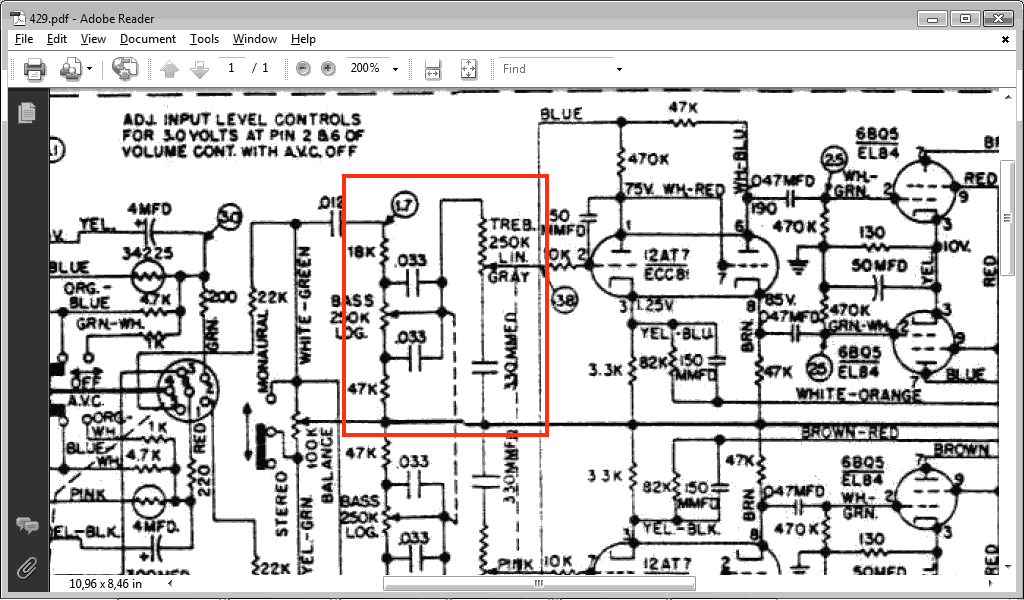

Hi audio lovers ! I bought an amplifier from a Rockola 429, the chassis is 41056-A. The tubes I got with were very bad sounding so I got some new output tubes. The problems are the basic hum and the lack of treble. Even if I put the treble at maximum, it is still not enough compared to my other amps. Does someone have some advices for improving the sound, because right now my only option is to sell it. Maybe chage all the caps , they seem to be all original (1965). Or modify the circuit, or use all the transformers and tubes, get a modern schematic and redo it entirely.

Rather than guessing or replacing parts at random, you should look at the schematic (which you didn´t care to supply 🙄)
If you had, you would have noticed its weird tone control section: "almost normal" Bass boost/cut but treble is incomplete: cut only.
Best is "flat" with Treble on 10 which is not enough.
Replace that tone control with a standard Hi Fi type passive one, often called "Baxandall" but which is actually a "Johnson" type.
You will then recover full control over Bass and Treble, and at the proper frequencies.

And just changing an output transformer with another model and not adjusting the negative feedback parts might be interesting . . . .
because negative feedback combined with the phase and frequency response differences of different output transformers might create an oscillator.
Please consider that this amplifier never was intended to be HiFi, but for sitting in a jukebox instead, feeding - mostly cheap - full range speakers with the primary capability of being as loud as possible. Hence it can't be exluded that it won't fit your needs.
