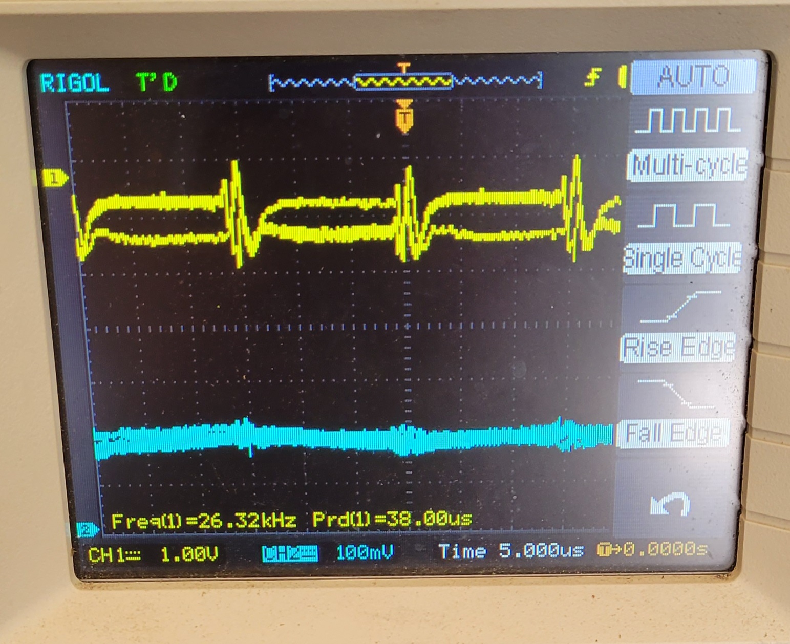

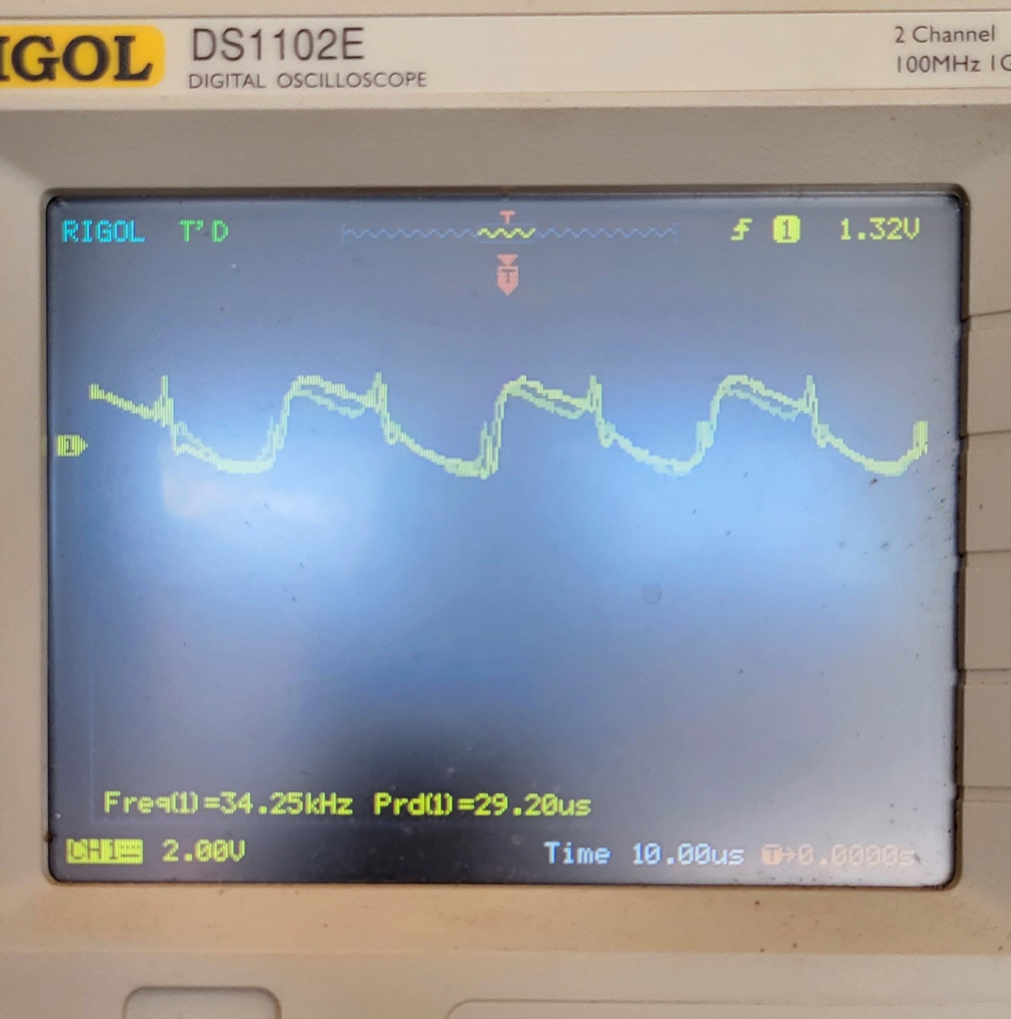

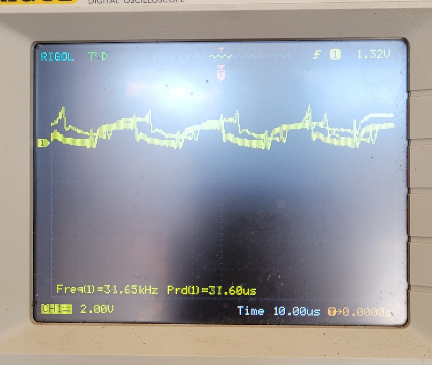

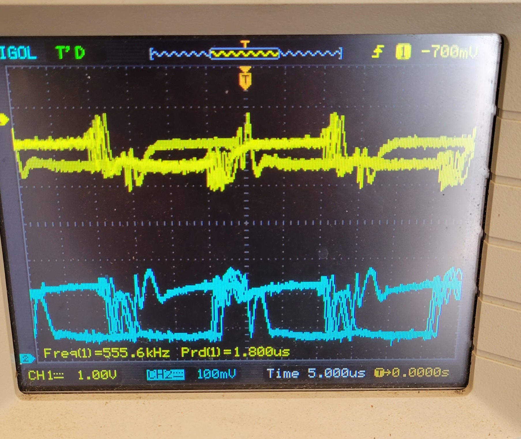

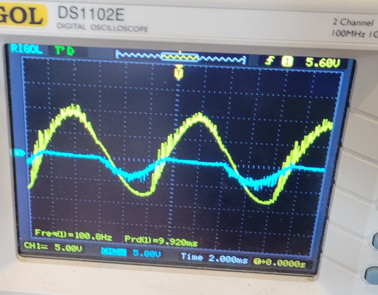

Hi guys. Working on a rockford t600-2 both channels play but are slightly distorted. The amp will play bridged but very low volume. Where should I begin?

Are you sure that the 0.1 ohm source resistors are within tolerance?
I'm not sure about this board but a board from a similar amp uses D204 and D205 on the driver boards in the over-current protection circuit. Lifting them will tell you whether the problem is in the protection circuit or in the drive circuit.
