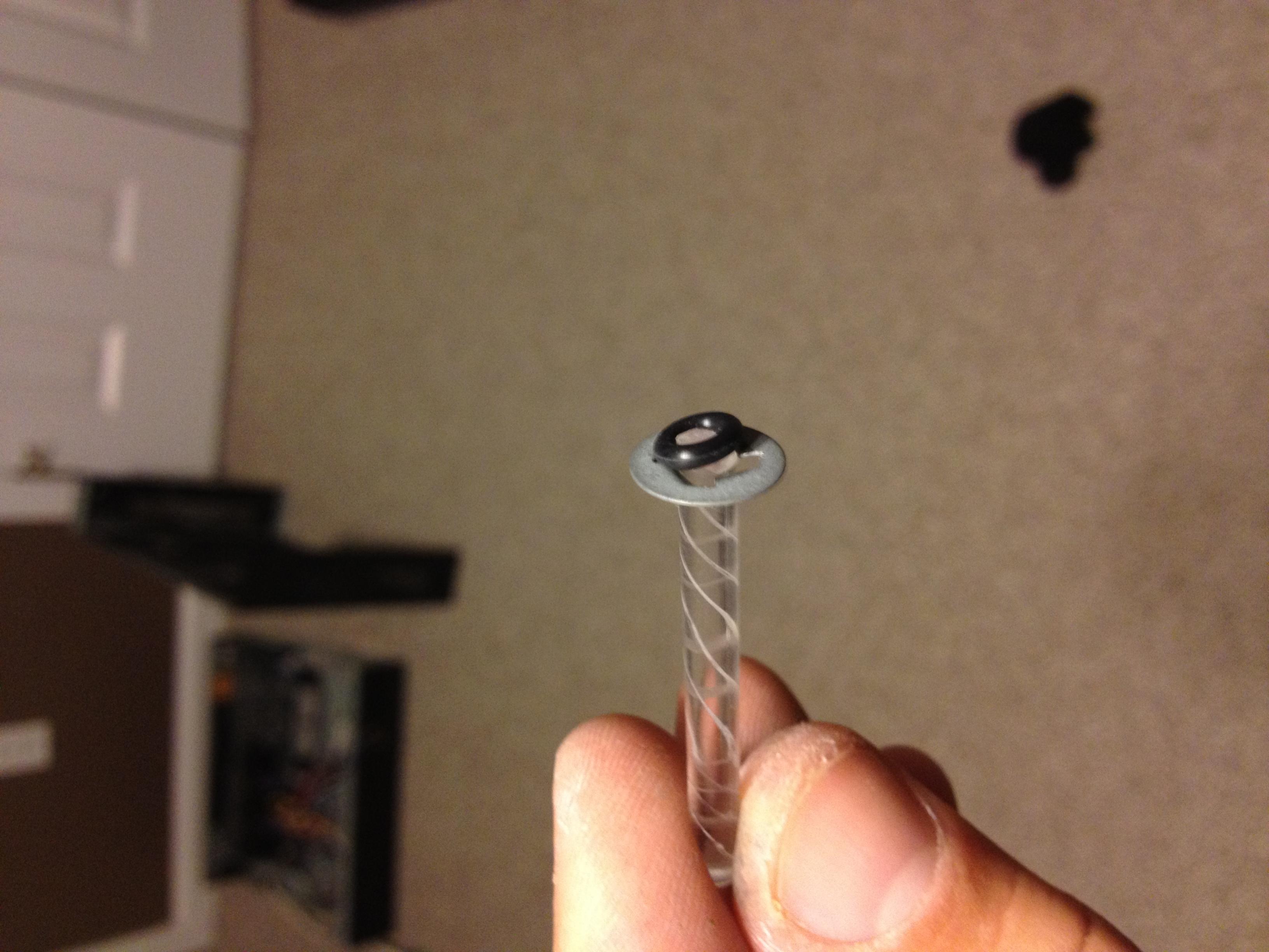

Hey guys just a quick question, i finally fixed a rockford fosgate t3002, but i cant for the life of me remember how to put the clear led pass thru bars back together? Its a clear plastic tubing with a rubber washer and metal washer that is fixed to the post itself. Im sure its simple and im just over thinking it, but from what im getting is the rubber washer sits on top of the smd LED and then the metal washer thing and then the post ?
The post slides into the hole from the top of the panel. The o-ring goes on next from the bottom and then the retaining ring. When properly assembled, you can't see the o-ring.
