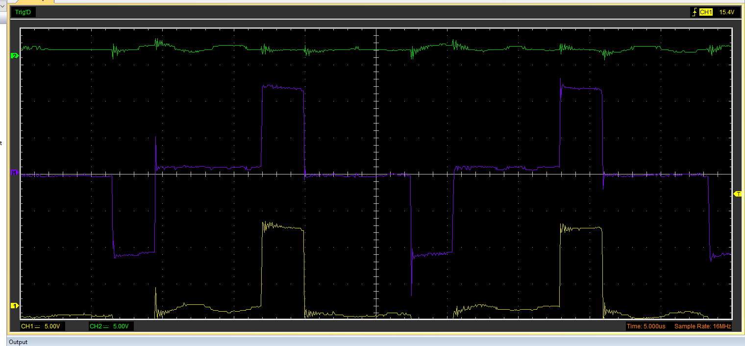

Please help me trace or eliminate the ringing signal from the high side output side of the T2000 and T2001. I believe this is the root cause of ringing on positve side of output fets but please correct me if I am wrong. This is the first time I trouble shoot this kind of amp.
44H11 and 45H11 readings are good I also re soldered it. I also pulled out driver transistors and all tested fine no leak.
Attached are the signal forms.

Hello Perry,
It is a USB scope Hantek 6022BE
http://www.hantek.com/products/detail/31
I already tried swapping it with channel 2 (green) and it really reads the same.

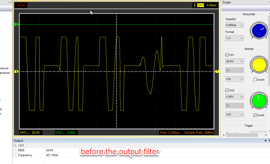

I am now back checking this AMP. I got the differential mode setup going. A purple line appeared in the middle. I set the ch2 inverted. If I touch both probes with my fingers, the purple line is not moving. I guess that is how differential mode should work right?
How can I use this in checking this amp?
I actually tried using both probes left the ground floating in the air and I don't understand it. There is still ringing in the purple line. The photo is taken directly to the transformer without the 12 diodes and 6 driver transistors because I pulled it out

Please use circuit board designations. Which transformer?
The circuit needs to be complete to determine if the waveforms are normal.
When in differential mode. if you place both probes on the same point, the trace should not move. It should remain a straight line. It's essentially like a multimeter, when you place both probes on one point.
Hello Perry,
Sorry the transformer I tested are the T2000 and T2001. The ones being driven by the 5110 ICs. the primary looks good.
It means I got this differential mode right then 🙂 It is convenient because I don't have to force contact the ground clip I can just leave it hanging. I am just having a bit difficulty on the trigger though 🙂

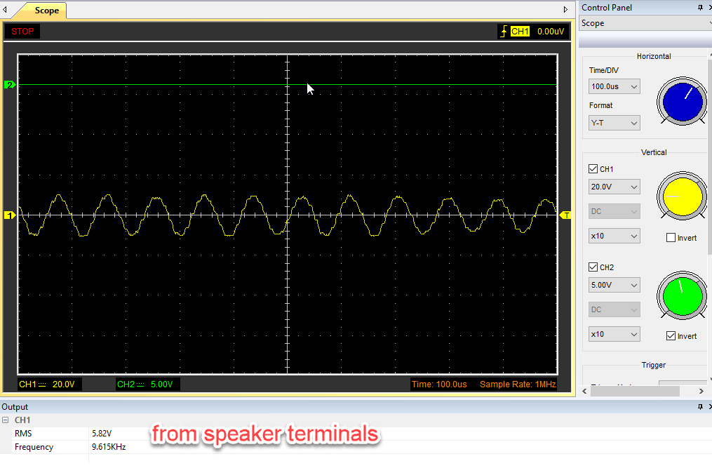

The problem with this this unit is that it gives out high frequency audio like around 10Khz without audio input, and FETS are heating quickly (clamped on heatsink), then class D signal before the output filter is not normal. The output filter tested fine when I pulled it out. As well as the output caps.

Hello Perry,
Yes it is audible in the speaker. I have also tested it with a 2 ohm subwoofer the first time this came in. It was not that audible because it was a sub but it is really there. This is very audible in the subwoofer inside the car where this was installed.
I also tested it with a 4 ohm full range speaker the other day when I sent the screenshot. It is very audible

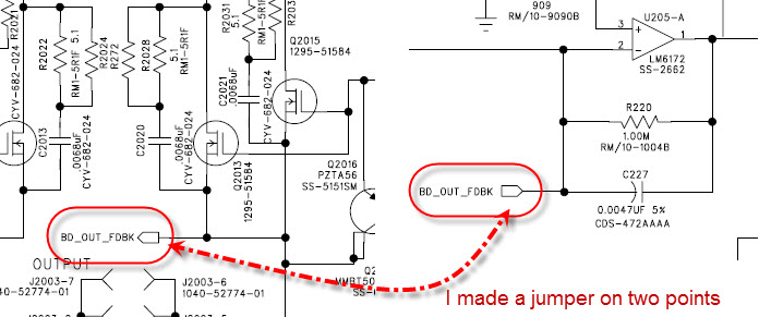

Hello Perry,
It is a constant tone. I can't find C35 in the output card.The capacitors in output card start with C2xx. What IC is it connected to?
In the diagram, I can only find C235 connected to u208 lm 6172 but it is "not used" and not present nor indicated in the actual output card
the PS fet frequency is 24.1Khz to 24.39Khz on both banks
Hello Perry,
I made a jumper on these to BD_OUT_FDBK because I find it open.
Amp fails to produce oscillation now even after I removed the jumper.
Are those two points suppose to be open or should be connected?
