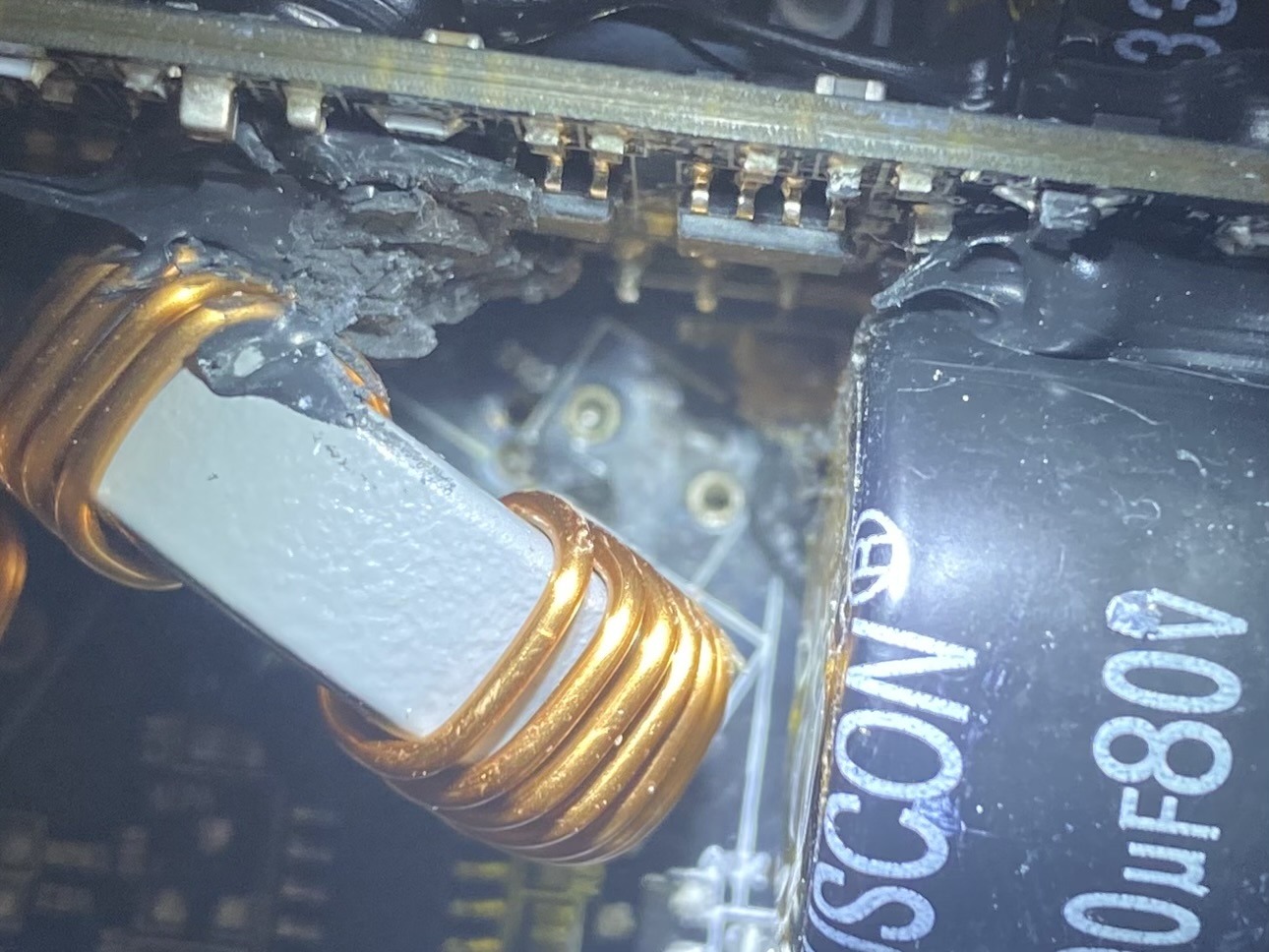

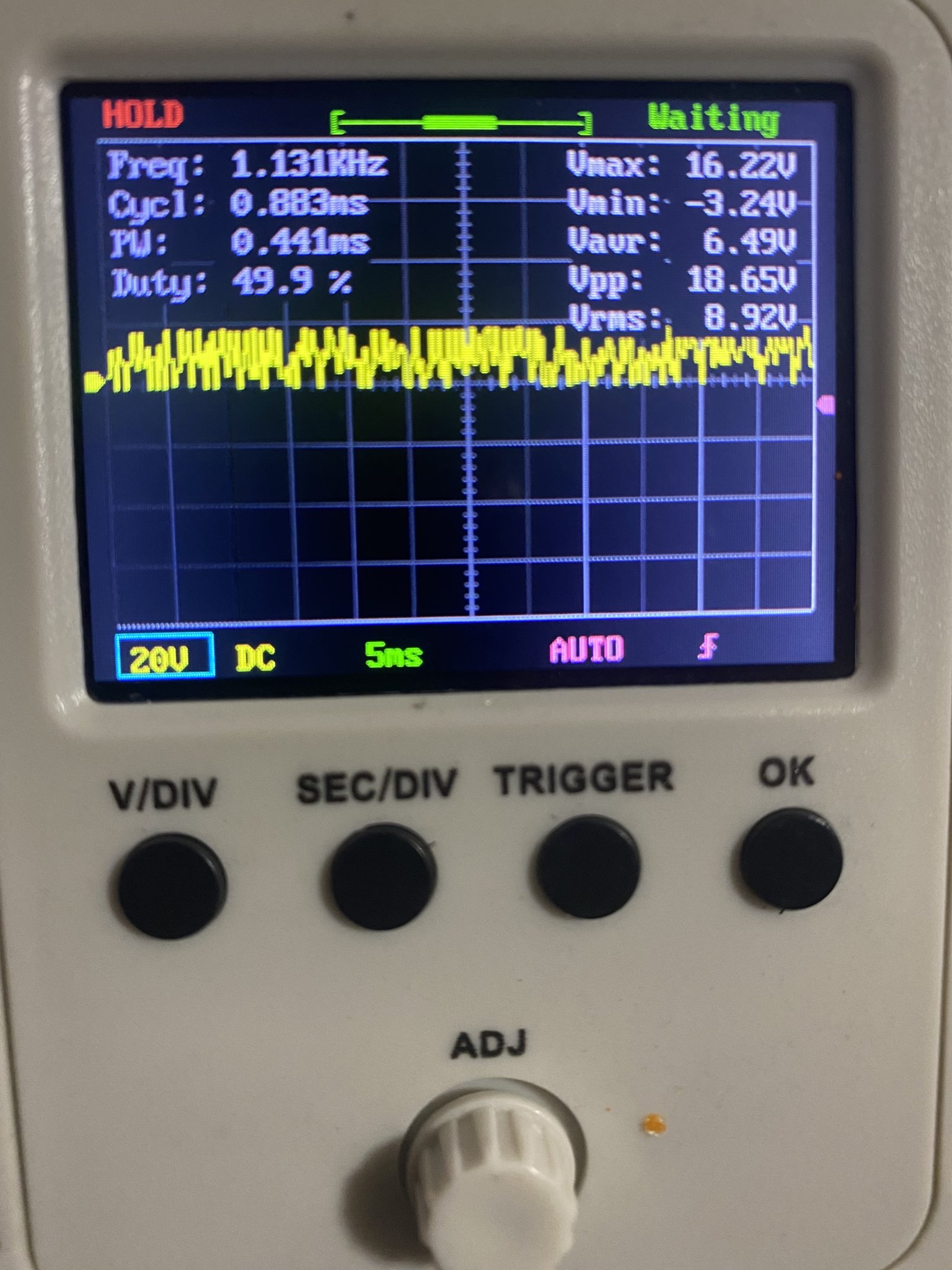

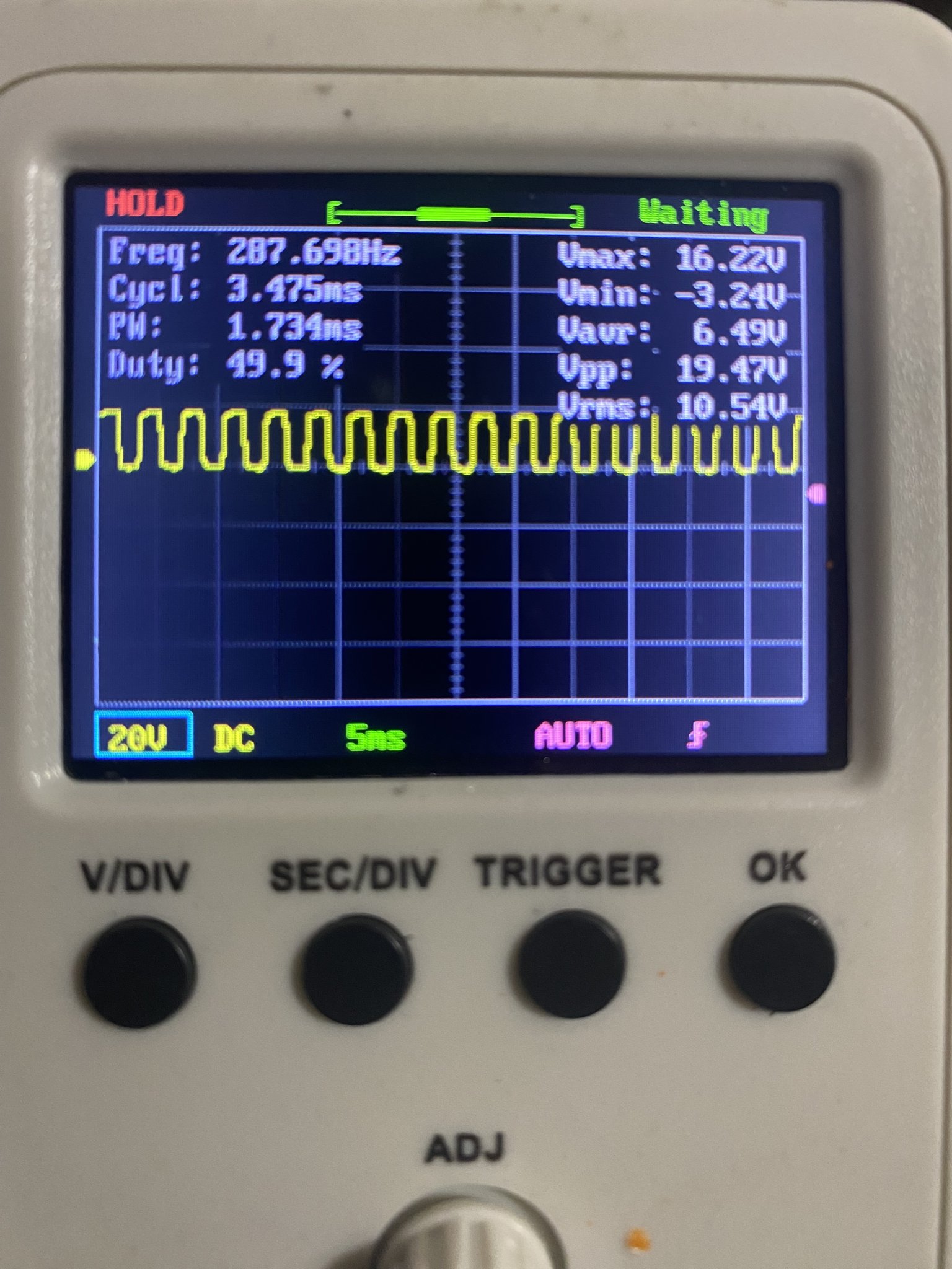

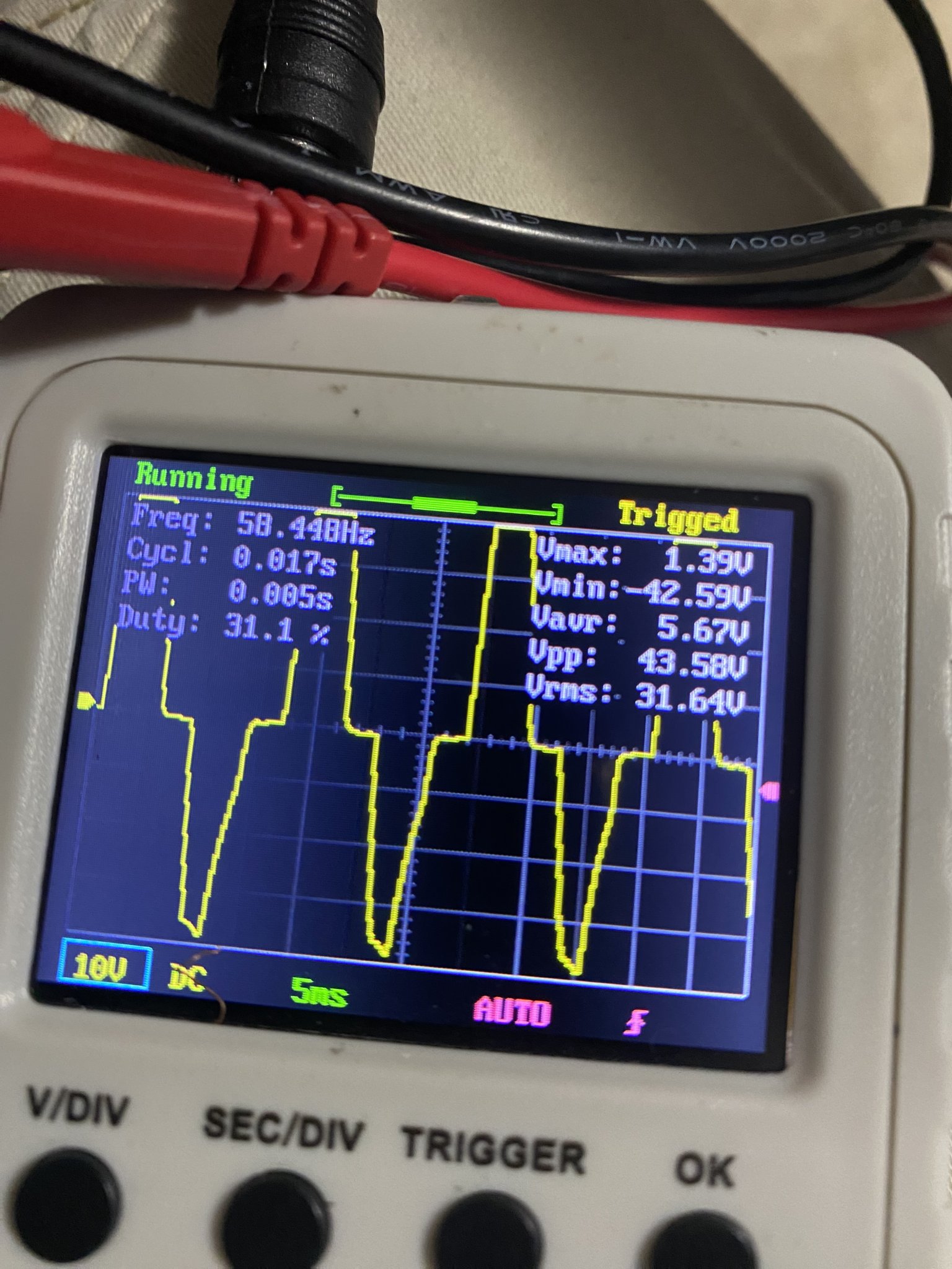

Hi I have a Rockford T1000.5. I has no output, it powers up but makes a buzzing noise and all the clip lights are flashing. I checked all the fets and no issues. I found a 1uf capacitor with a hole blown in it. I removed it from the circuit and I’m waiting for replacement to arrive. I checked the square wave on the ps fet and it start off fine for two seconds then it turns to the monstrosity in the photos. Im thinking there is an issue with the drive IC. Thoughts?

Did you try reducing the 12v supply voltage to see if the waveform cleaned up?
What's the driver IC for the power supply? A boost/flyback will have a different waveform than a push-pull.
I lowered the voltage until it turned off. I turned up the voltage it came back on around 10 volts. It had a squarish waveform and no noise for a second. As soon as the waveform changed the transformer started screeching.
Set it to 5v and 10us. The frequency is 30 when it’s a square wave.
I’m not sure what part of the circuit it came from. The components are absolutely crammed on this board. It was between a vertical board and an inductor.

30k is much better.
It's likely part of the output filter, possibly connected across the subwoofer speaker terminals.
If that's how it'a being used, the output filter inductor may be intermittently shorted. If the cap is being used in that way and it blows again, you will need to find where it's shorted or rewind it with new wire.

I clamped everything back in and moved the inductor and no fluctuations. I did make a mistake with the thermal pads, I cleaned them and applied new thermal paste. I was not aware that Rockford uses thermal pads that are conductive on one side. I installed them backwards by mistake. Took me an hour of head scratching before I figured it out. Everything is working good now.
