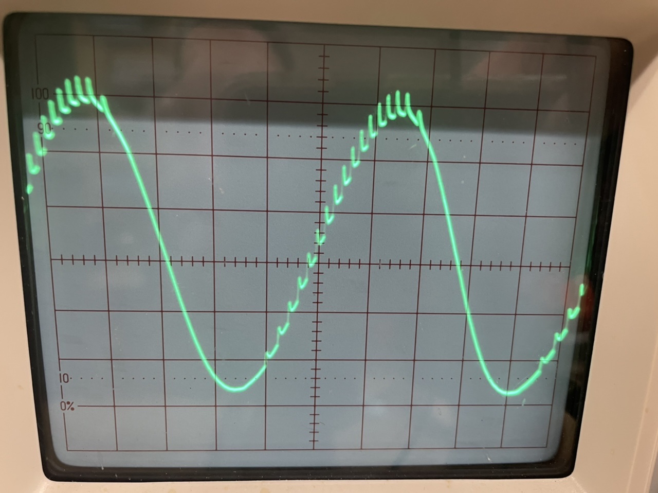

Amp powers and draws 1.2A with bias pots CCW. With no load, Left channel at very low input has artifacts on the top half of the waveform, and the bottom half is only about half what it should be. When increasing input signal, the amp 'freaks' out and outputs garbage to my scope which sort of ends up looking like an MTX power supply drive signal.

Now under 4-ohm load, I'm still getting some artifacting on the top half of the waveform. Artifacting tends to reduce when increasing the bias.
Here is a photo, this time bias CCW (Off), no load. Scope set to 0.5vDiv

I installed all new IRF640/9640 and I'm taking a step back, amp freaked out and starts drawing a bit of current over about 5% input signal. Under that and it still shows like above photo.
