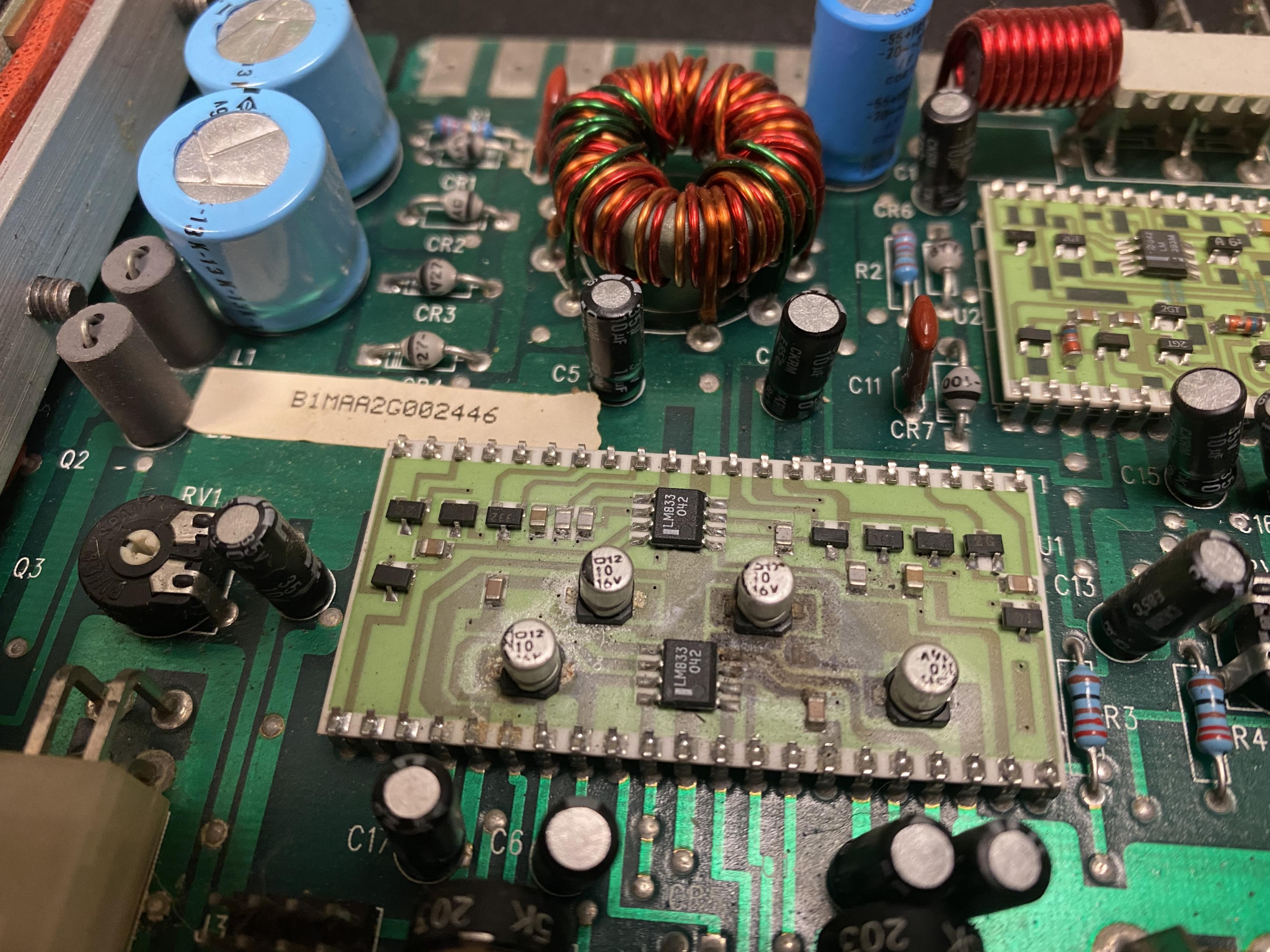

Rockford Punch 30HD
This amp uses this board
If the trace is solid (no printed resistors) between the cap pad and the header pins, solder one terminal there. The traces are solderable (sometimes) so try to gently scrape the green mask off and solder to the metal under it. A fiberglass scratch brush works well for scraping the mask. Lay the caps down and use a drop of E6000 or GOOP to hold them in place.
I have not done the 30HD (also used in the power 100HD) boards yet. There is so little demand. I have found that Perry is correct, depending on the damage you can solder and repair the boards sometimes. Somewhere I have the board drawn on paper, if one of the traces passes to a resistor and you need to bypass that resistor (the dark printed on resistors) with a wired resistor, let me know and I will give you the value.
