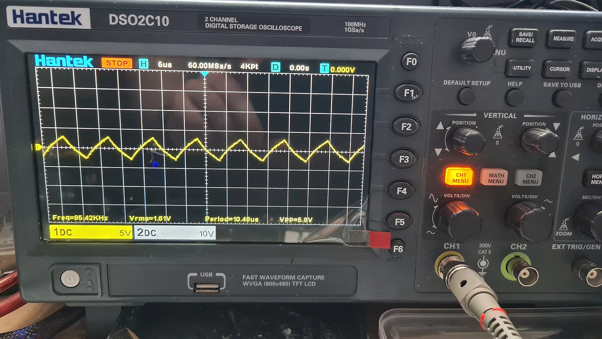

Suppose ne5532 is not working correctly. = I've already swapped NE5532 with a new one, it's not the IC itself, but something around it.
Both outputs must be exactly the same. = indeed, but they are not, so something around it causes the issue.
Can u post a oscillogram picture of pin 5 of lm393 (triangle wave) ? = Check below, I just don't remember what I've referenced it to as i'm not in front of the amplifier now.
