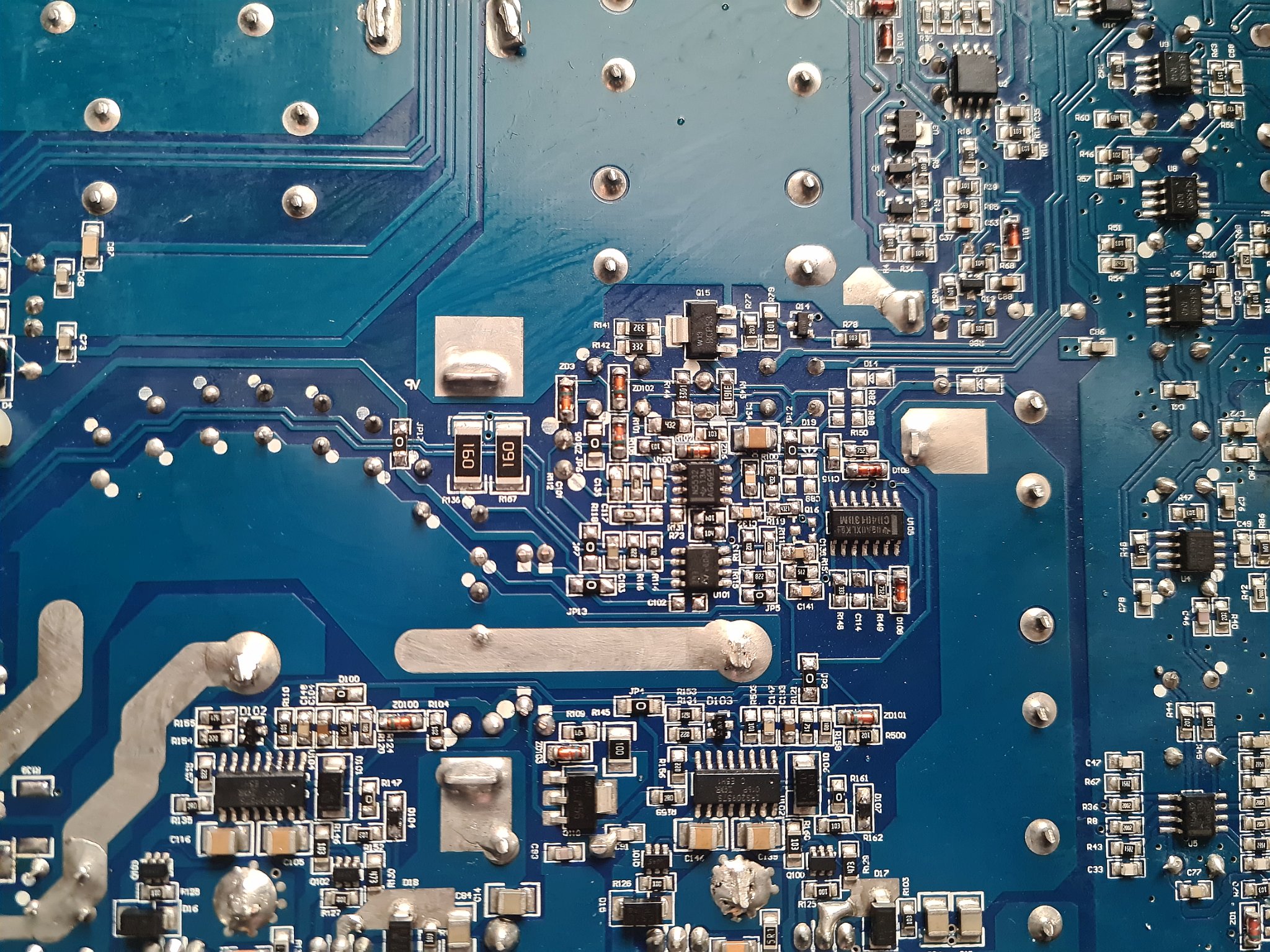

Have this amp for a repair. No class D switching, nothing in short.
Was mounted freely in a trunk, an object hit it really hard looking at the deformed metal heatsink.
SMD caps C117, C141, C102 were cracked/split in half, maybe I will find more like those while poking around. Does anybody has schematics around the PWM / flip flop ic section or can tell me what are the values for those smd caps in the attached picture ?

The information I have doesn't have C114 or C141 so it's not likely the same as your amp.
The amp has 2 circuits for the output. Dod the corresponding caps for the other circuit survive so you could measure those to find their values?
Contact Rockford to see if they can help.
They have few different revision and there are differences. That's why i've posted the revision in the picture attached.
Not sure what survived and what not...Can confirm the PS section works now, but there is nothing at the irs20957s input pin 3. No PWM.
R140 + R139 + R138 are 2512 resistors 16 and 27 ohms, also cracked, there are signs of burning around those pads too.
I've already did some work in the PS section thanks to the attached schematics found in the forum here. But found only the PS section.
I've replaced the caps with 1nf.
I do have switching now at one of the amplifier (it's a full bridge) the other one has 10v of DC at the input, pin 3.
While amps starts R140 + R139 + R138 are getting extremely hot and burns, I'm using now thru hole higher wattage resistor not the smd ones, as they don't survive the initial start up procedure. I suppose this happens due to the imbalance of the both amps being in a full bridge configuration and one of them working as it should but other one not.
The 393 gets it from the 4013, doesn't it? One of the Q or not Q terminals?
180k is probably too high. On notes from a JX500, the oscillation for the outputs is 83k. This could be part of the problem with failing parts, although I don't know what R140 + R139 + R138 are in your amp.

There are also a lot of zeners in the region, they are not shorted, but how I know if the regulate properly ?
IC1 works fine.
IC2 - no output, neither LO or HO .
Both IC have exactly 12.5v as a supply voltage.
I don't think IC2 will produce anything if pin 3 IN is just DC.
