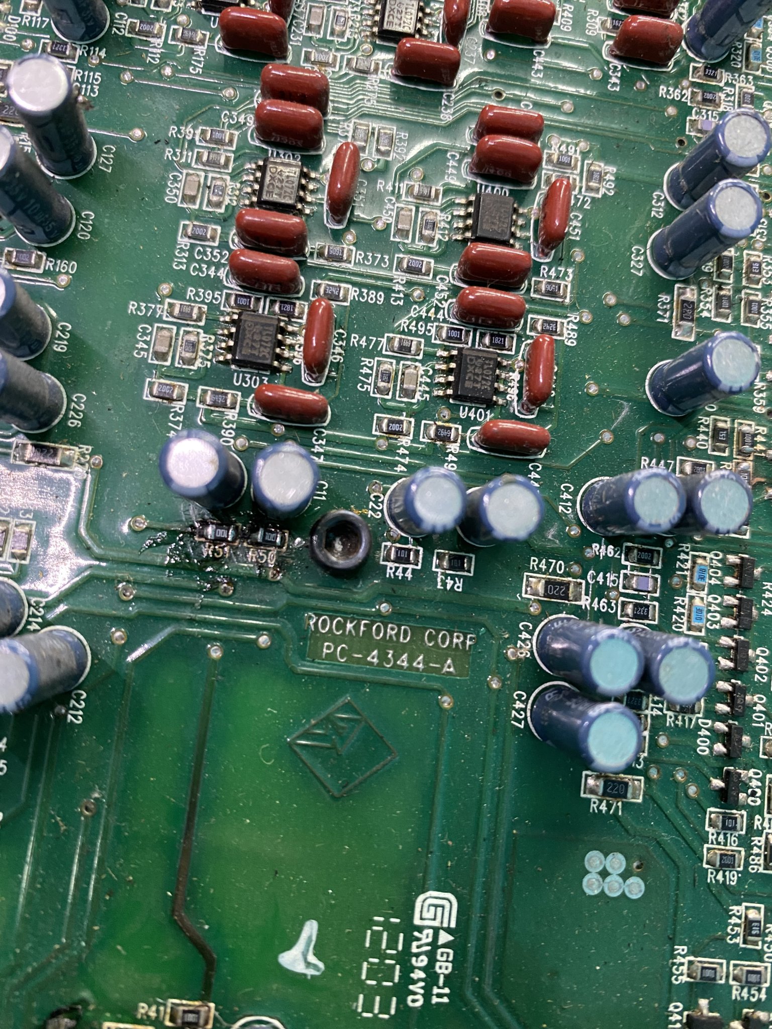

H Hexhclass Member Joined 2010 2023-10-31 2:45 pm #1 2023-10-31 2:45 pm #1 This amp has no output.R51/50 burnt and also D3. On the Lm317 1: 35.16 2: 35.88 3: 37.46 I replace the 317 but no change.Any suggestion? Attachments BAFD8986-1CE9-46E1-8C2A-E3F6765F5C23.jpeg 746.1 KB · Views: 76 H Hexhclass Member Joined 2010 2023-10-31 4:28 pm #2 2023-10-31 4:28 pm #2 Found an open ground,problem solved P Perry Babin Member Joined 2003 bcae1.com 2023-10-31 4:34 pm #3 2023-10-31 4:34 pm #3 Confirm that you read 1k from the RCA shield (no RCAs plugged in) to the primary ground. You must log in or register to reply here. Share: Facebook X (Twitter) LinkedIn Reddit Pinterest Tumblr WhatsApp Email Link
