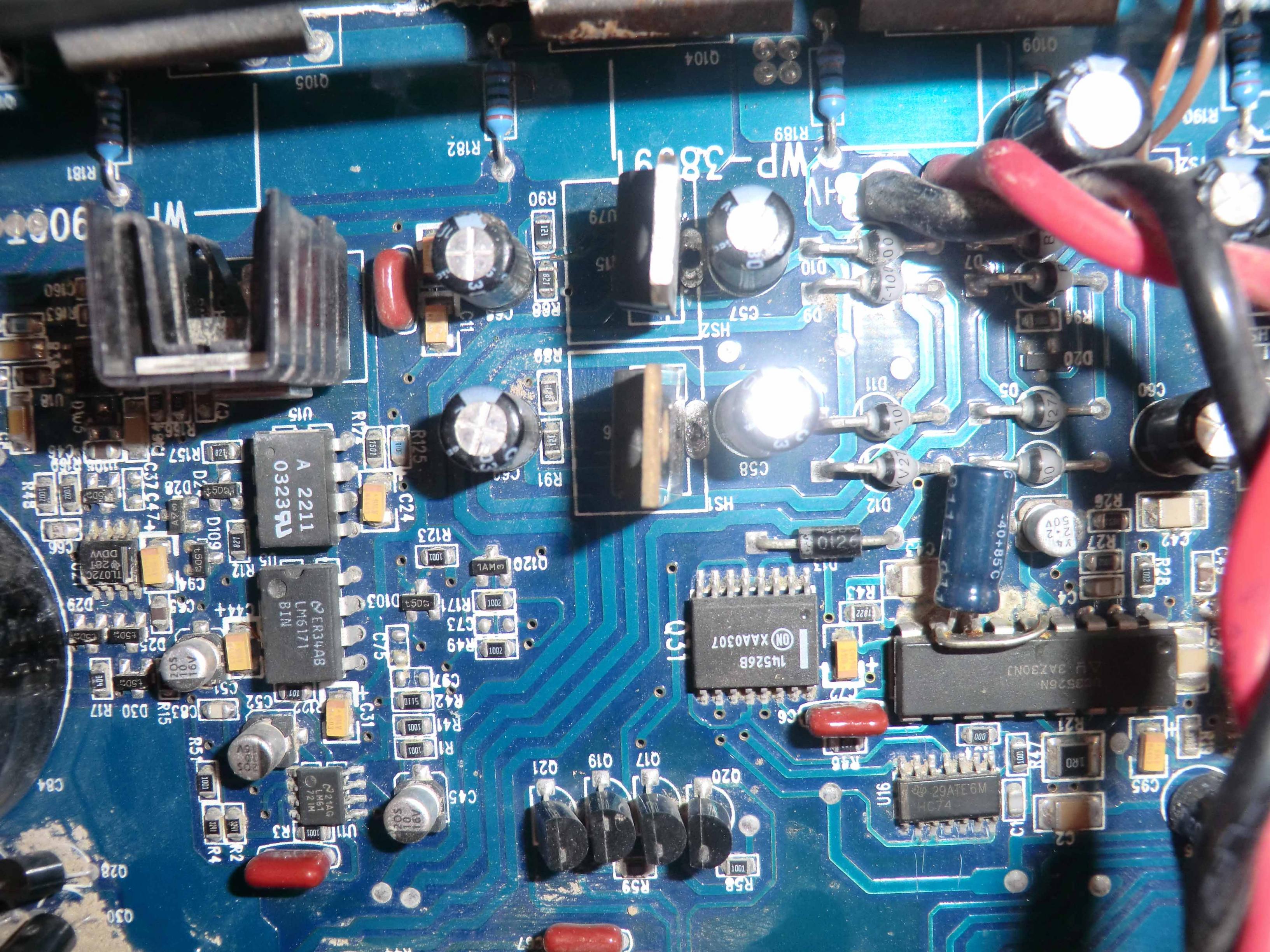

I ask for your help!
would like to know the number of controller that takes the amplifier where indicated in the picture
HELP PLEASE!!!!!!!
HELP PLEASE!!!!!!!

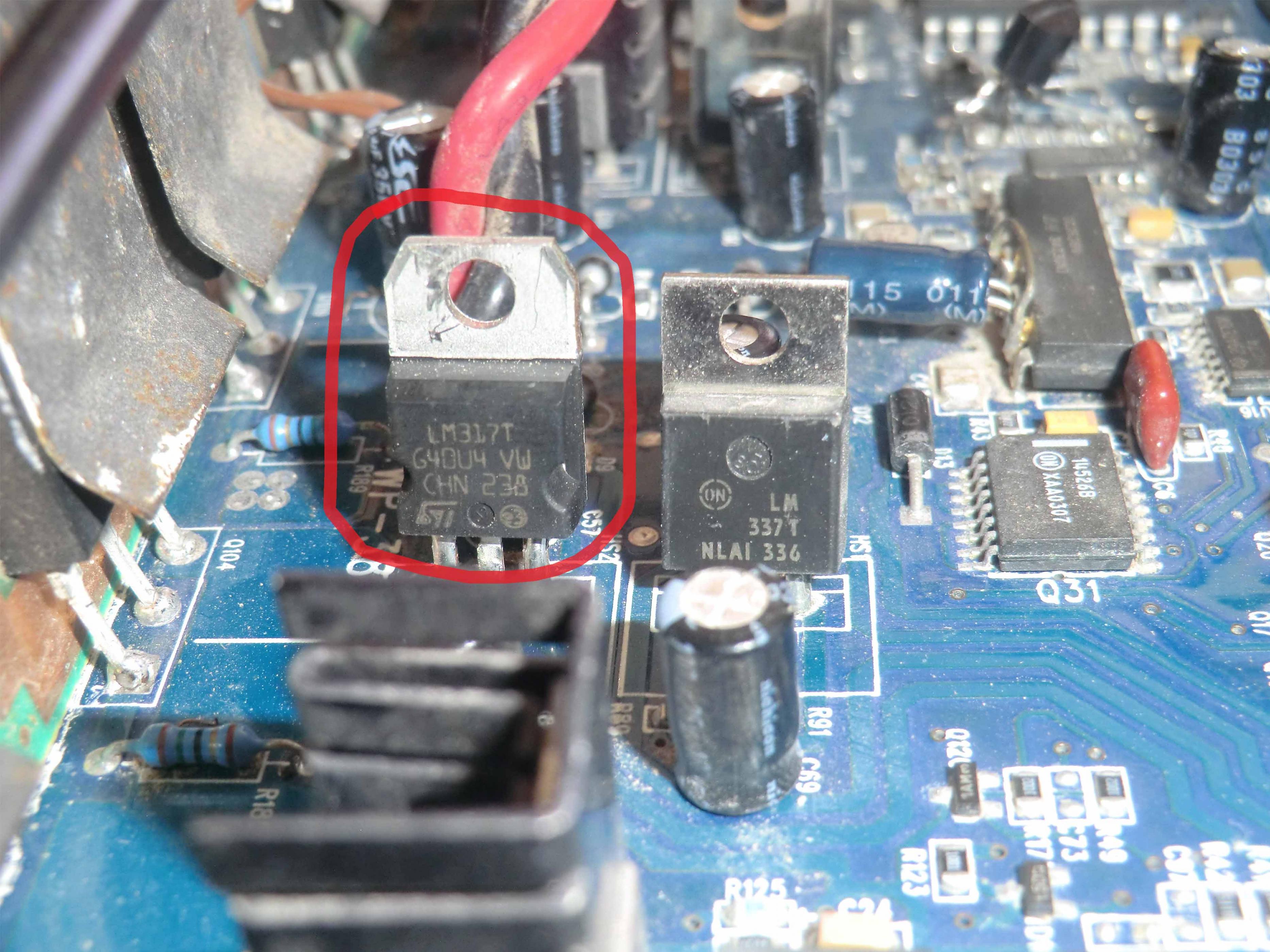

would like to know the number of regularly takes the amplifier qe where indicated on the image
help please!!
help please!!
The devices in the heat sinks you have circled are positive and negative voltage regulators.

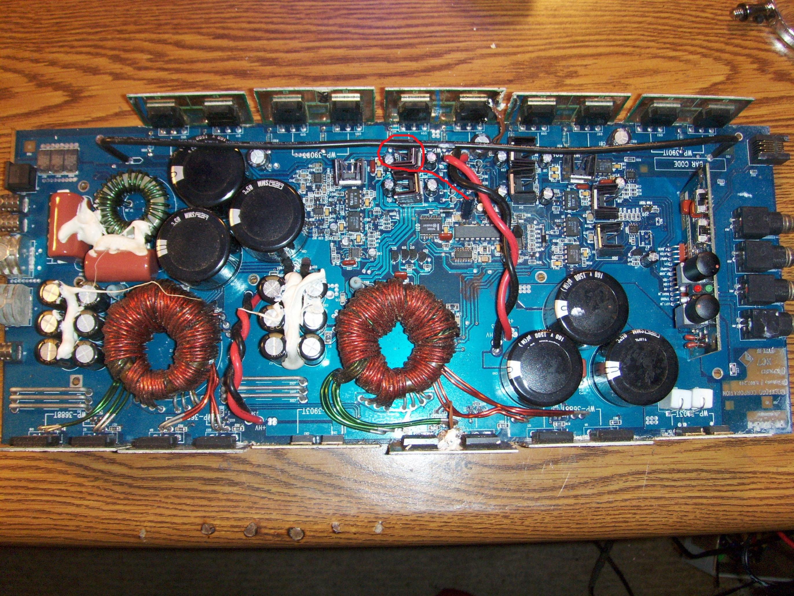

I need the board location, but its either a LM317 or LM337.
Never power this amp up without the heat sink soldered in place for the voltage regulators. They will quickly overheat and fail.

checking the amp is in good condition throughout. The source, outputs, etc all be fine but stops when connecting the amplifier LM317 regulator protects and warms
What can be the cause?

I'm working on one of these amp right now. I'm having similar issues as described in the first post.
SeanKane, do you have the schematic for the pre-amp board? I contacted RF, but they could find only the schematic for the rest of the amplifier (not the pre-amp) 🙁
