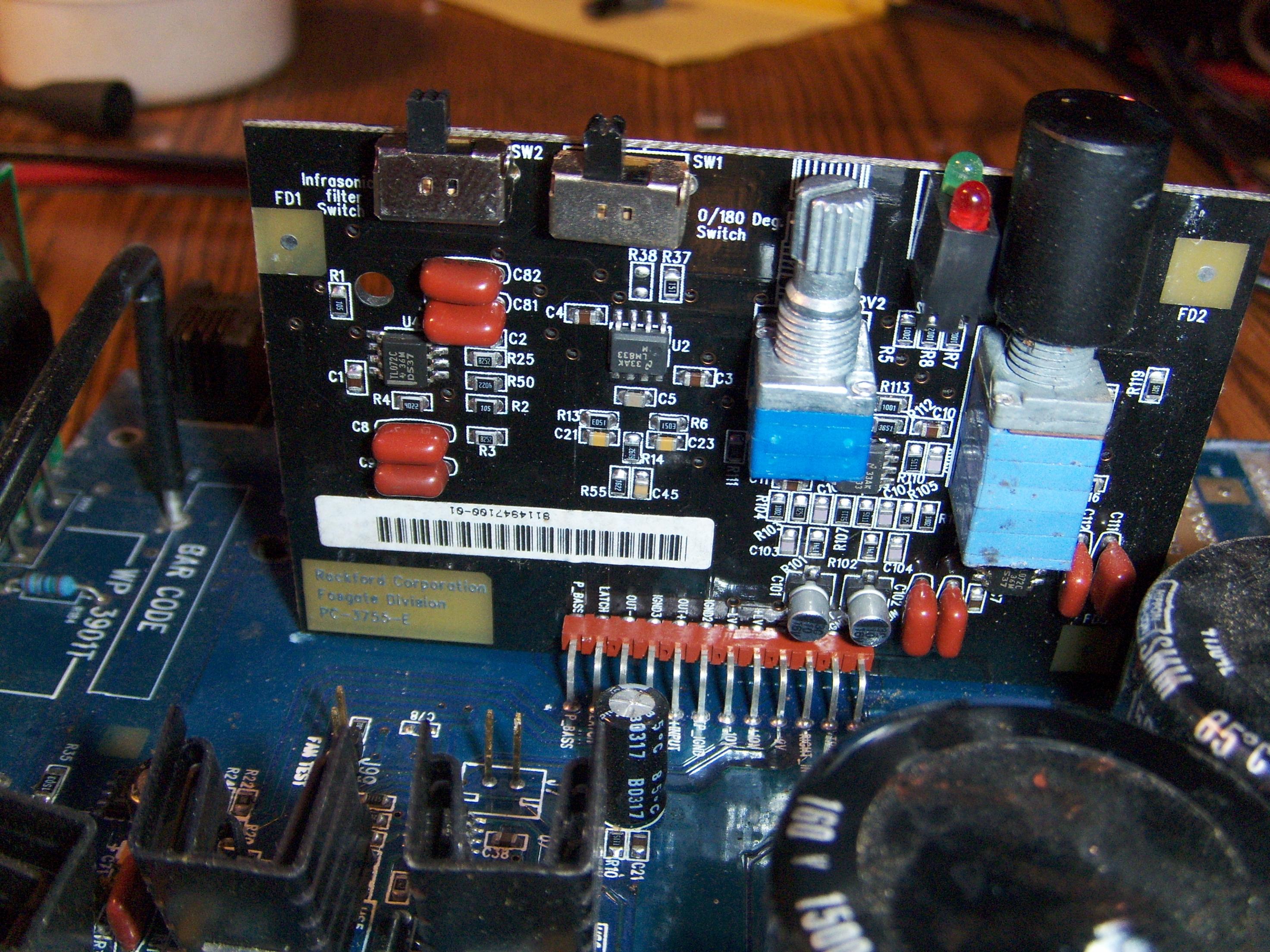

Hello all, I have RF X7 board number PC-3758-H
The amp powers up and idles fine, no DC on output terminals, and is not in protect.
I tested for output and the output is very low and viewing it through the scope it is low as well and intermittant. I messed with the gain knob and it spikes to full rail on the output terminal when turning the gain pot and the gain pot does not increase the output.
I am going to switch out the gain pot to a new one but my question is, could the pot being shorted or bad cause this symptom or is there something else I might look over as well?

Look at the preamp level signal before it gets to the amplifier section to see if it's good or bad at that point.
OK well if I switch the infrasonic switch it puts over 100 vdc to the output terminals and kicks the protect.
So far I have changed the infrasonic switch and the gain pot.
Why would the infrasonic be putting so much DC on the output terminal?

OK Perry bare with me here I have been attempting to read schematics again.
U2 and U3 have 11 vdc on their outputs.........so...............
Signal enters U1 from pins 2&3 and 5&6, then leaves U1 througn pins 1&7 which have no DC.
Enters U2 pins 2&3 out pin 1 to pins 5&6 then out pin 7.
U2 has 11 vdc on pins 1&7
Enters U3 pins 2&3 leaves pin 1 to pins 5&6 then out pin 7.
U3 has 11 vdc on pins 1&7
Enters U4 from there and U4 has no DC on output pins. So switching the infrasonic switch must enable or bypass U4 depending on switch setting?
If U4 is bypassed the switch would send DC from U2 and U3 to where ever it goes next. If U4 is enabled, why is it not getting the DC from the output pins on U3?
Where is the 11 vdc coming from on the output pins of U2 and U3?

I replaced U2 and U3 the amp works great, but if its not to much trouble could you give a few answers fro, post 7? Was I close on reading the schematic?
