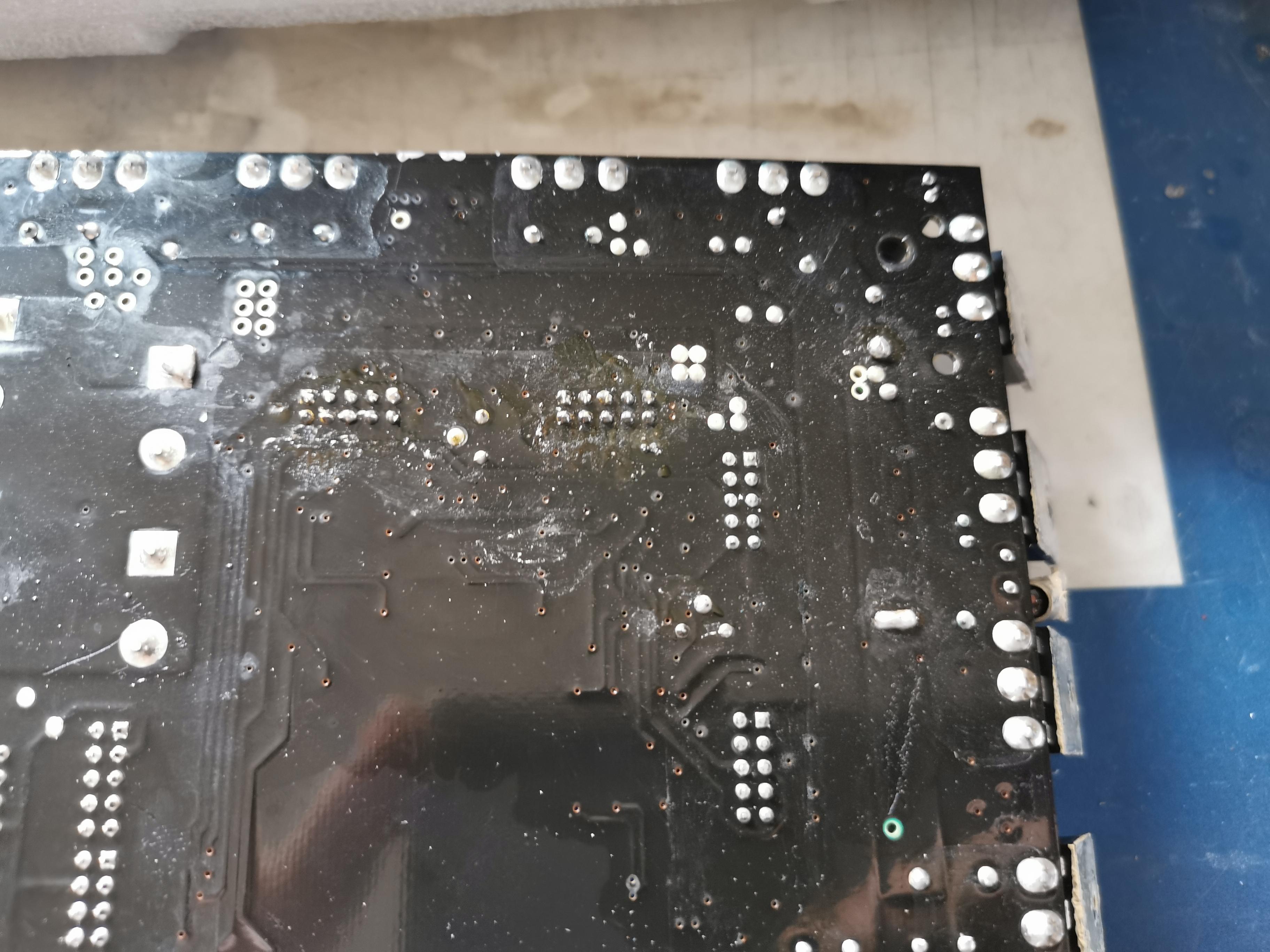

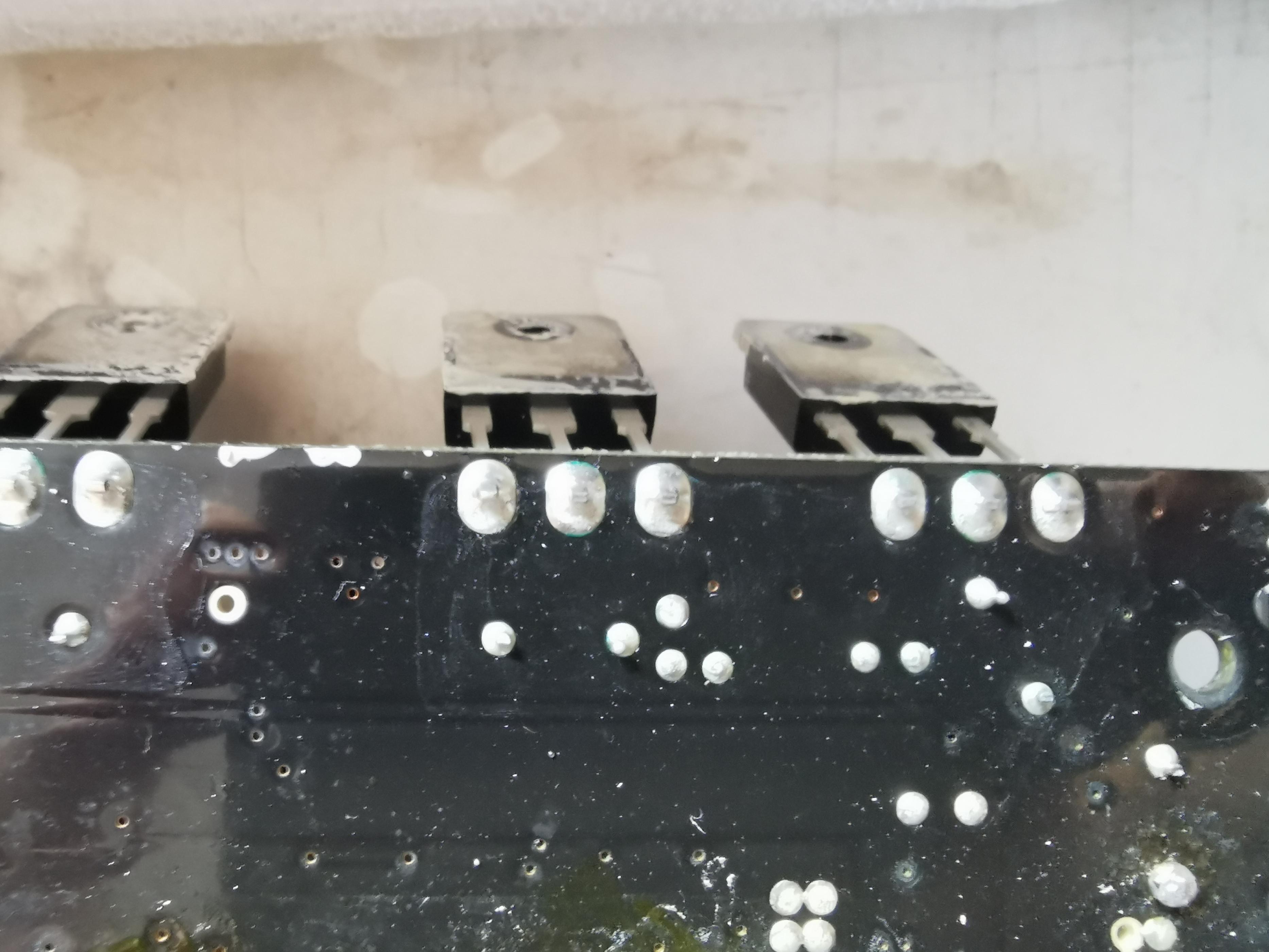

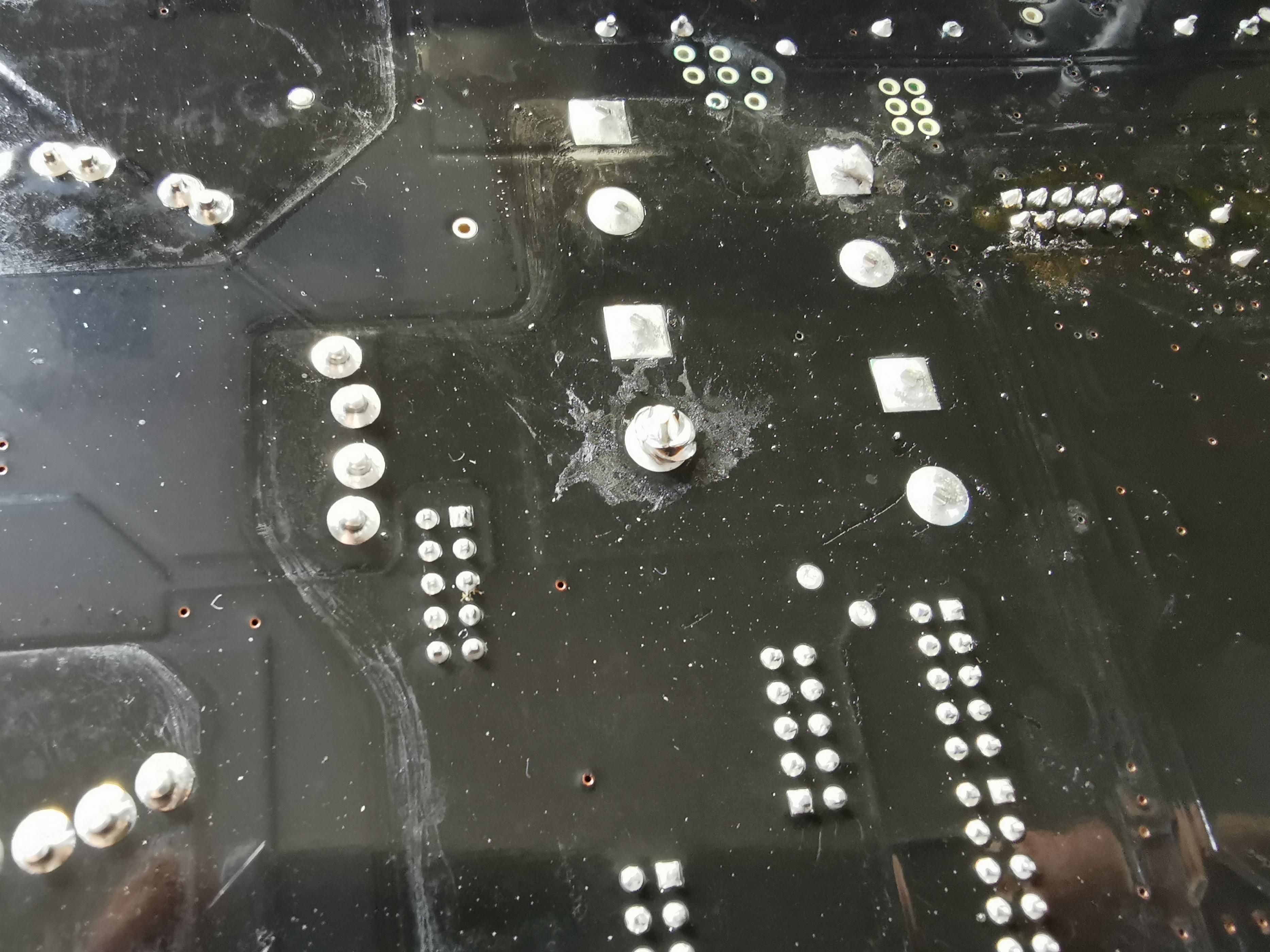

If i touch the 0,1Ohm resistors, the crackling changed. I removed the board, and found a bad repair. Also it seems, that the board was wet before.. Some green spots on the vias and solder joints.

I do not. I haven't seen colder solder issues in any Rockford amp, as far as I can remember. The exception is for components that have overheated due to other problems (snubber resistors and such). It's actually almost unheard of in any amp except some that are single-sided (generally where the through-holes are too large).
The only types of boards that I've seen with solder issues were the double-sided CEM boards without feed-throughs that have solder connections on both sides of the board for a single component terminal. For those, you can expect problems.
