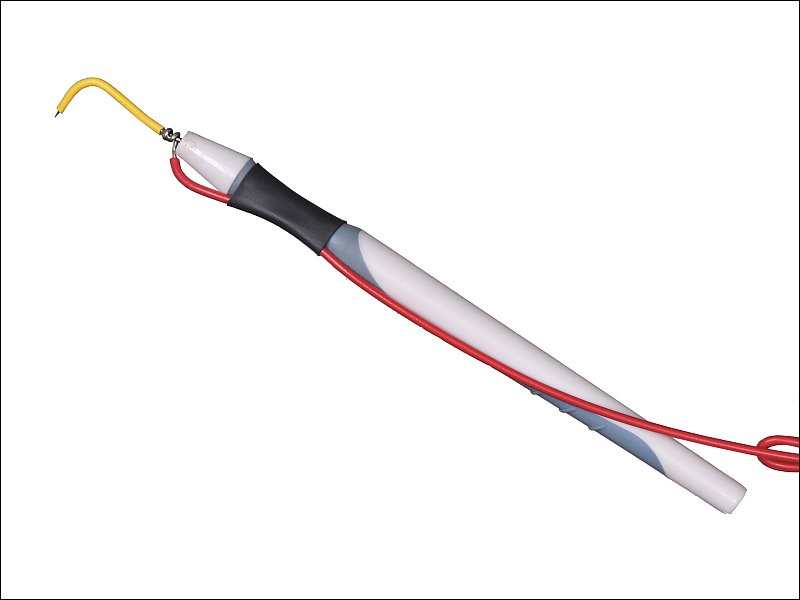

It's a dental pick. It an other options are shown near the bottom of the 'know your meter' page.

No sir, what I did was bend a meter lead tip, and put heat shrink on it and measured the op amps in board

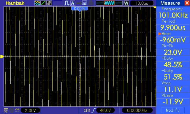

Post a photo of the waveform on pin 5 of U205. Scope, center trace on reference, dc coupling, 2v/div and 10us.
Are you sure you were on the right point? I don't think the amplitude would have been more than about ±5v.
