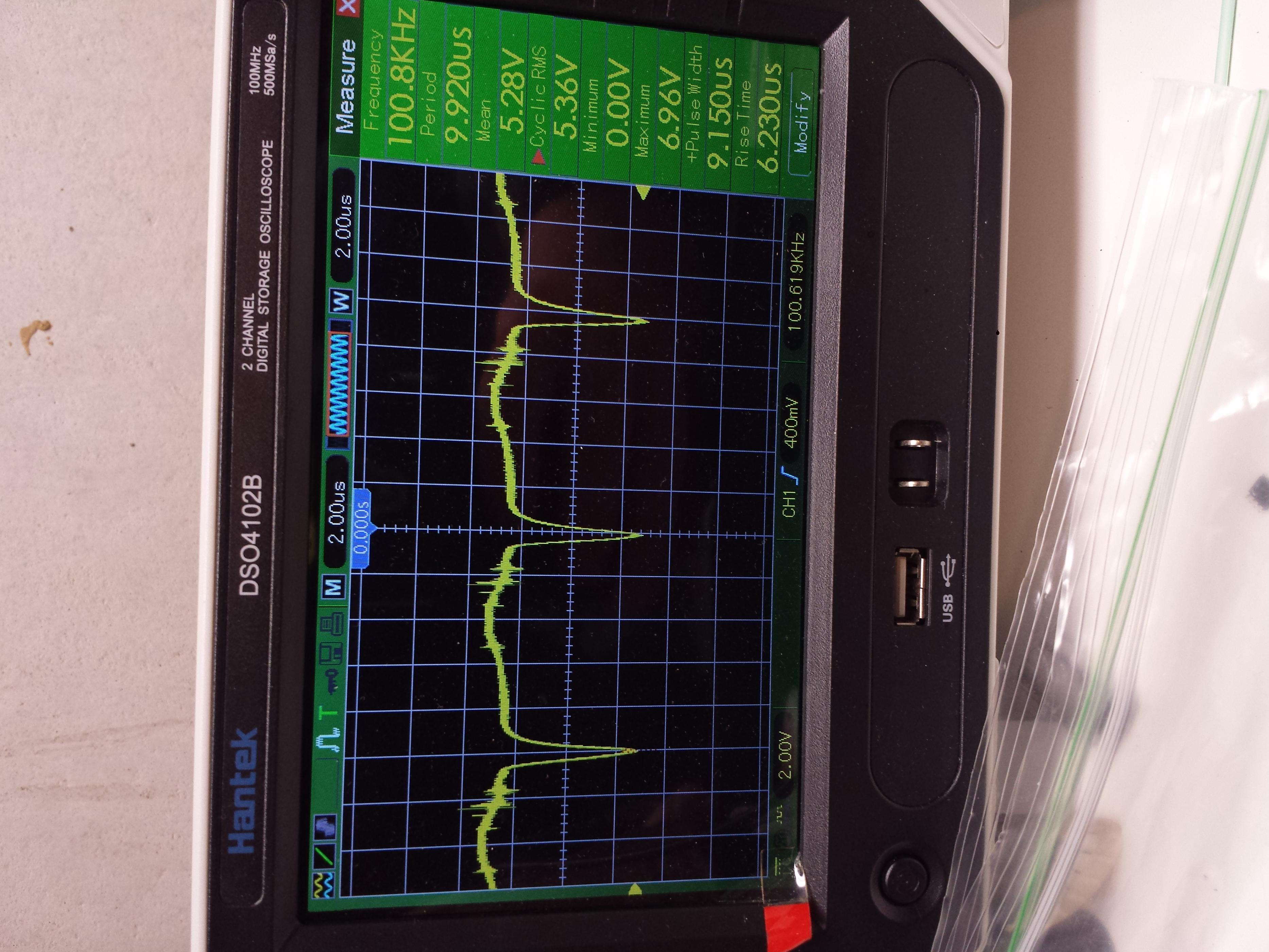

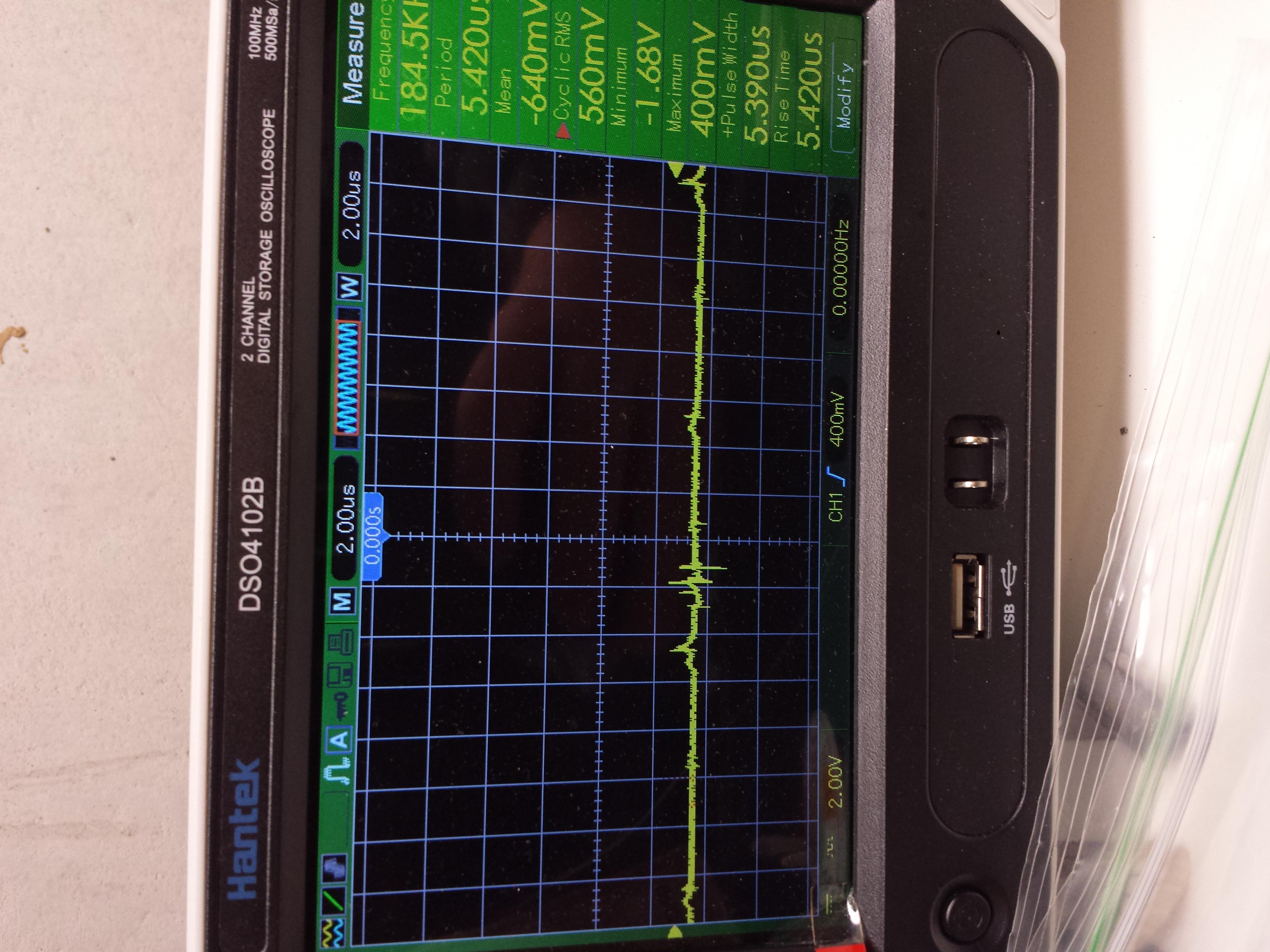

Perry I did scope probing this morning trying to find my drive signal with no luck. Interesting enough, the square wave on the output of the gate driver ic would change by cycling the power. I never had 4 drive signal 2 at most and they switch banks after power cycle...kinda weird. So I was looking for the pwm waveform. Is this suppose to be a square wave? Here is the waveform for both ic chips pin 2.

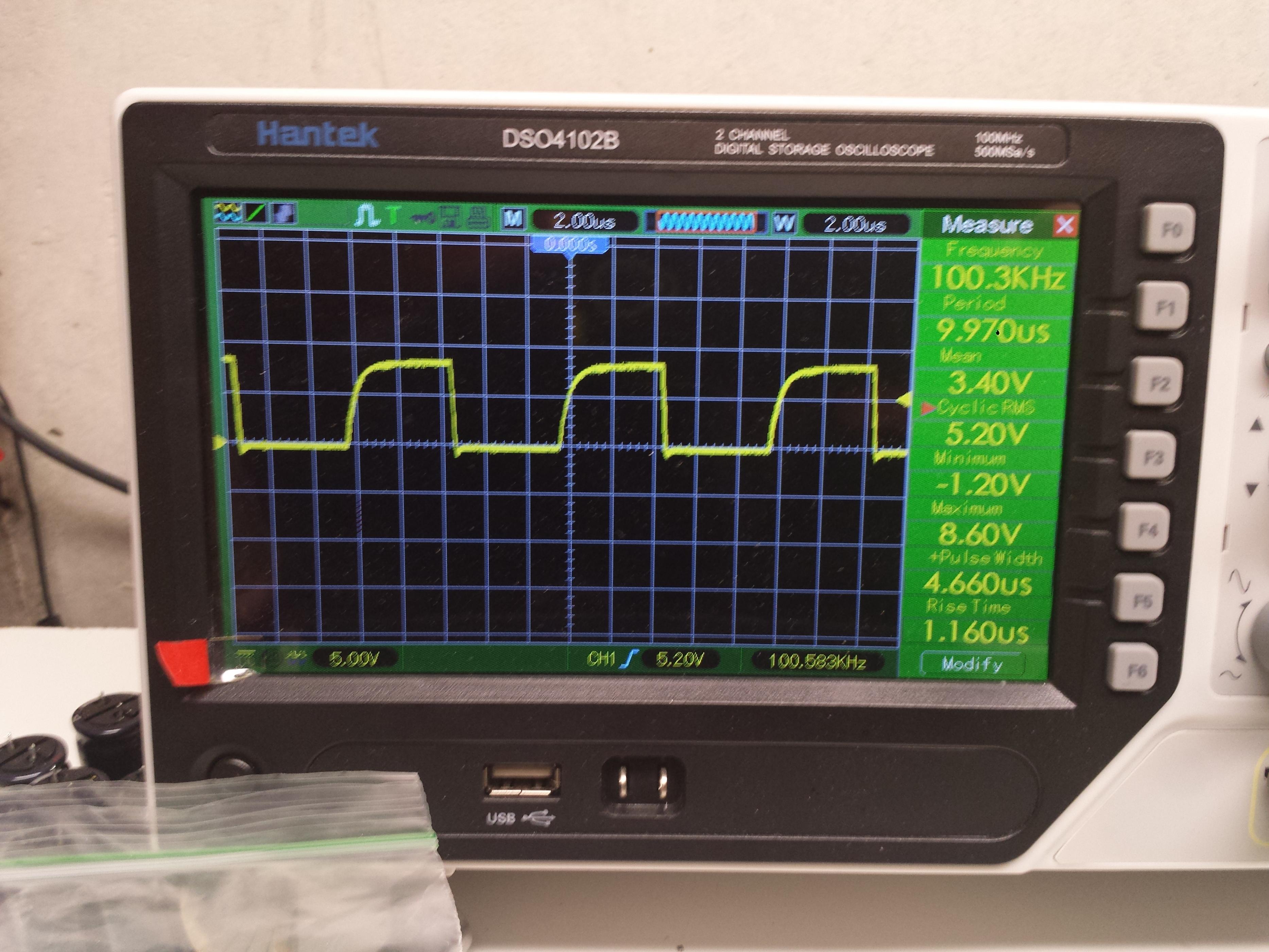

So not sure if that wave form is normal but I expect them to look the same at very least. Correct me if I am wrong. So now I checked pin 7 on U307 and U301 and this what I got. Oh pin 5 on both had a nice triangle wave form.

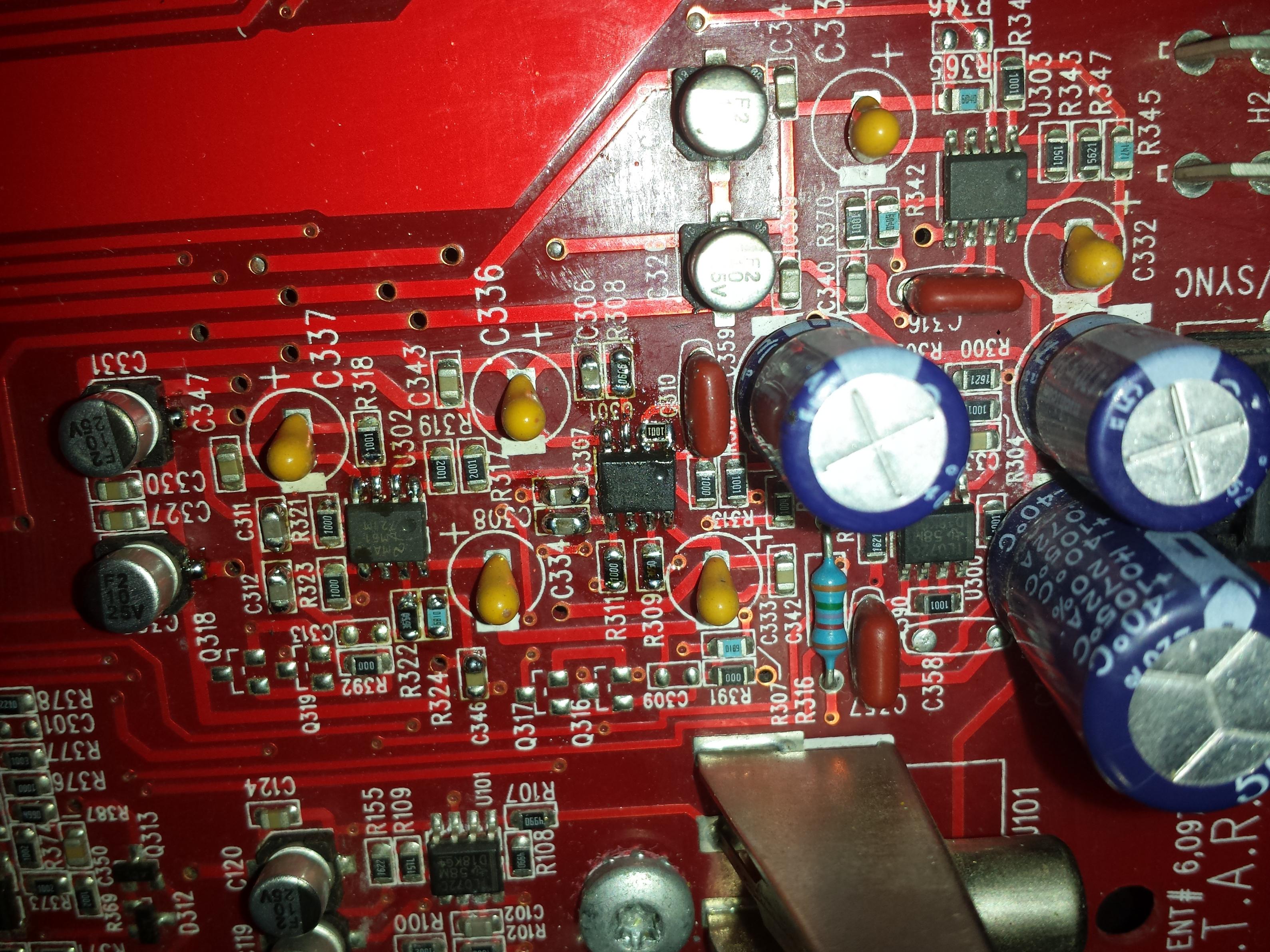

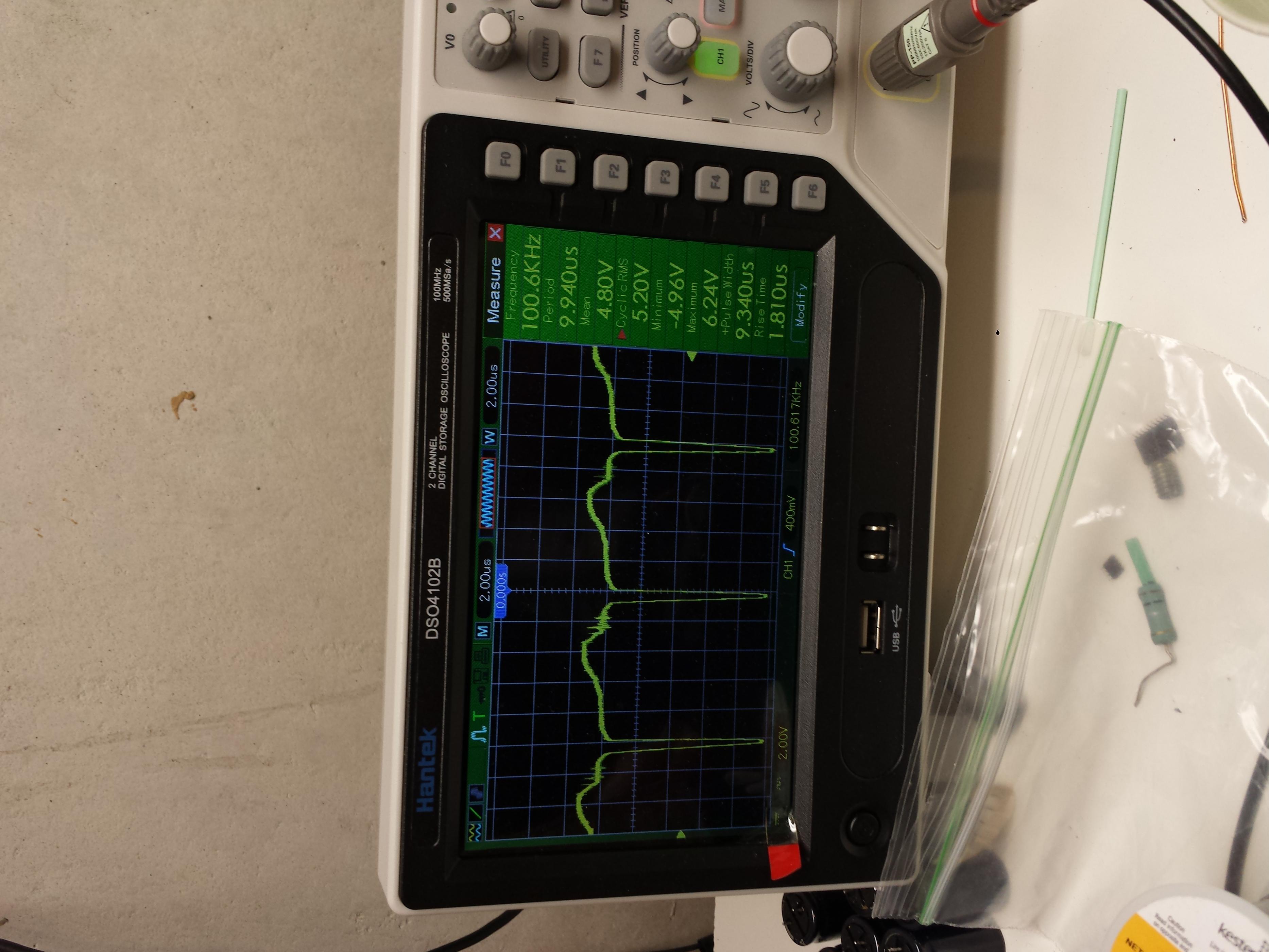

S u nce I added that 1k resistor on the feedback loop it dropped the dc offset from 5v to nearly nothing. Since there was no offset then the amp thinks it is operating normally. Now does this mean I have an issue with u301 possibly causing the 5v offset?

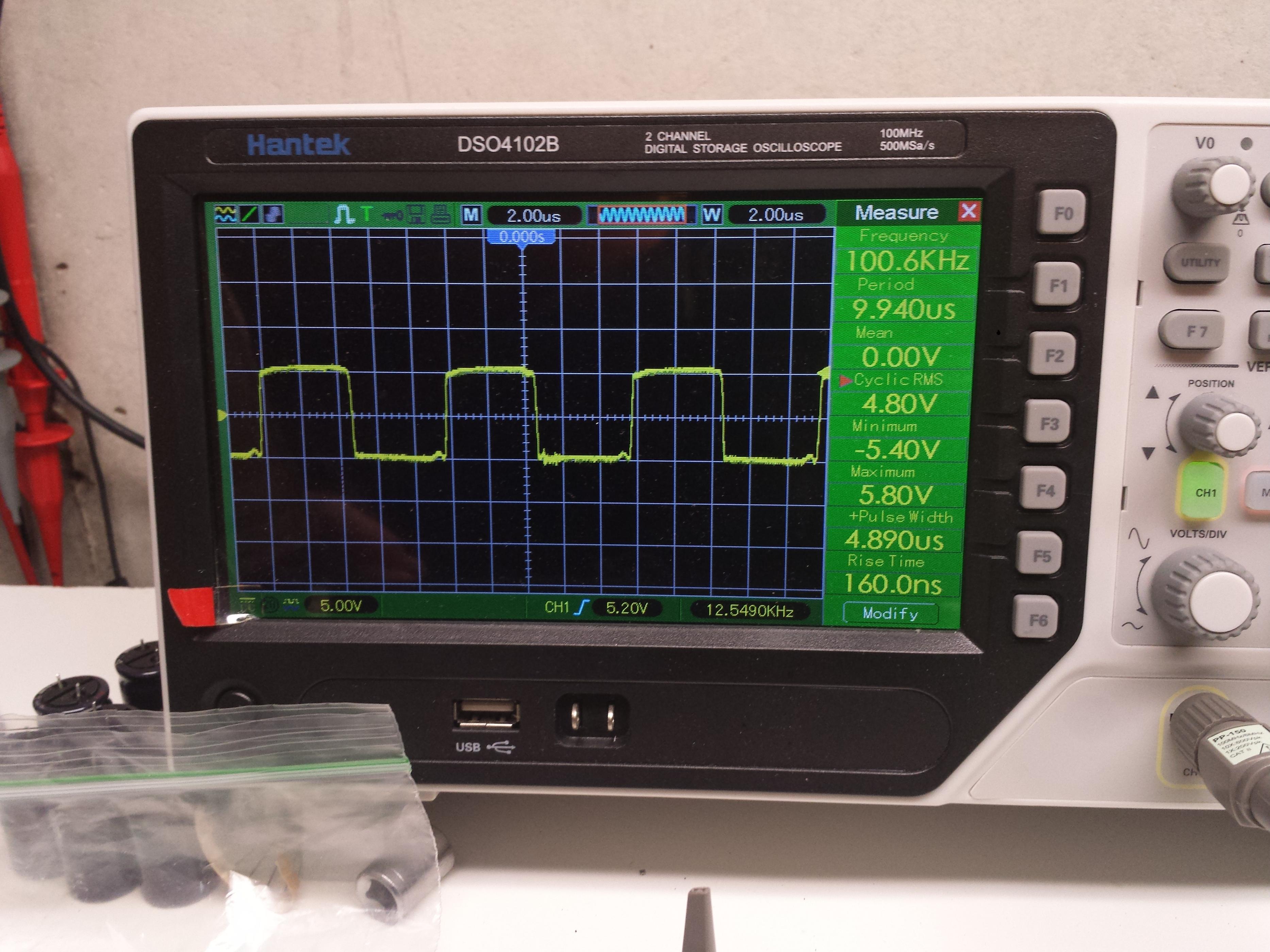

I soldered in a smt resistor of 1k across the leads. Attached is a pic of the resistor in place, the output of U301 pin 7, and the drive signal on the FETS.

I powered up the amp with the HV wires connected to see if I have audio. The FETS were operating correctly it seems and the rail voltage equilized. I did notice a 1.3 vdc on the output. I thought this was strange I connected the audio anyways just to check. With 60hz test signal I saw no audio.
No. The switch is well before that point but it could block the audio.
The 1k resistor can't be installed for normal operation. If the amp wouldn't function when the rails were connected, there is another problem.
If there os no feedback from the output, you could have a broken connection.
