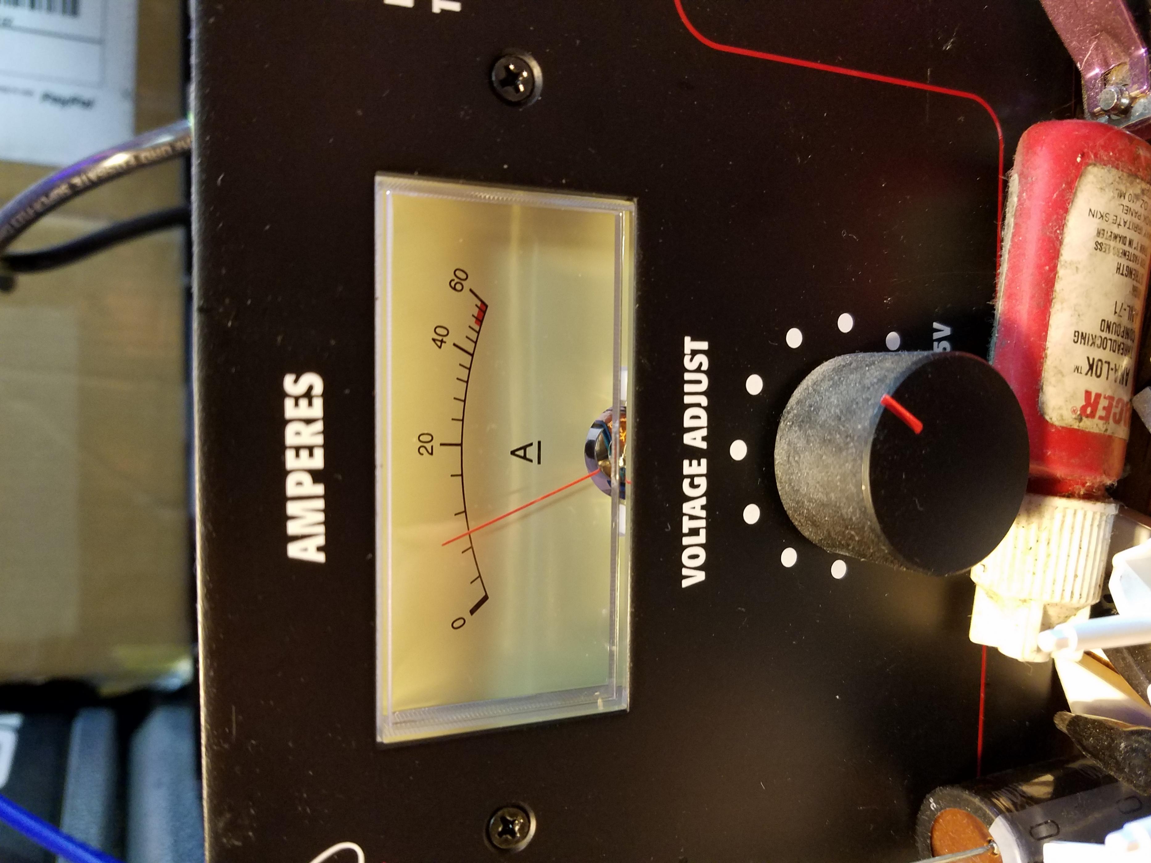

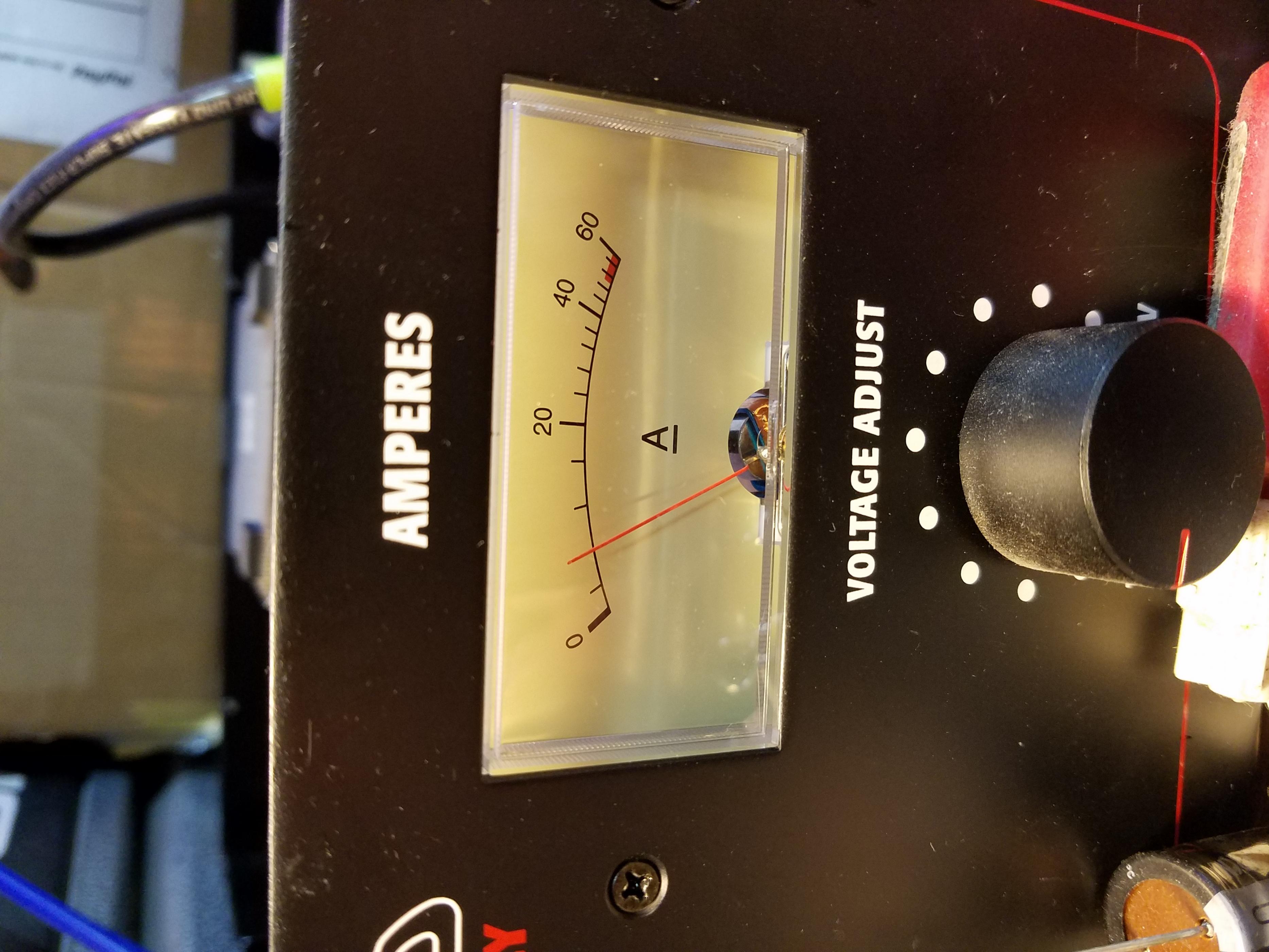

For one 2500 that I have here, the amp draws about 2.1 amps before the class D is engaged and about 4.4 amps after.
The amp I have has the 55947 driver board.
I've never let it idle for more than 2-3 minutes and played audio for only a minute or so. I didn't want to risk damage just in case. I haven't noticed anything getting hot other than the 2 large white resistors next to the regulators.
One thing I will add the current draw is sensitive to voltage input adjustments from the power supply. The lower the voltage the less the draw, the higher the voltage the bigger the draw. If I get up around 14.50 volts in the current draw pulses a little on the meter.
Its hard to tell the exact draw with my meter as I don't have a clamp.
I posted 2 pictures one at 14.4vdc and one at 12.8 vdc

Sometimes its a little higher than these photos like with a load connected and a source connected but not much.
I'll confirm this tomorrow and post results. So as soon as the cap reaches 4vdc on the positive terminal the output stage switches on correct?
If I still have the draw then I'll know there is a problem in the power supply.
If I don't it must be in the audio side. Its hard to know how much the audio side should draw. Other 2500's I have had here did not draw this much current.
For the amp I have here, the input voltage 12-13.8 didn't make the current draw change more than a tiny fraction of an amp.
