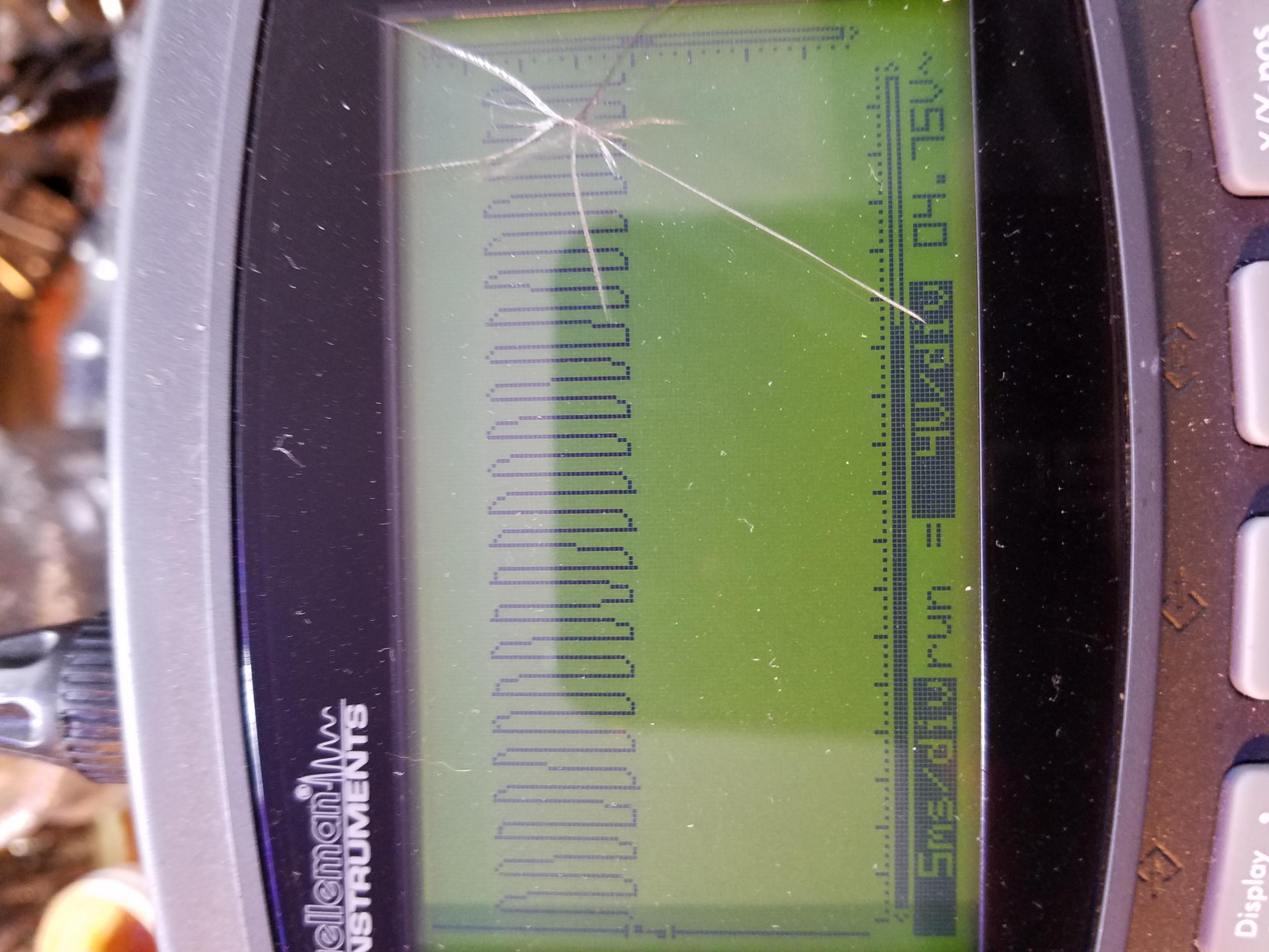

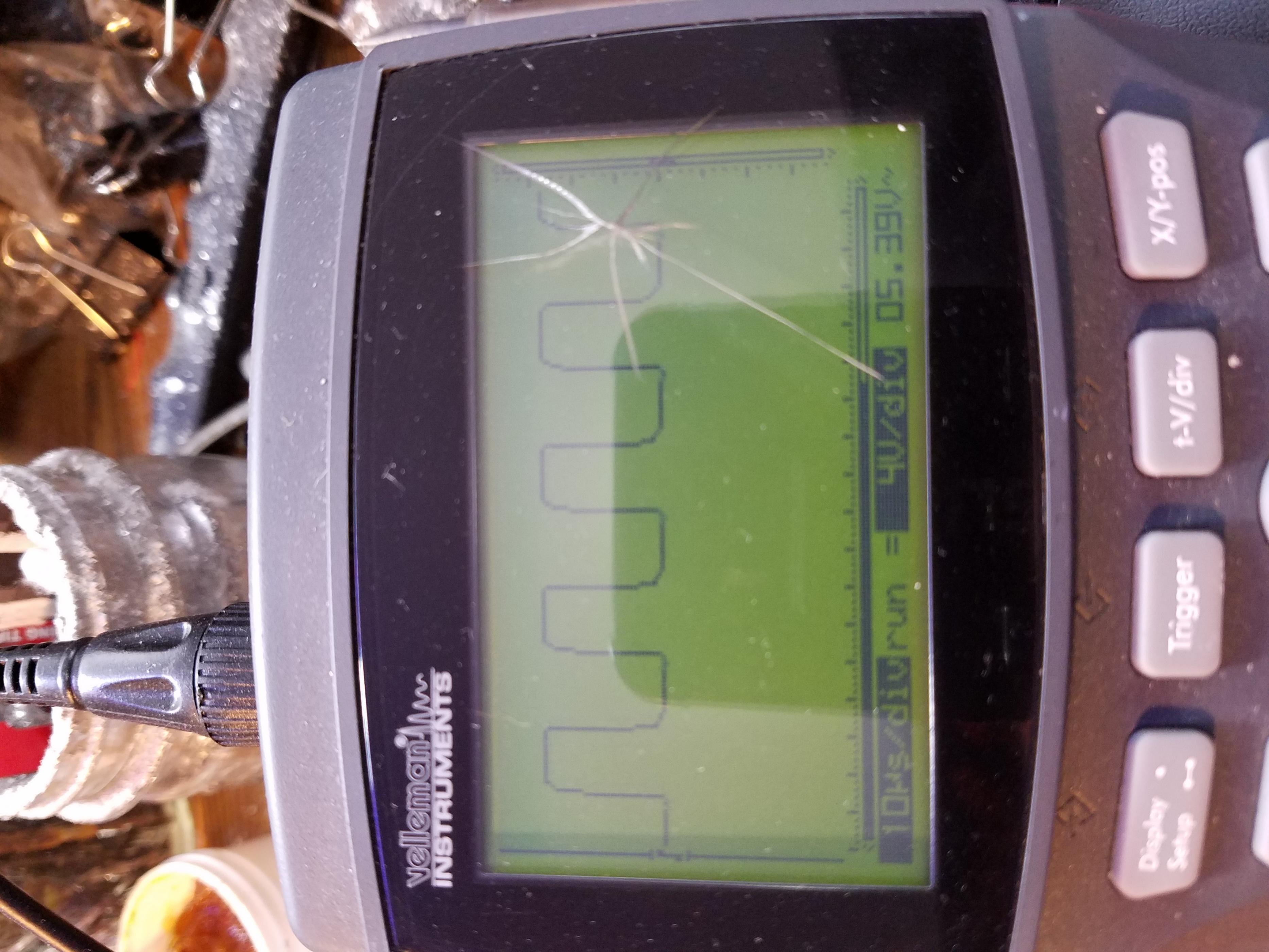

I have 5.60vdc on all power supply gate legs, half the power supply has a nice square wave on the gate leg. The other half is a square wave as well but it looks different. The wave is much further above and below the reference line and a lot closer together.
I apologize for the pic quality. My big scope is down had to use the hand held.
It looks like one supply is idle and the other is at higher duty cycle?
The scope is in auto range not sure why one reading was in "ms" and the other "us".
Why wouldn't the scope read them the same in auto range? Why would one be in ms and the other in us?
The scope probably tries to decide which will give the best view of the signal. Maybe one of the things it used to make the choice was on the border and it chose differently.

The waveforms on the drive circuit for the power supply look good, I'm just unsure why the current draw.
