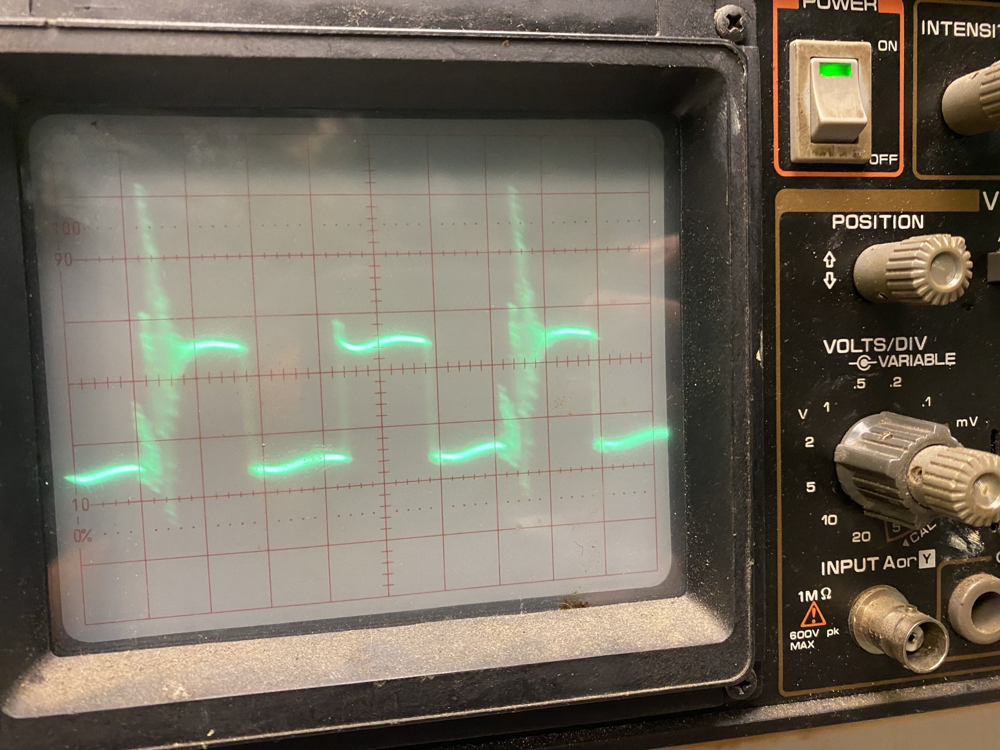

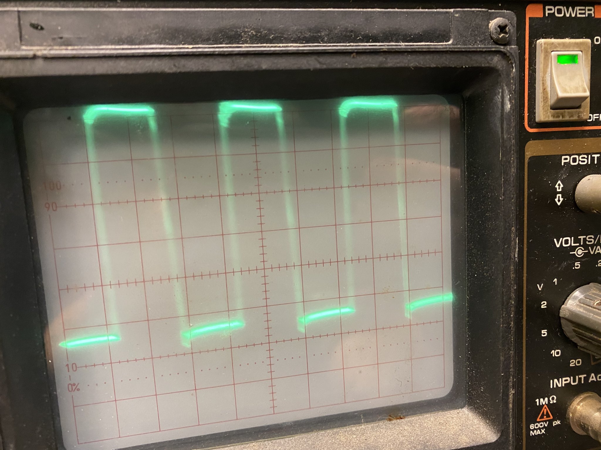

Ok sorry for the confusion. The jumper came unsoldered from R315 I soldered off back in place and get a square wave on pin 7 of both ic’s . On R309,322 I get a square wave on both sides of those resistors

Can you use your scope in differential mode?
