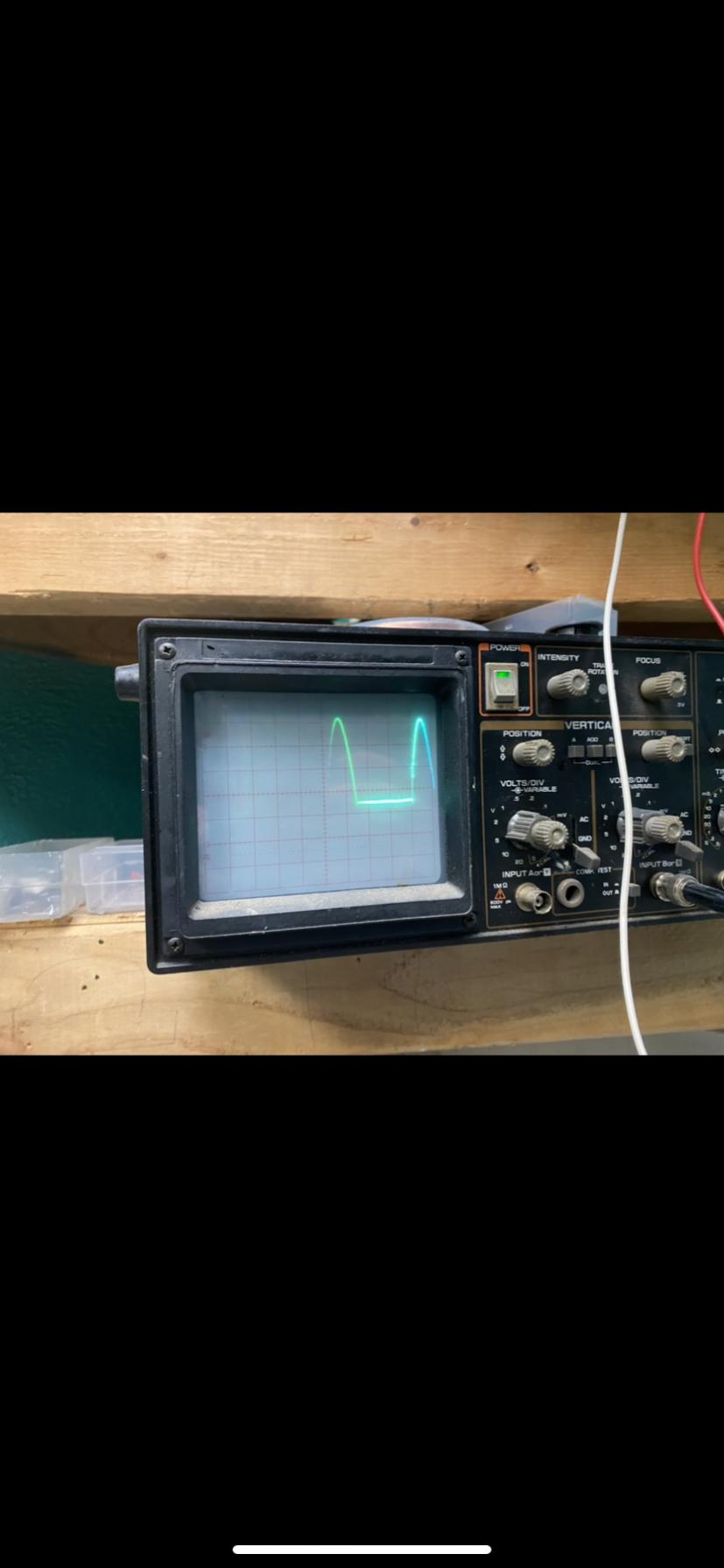

Amp cam in with blown outputs and the output filter inductor broken off the board .
Fixed the inductor and replaced all outputs with matching date codes .
Amp will power up and idle fine .
Problem is the amp has very distorted output .
Any ideas on where to start ?
Best pic o could bet with my cell phone since the trace bounces all over the screen but the image I’m seeing looks like this across the entire screen of my scope .
