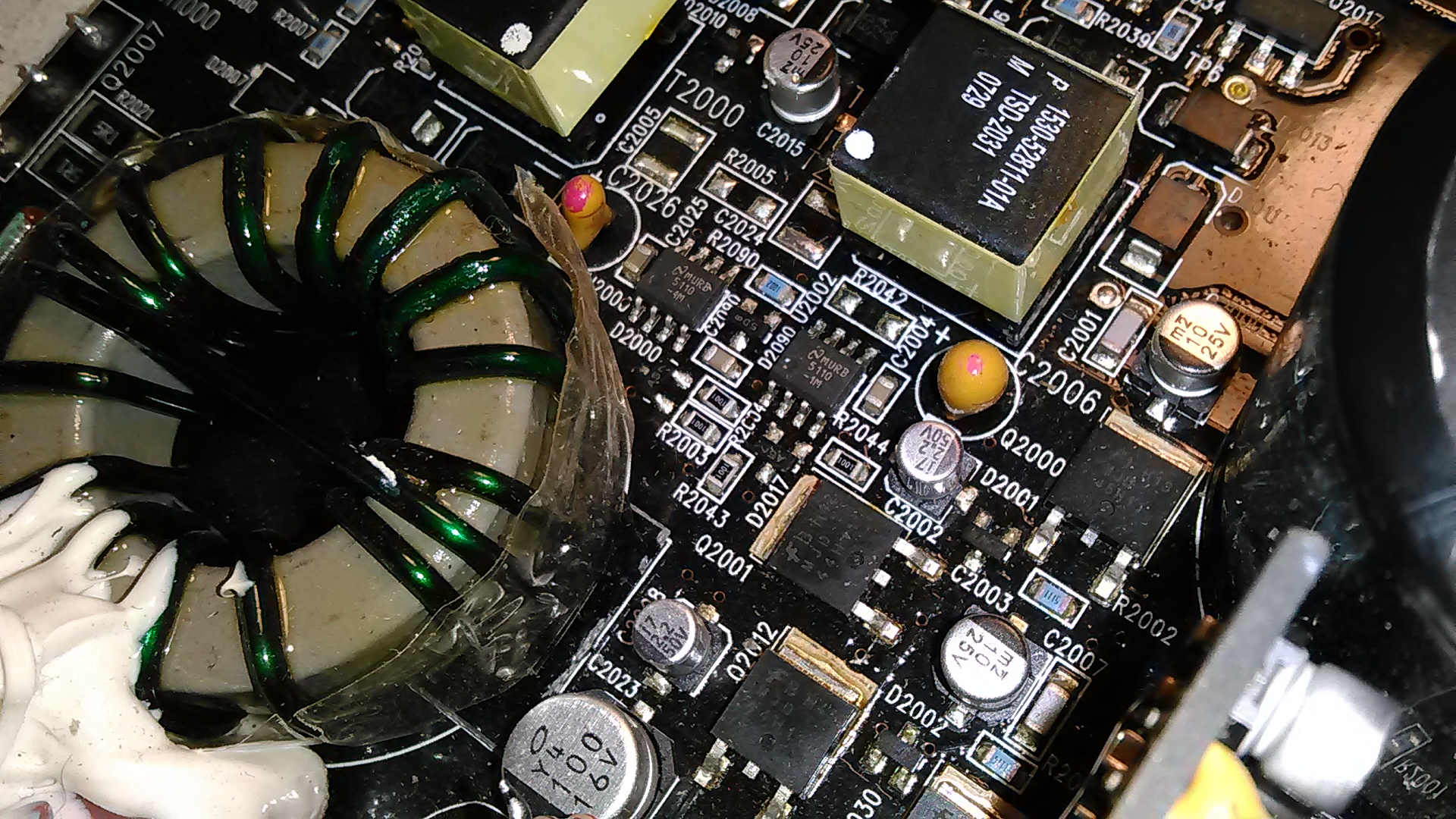

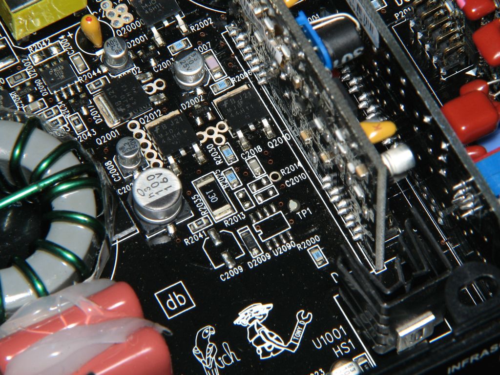

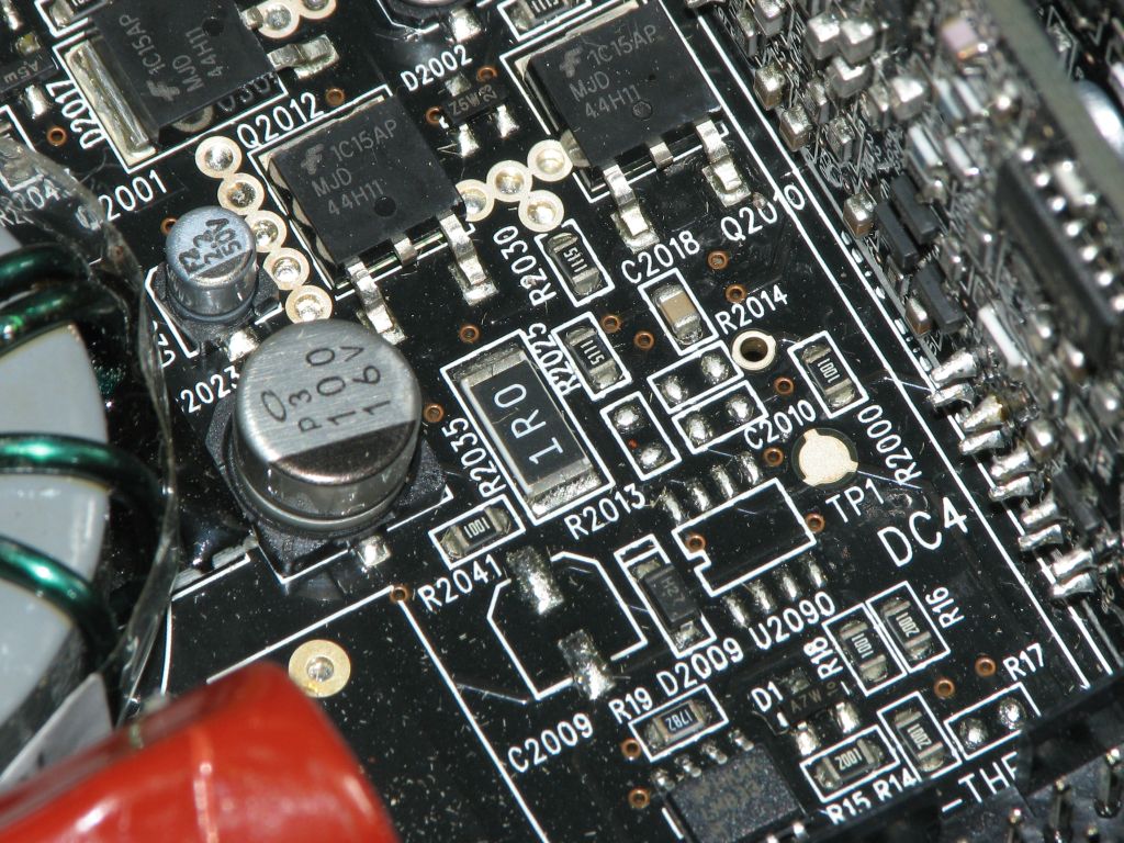

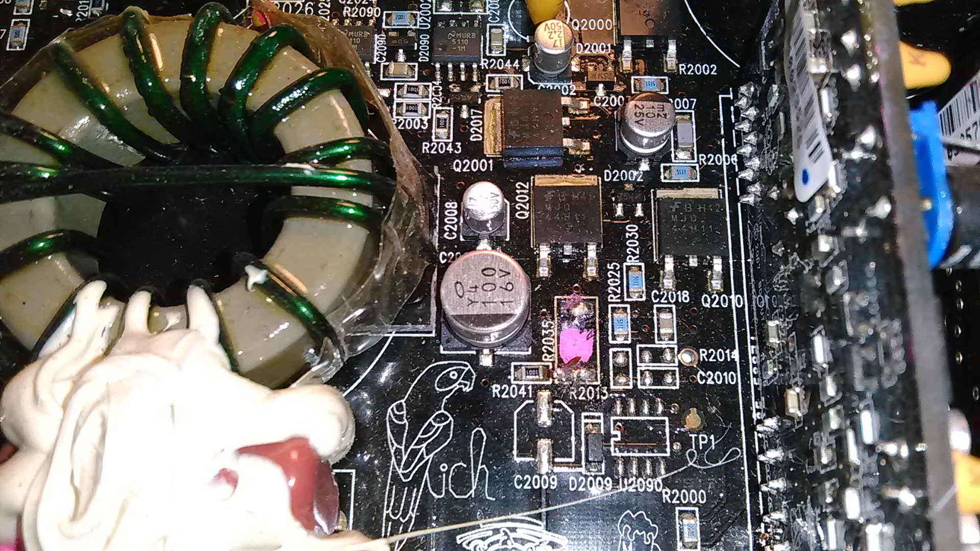

I had to resolder this resistor (13ohms) in mine as well. Are you saying I could just swap it out for a 1ohm without changing anything else?
Sent from my SM-N920G using Tapatalk
I know of no other modifications but I have not compared two amps to see if there are any other changes.
the amp plays now but the outputs over heat. i traced the signal back to the lm5110.
the wave output coming out is really bad. would there be anything else i need to check before i order parts?
everything running ok. op amps and rail voltages are right. the lm5110 looks to be going bad u2000 or whats feeding it. on pin 2. trying to trace the signal back to the card now.
It probably goes back to one terminals of the 74hc74 IC. Confirm that it has supply voltage. Also confirm that it has a triangle wave into the clk terminal (pin 3) and a square wave out of pins 5 and 6.
