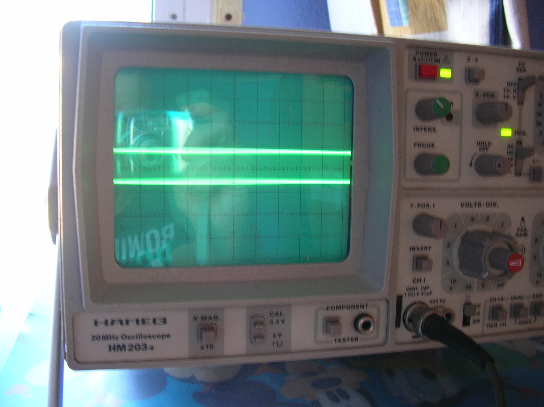

If you have a scope, confirm that you have a continuous square wave on the center leg of the power supply FETs. With the scope set to 2ms and 10v/div, you should see a wide trace (~2.5 divisions high) that is unbroken across the display.

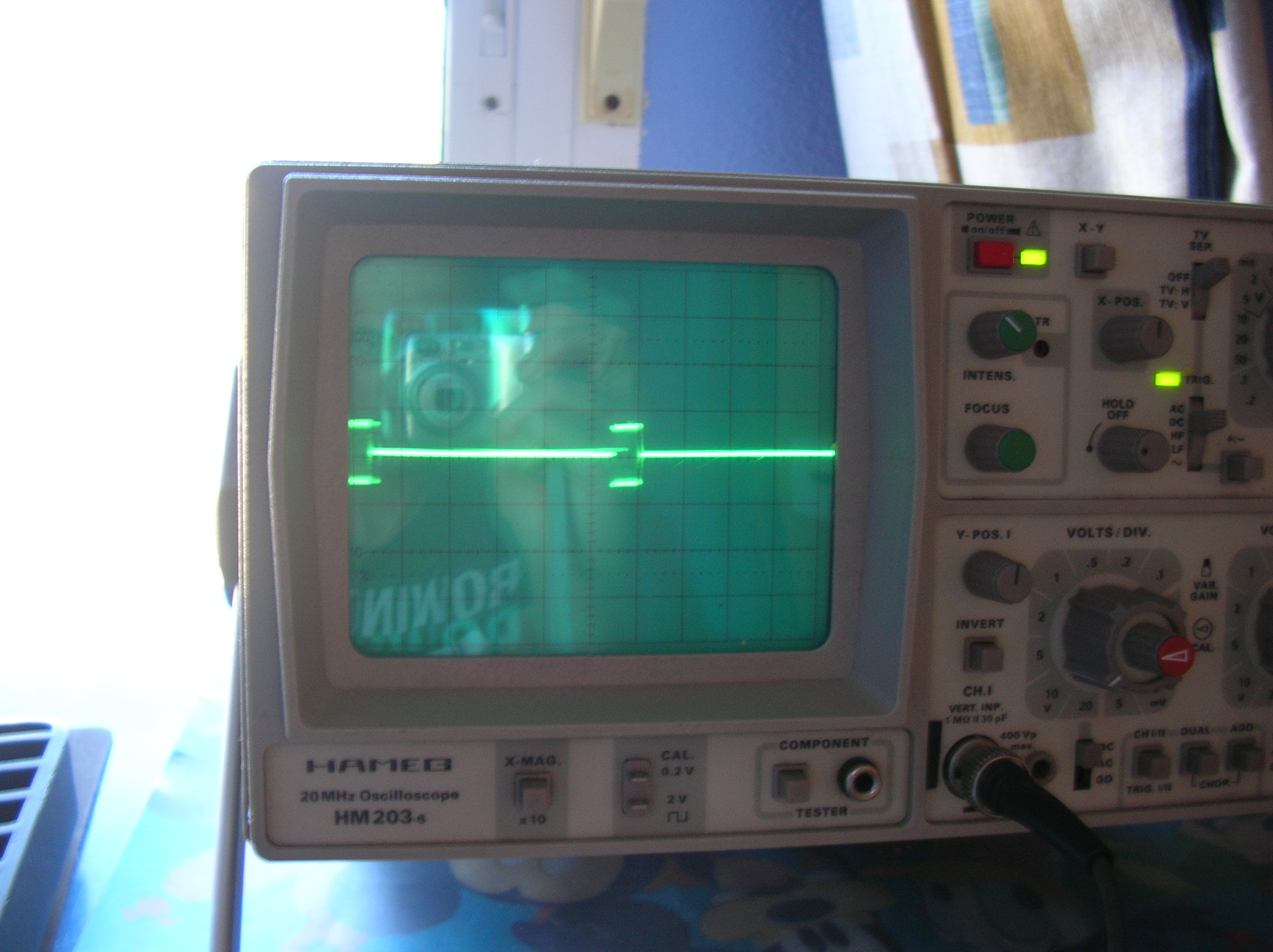

I was struggling to take measurements ...
When the tension, was down to 0V, and stayed there, I could not make any comparisons with the waveforms ... and I had to wait half an hour, between measurements.
I have found, from pin 9 to pin 18 (pin 1 to pin 8 I could not check them, I'll try tomorrow ...)
The pins that come closest to the waveform found in the center leg MOSFET power supply, are: pin 13 and pin 16, I think, are the outputs, truth, Perry?

13 and 16 are the outputs but that's to be expected.

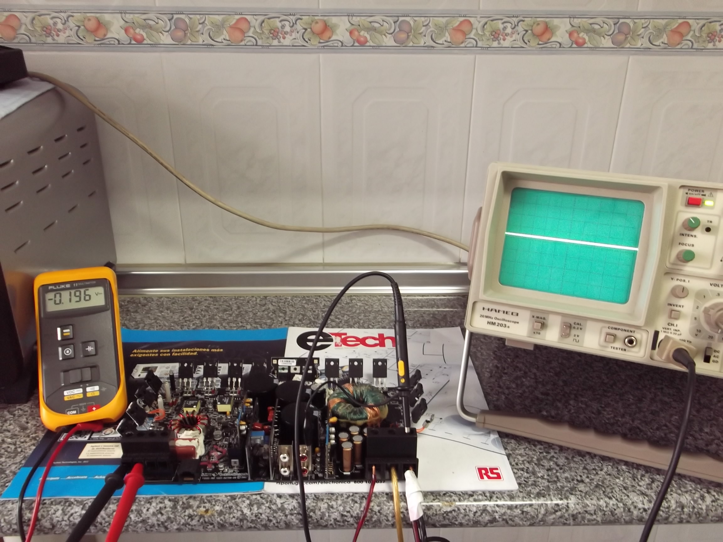

As I'm checking with the scope, I have connected to the speaker output, the meter, to be watching at all times, the output voltage.
The measurements that I needed, from pin 1 to pin 8, are:
Pin 3, 4, 5, 6, 7, 8, give me a very similar waveform to which I gave, the center pin of the MOSFET power source.
What do you think, Perry?
