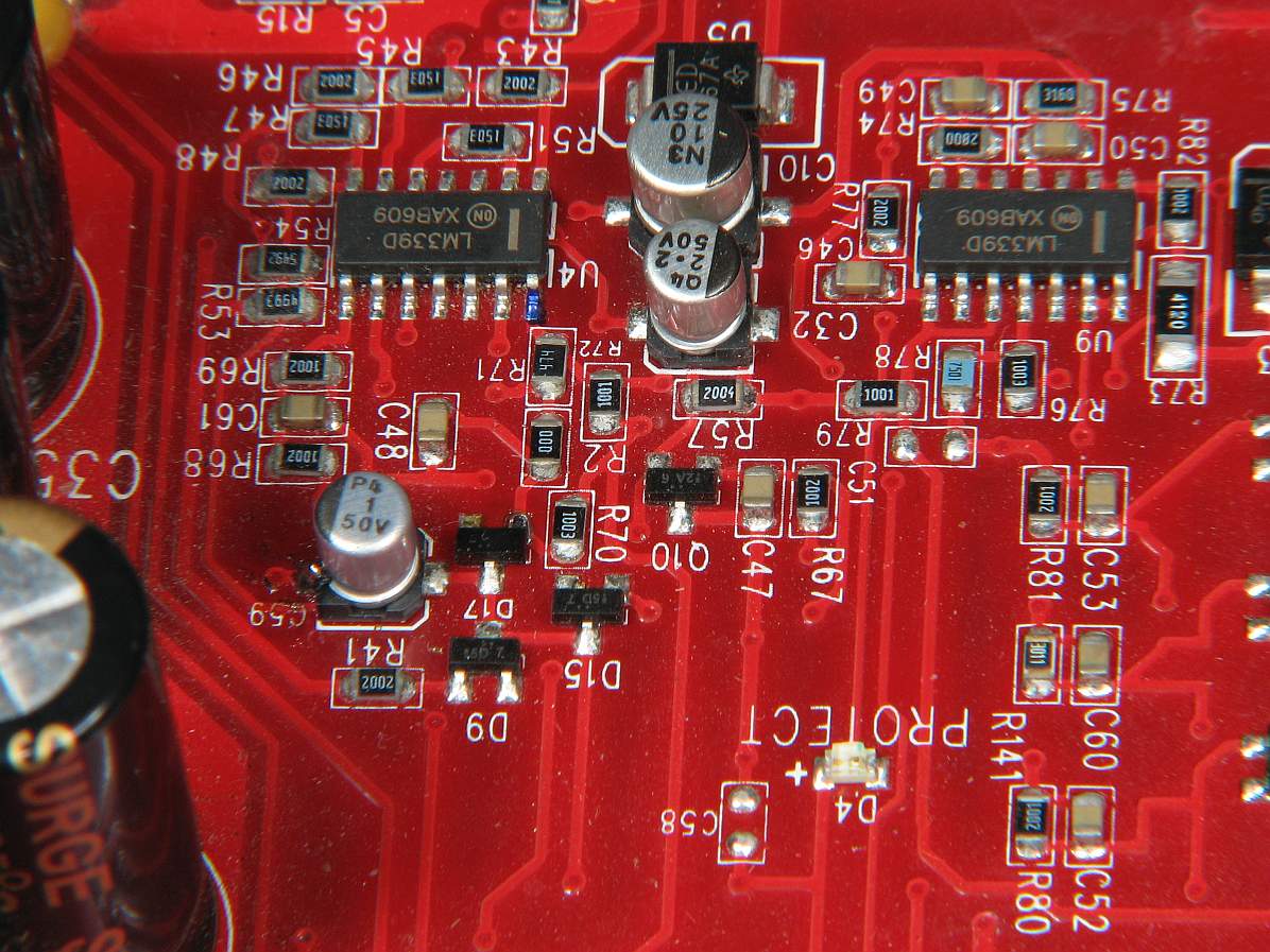

Do you have a pic of the area around U10 ?
I need to know if the board locations are populated or not
I see the problem now .
It appears the board got wet at 1 Point and there are a lot of bad connections .
I will have to redo a lot of connections all over the board
I went over a lot of connections .
Still no audio .
I do not have rail to rail oscillation.
Any ideas on what to start checking to see why I do not get rail to rail oscillation
Still no audio .
