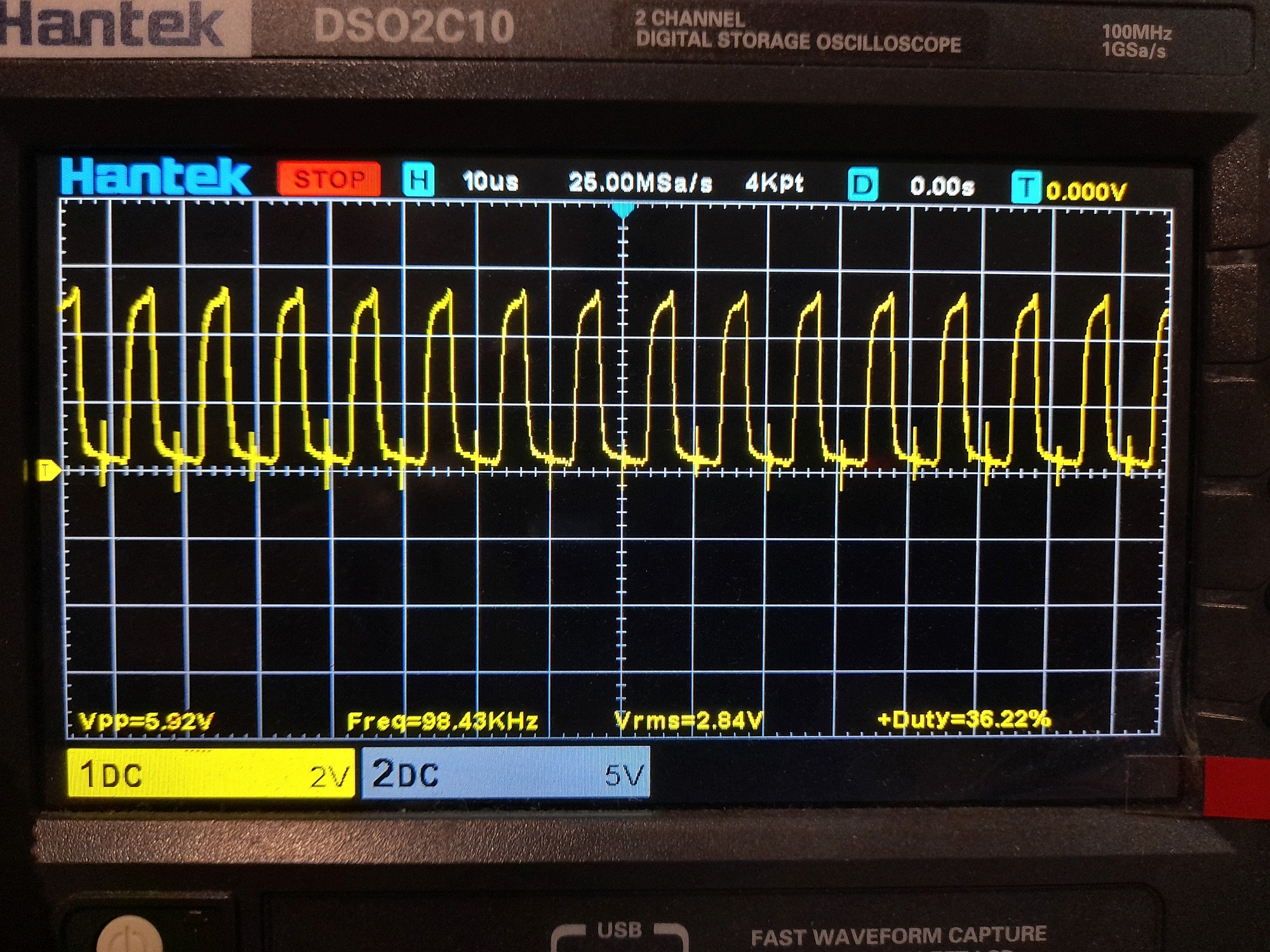

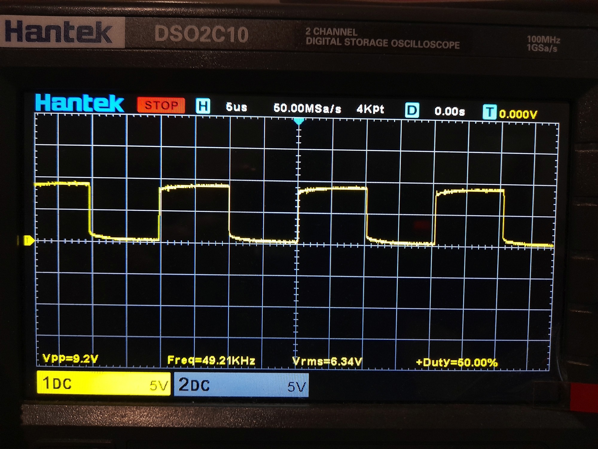

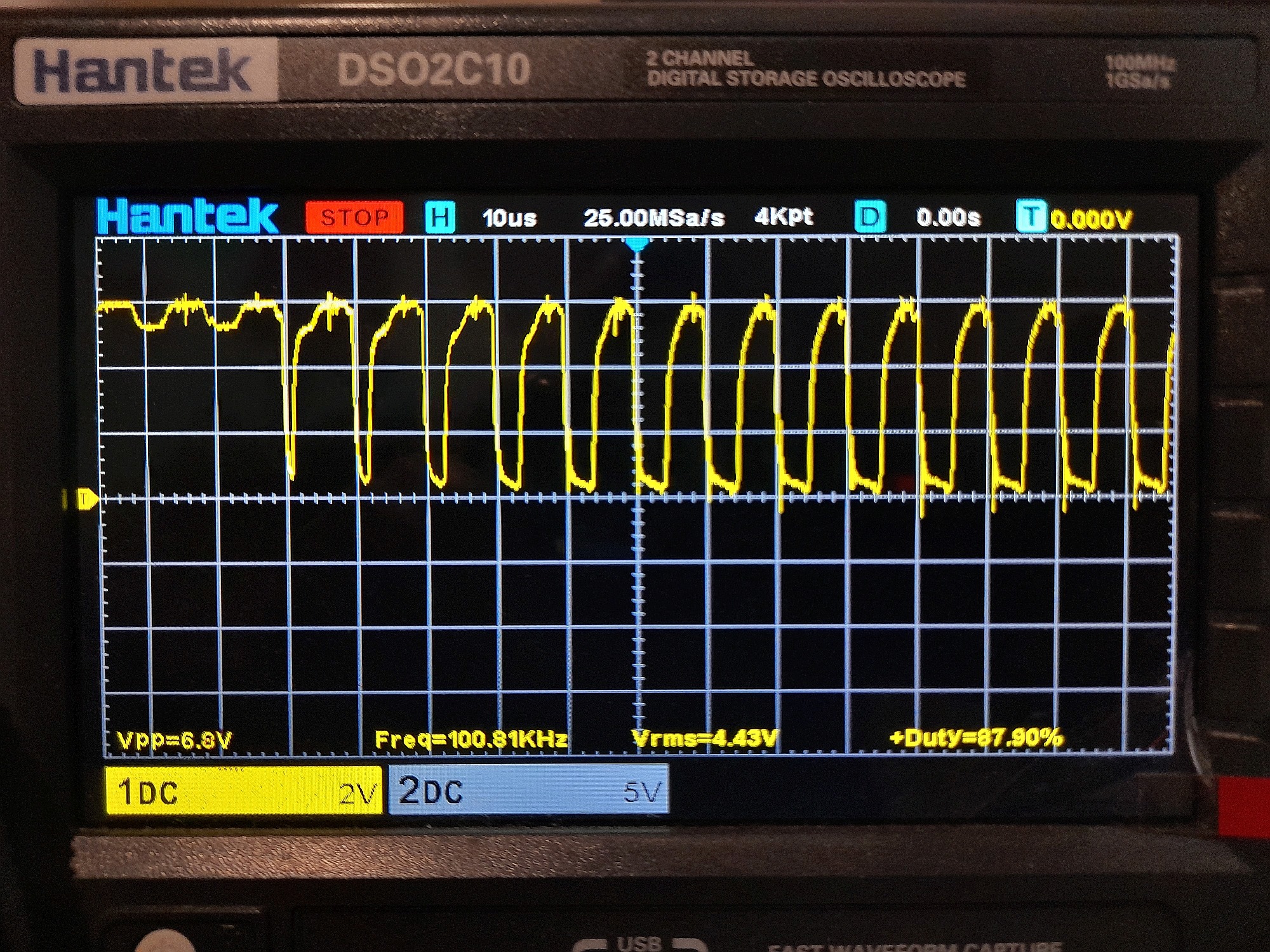

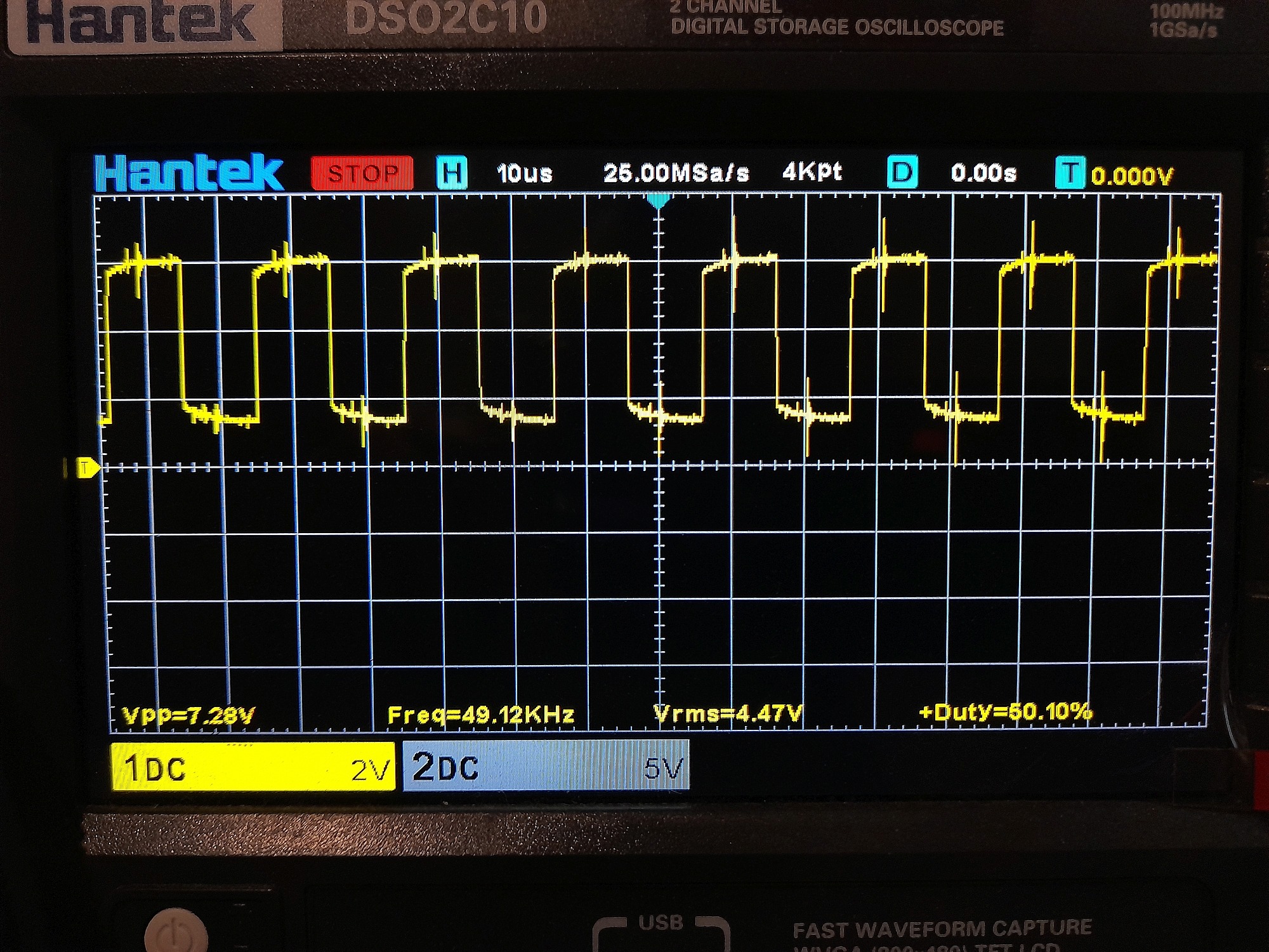

Measuring was done at clipped point at approximately ~8.3vrms. This is kind clean sinewave but at very low volume - at 2-3vrms.
Both U202 + U204 - pins 1 and 16 are stable at all times and are looking basically the same.
There is difference between pin 2 and the outputs between the two chips.
At very low volumes when there is a clean sinewave both audio drivers are measuring/switching almost the same. But once u start increasing the volume and the output becomes clipped, U202 starts to behave awkward. It's like trying to switch but cannot develop proper wave. Pin 2 and the outputs pin 6 and 11 are nothing like U204.
