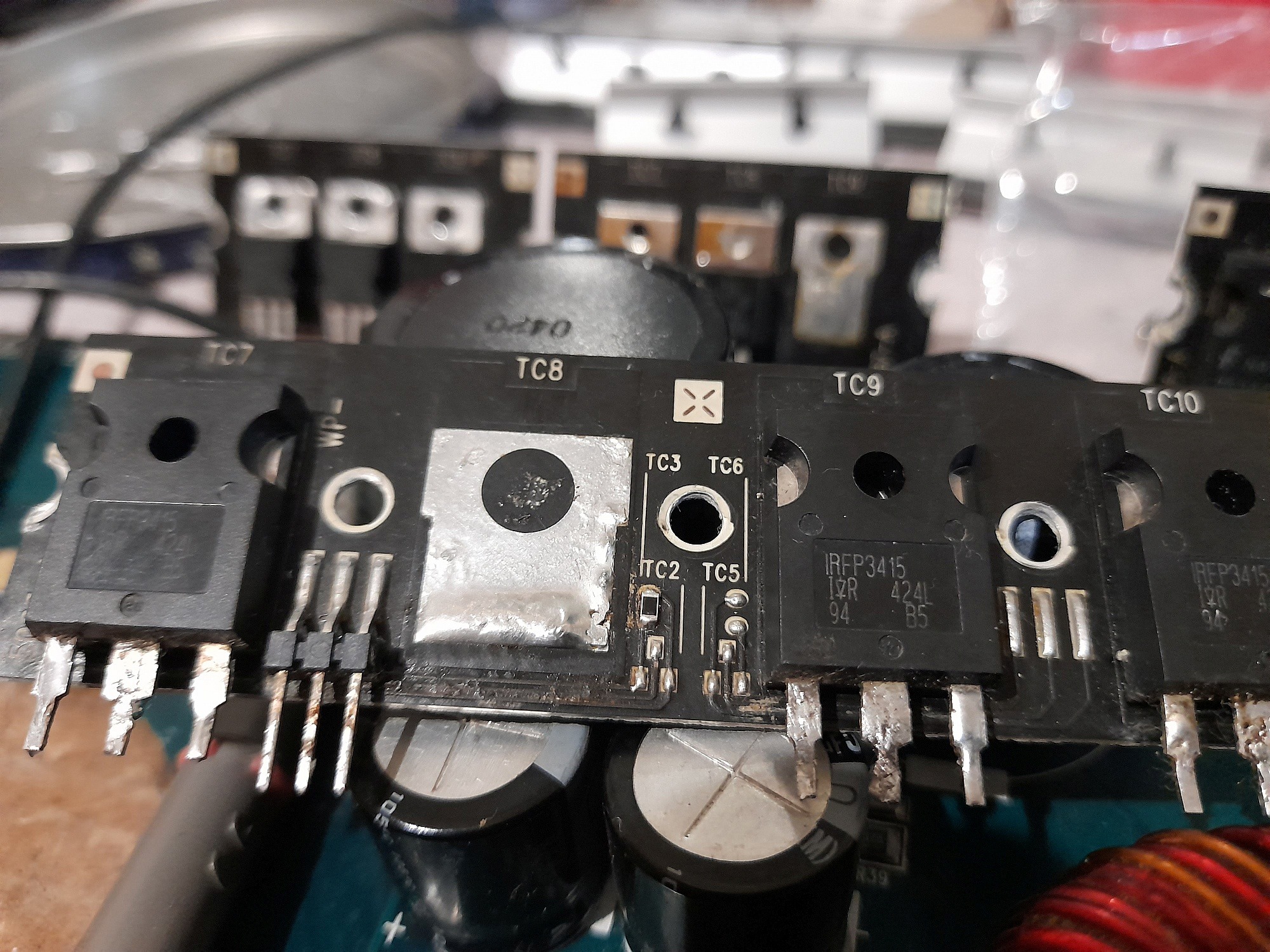

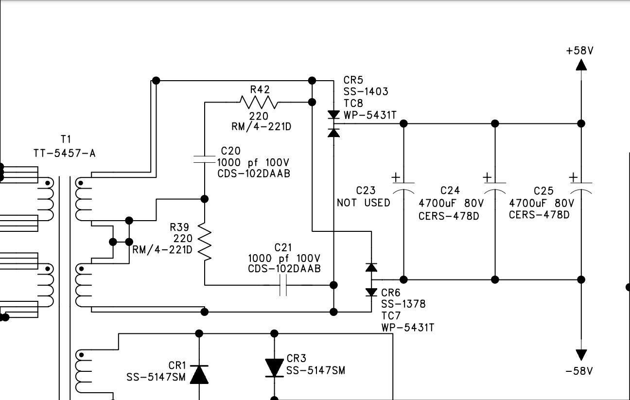

Can somebody point out what are the CR5 + CR6 (TC7+TC8) in Rockford Fosgate T10001bd component as they are missing in mine ?
How there are +- 58volts rails when the minus is connected to one end of the cap and the plus to the other. I don't get that, There is no ground ?
Schematics attached.

MUR1620CT and MUR1620CTR
Both have a G suffix for the newer, lead free parts.
Rockford BD amps have floating rails.

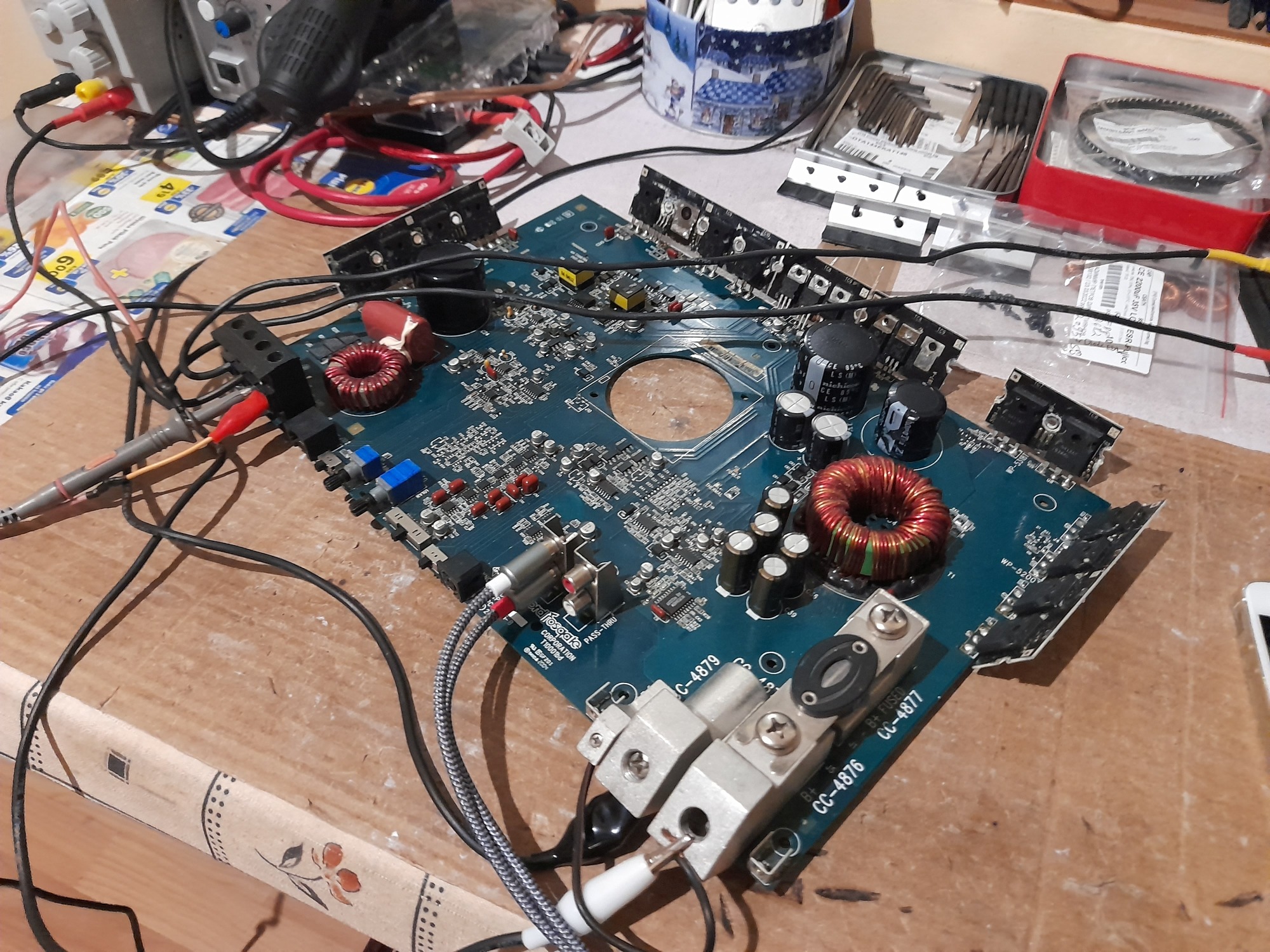

Amp actually powers up, but does not produce top half of the sinewave, the positive one. It came in without one of the irfp3415.
I could not find any shorted transistors, diodes or voltage regulators. Nothing visible. I've measured most of the resistors (not all of them) and they are in 1~2% tolerance range. Nothing is heating up abnormally.
I do have the auxiliary +-6v, +-10v, +-20v, but the +-16v are +-14.2v, not exactly 16v. Changed LM317 (U7) + LM337 (U8) аnd changed the resistors in the circuit, still the same +-14.2v. I don't know if something is dragging the voltage down equally to +- or this is supposed to be like this.

You measure the rail voltage by measuring across the center legs of the positive and negative rectifiers.

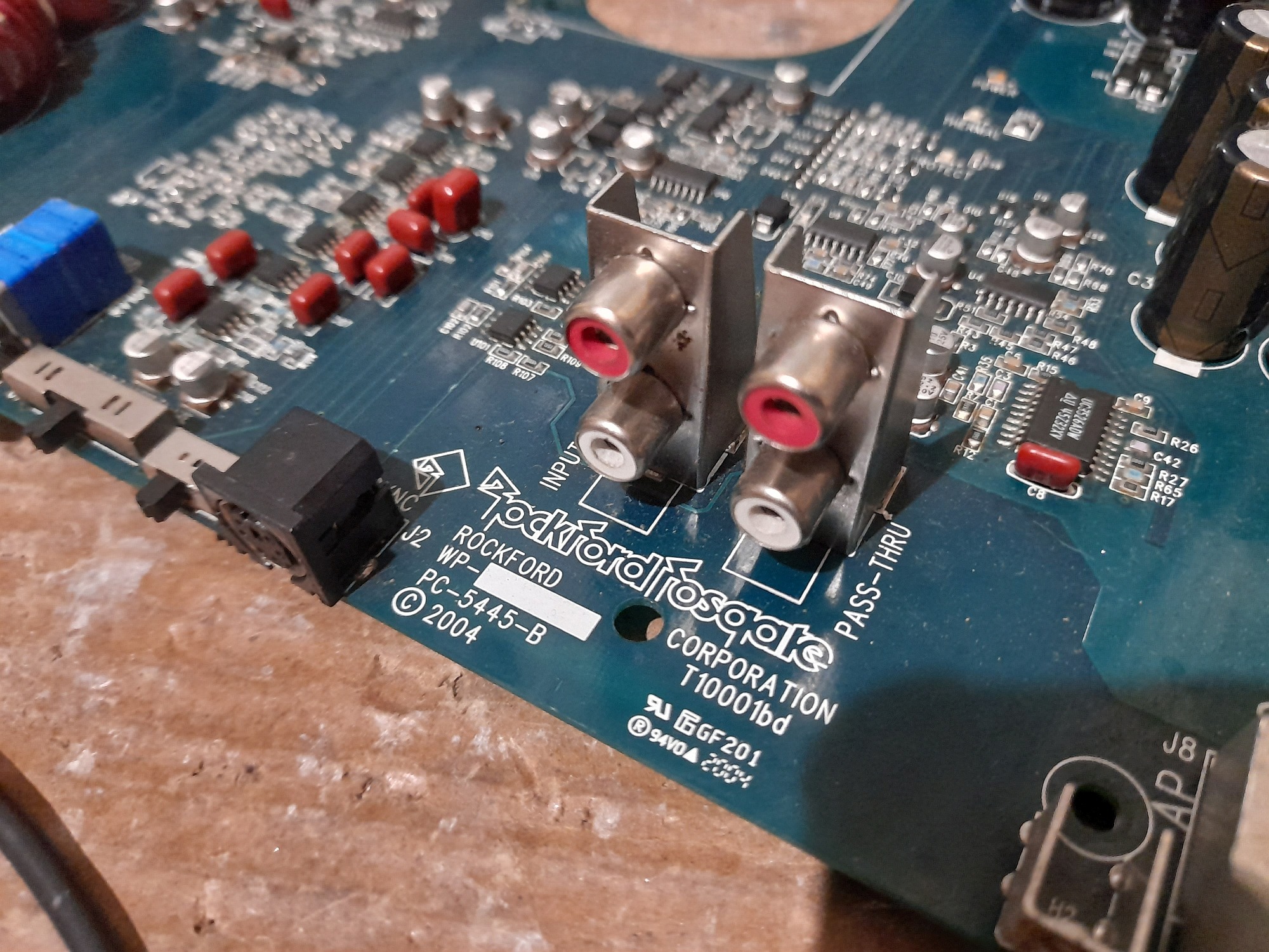

What's the PC# on your board?

What's the PC# on your board? - will post once I get back home from work.

Not referenced to ground. You have one probe on one center leg and the other probe on the other center leg.
So measuring the proper way +58,5v of rail voltage.

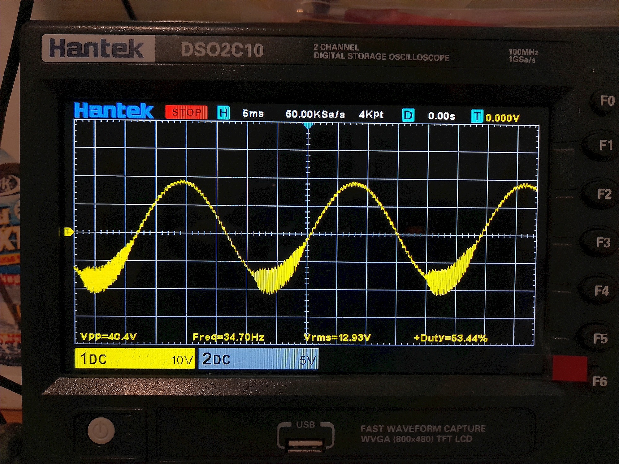

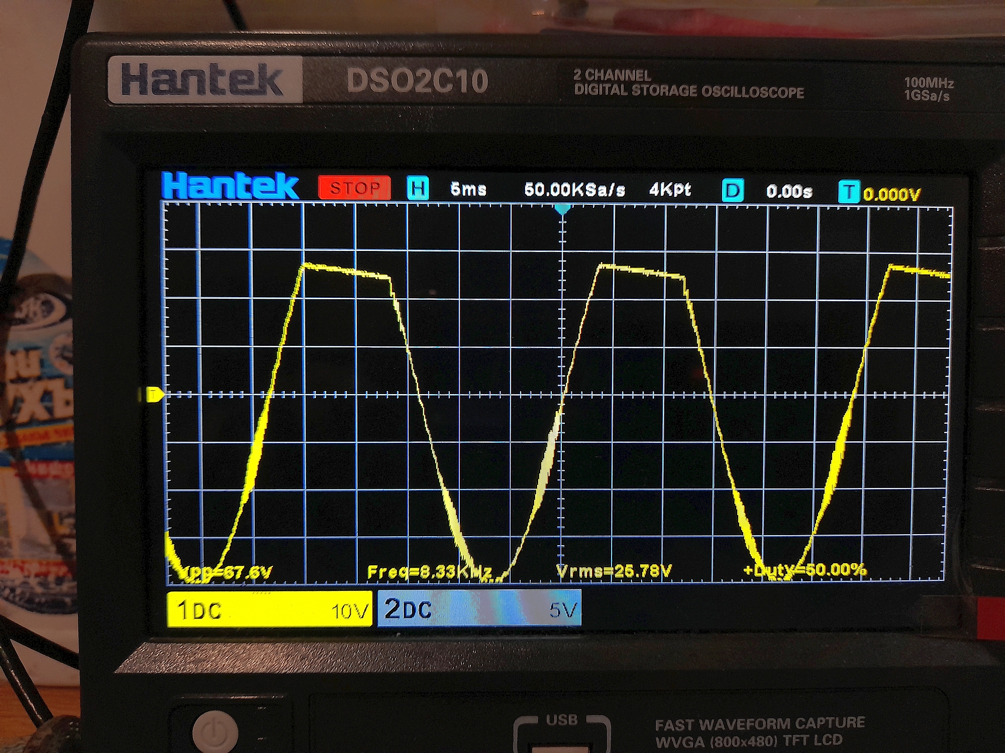

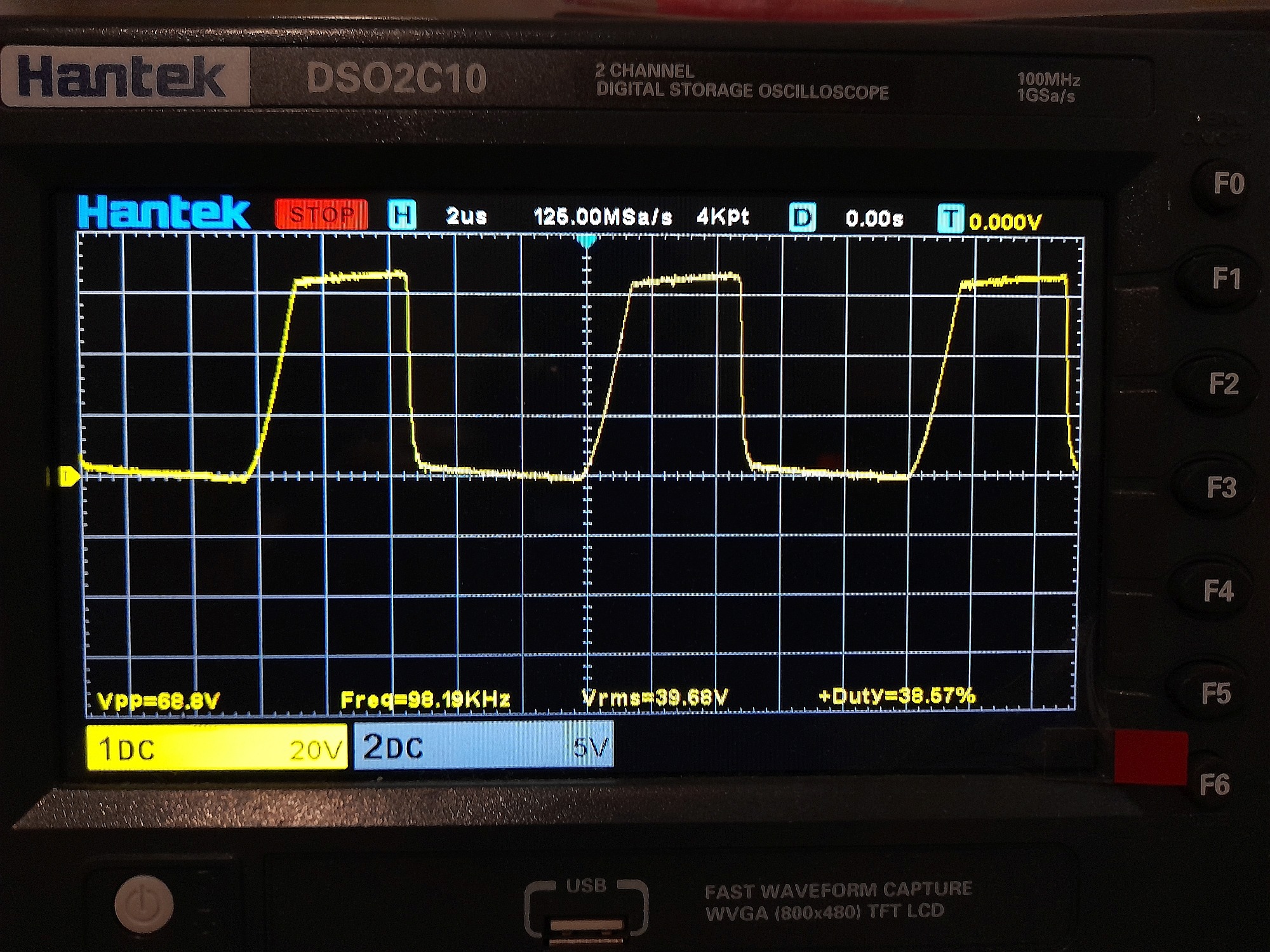

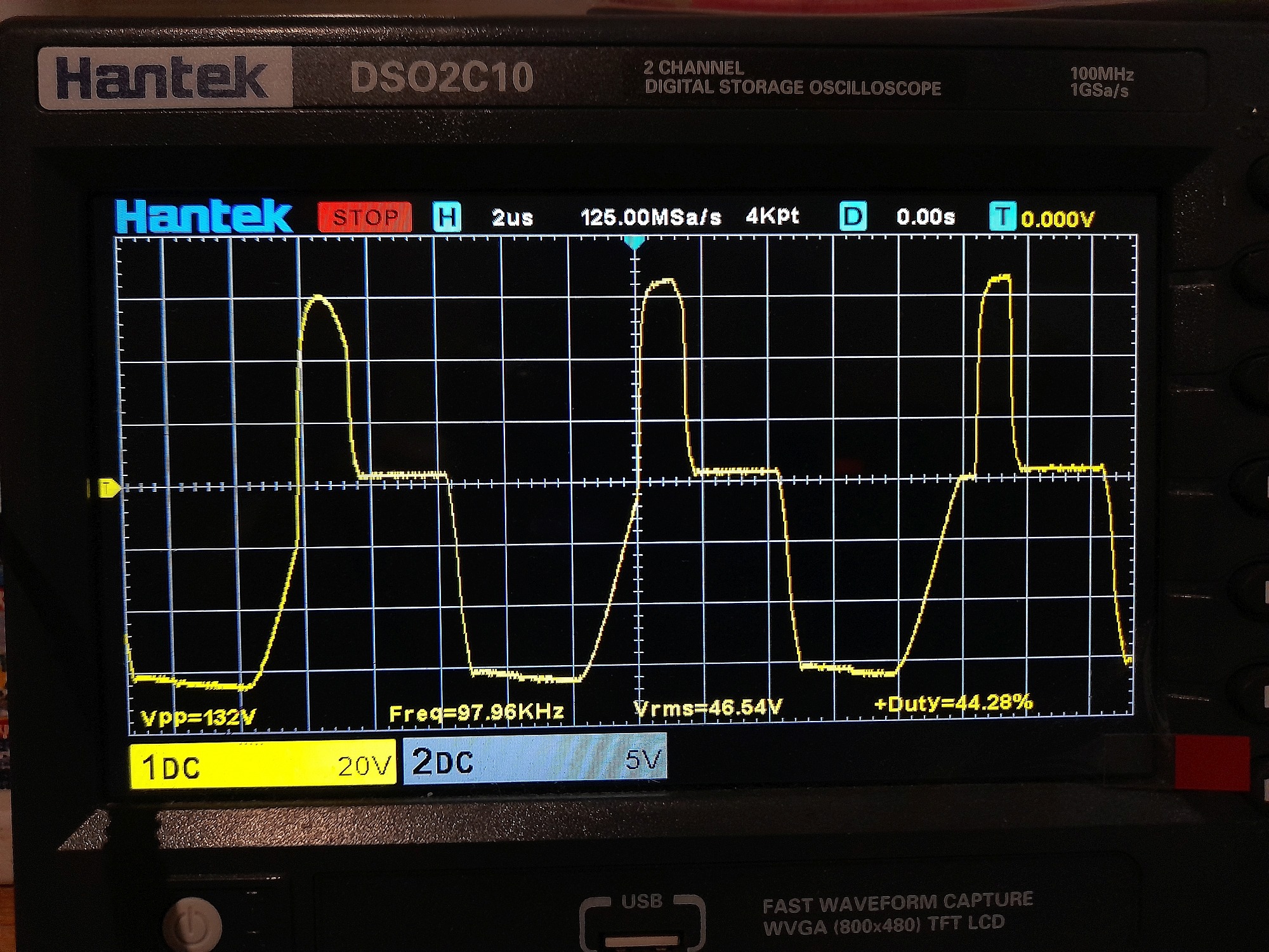

I've fitted some new irfp3415 but same thing as with the original ones. If I apply even a small loud at the speaker terminals the top half of the sinewave is not being produced.
Without a load there is a noisy sinewave at the lowest gain point, but if I increase the gain even a bit, same thing happens, the top half of the sinewave is cut off.
You can see in the attached images.

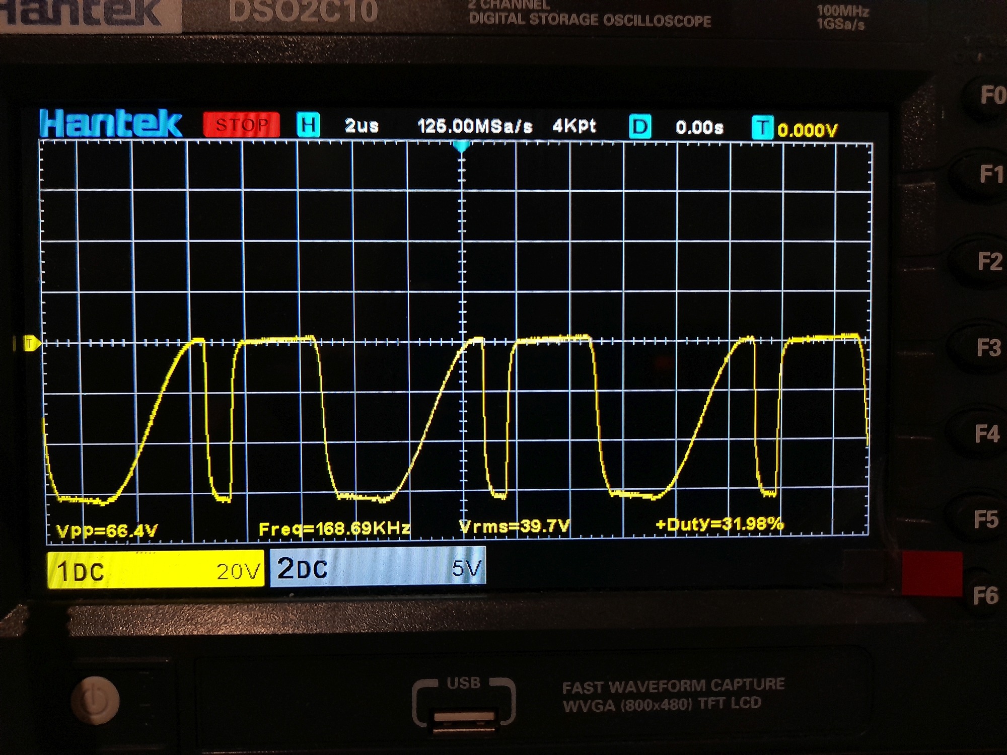

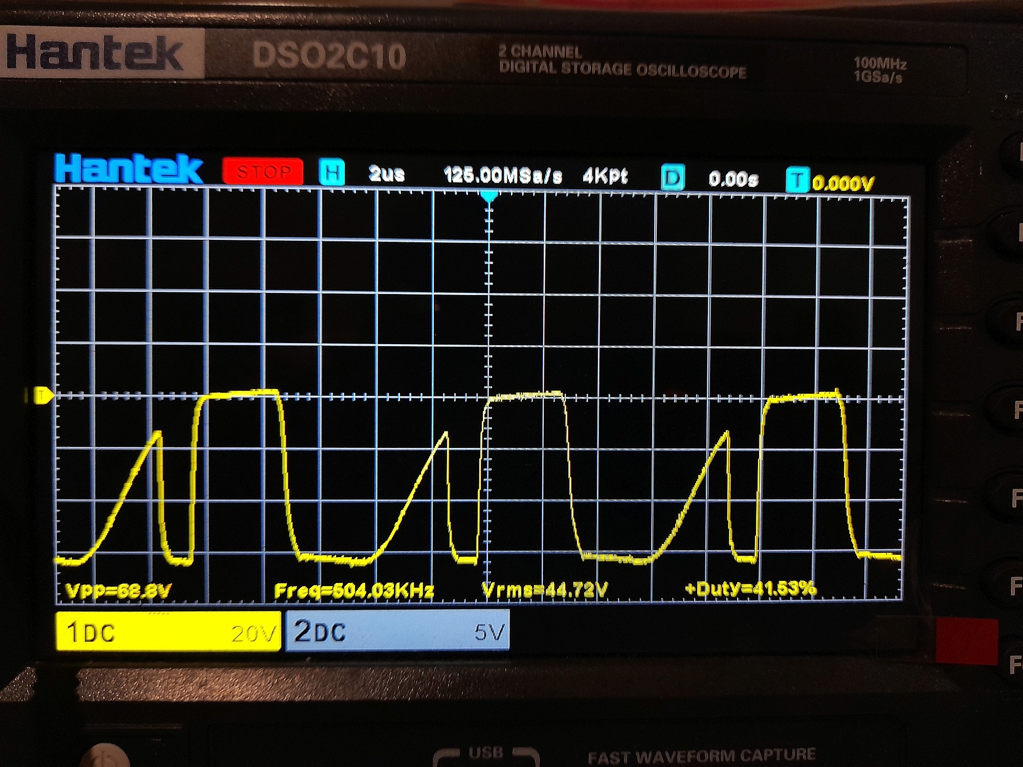

What i've noticed, if the amp stays idle for more than 1-2 minutes, q201, q202, u202, u204 and the output mosfets are getting hot. Current draw stays the same all the time at 2.4A.

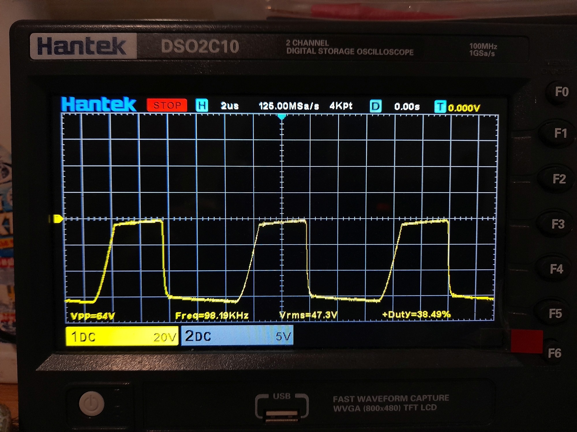

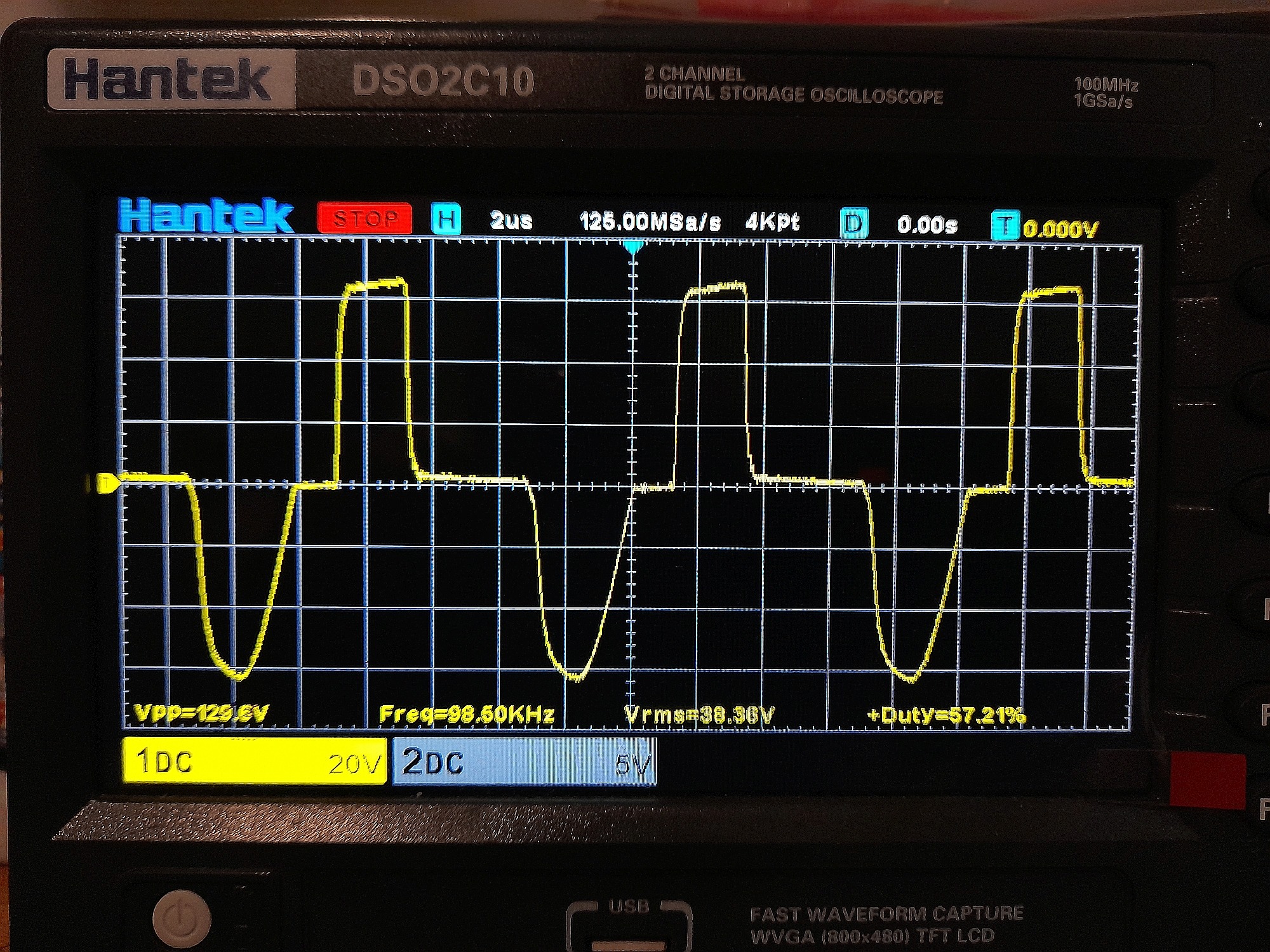

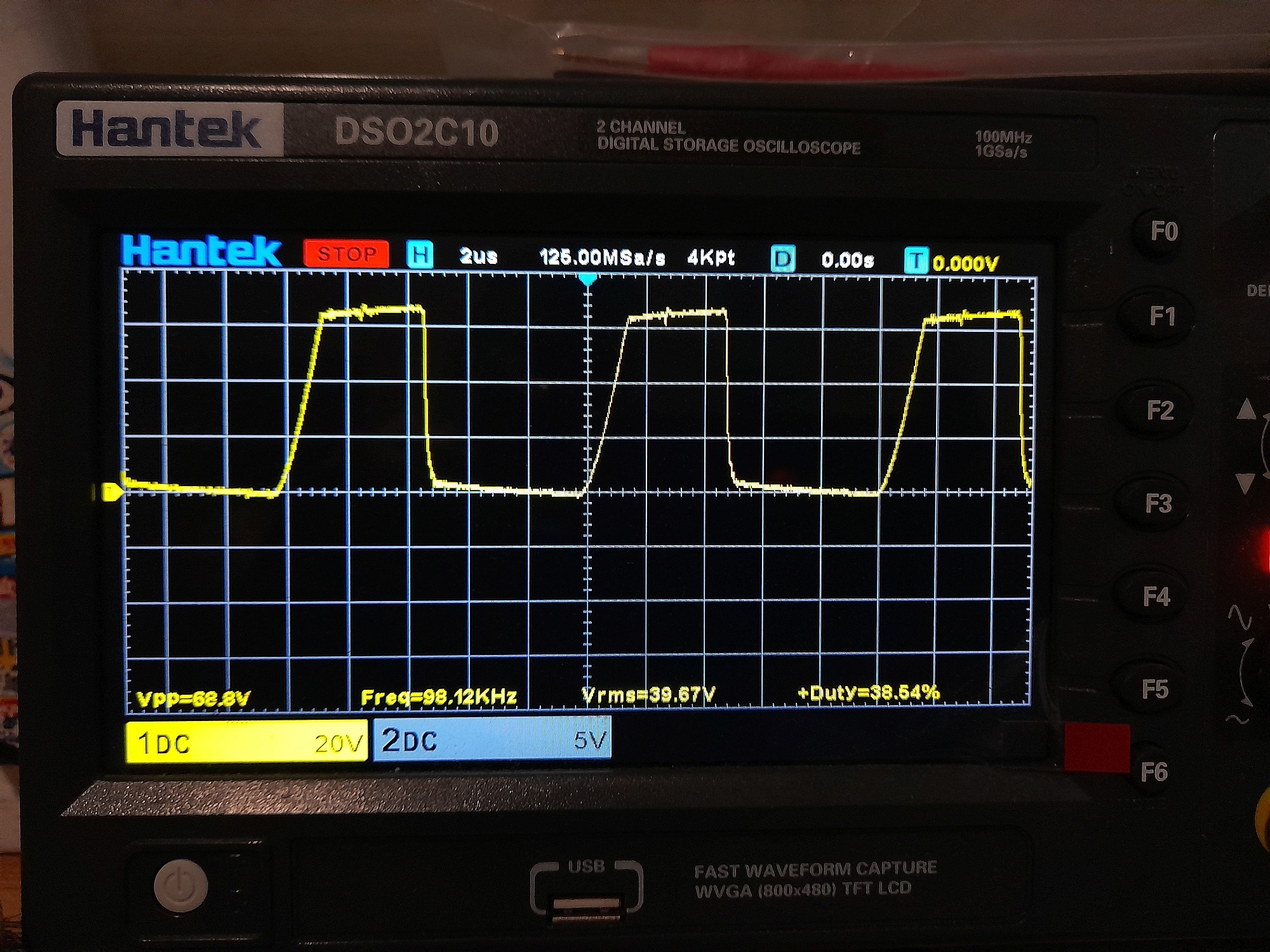

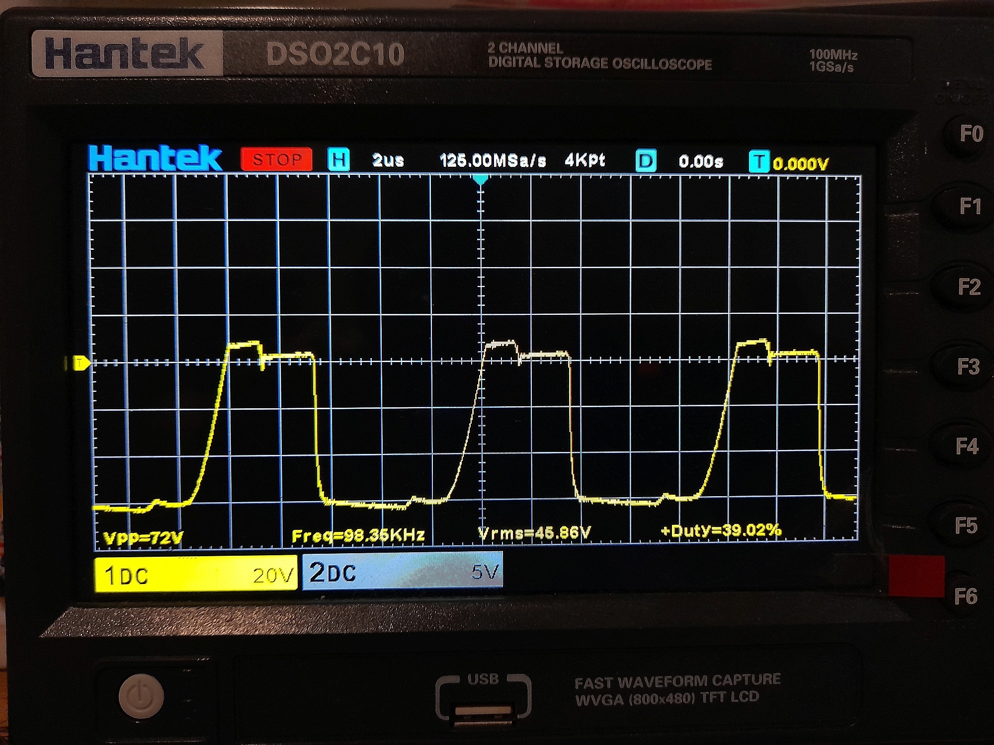

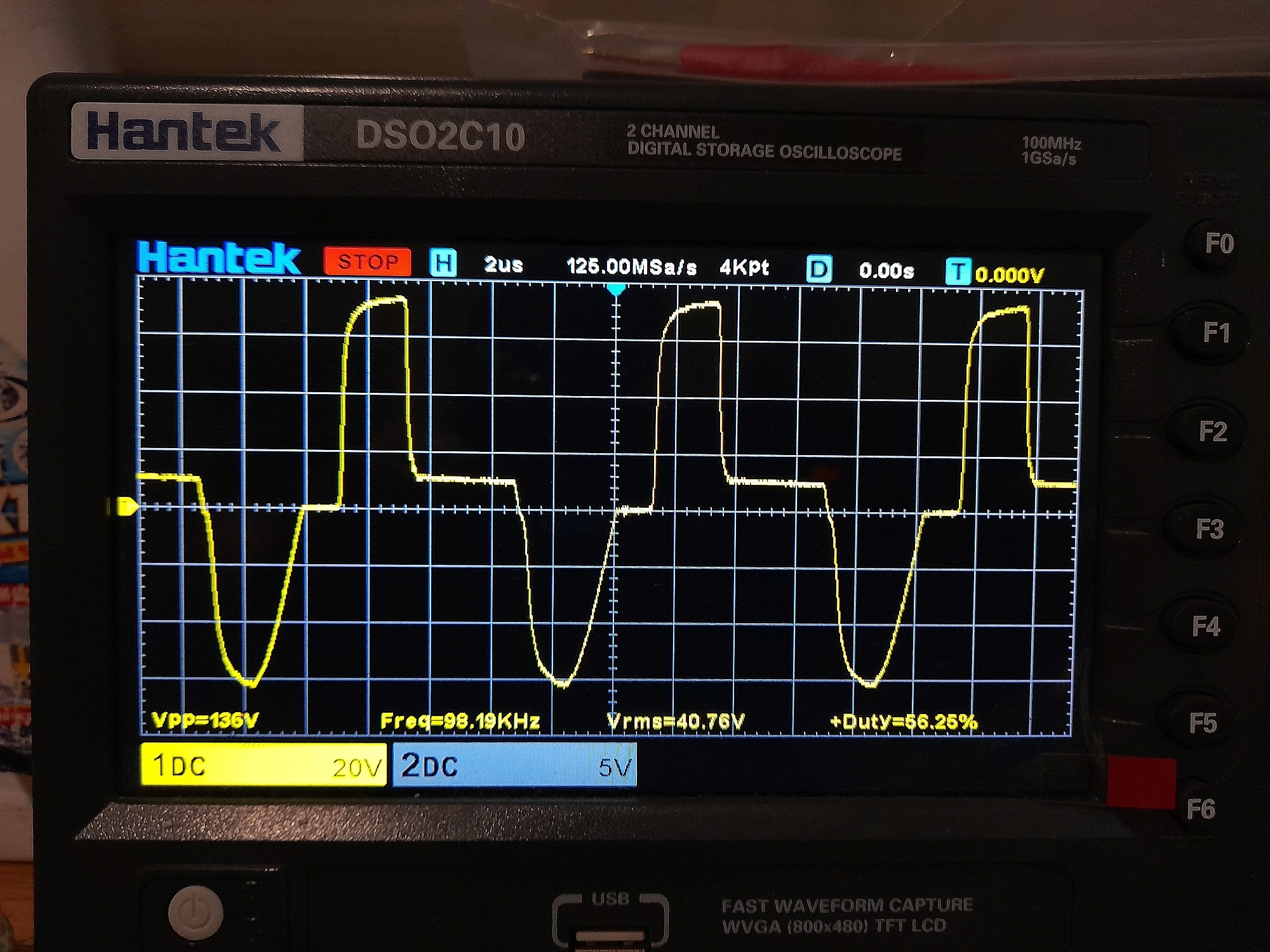

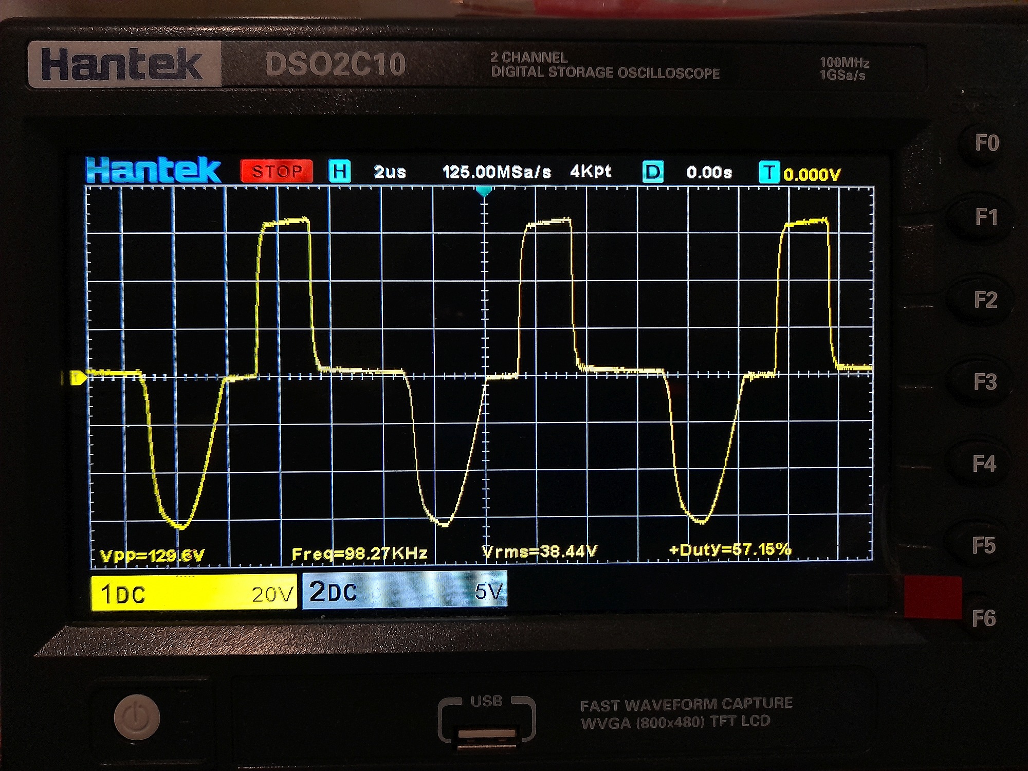

How far is the square wave shifting, above and below ground, on the rail switching FET (on the left of the amp)?

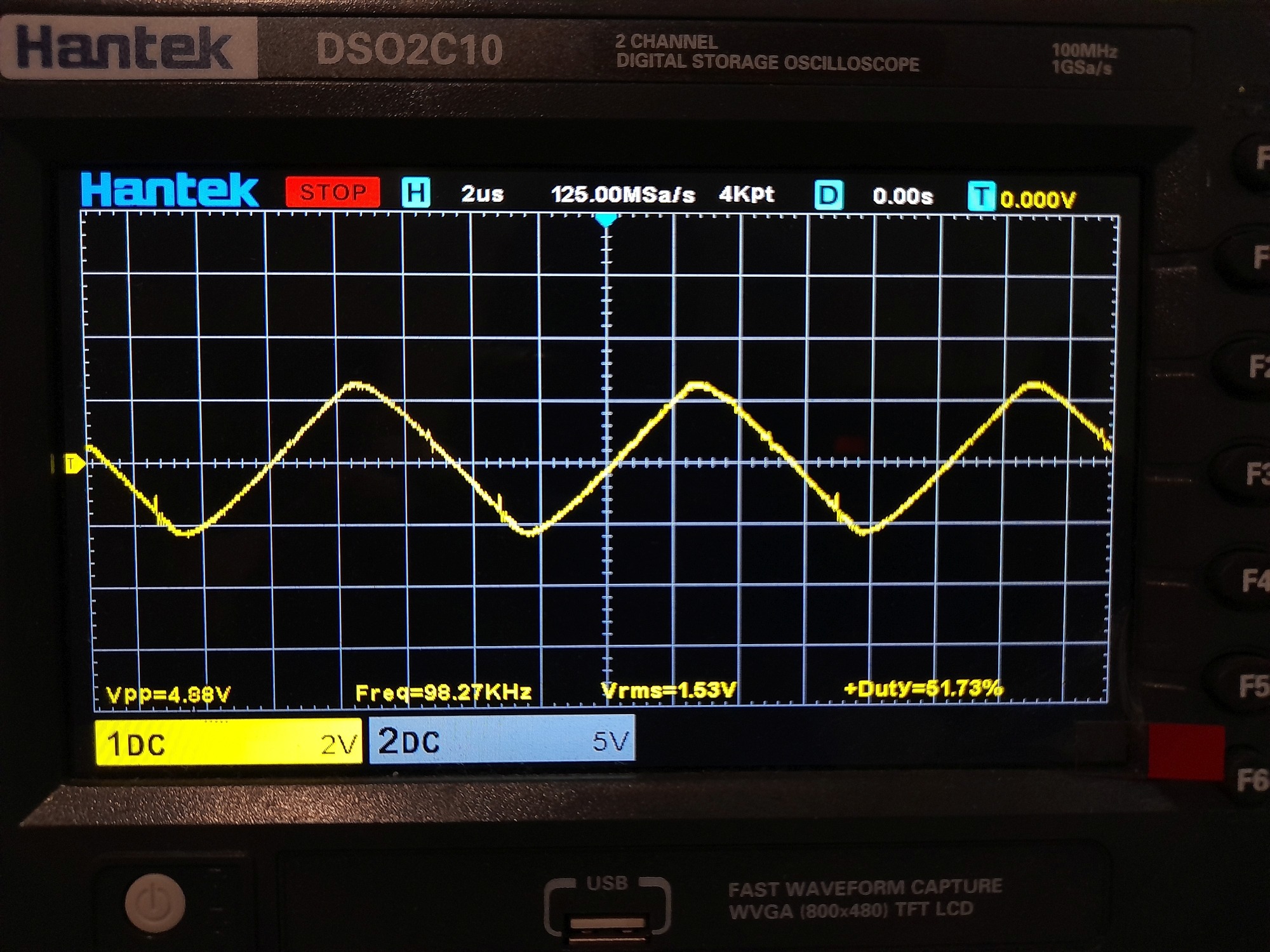

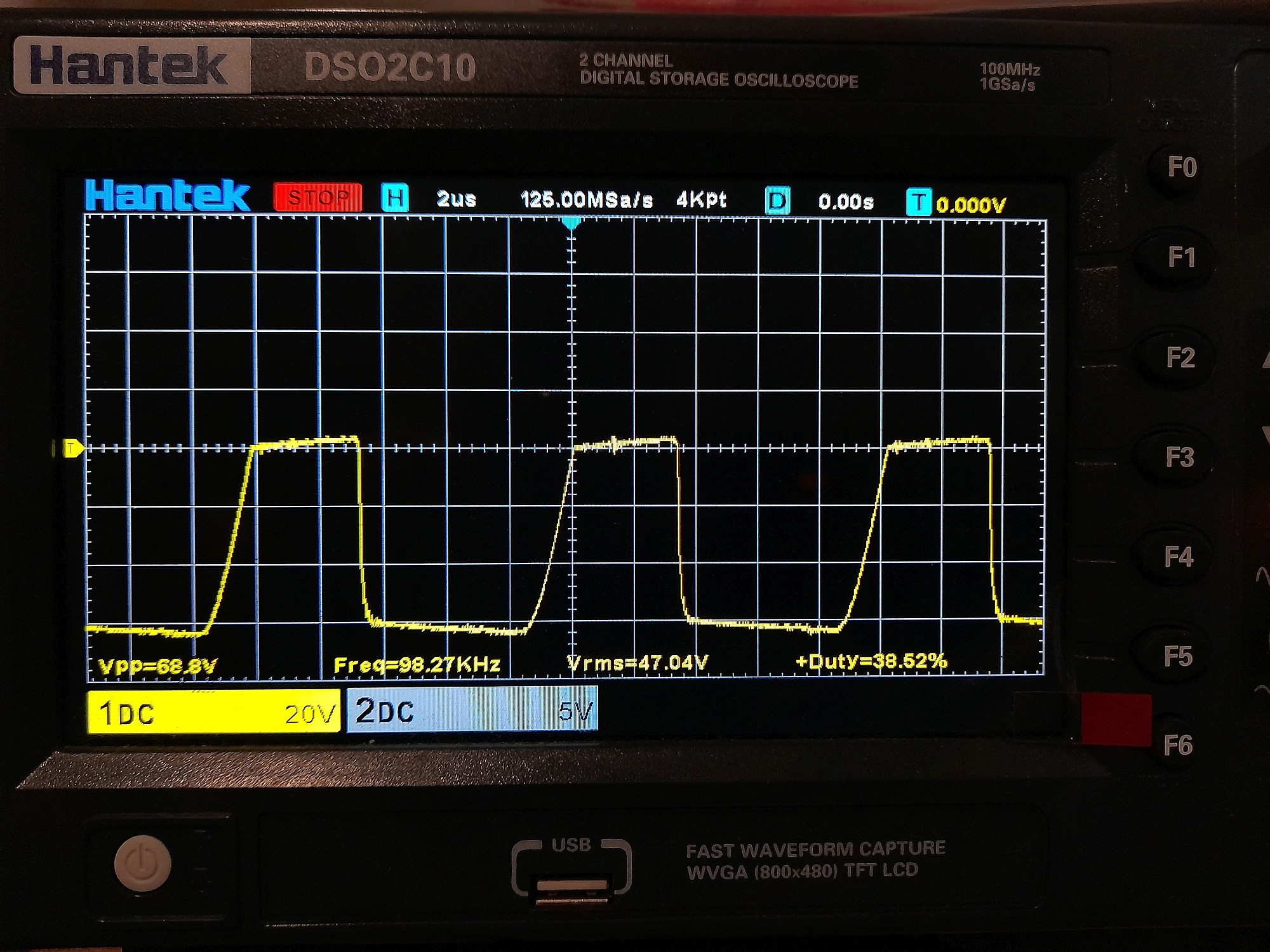

What's the amplitude (above and below ground) of the triangle wave on the integrator output?

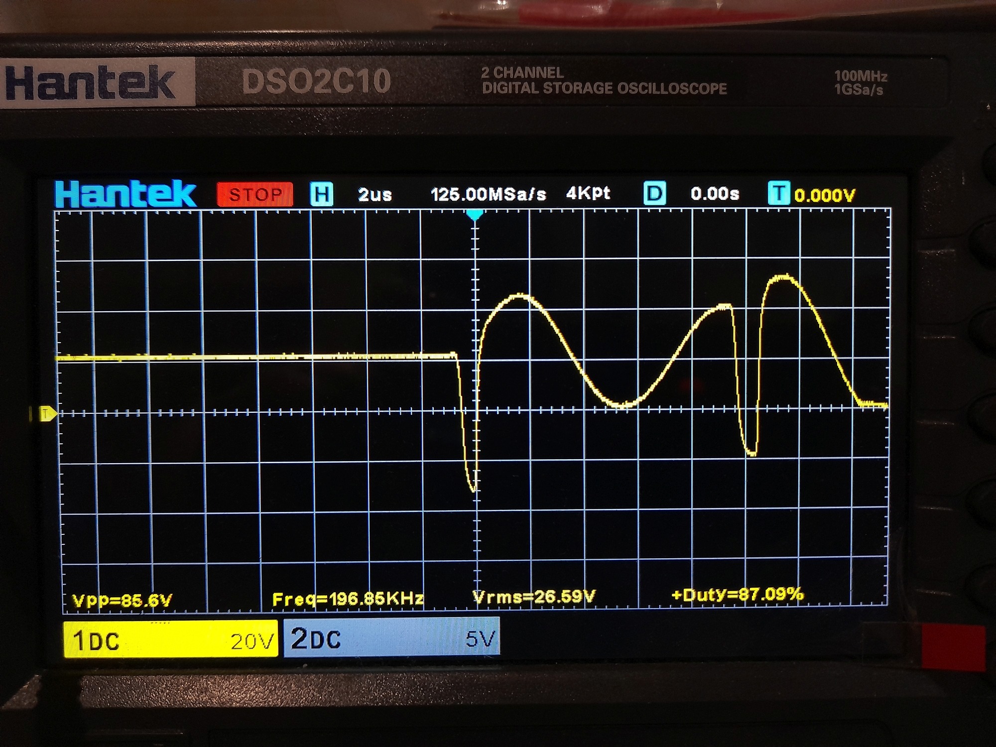

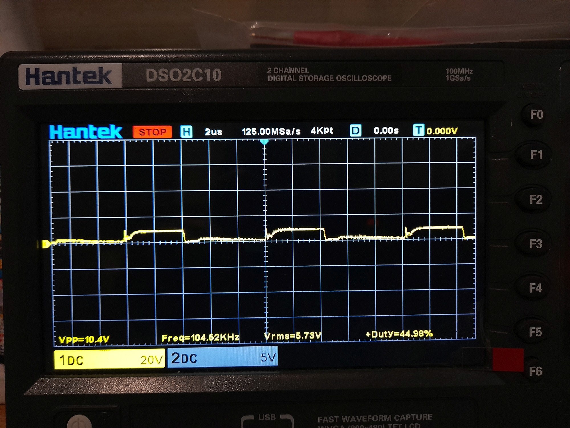

I will try to give as much info as a I can. Pictures are taken with no signal thru RCA jacks.

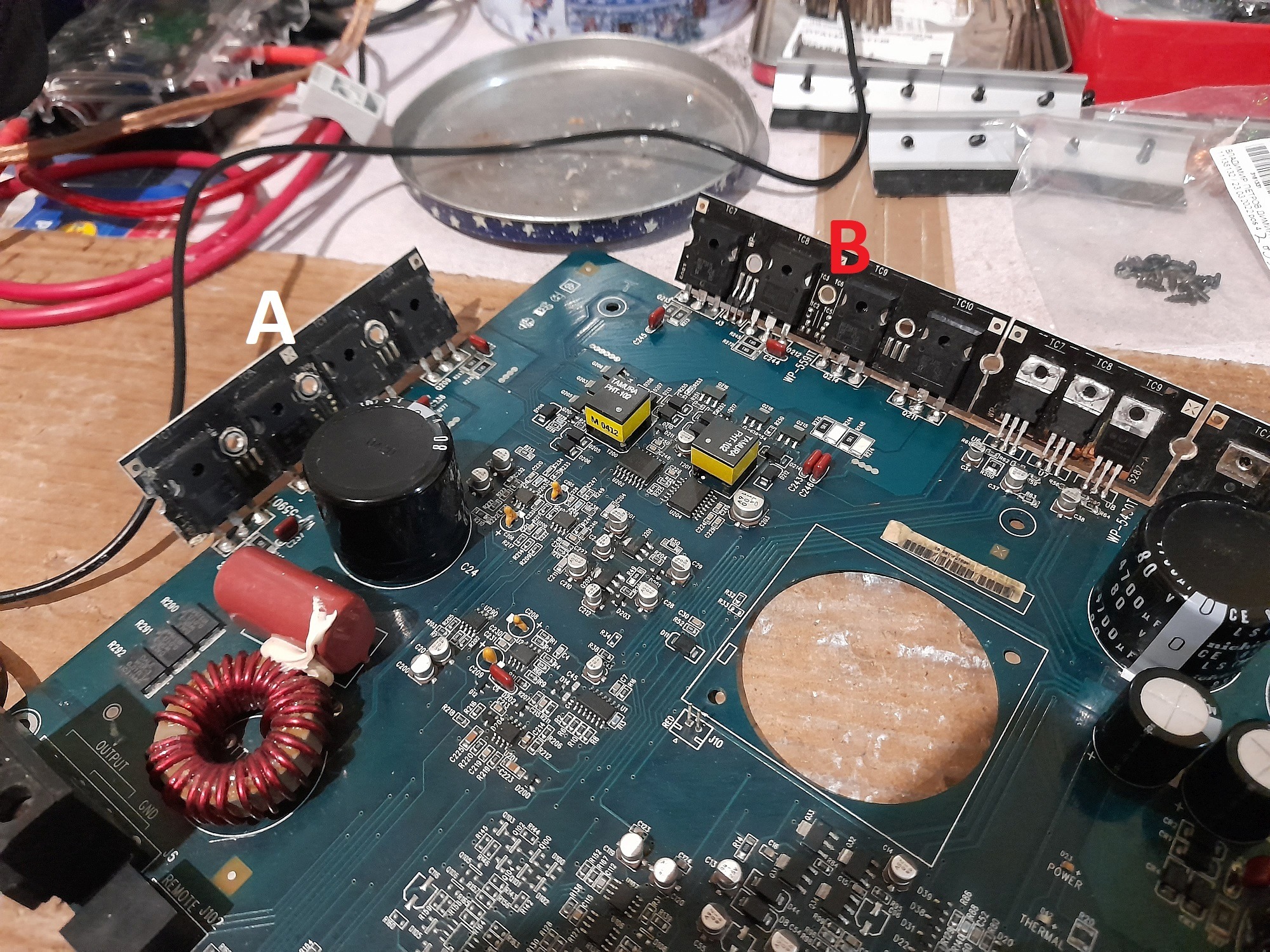

Section A runs much much cooler than B.
This is the A side
This is the A side
This is section B:
Are the current shunt resistors R290-292 reading, basically, a dead short across them?
Is the voltage on pin 8 of the audio driver ICs at a steady 10v?
What's the DC voltage on pin 3. Is it steady?
1. Yes, dead short
2. Do You mean U202 and U204 ?! Pin 8 is exactly 10.5v steady.
3. Pin is exactly 5v, steady too.
When you load the amp and get the distortion, do you get a similar change in the input or output of the audio driver ICs?
