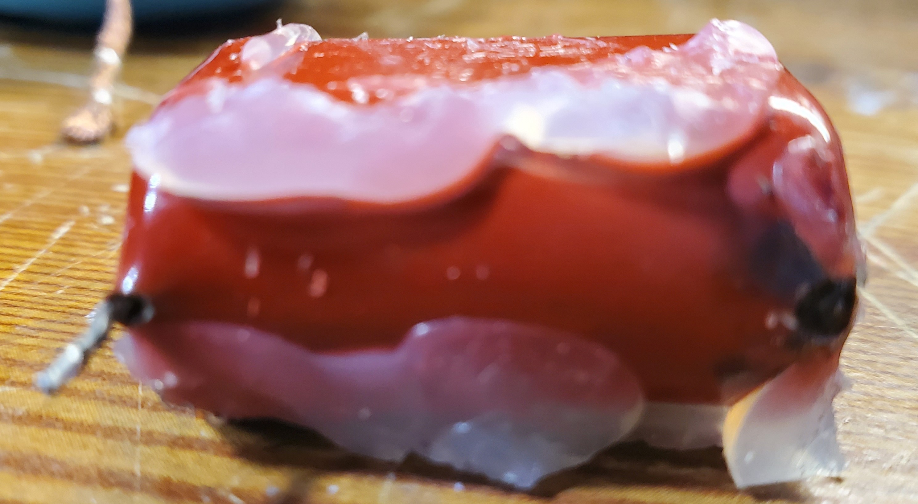

Cap blown up, found after removing. Removed because it was reading shorted. I still have a short somewhere, because it is still shorted from pad to pad.
The amp should power up fine now shouldn't it, if there is no more bad components? I know it won't have no output, since I am going to have to order a cap (106J/100v). I have replaced 2 IRFP3415's.
